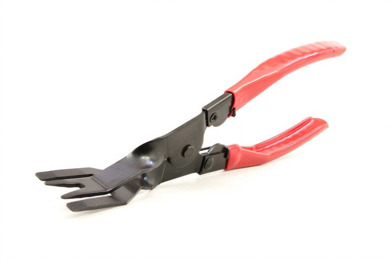

    Even the cheap Depo/Spyder housings don't give off that much smell. It shouldn't be an issue if done correctly. Some panel clip pliers help a lot

    For some reason I had really no problem with the clips.
    Only tool I used was one of these, to split them apart and also to scrape all (most) of the old glue out.

    I don't mean for the clips on the headlight, I just meant the tool used for interior clips. Anything flat and semi sharp will work though if the butyl is heated enough.

    Gotcha... Ya, I was wondering how that thing would help on the headlight clips LMAO

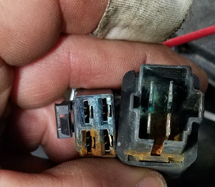

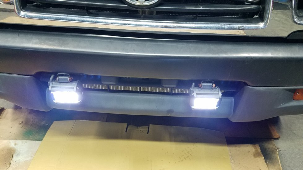

    About two weeks ago, I looked out the kitchen window and saw my add-on fog lights on. I pulled the fuse. Today, I got around to investigating.
    I confirmed power to the switch and relay input. Pulled the 2 yr old relay connector and found this:
    This connector is in the space between the battery, headlight, and the fender. Pretty well protected from rain and splash. But it is Chinese.
    I cleaned it up and still got no function.

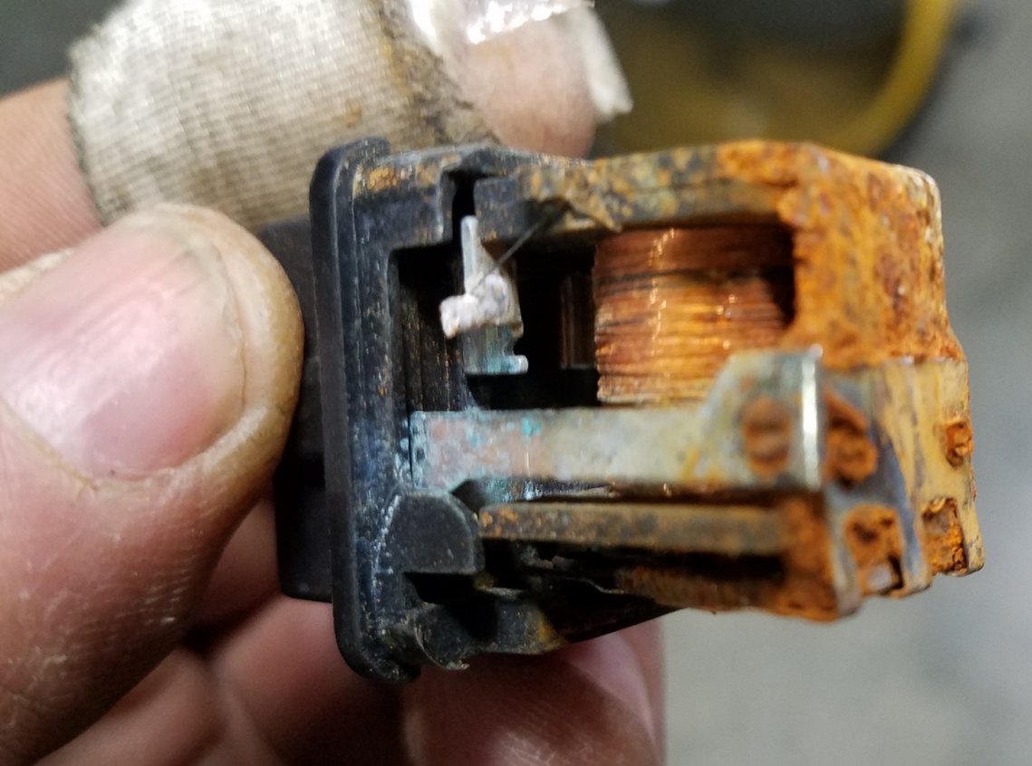

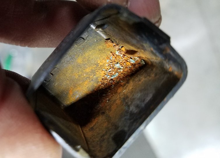

    Pulled the relay cap.
    Again, this relay is only about 2yrs old and not in a truly wet zone.
    I didn't have a replacement in my salvage yard scrounge stash, so I cleaned up the contacts and it worked fine.

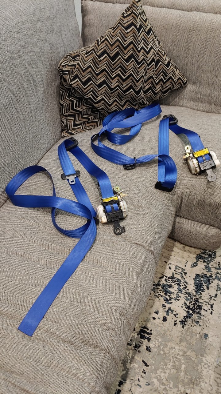

    New belt webbing to match the exterior. Was too dark by the time I finished installing but you get the pictur
