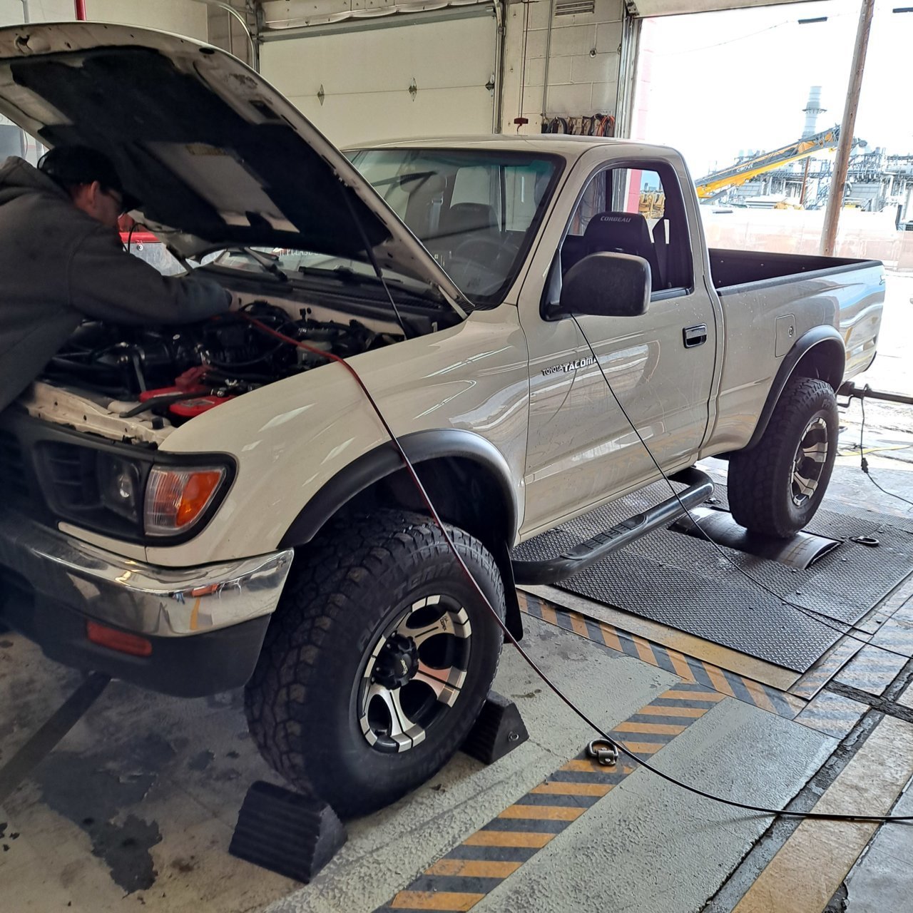

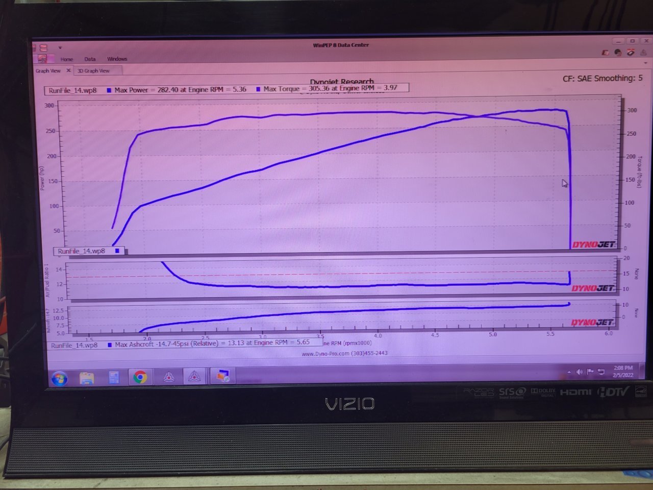

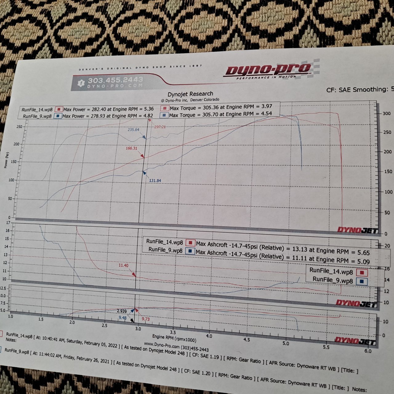

    Haltech finial tune and dyno done yesterday.
    A beautiful power graph curve too
    We gained 62lbs torque and 35 hp of new power in the midrange area 2k-4.5k from the haltech compared to the stock ECU on methanol both with dyno results.
    Rev limiter raised from 5100 to 5600 and hp is still going up.
    Torque is almost at max at 3000rpms at 300lbs.
    Finial numbers are 282hp and 305 torque at 6000 feet,
    SNPSPEED.COM With the remote tune is the bomb for getting the most out of your supercharger with the remote tune by GABE SALAZAR
    All from a tune
    if you want the most out of your supercharger with a perfect tune this is the way to go

    How much do you think stock could gain? And have you inquired about a fuel economy tune at all?

    Fuel economy is the same, still around 20 mpg and I have about 5k plus miles on the haltech, I’m not looking for a economy tune,
    how much what can be gained?

    20mpg wow, I've always been around 14. How much HP do you think just a tune on stock could gain (for the non-FI guys)?

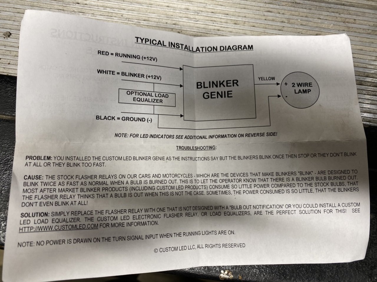

    Added some fancy logic to my tail lights so I get all brakes unless I have a turn signal on.
    this
    To this

    Did you use a device or just clever wiring?
    Could the same thing be used for turn-signal-corner-lights?

    I used a device, and planning to use it for corners if I ever buy some driving lights.
    https://www.customled.com/products/blinker-genie-2

    I think a basic P-channel MOSFET and pull down resistor would have done that for you, for future reference. HIGH blinker input = OFF

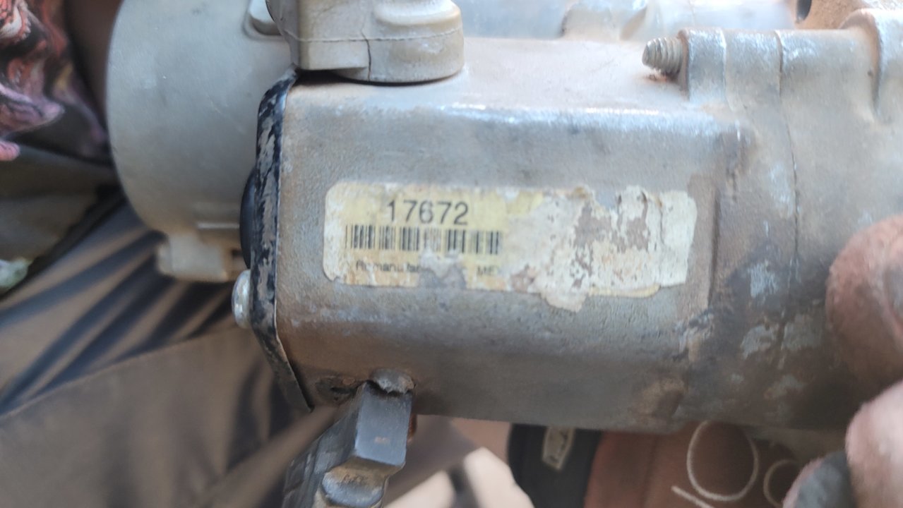

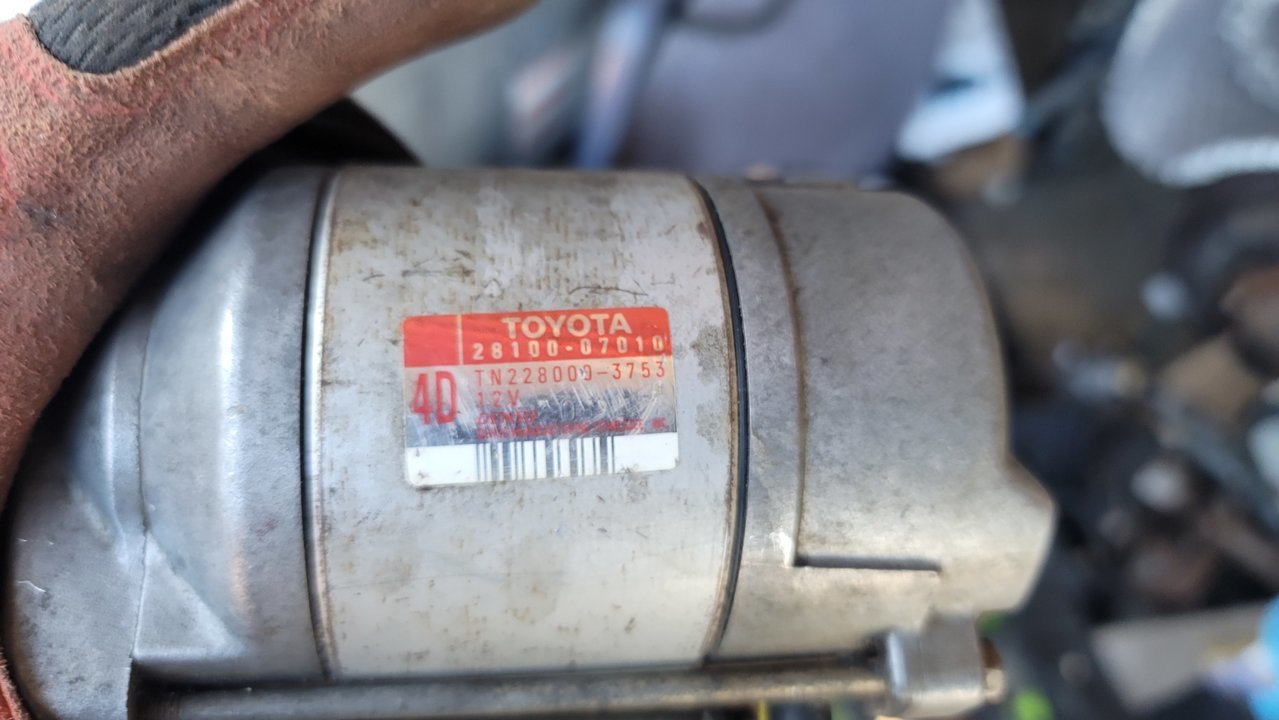

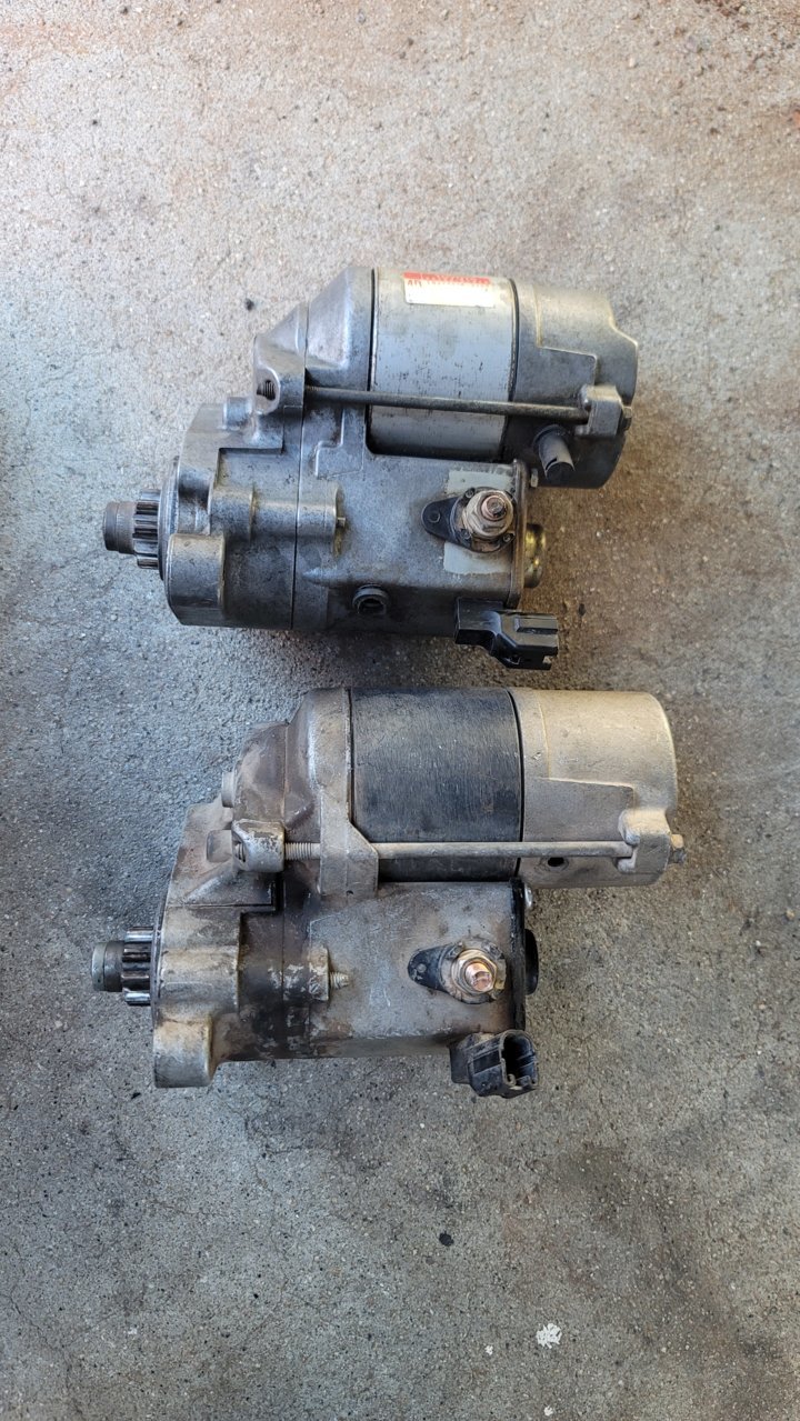

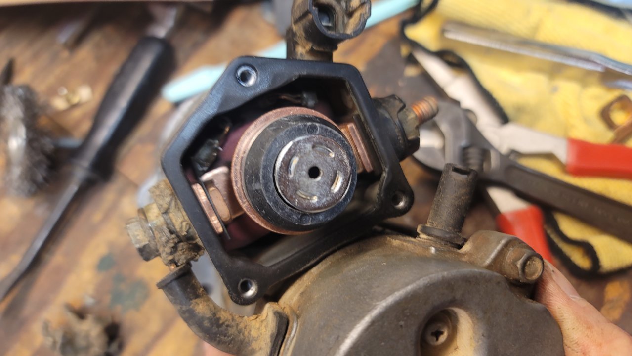

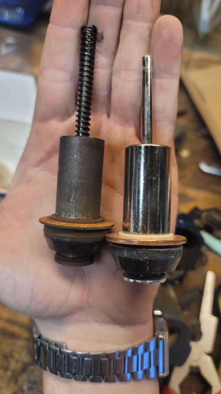

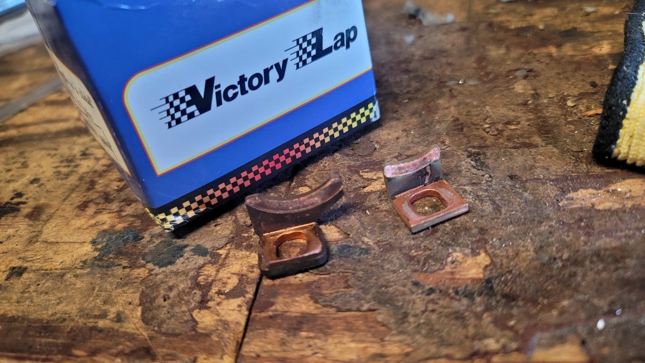

    Trucks been not starting or starting weak lately.
    Not starting after long drives.
    Just did a rebuild kit on the oem one and she's still being lame. Thinking a new starter might be in order since the battery is fine and all electrical is solid... or so it appears.
    Any other ideas on a culprit? Turns over a bit (weakly) then starts. R150f 5vzfe
    The reman is much larger also oddly.
    20220206_130838.jpg 20220206_123620.jpg 20220204_172728.jpg 20220204_174334.jpg 20220206_123751.jpg 20220206_123339.jpg

  16. Feb 6, 2022 at 5:29 PM

    Have you had your battery checked? Maybe it’s lost it’s cranking amps
  17. Feb 6, 2022 at 5:40 PM
    erice
    erice Well-Known Member
    Nov 9, 2014
    #142008
    1,084
    Eric
    San Diego
    It's been a good 12.2 12.4 volts
    Can they loose CCA and retain a regular comsistant voltage?!
    1997tacomav6 likes this.
  18. Feb 6, 2022 at 5:45 PM
    Kwikvette
    Feb 27, 2019
    #284735
    82,840
    Fresno County
    4 run, 2 don't
    Weak start wouldn't warrant a starter rebuild.
    That'd be if you got the 'single click' no start issue. Or if you had a starter that kept cranking after it fired up.
    All your grounds good?
    unstpible, erice[QUOTED] and Dan8906 like this.
  19. Feb 6, 2022 at 5:46 PM
    Dan8906
    Dan8906 Well-Known Member
    Jul 26, 2016
    #192977
    5,151
    Daniel
    Concord, California
    2004 Tacoma ext cab TRD 4x4
    CBI sliders, ADS extend travel with compression adjuster coil overs, 9” Bilstein 5125 rear shocks, Icon Tubular UCA, Alcan custom leafs, All Pro Apex bumper and skids, NWTI rear diy bumper, 295/70/17 Cooper St Maxxs and nitro 4.88s.
    Yes, it happens. CCA decrease over time. I’d just go have it checked.
    treyus30, unstpible and erice[QUOTED] like this.
  20. Feb 6, 2022 at 5:48 PM
    Black DOG Lila
    Black DOG Lila Well-Known Member
    Jun 14, 2019
    #296344
    9,116
    Virginia
    2003 Tacoma SR5 2.7 5 speed 4WD
    Stock. EZ pass.Dump pass.Inspection sticker.Convict printed lic.plates.FG cap.
    Get the battery load tested.
    The larger starter is Cold Weather part.
