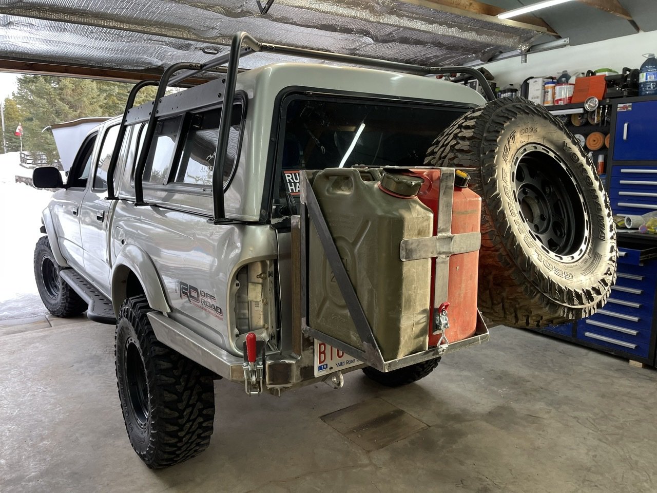

    I’ll be interested to see how close you get to the bumper wings on that Coastal rear when you jump to 35s.
    I have the same kit holding down my parts shelf, so I haven’t been able to check it with my 315s yet…

    Is that over the shell rack DIY? Looks great.
