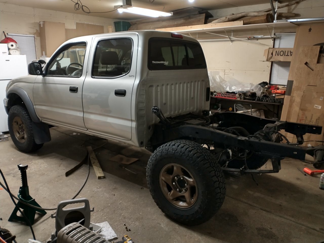

    I Will tub it eventually. Not sure I have enough time (might be leaving for Saudi this weekend)
    Got the 35’s on now, went for a drive and didn’t hear one bit of rubbing. Even up on a snowbank, I barely contacted the fender flare.. those will be cut tonight plus the fender behind. That should get me by if I do leave. If not, I’ll be cycling the suspension and tubbing fully this weekend.

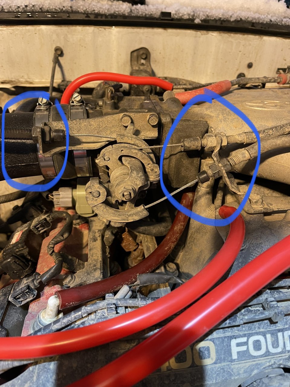

    Asking again if someone wouldn’t mind posting up a picture of their TB cable nuts so I can compare how mine are placed to theirs. I’m still tweaking with it right now but a reference pic would still be nice.
  3. Feb 8, 2022 at 3:13 PM
    drr
    drr Primary Prognosticator
    Oct 17, 2013
    #114681
    2,726
    Dan
    Seattle-ish
    02 4WD Tacoma

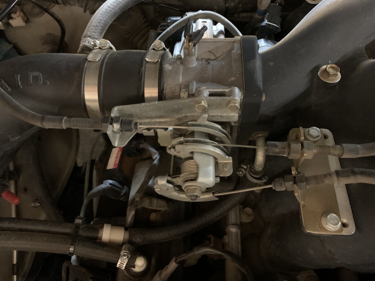

    Do you mean how yours are adjusted compared to some one else? The cables stretch, that’s why they have adjustment, so mileage and condition are going to be major factors. Here’s a picture of my TB, I don’t think it will do you much good though.
  4. Feb 8, 2022 at 3:23 PM
    Logans2001
    Logans2001 What’s crackin’
    Jan 23, 2016
    #175792
    1,972
    San Diego, CA
    2001 v6 4WD auto
    Yes compared to someone else’s who has a normal idle. I replaced my IAC recently and my idle has been high since. 1000 rpms in park.
    Is that a 4 cylinder?
    While I was replacing the IAC I also tightened the cables a little. It’s just weird cus I’m positive that I didn’t tighten them enough to start opening the valve but perhaps I did.

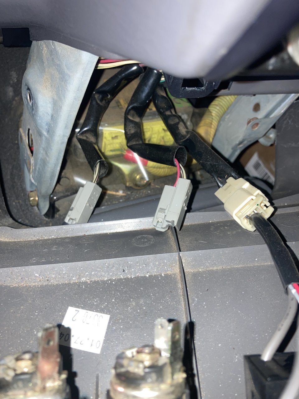

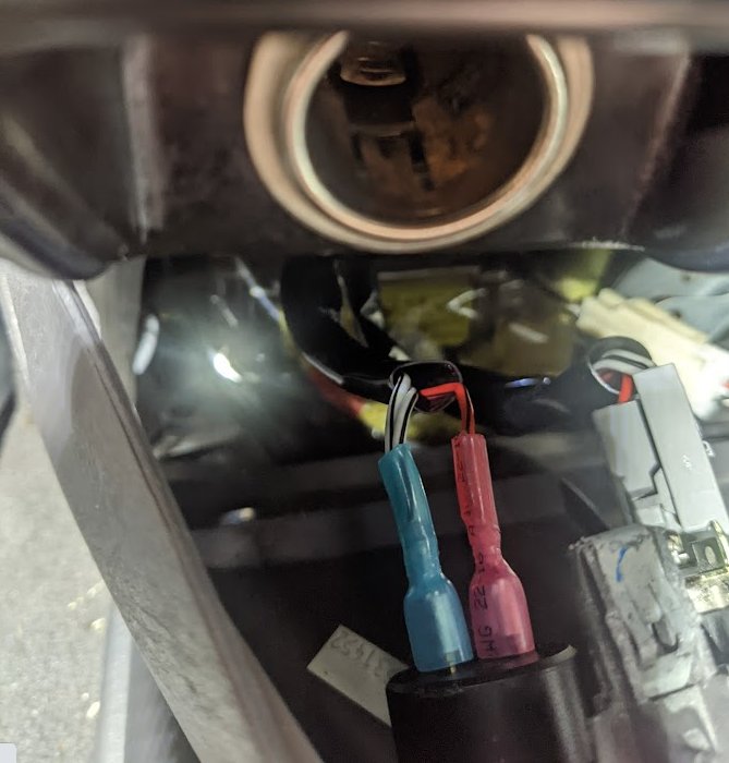

    Just get a thin/small size pick tool and insert it into the connector (power off of course :anonymous:). There is a tab in there that locks the terminal in place. The L connector may end up being destroyed in the process of releasing the terminals but whatever, not going to need it again.
    I thought I reused the original terminal but looks like I did not (see below).
    Also note, you may need to bore out the hole a little bigger to accomodate your new accessory plugs. My aftermarket USB and Voltage meter did not fit.

    Just loosen the cables all the way to test if they’re holding the throttle plate open. It’s pretty unlikely though. If you just replaced the IAC that would be the main culprit. Was it used, aftermarket, OEM? I would be suspicious of anything other than a new OEM or known good used one.

    Consider returning it and getting a replacement. The IAC can be super finicky sometimes. If you’ve ruled out the throttle cables being too tight, reset the ECU, and have a clean MAF, etc then that is almost certainly the issue.

    Thanks! I'm assuming the red wire is the + here? I never know with Toyota wiring lol. I'm used to black/white
  14. Feb 8, 2022 at 5:22 PM
    Area51Runner
    Area51Runner Well-Known Member
    Jun 26, 2014
    #132748
    11,977
    Northern California, Bay Area
    02 3.4 DC TRD PreRunner 4WD SWAP
    Should be but honestly, I may have been in a wonky mood that evening lol. Double check with your multimeter to be sure :anonymous:
