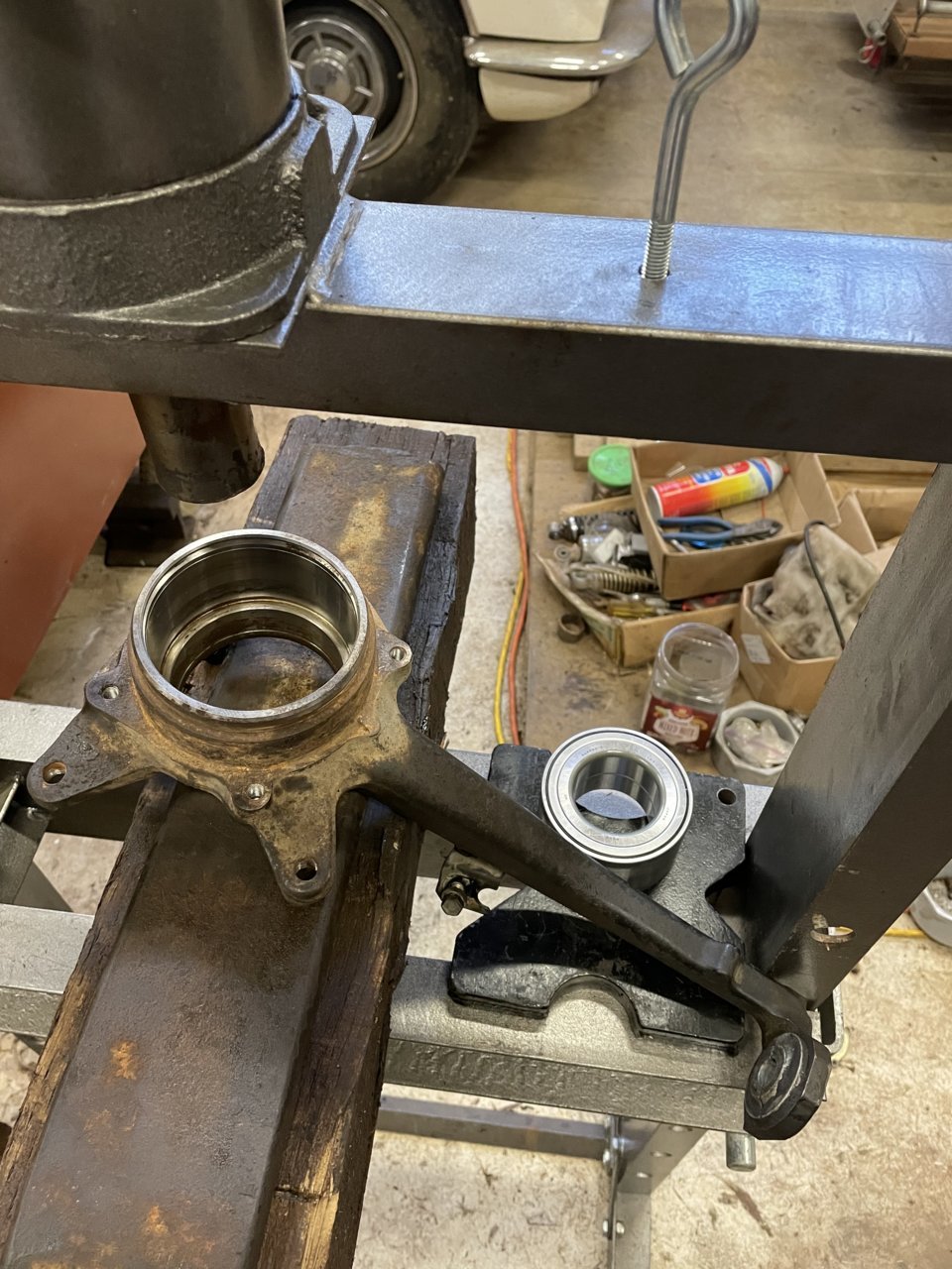

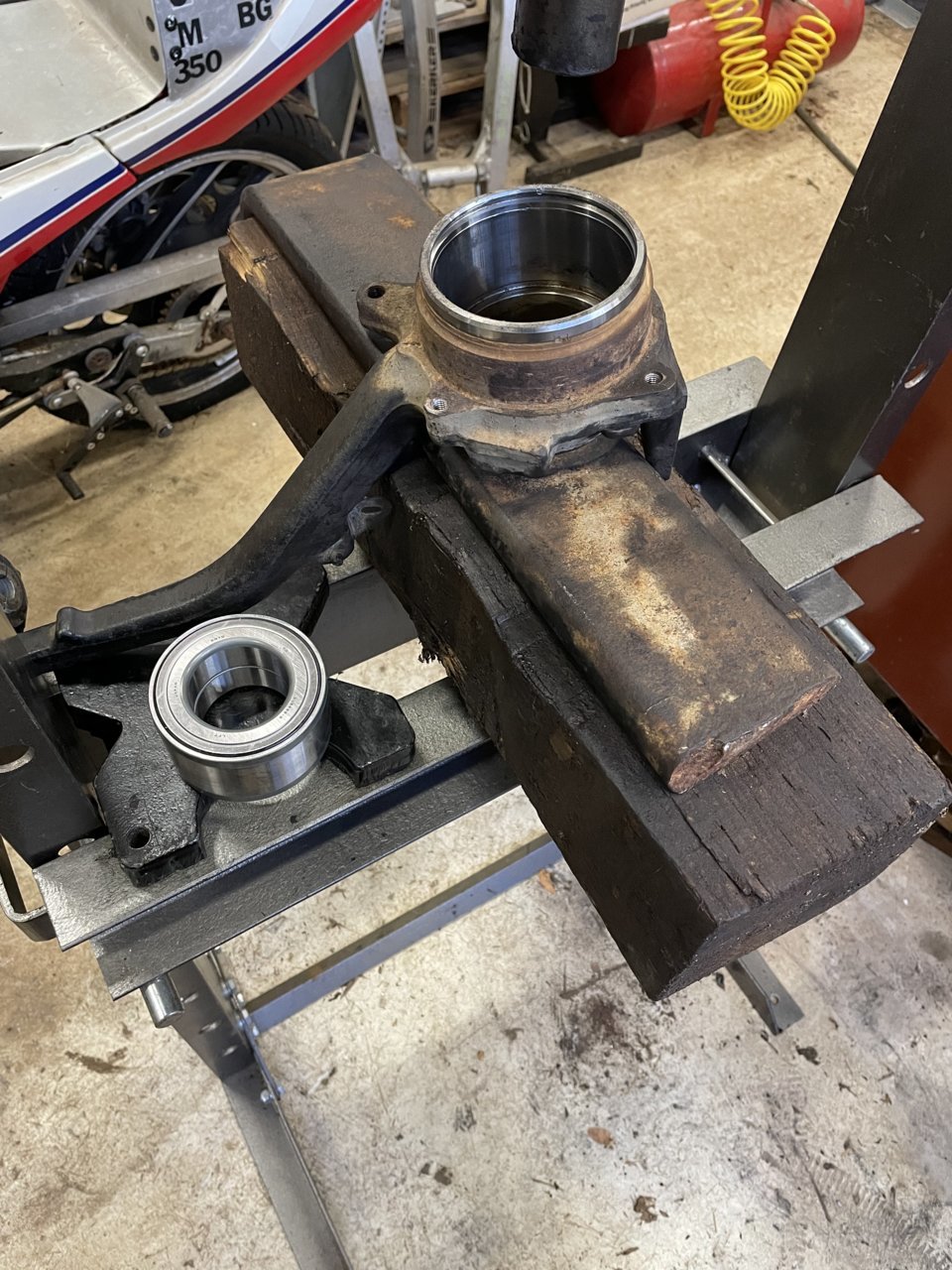

    2946D992-474F-4BF7-A049-3CB1F45DED0A.jpg Wheel bearings today… ECGS bushing install and axle seals too if all goes well, if not, tear things back down on Monday.
