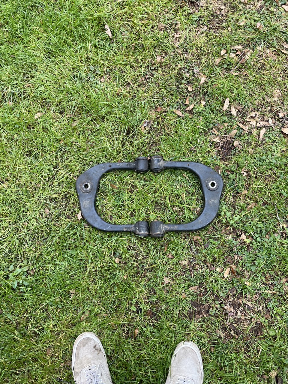

    @WTORRES141 if you never found a set

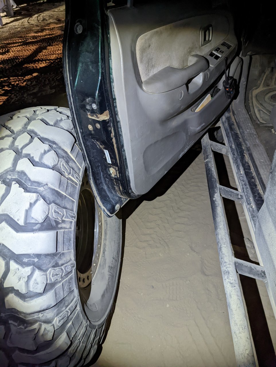

    I cut mine to the door hinge as well, actually i think I cut my hinge a bit even.
    Also Im not totally sure what tire size you have(35x12.5vs315s) but if you've done enough searching you'll notice a different hole cut by different tires. The 35x12.5s end up cutting wider holes usually than someone with 315s. Thats a bit of a generalization as alignment and wheel setup factors in too, but just something I've noticed.
    It's definitely not the funnest project but worth it I think. Bigger tires help a lot. It's just a damn expensive mod given all the other shit that goes with it.

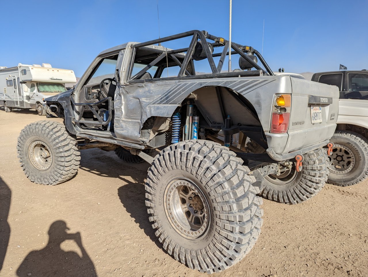

    It's totally a real thing, I sure felt insecure after my first hammers trip and was tubbing 2 months later :laugh:
    And every time I return from an ultra4 trip I start cruising pirate2x4 classifieds for a crawler.... Maybe one day...

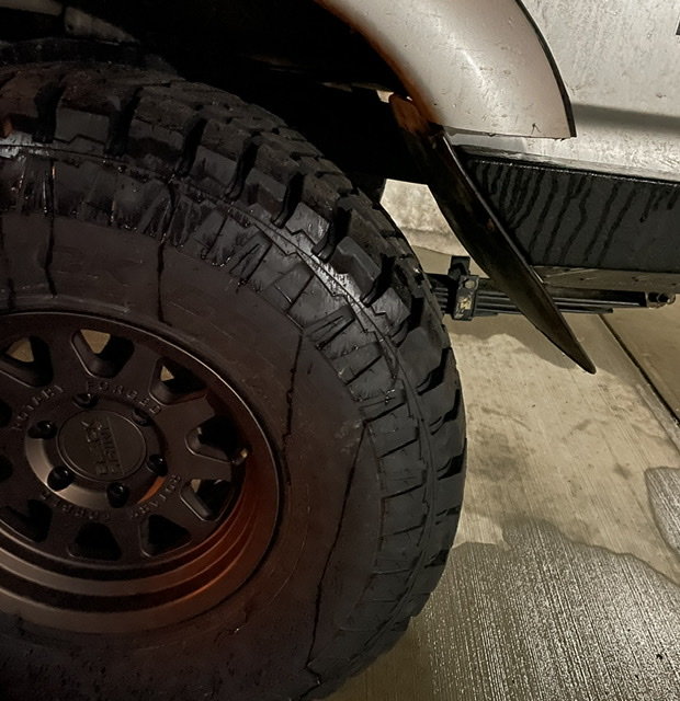

    My truck on factory suspension and 245/75r15 ATs.
    Non-truck people: Those tires are huge! Is that thing lifted?
    Truck people: Those look a bit small. You should at least go to a 265/75 to fill the wheel wells.
