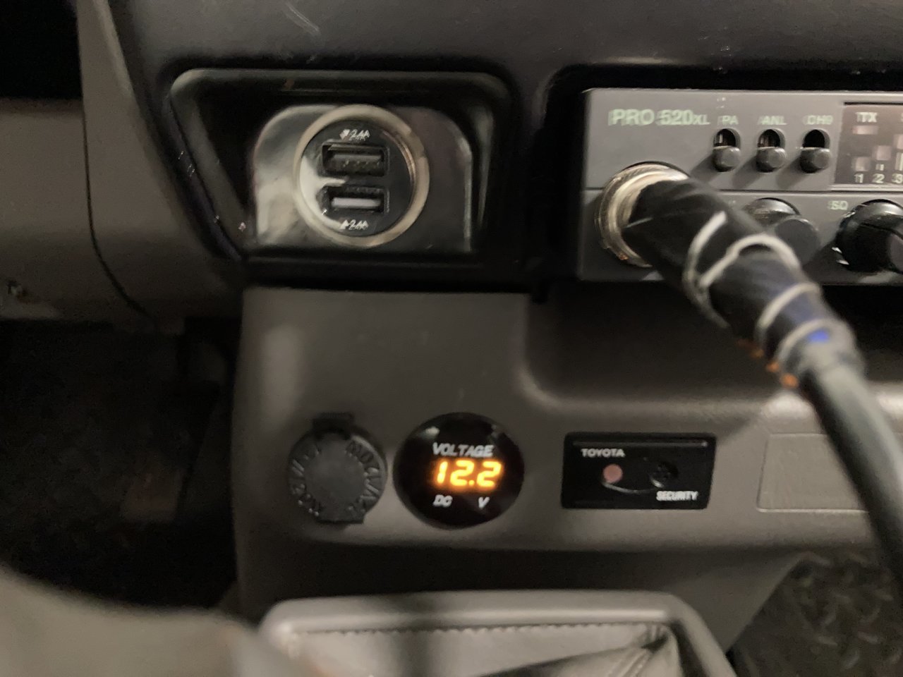

    What plug did you use to replace the cig lighter? Plug and play besides cutting the plug in half?
  4. Feb 15, 2022 at 8:35 AM
    ThunderOne
    ThunderOne Well-Known Member
    May 20, 2009
    #17473
    10,042
    Mitchell
    Nashville
    1ST GEN OR GTFO
    Toyota NERD
    Almost plug and play. I had to undo the terminal on the red wire, and dremel a larger slit in the plastic because it was too narrow to fit over the connector on the Voltmeter on that side. I then put the plastic bit back on and it fit. I also trimmed a little plastic that was poking out off the terminal cover on the - side as well so it would sit on the connector a little further. It will make more sense once you try to connect everything. YMMV though depending on what you are trying to plug in.

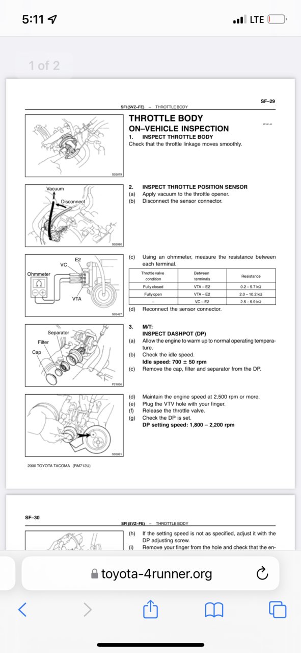

    Does it matter if I try resetting my ecu with a warm engine or should it be cold? Or does it not matter.

    doesn't matter

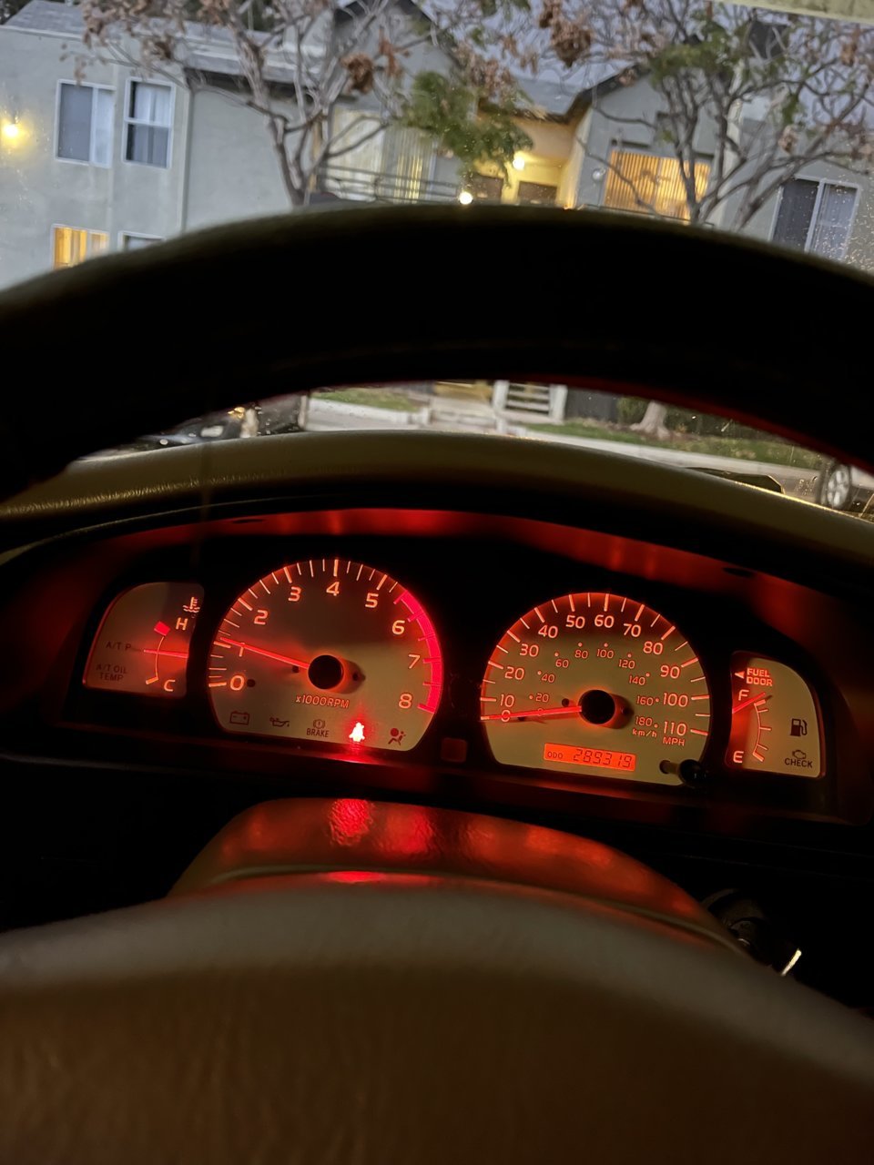

    Did another ecu reset for the third time but this time left it for about two hours, not just 5 minutes. Still hovering just around 1000 after 10 minutes in park, shooting for around 750. Really hoping this fixes it tho I don’t think it will. Rockauto warranty replacement IAC just came in the mail today.

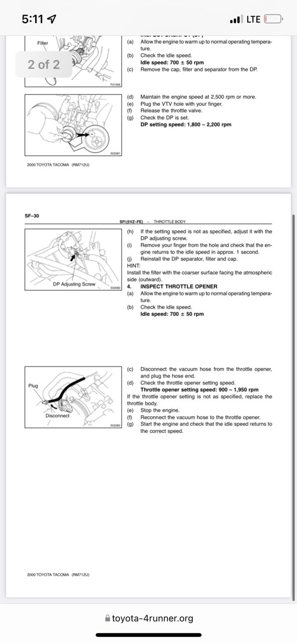

    Have you tried draining capacitors by touching leads together while off the battery?
    also, not sure if these pics might help, was a nice resource for me. 2431C52C-13EA-471C-A740-34529447B267.jpg 98D60494-EC38-48B5-B2C0-0835B5F34BDC.jpg

    I tried but they’re not very long so I could only bring them together for a couple seconds at a time a few times. I’m not sure how long they’re suppose to be in contact for.

    Your idle is dead center for the type engine you have, you can go a little lower but it won't stay there for long. Keep messing with the ECU, good bet your sensors will start failing - fast.
