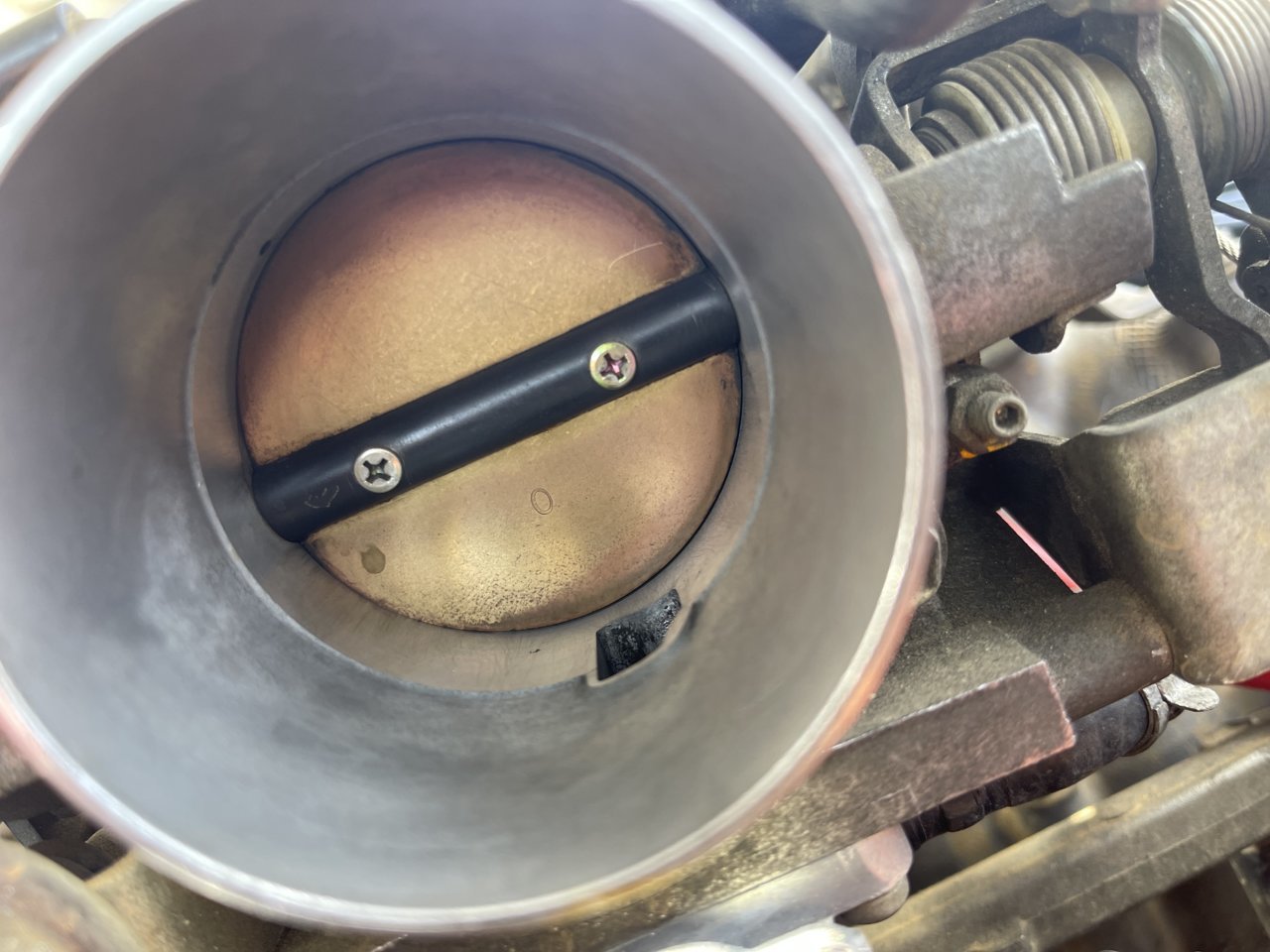

    So there should be no space between the butterfly valve and TB? It should be completely closed?

    You should'nt be able to see any light coming through it when you hold it up to a lamp, that means it's worn and would cause your idle issues for sure. Someone a page or so back posted a pic of what that looks like. Didn't you just clean it recently? A lot of times the gunk is what keeps it sealed on higher mileage TBs and when that gunk gets cleaned out it's now letting too much air through.
    I think there's a place called Max Bore that people send theirs out to get re-bored at

    Ya it got cleaned when I did my valve cover gaskets about a year and a half ago and cleaned again in December but there wasn’t much at all to clean. I’ve heard a lot of good things about MaxBore and for the price it seems worth it. It would just be a major inconvenience since this is my dd and me and my gf are both full time working or in school so I don’t exactly have an extra car to use for a week+ while my TB gets serviced. Maybe I can find one in a yard for cheap and use that temporarily. Who knows. I think I’m gonna rip this thing apart again today so I’ll keep you guys posted on what I find!

    Yeah definitely check it before committing to a new TB or rebore. Could still just be that aftermarket IAC

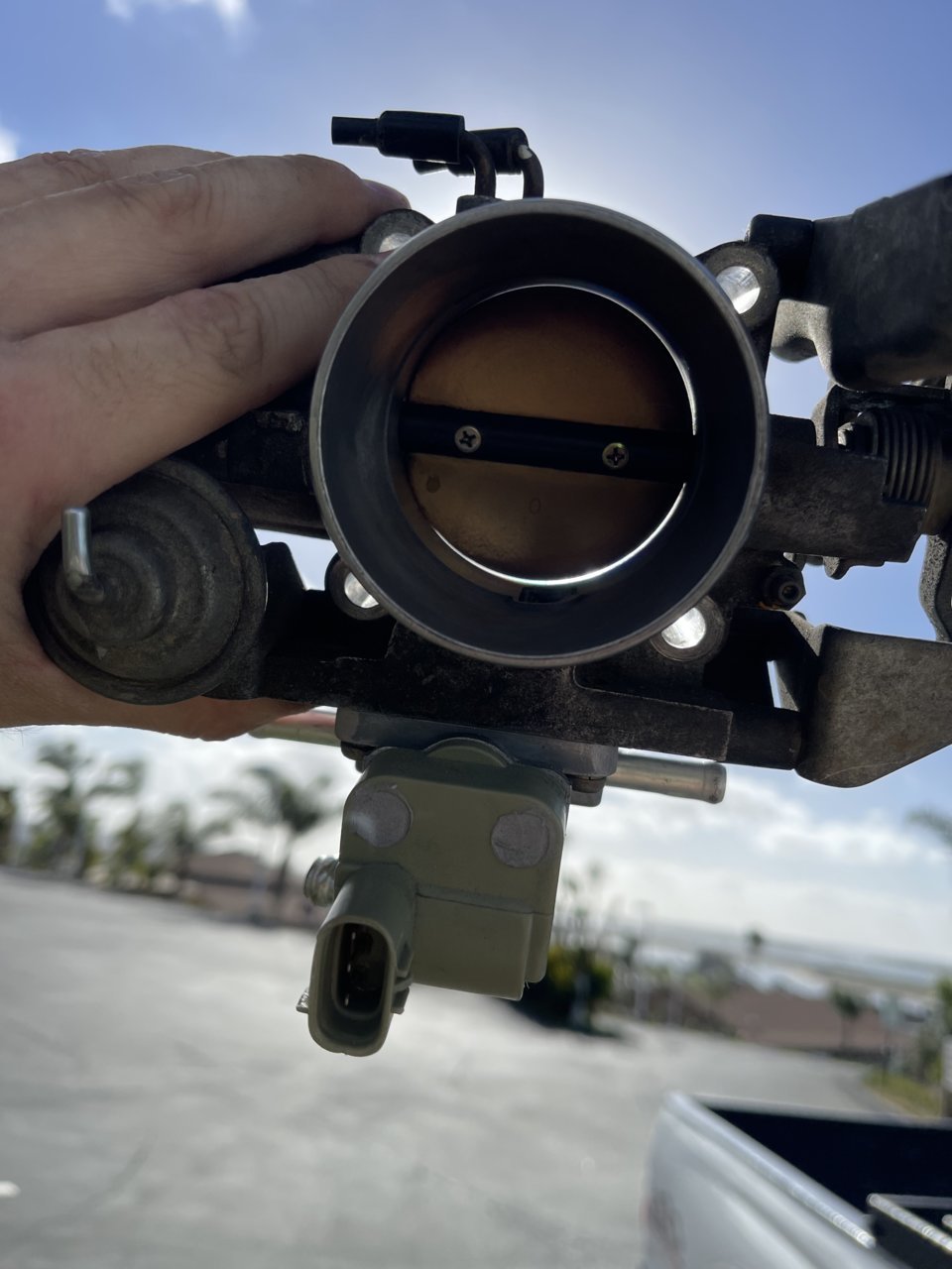

    So here’s what we’re looking at so far. From what I can tell there’s no space for air to be getting past. I’ll try to hold it to the sun and look for any light in a sec.

    SIKE! nvm there clearly is a gap now that I put the sun to it. Glad I finally figured it out. Thanks for everyone’s responses.
