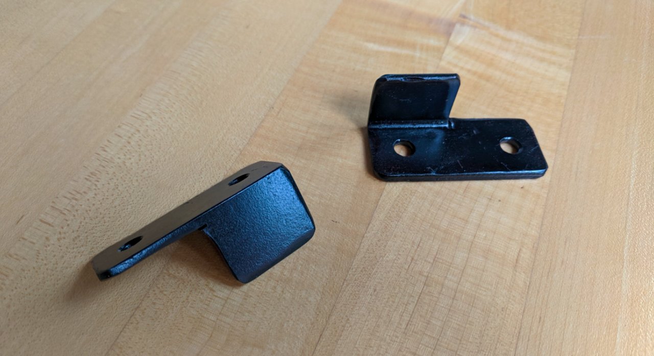

    It's less Tacoma and more mod
    I made some out of 3/16 angle iron that i just milled the top off of a portion on...

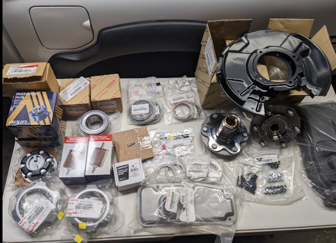

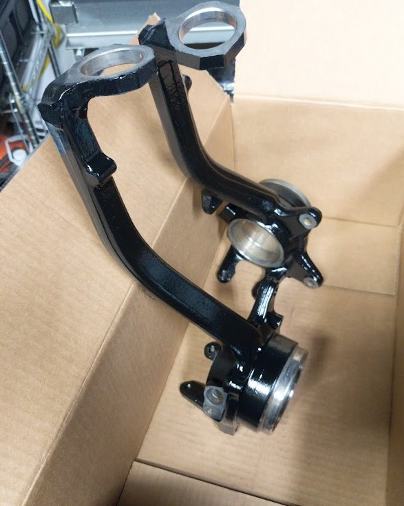

    Those are new spindles? Or some cleaned up originals?

    Everything on the table is new, including the hubs.
    The knuckles are off a 2004 Taco.

    Yes. Very easily this can happen and 90% of the time is why I have to replace bearings at work after someone DIYs them

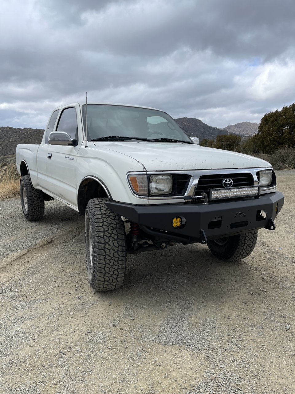

    New Falken Wildpeaks, mounted up a Lightforce bar and Baja Designs fogs, and found a nicer OEM grille for the 95. Also did a bunch of touch up on the paint behind the bumper while it was off. Waiting on a winch still. Might start dabbing up a rear bumper next.

    How tight does that have to be? I've always just impacted mine and never had a problem

    Anything over 300 ft lbs tears bearings up pretty quick. The torque sets the preload. Too much preload you get issues

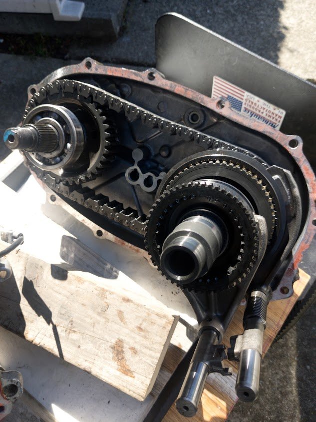

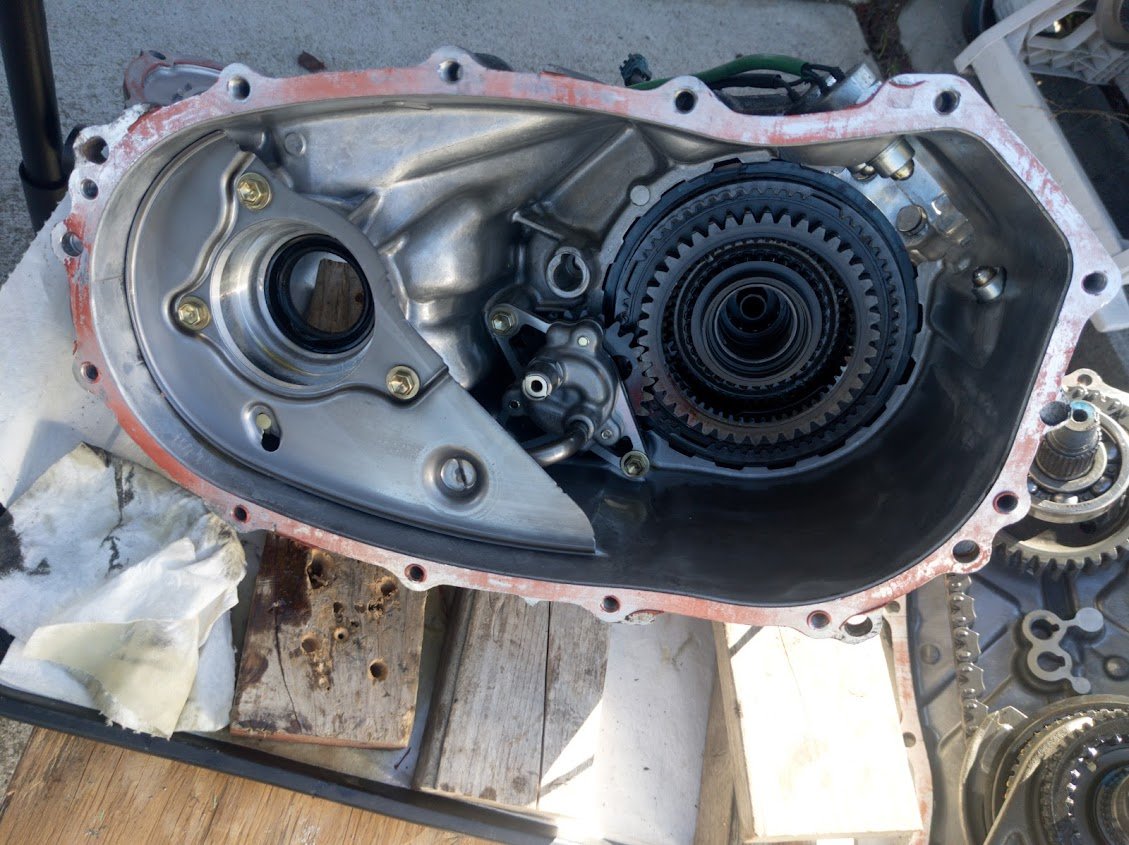

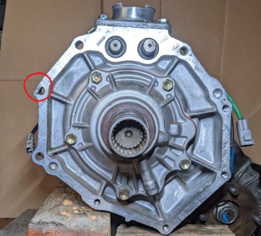

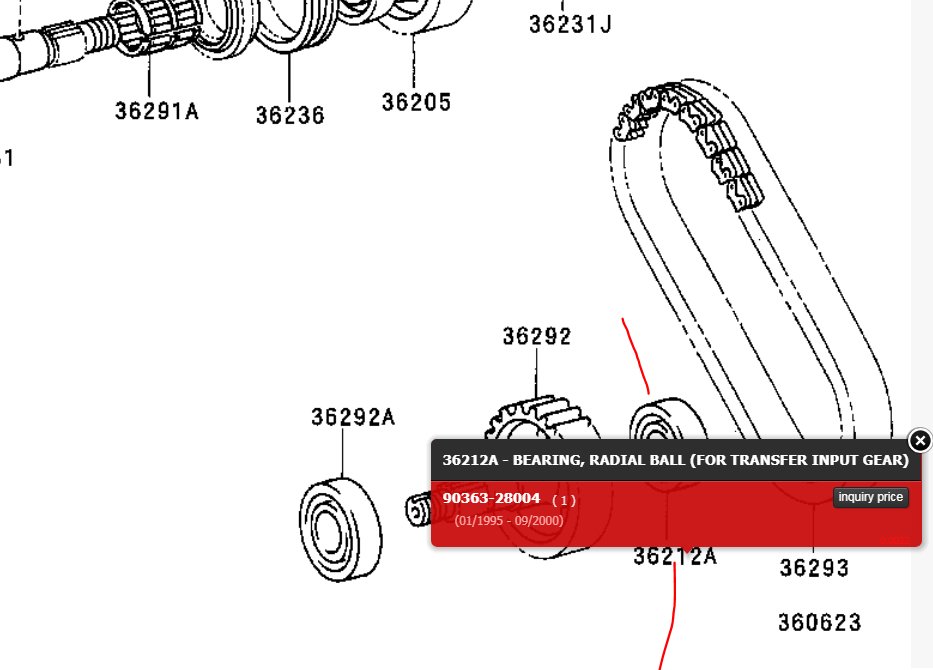

    Took the transfer case apart today to try and determine what was happening with that noise. Bearing for that 4WD output shaft seems fine. Spins freely with no visual issues.
    Noise (additional video below) is definitely from the chain, just not sure if its expected or not (especially with no oil in the case). Chain is not loose and does not appear to have excessive play. At this point, going to replace the Type T Oil seals as well as the smaller oil seals and just go with it.
    Clean inside :thumbsup:
    D4GgcRt2UVY7Qd3GXrMBJNJ_LRxA2uYXrvodCIL3_dca0e3ced6e876a560b757552c04fab721f959a6.jpg
    aT3b34Zy94bsnOQqjGFGi-fkCO-mBlr3YFs7-Irs_acf2e0d385eb77c01070e7af08887e12b81eddcf.jpg
    NOISE (Chain?)
    https://vimeo.com/681589302
    Now that I'm looking at it more, I wonder if it could be this bearing (inboard) - havent drilled down that far yet.

    hm that sounds like a bearing failing to me. Could be the more inboard bearings.
    Area51Runner[QUOTED] likes this.

    Great. So now I get to really take it apart. Will drill down further. Thx for the feedback.
