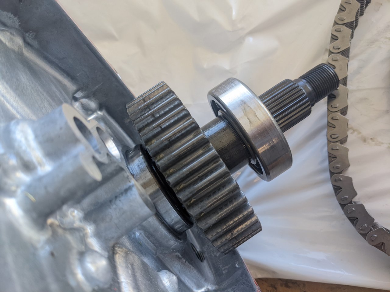

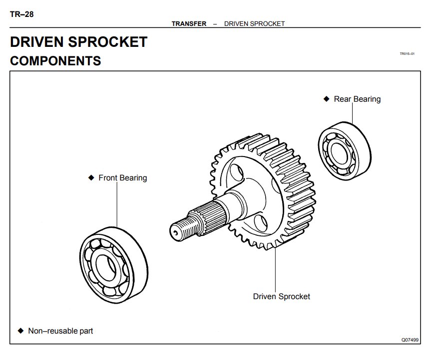

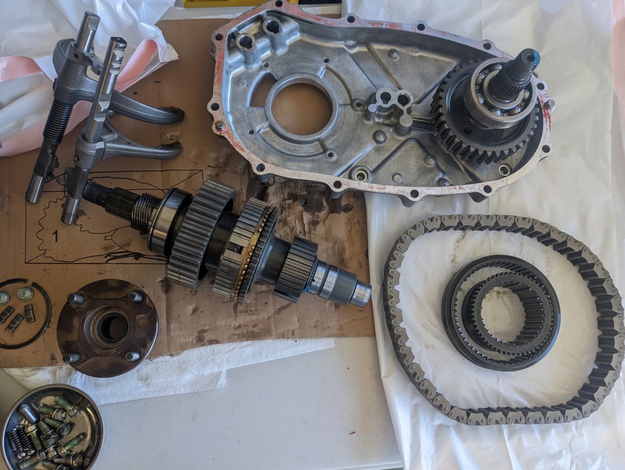

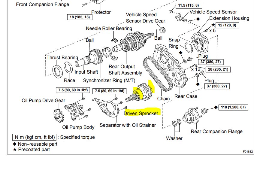

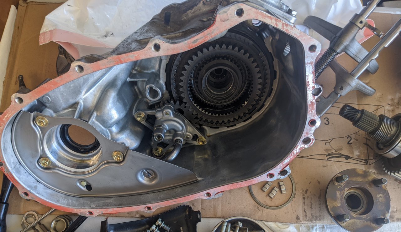

    Ripped into the transfer case and found that there is noise coming from the rear bearing on the 'driven sprocket'. Front bearing is smooth and doesn't appear to have any issues but apparently its a "sorry, replace one - replace both" thing. Ordered and while I await delivery, guess I can paint the transfer case since I have it apart now. Everything else in there appears fine. Chain included, thank god. That damn chain runs about 530 dollars. The two bearings I'm replacing total at about 50.
    A few pics from surgery...
    Driven Sprocket with 2 bearings which will be replaced.

    If you needed a chain I have a spare with less than 100K on it. It wasn’t affected by the water that collected inside the front of the case. Glad you were able to identify the noise.

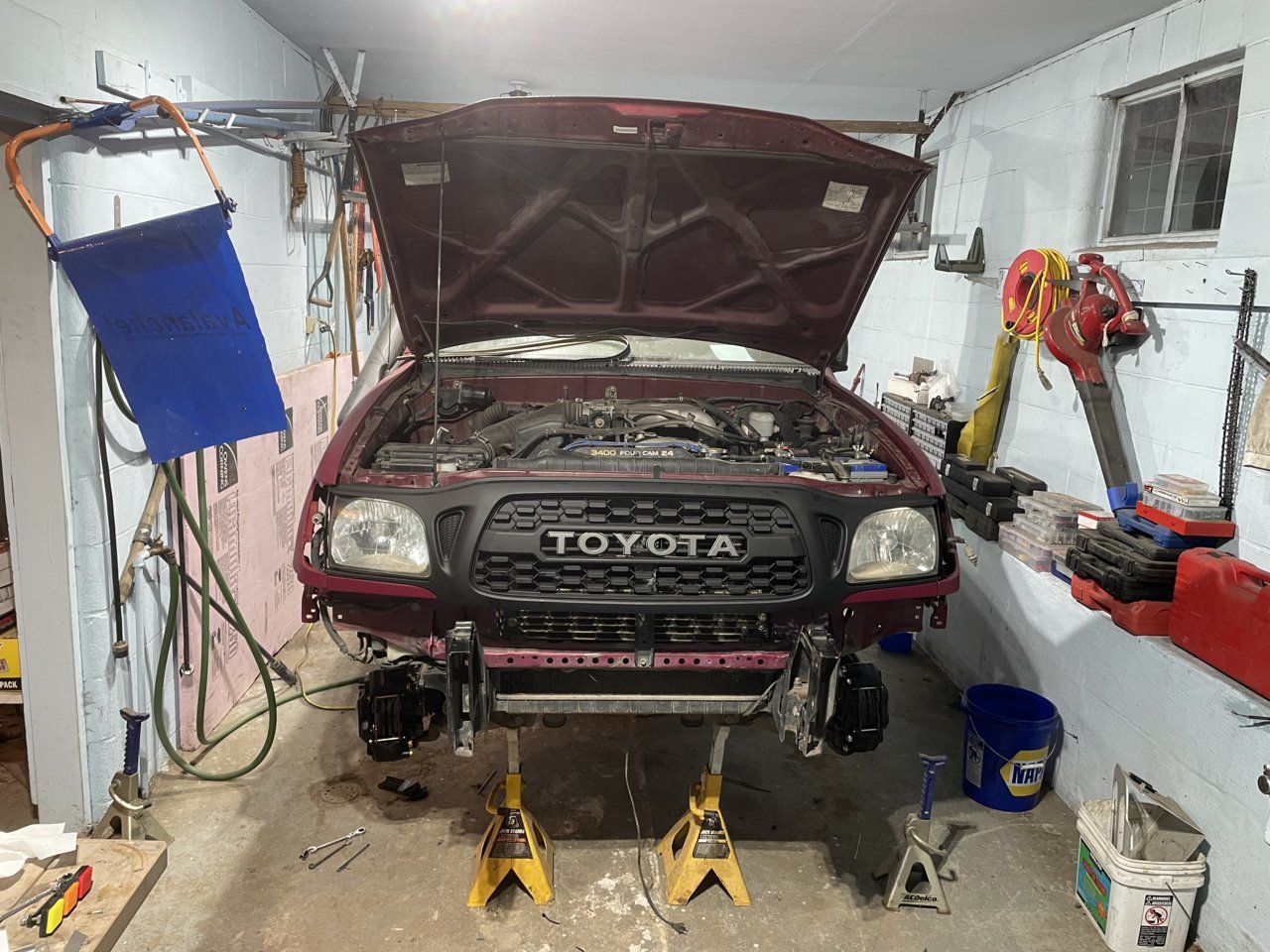

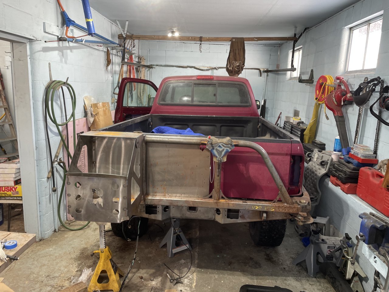

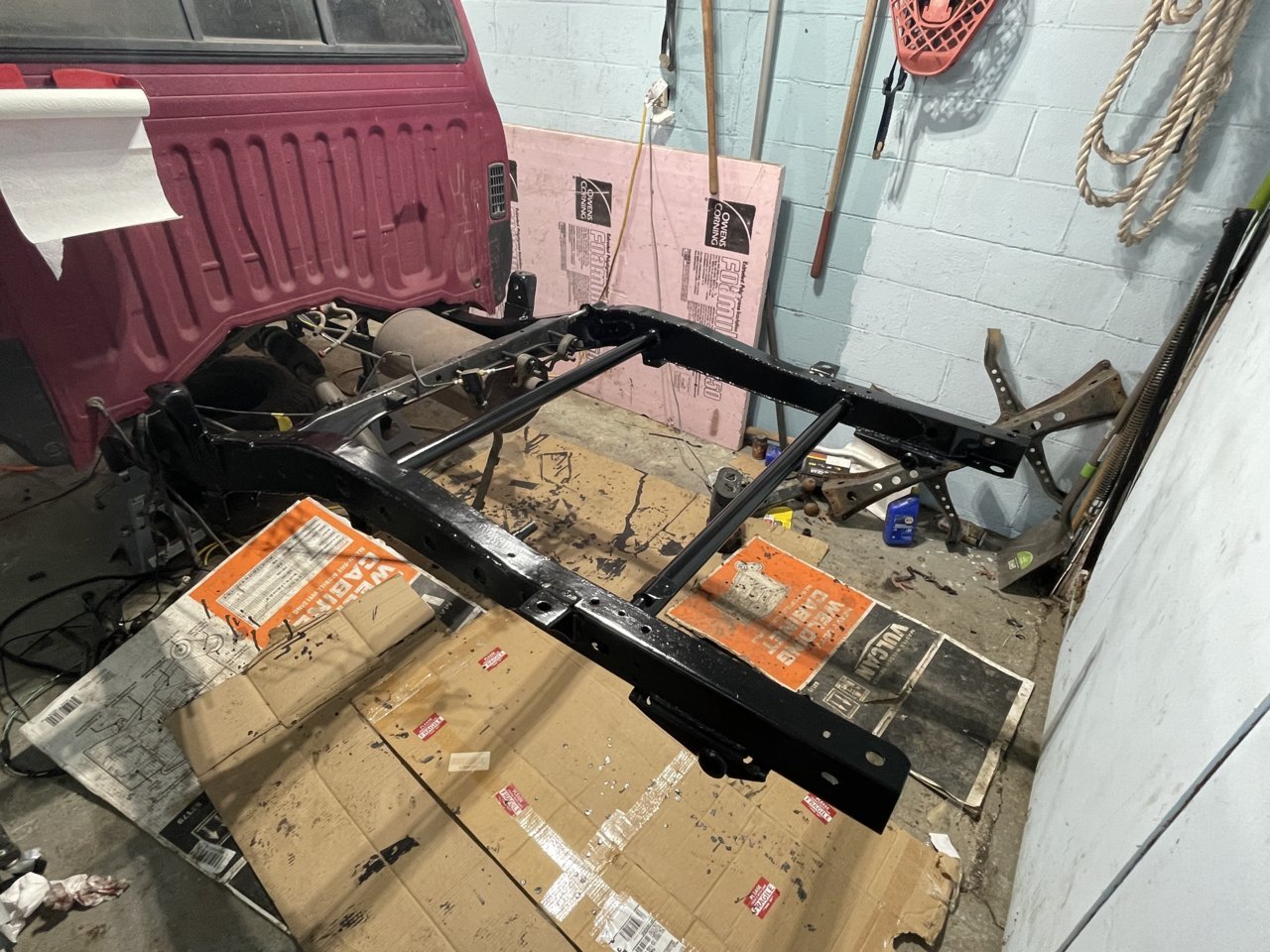

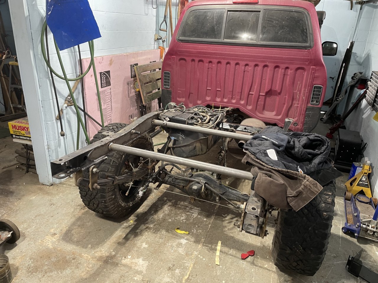

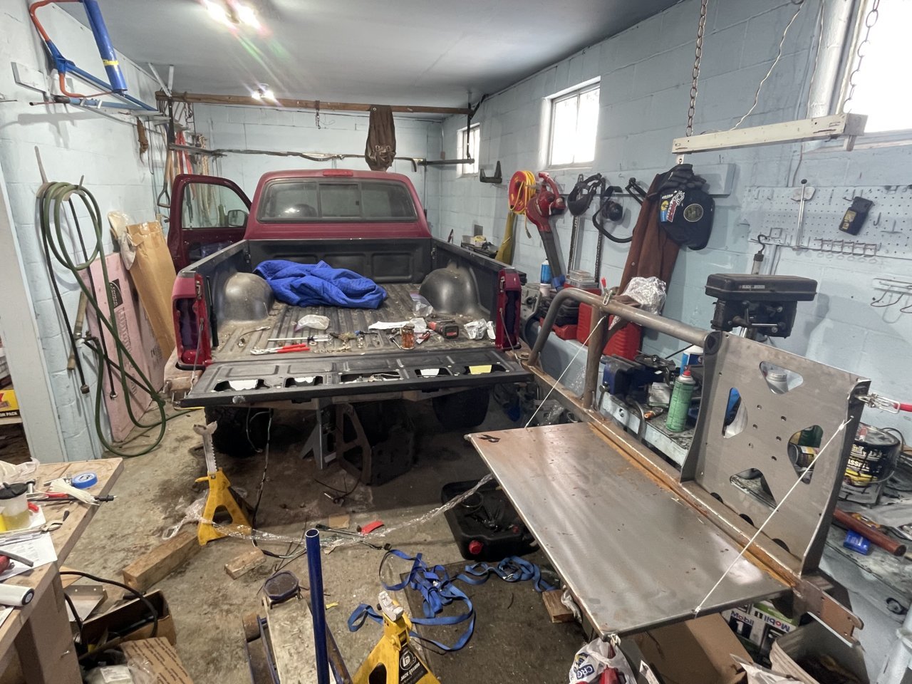

    Been gone from Tacoma World for a minute, but I started working on my Tacoma again after not having any time this summer.
    List of accomplished tasks this past month:
    -painted the back half of frame after trail gear kits install and rust correction
    -Tundra brakes
    -ABS delete and custom brake lines/manual proportioning valve
    -ES body mounts
    -Wiring harness for twin compressor and air locker
    -Vinyl floor (mostly done)
    -Patched the wiring harness for the tail lights that was ripped apart during the wreck
    Next month, I’ll have to finish fitting the bed to the body. One of the bed mounts is tweaked and I’ll need to drill it out to square the bed. I’ll pull the bumper off and raptor it and run my stock bumper until that’s all dealt with.
    1B6F23E6-2E28-4A9A-AC58-F5451E7AF20C.jpg BBECD608-B462-433F-ADC1-E6C460968511.jpg 0C68DC40-FFC0-41D6-BBE1-DB552BBF4CAD.jpgE5078D98-0F5F-4127-BAA0-668E53667129.jpg760F7963-6E01-4358-8655-046AC17832B7.jpg3AEBD670-E757-4C35-93D2-C0E41B19E417.jpg

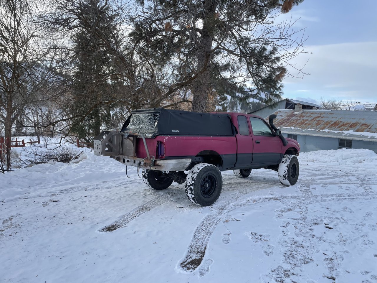

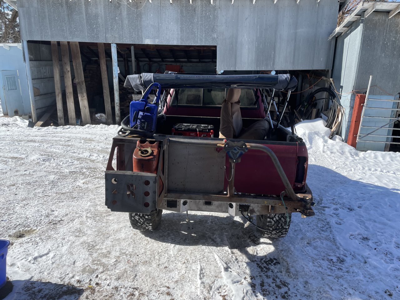

    Had to get it outside for a couple of pics.5C88305A-54B5-4728-B3C2-45DB3CF62DE5.jpgCDE38178-971F-4055-A783-C7084F44921C.jpg
    Trying to figure out where the chainsaw will be mounted.90DAB0F6-6278-4742-B765-F1064BA037C5.jpg
    Headed back for my work rotation tomorrow. Maybe a week worth of messing around with it before it’s ready to be back in the fleet of drivable vehicles. Will still have lots to do after it’s drivable, but I’ll be happy to get to use it again.

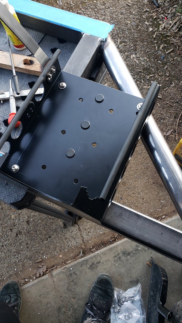

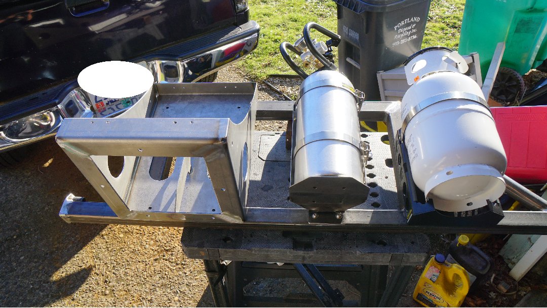

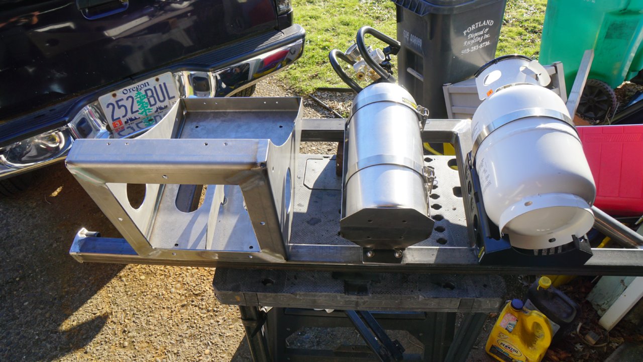

    Just been reading and lurking ... have done a few things, but recently designed the mounting for my CO2 and propane tanks for the 4xInnovations swing out.
    Both tanks mounted using PowerTank brackets:
    I was able to just drill and tap the swing out for the propane mount:

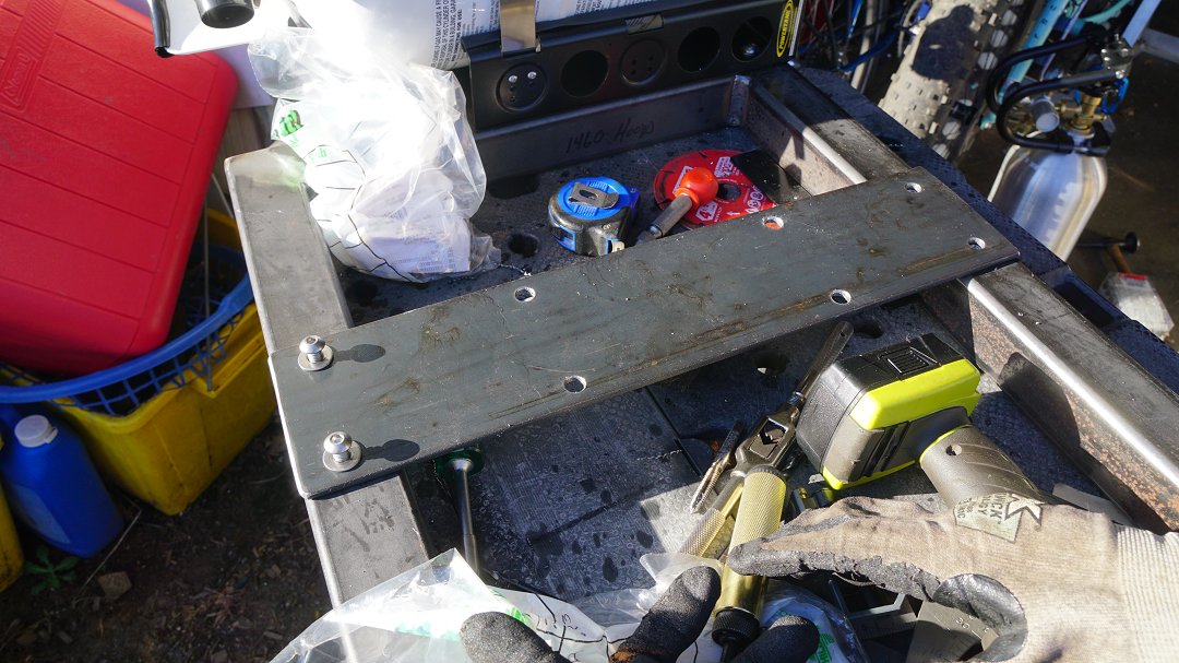

    I used 3/16" flat bar for the CO2 bracket:
    Now, just need to do some finish and prep work on the bumper and swing out.

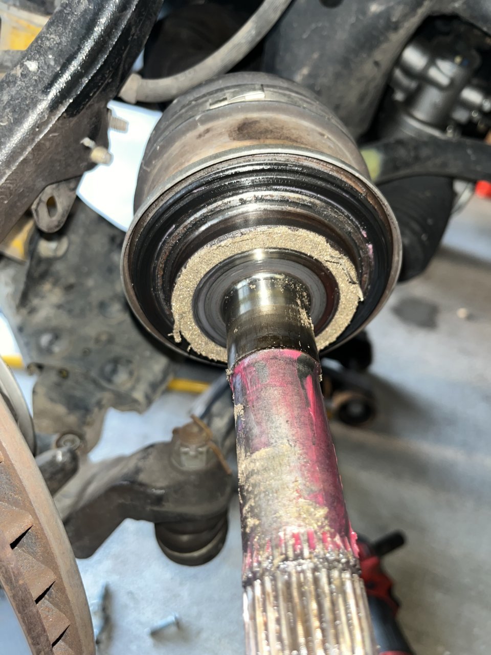

    Okay so less than 15k on the seals and bearing, my theory was a clogged breather blew the seal out (was in a heavy snow storm and figured water got in and froze it). Took it apart tonight and the seal came out with the axle. Pretty much confirms my suspicions I think? Thoughts?

    Thats pretty ridiculous for a chain. When mine was slipping I just picked up one from a junkyard. Figured its pretty rare these have any issues.
    Can you push it back in by hand? Maybe use some sleeve retainer on install.

    Are you thinking that with the plugged breather, the pressure change from running on the highway blew the whole seal out? That would be pretty crazy, but if the pressure is high enough and the seal isn’t compromised, it could be possible, I guess. I just remember it taking a good amount of force to drive that thing into the housing.
    Like Ryan said, if it’s intact, you could use some Loctite 680 retaining compound next time. It’s pretty serious stuff.
    Loctite 1835201 Green 680 Retaining Compound, 50 mL Bottle https://www.amazon.com/dp/B00KC541DA

    Green loctite I reserve for pressure vessel threads and the oil filters of my enemies... that stuff is no joke.

    Yeah, we use it for shit that we REALLY don’t want to move.
    Ever.
    I’m honestly kind of shocked that the seal vacated the housing like that. Mine required more than a little persuasion to install.
