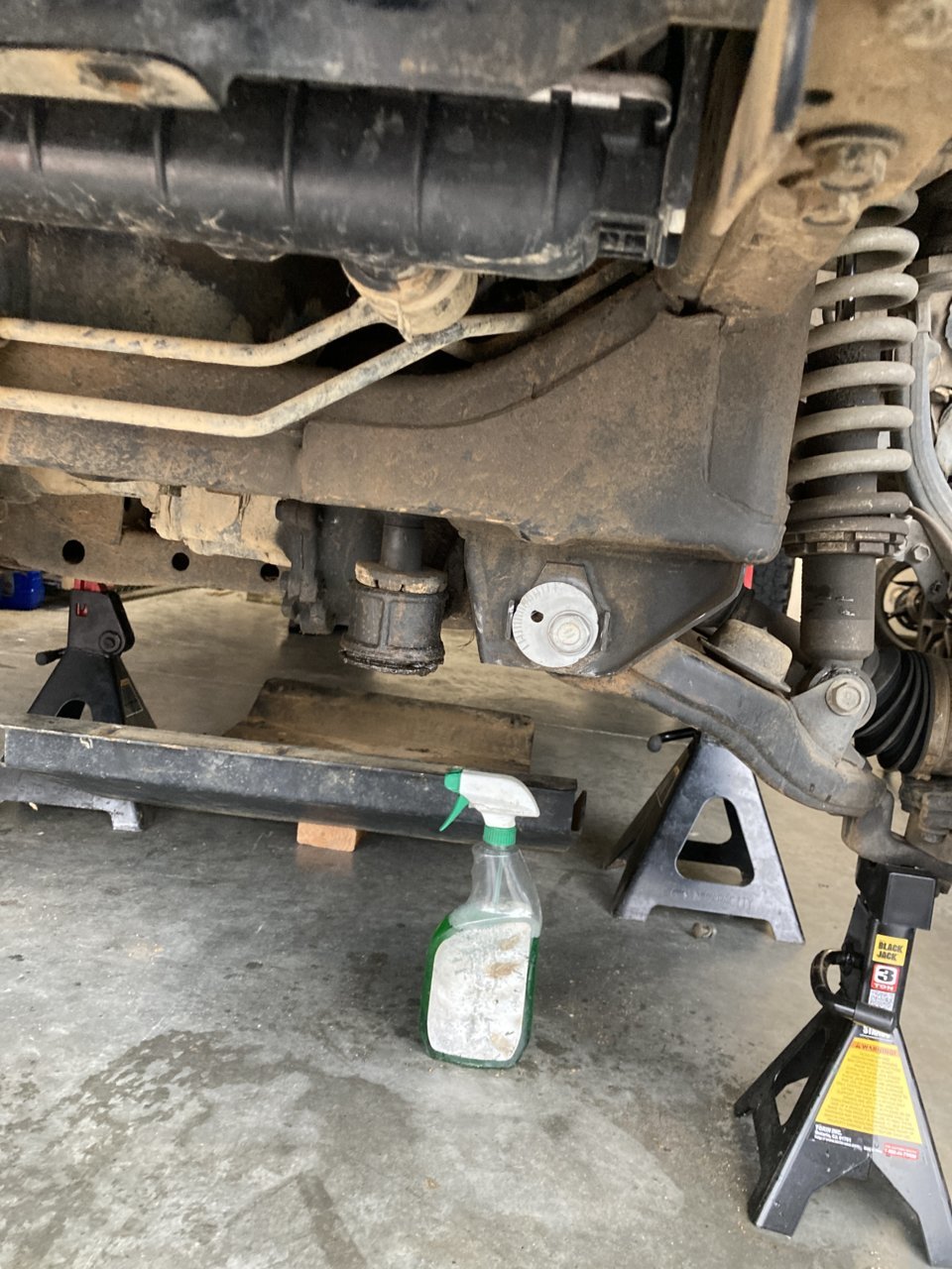

    I haven’t tried yet tbh, was focused on cleaning it all and strategizing my plan to make sure the bearing can be saved.
    yeah same here. So much so that when I finished for the night I instinctively put the new seal in the freezer to make install easier when I go back at it sunday. so I am doubtful it was loosey goosey in there. :notsure:

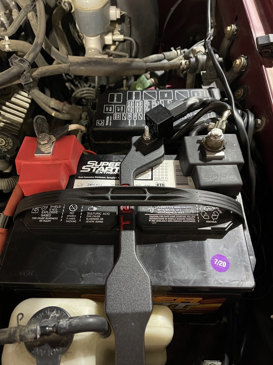

    Tried to clean up the battery terminals, not thrilled with the negative, will work on that later.

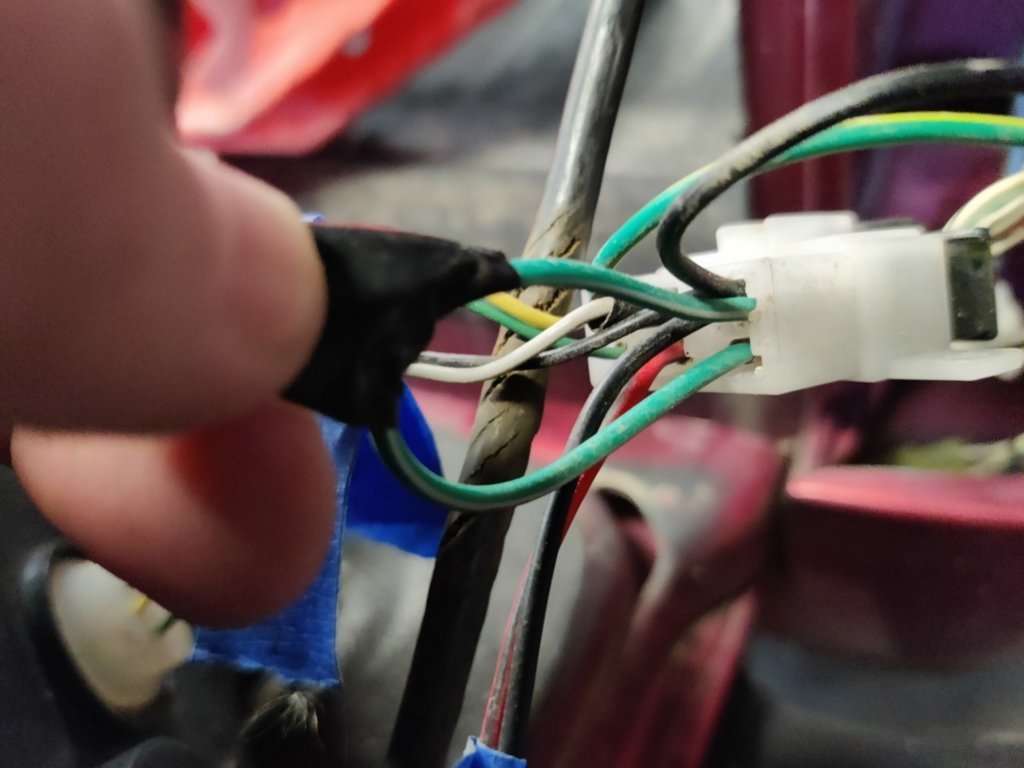

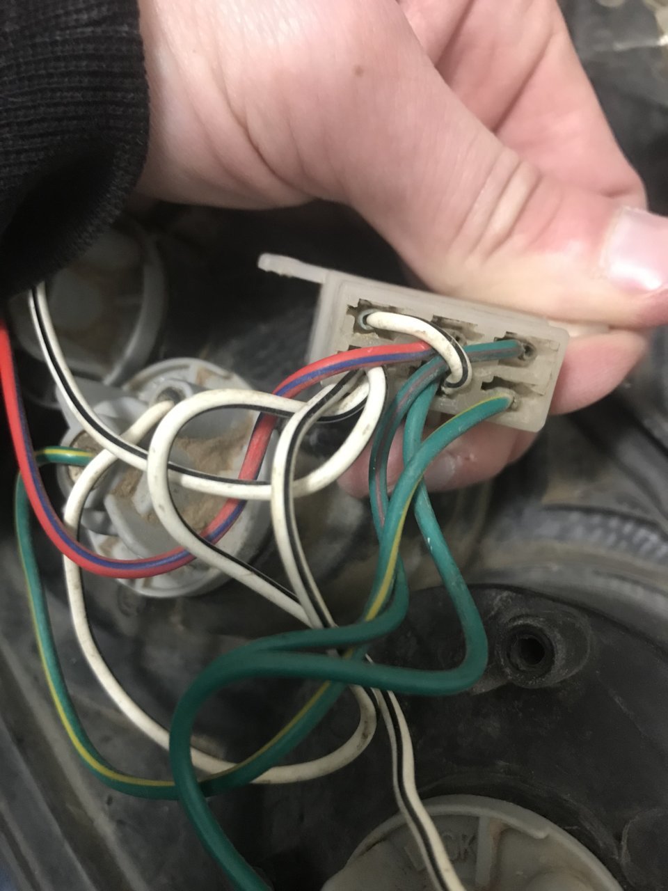

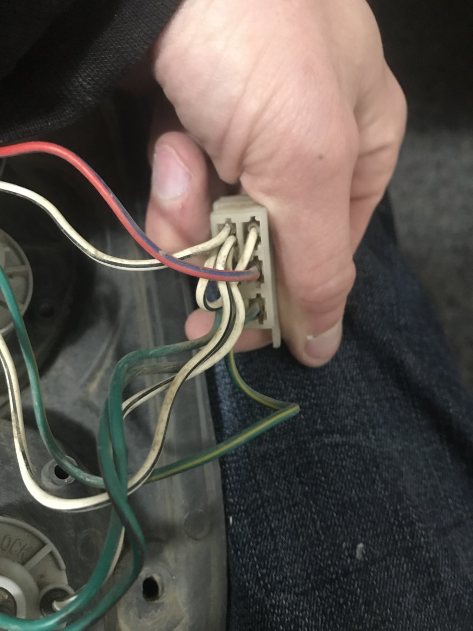

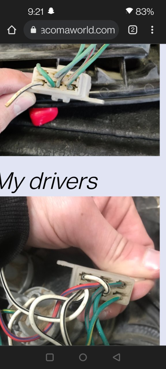

    Okay, I’ve been having problem with my passenger tail light, doesn’t work when plugged into the passenger side, does when plugged into the drivers side. @unstpible had to change some wiring on his taillights to get the 95-00 light to work on his 01-04. So I tried to copy what he did as seen below, but still not luck. Any ideas?

    When I was repairing my tail light harness, I found that the driver side tail light had a jumper on the running light circuit on the tail light side of the connector. Running light power wouldn’t get from the driver to the passenger side or the license plate lights without the driver side light plugged in.

    Might be worth taking the harness loose, getting the ends together and pinning everything out with a multimeter if the new tail lights don’t fix it. It took me a solid hour with a multimeter to figure out what the hell was going on after I plugged in my passenger side light and had nothing.

    Take another look at my drivers plug and your drivers plug. One of them is inverted.

    They say it’s non serviceable, let’s see how accurate that is.
