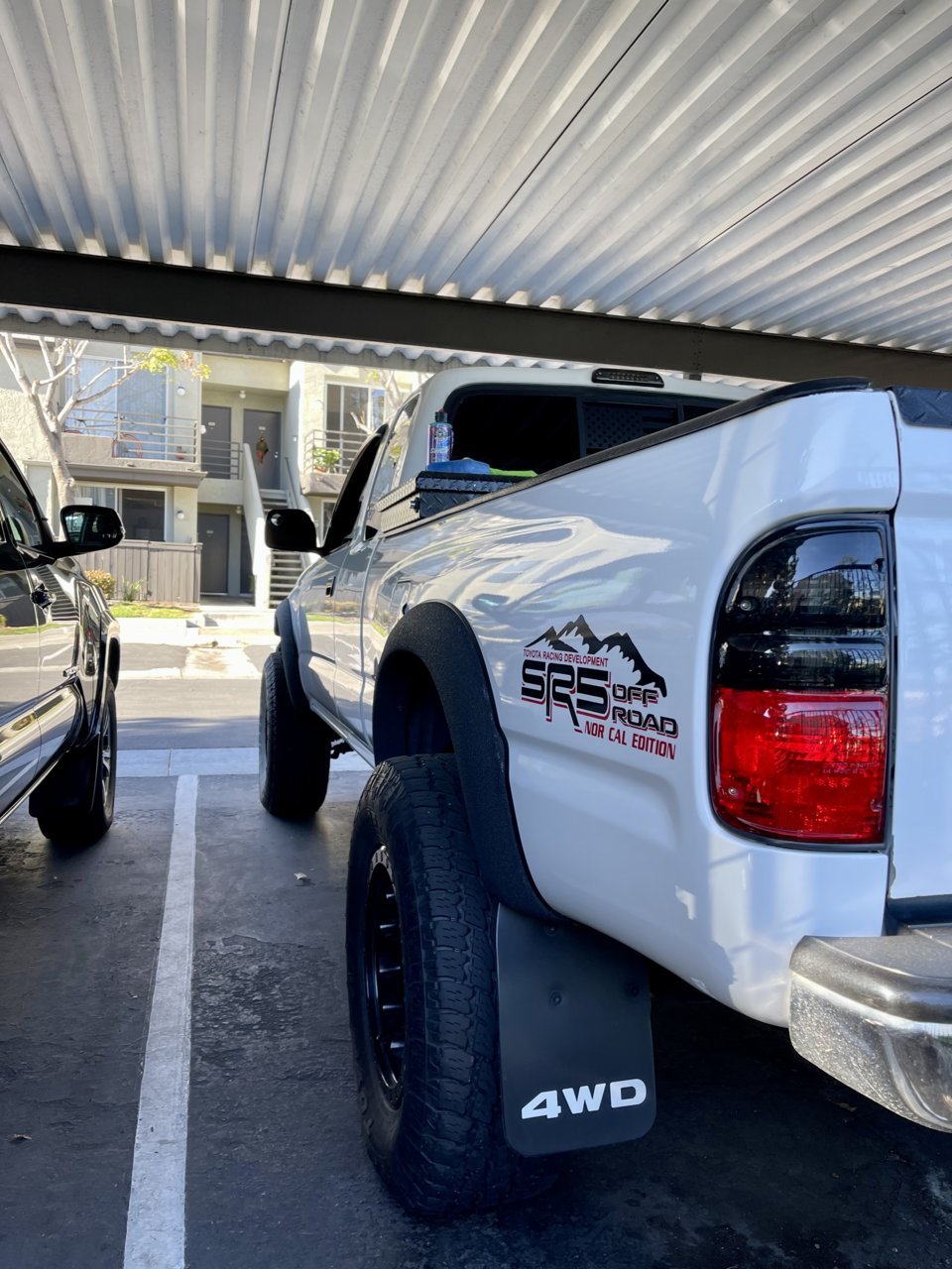

    Ceramic wax today. Sealant and carnauba wax tomorrow. Also planning on borrowing a throttle body from a fellow TW member tomorrow so I can send mine into MaxBore.

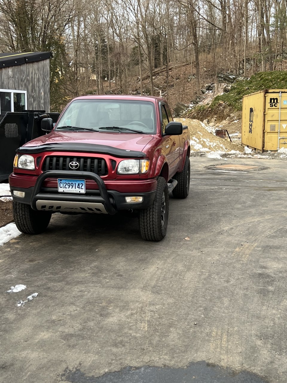

    Good looking impulse red ride

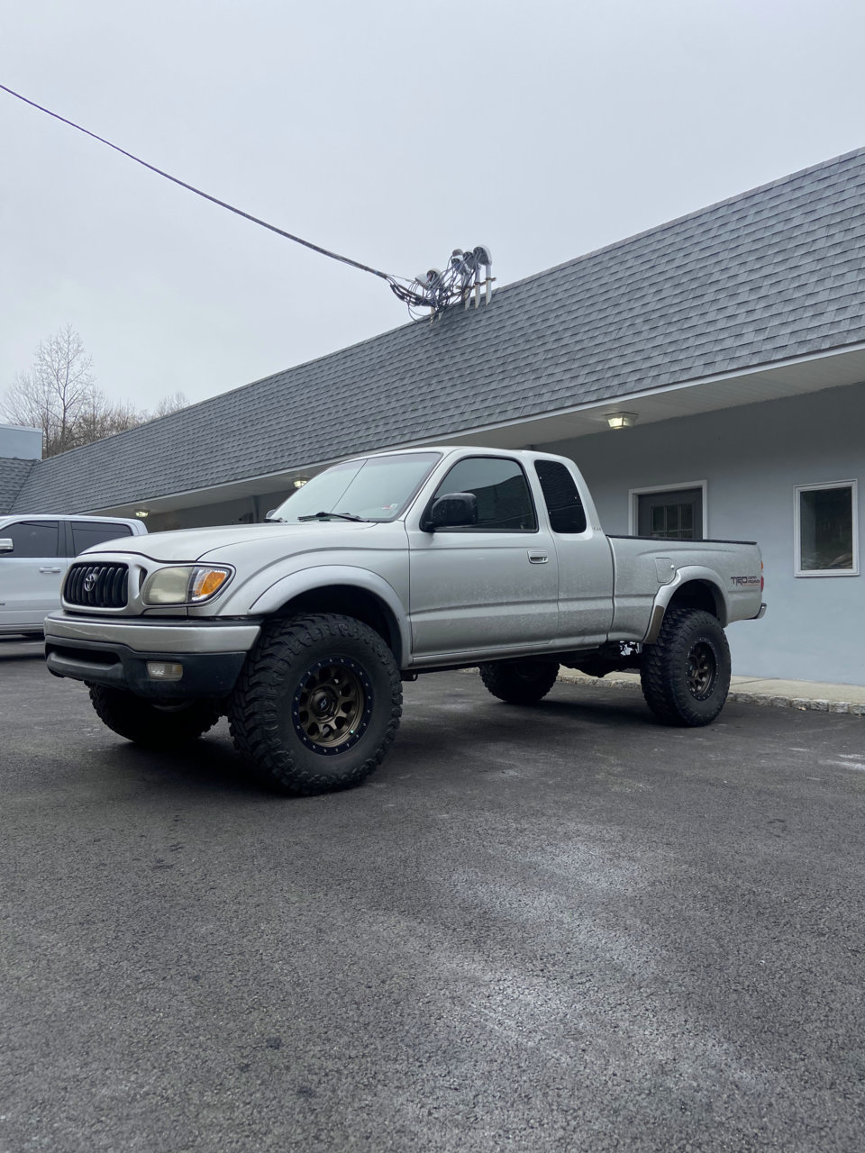

    a little wheel swaparoo.

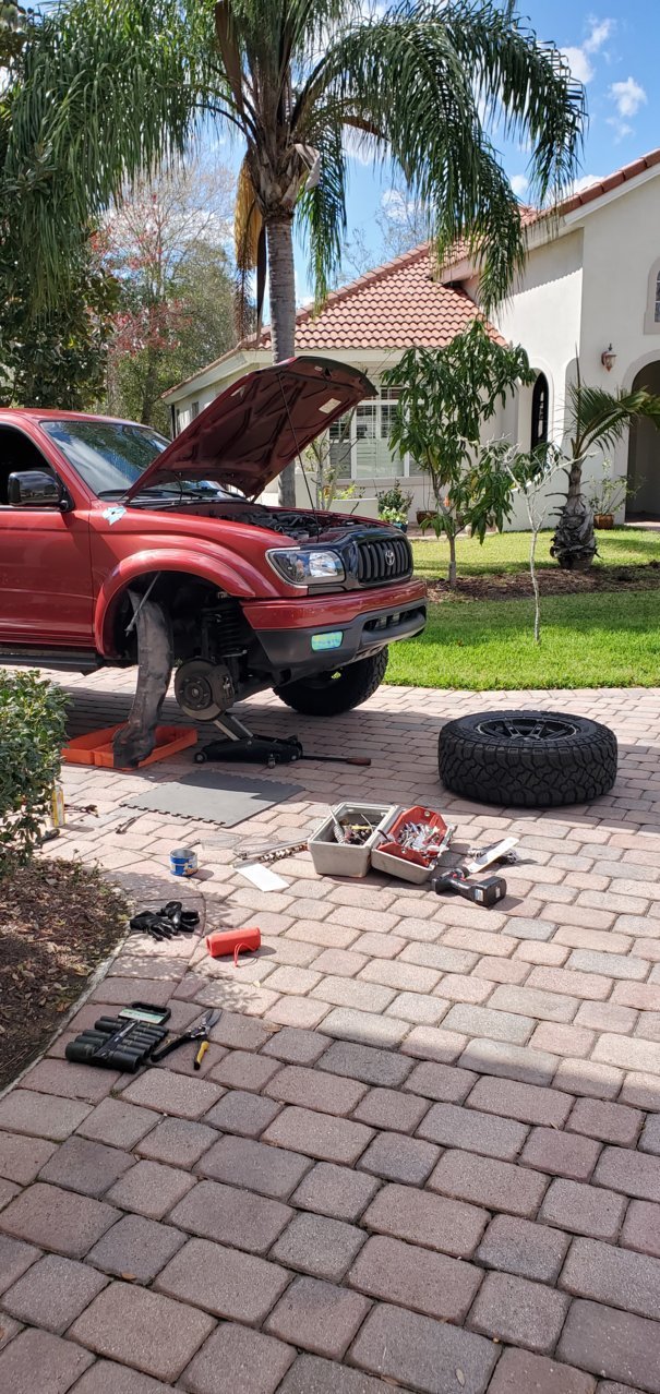

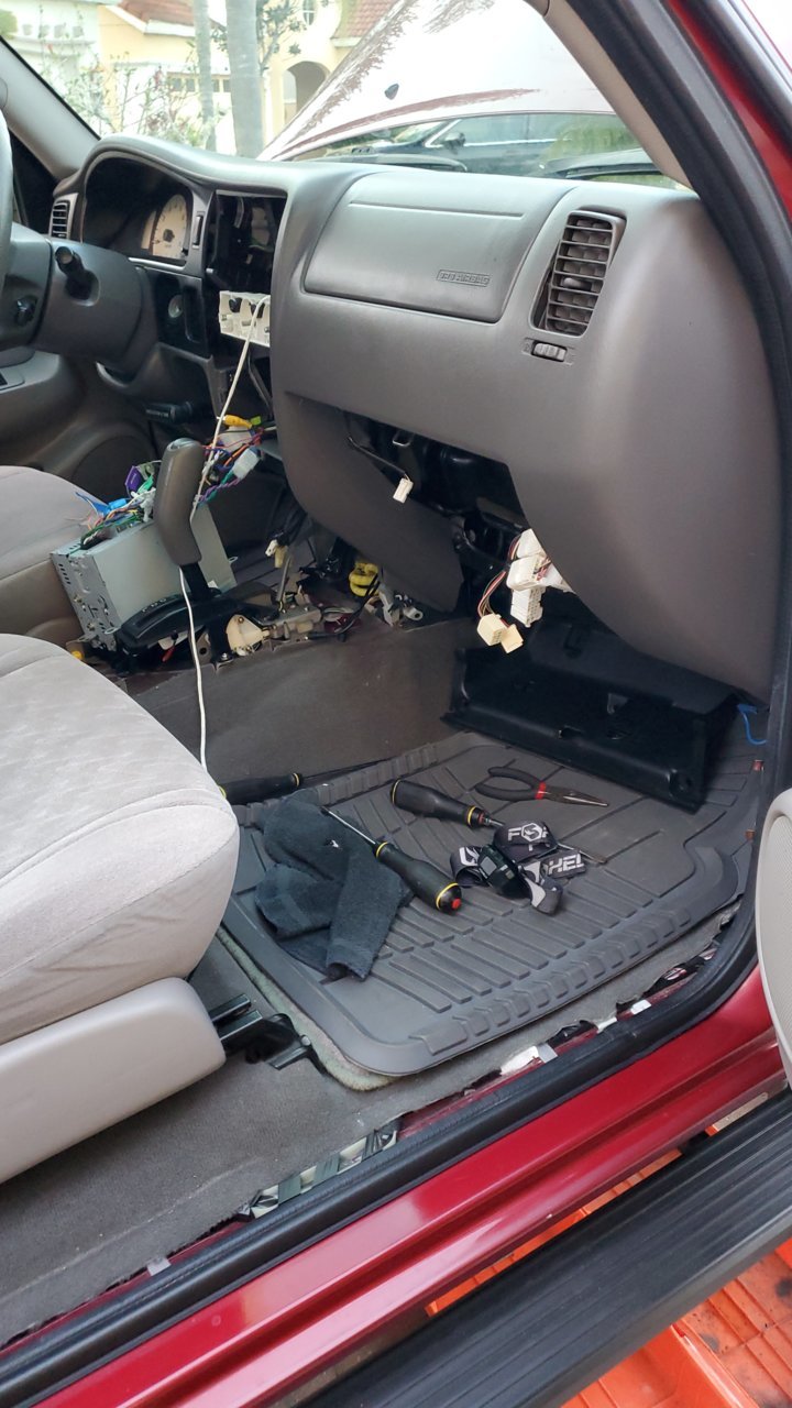

    Finally got some time to work on my truck. On the list of things the truck needs was a new antenna and I figured that would be a quick and easy start. Normally I'm a big fan of Toyota over-engineering but didn't expect I'd have to take half the truck apart to get the antenna out

    I spy some Kendas! How do you like them? What size? I’m planning on getting those hopefully soon.

    They are 265/70 R17 RT. I didn't pick them but have been pleasantly surprised by them. Bought the truck down in Miami and drove it back to Orlando, road noise wasn't bad at all and ride smoother than I would have thought. Running 33psi in them for road. Haven't played in the dirt with them yet.

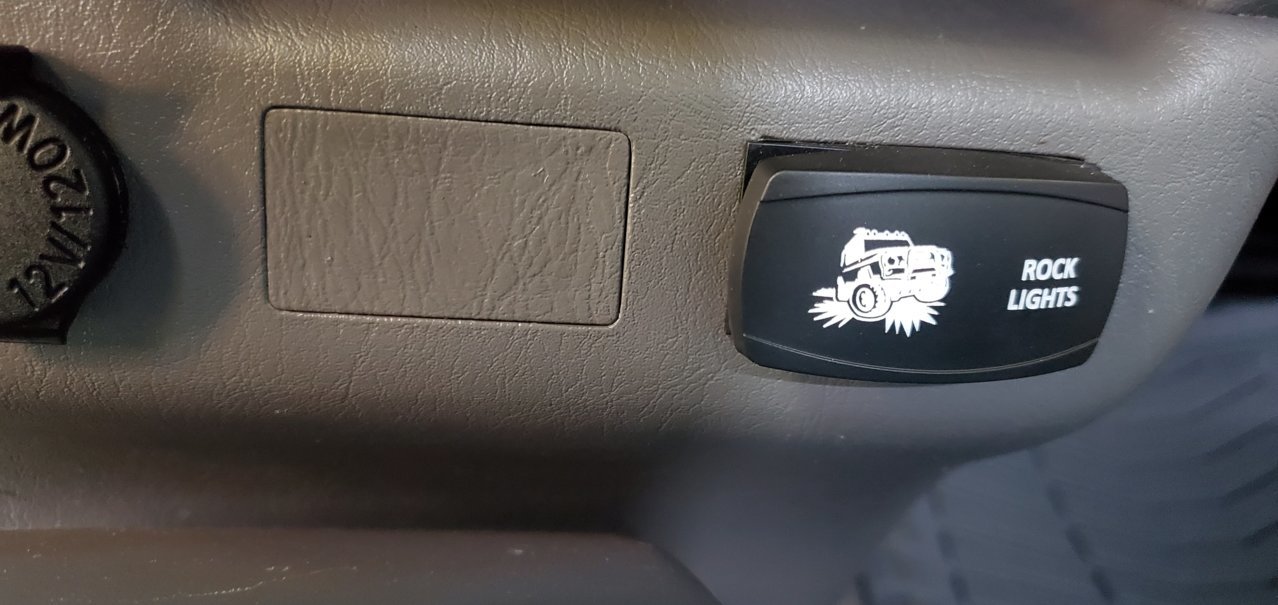

    Still to be determined. Had to order a new one and still waiting for it to arrive so put the truck back together and will do it again when it arrives. On the positive side getting more familiar with trucks history. Found that a/c blower motor has been replaced and that rock lights were wired to the head unit so taking advantage to rewire them to rocker switch. Shout out to TW which reminded ne to run a string when I finally got the cable free of all the clips and pulled it.

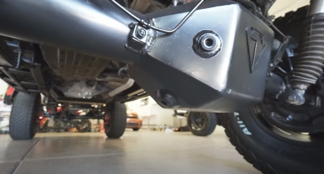

    Well, I haven't done anything yet, per-se, but this just showed up... Can't say I'm all that happy with the packaging or how long it took to arrive, but at least my existing housing has been going strong with the patch.
    Now to find some time to finish fabbing up everything that needs fabbing, and getting it mounted. Too bad I don't have a Zane-sized shop. @Speedytech7
    A few questions I suppose while I'm posting...
    1. For moving the rear diff over to the new housing - is that just a "bolt-in" process (with new sealant of course), or am I going to need to do adjustments/shimming/something?
    2. I think that as far as alignment of the housing goes, that I want to get the truck at its normal resting height (as much as possible) and then get the rear drive shaft (and all the u-joints) to be as straight into the diff as possible, yes? As in, tilt it up so that the u-joints have as little angle as possible.
    3. Once I have the orientation of the housing set, then I glue on the spring perches so they are level? Of should they tilt forward or back a bit to counter axle wrap?

    If nothing else, it looks absolutely rad.

    It's less Tacoma and more mod
    Diff should just bolt in as is... can glue or gasket it. I would take a measurement with the truck on the ground and see what angle your existing pinion flange is at, then set the new perches on the new axle and snug it up on the truck unwelded and knock it into position to match the pinion angle and lateral centering. Then tack
    Depending on when you do it, you are always welcome in the new shop, but I'm not done moving things just yet.

    I would do a 'diff stud elimination' while you're at it.
    I.E. on all the shorter studs, replace with a grade 10.9 button head run in from the back side. You'll need to reuse the longer studs around the elocker actuator. Use a normal bolt on the bottom as a drain as it looks like you don't have one anymore (good call).
    There's a good picture somewhere about what angle you want your pinion to be at with our double carden driveshafts. Need to try to find it.

    is the advantage of that just that the bolts are stronger than the studs?
    I have seen some guys weld in a plug on the bottom of the diamond housing kind of off to the side off of the flat bottom since it doesn't come with one. Doesn't stick out nearly as much as the one on the OEM housing
