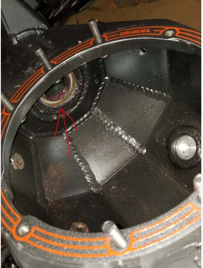

    Thanks for all this. Some questions/observations:
    Diamonds come with uninstalled inner 3rd member seals (one of many benefits) it'll keep fluid in the center section and out of the tubes, should of came in a small bag with misc hardware.
    [turbodb]: I didn't get any seals in the hardware package. Just the studs, u-bolts (and plates), and leaf perches. I also don't really see where inner seals would mount in the housing, but if you're saying I should have them (?), I'll reach out to FROR.
    Might as well grab a union fitting and new breather if you dont have the diff breather extension mod already.
    [turbodb]: Rear diff breather is relocated, and I'll definitely be moving that over.
    Mentioned already, recommend diff stud eliminator. Use min 10.9grade, as you want to benefit from the clamping force of the 3rd member to that flush 1/2" mounting flange on the diamond. This will prevent 3rd member flex/pull under extreme load. Also grab 1 or 2 heavy duty small magnets to add. One at the bottom of the diff and jb weld one on the fill plug.
    [turbodb]: I'd love to see a write-up on this somewhere so I can better understand. Certainly something I want to do. Fill plug has a magnet already, but it's a good idea to add another one to the bottom.
    You'll need spring perches, axle housing is 3.5 O.D. which puts you in the same category perches as 14bolts. Check out ruffstuff or similar and get a set of longer than factory lenth perches to combat axle wrap and multi drilled center pin holes for alignment. Also with that, get proper U bolts and corresponding u bolt plates. Shock mounts too…
    [turbodb]: Yep, already have my shock mounts from ruff stuff and using their leaf perches on my (patched) OEM housing. I actually like their longer perches than what came with Diamond, so may pick up more...
    Pinion should point to the end of the 1st section of your rear driveshaft. Pinion angle/Driveshaft slope should be compensated 1-3* degrees higher than pinion angle to compensate for pinion upwards rotation and keeps u joints with constant pressure instead of spinning inside the cups. Temporarily tighten u bolts and plates to unwelded spring perch mounts on the axle and set vehicle weight on the suspension/axle. Then you’ll rotate pinion up until pinion is pointed at rear 1st section of rear driveshaft (c.b. Hanger). You’ll then need an angle finder an compensate an additional 1-3*. This will get your pinion angle/ driveshaft slope at ride height. Tack weld your perches at this point. Unbolt, then fully weld
    [turbodb]: thanks, this is great info!

    Write up:
    Remove diff studs. Replace with bolt. Install from the inside of the housing with loctite. :D
