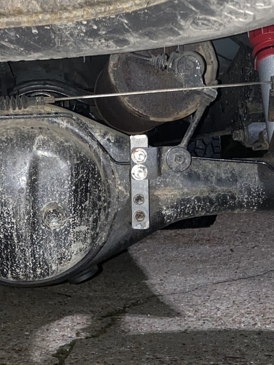

    6E76632E-5049-4117-B2A2-C6002166FBEA.jpg 5BD23CF6-BA3D-4292-9B98-AA85A5F498A8.jpg Finished up making the emergency brake brackets and installing them to get the cable off the leaf springs.

    There it is.
    That’s what I was looking for :rofl:

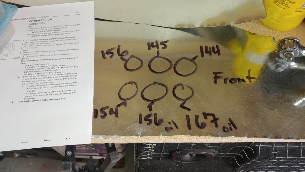

    Guess we're alright... Just barely

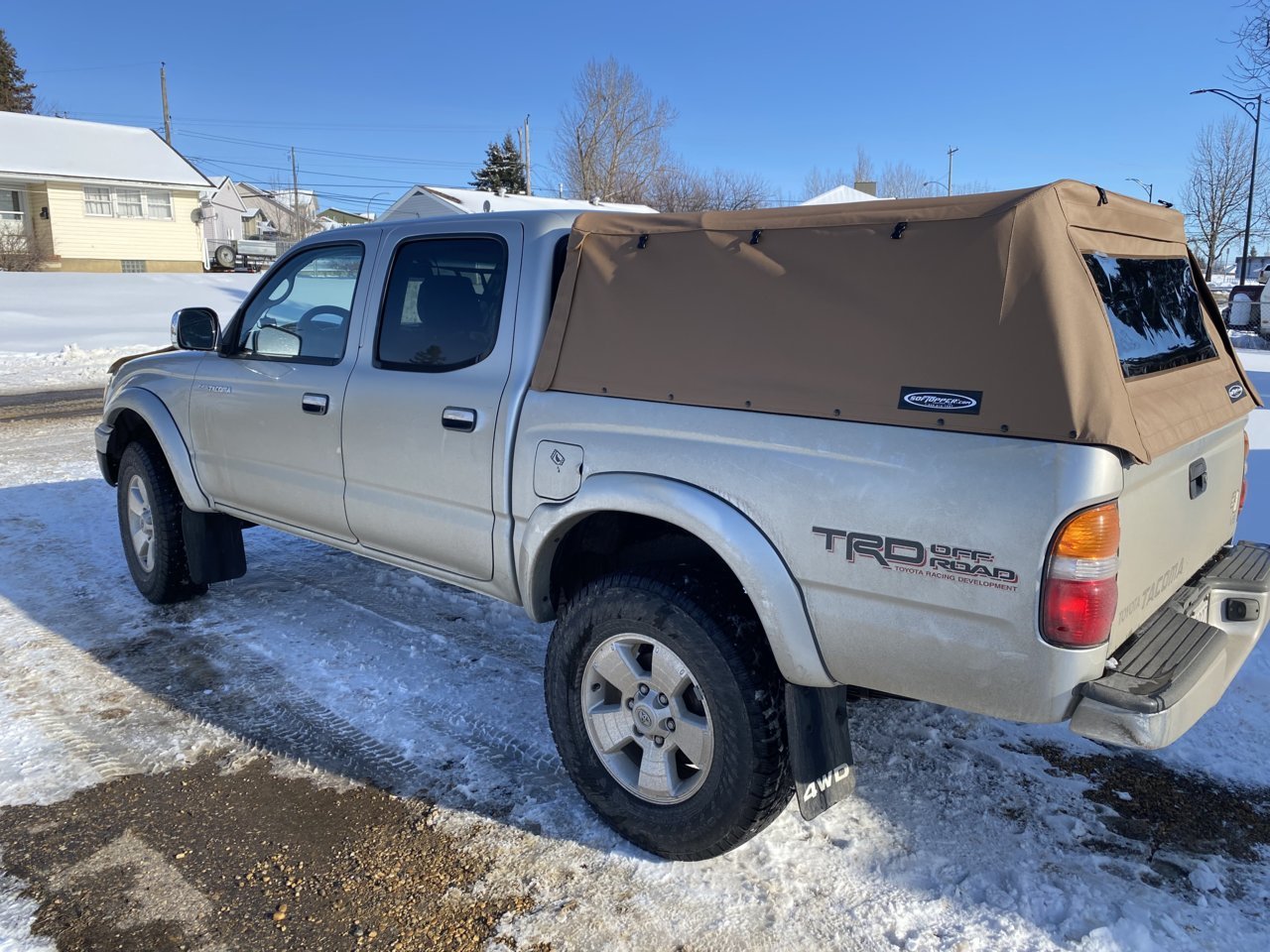

    Put on a new soft topper

    Not great. #2 is a little under spec, and I typically look for all cylinders to be within 10% (or 15 psi per the FSM). From #1 to #2 and #4 are outside of that as well. Did you try putting a little oil in those two cylinders?

    Passenger side valves are mostly in spec, with only 2 exhaust valves (same cylinder) gap too large by 0.003 - 0.004mm, so just going to leave it. I'll assume the other side is ok as well.
    So cylinder pressure a little low, valves ok, now just to check timings. Running out of hope for my fuel economy problem.

    I always forget how these are numbered.. 145 - 174PSI is spec, was really checking my valves but good to know rings could do for a replacement I guess.
