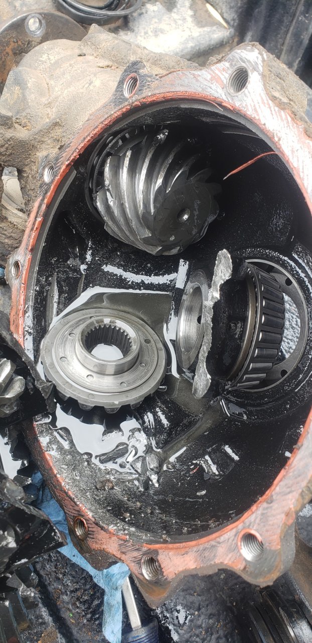

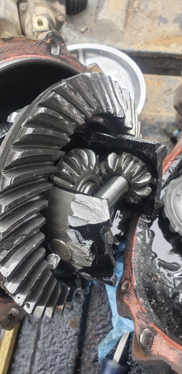

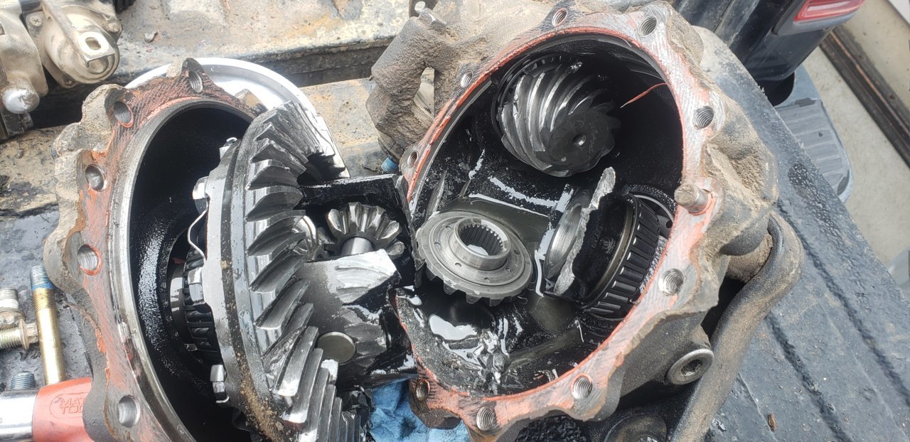

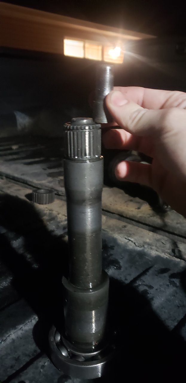

    Figured out why 4wd wasn't working. Surprised the little stub shaft survived.20220305_104425.jpg 20220305_104419.jpg 20220303_191906.jpg 20220305_104417.jpg

    Holy shit that's impressive haha

    I was expecting a ring and pinion, but not the carrier itself. Sad part is it didn't even happen on anything cool, just a small hill.

    mine didn't even do that when my pinion go sucked into the diff. Ate a big chunk out of the carrier but didn't break it. crazy.

    Did your front wheels spin after it happened? I feel like they would have locked up completely.

    No spining after. But I did notice some binding in reverse only when in 4wd later at home. I was able to still drive the truck normally in 2wd for a few weeks while I had a spare diff mailed in.
    When I took the diff out the drivers side L bracket was loose which I'm sure contributed to the destruction of the diff. That and many years of hard abuse.
