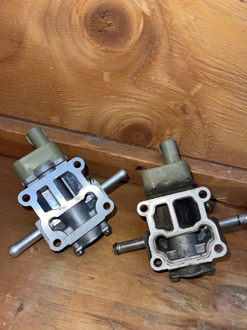

    We pulled the throttle body and pulled the IACV now.
    The IACV is really dirty with carbon deposits. The throttle body is pretty gummy too.
    We're on our way to O'Reilly to see if we can get an IACV gasket and throttle mounting gasket, for now... to be replaced again (OEM) when we do the valve covers (relatively soon).

    Throughly cleaned TB and IACV (also tested IACV that's it's operating).
    Put everything back together and it fired right up. At a lower RPM (was idling at about 1700 before we did this).
    When it warmed up, the RPMs started climbing again. We shut it off, waited a few minutes, tried to crank it...
    Doing the same fucking thing it was doing before.
    I've seen a few write ups about leaking injectors. I have never seen a fast idle listed as a symptom. Rough idle, hard start when engine is hot, but not specically fast idle.
    Not saying this is not the problem, saying I'm wondering if I'm dealing with multiple problems.
