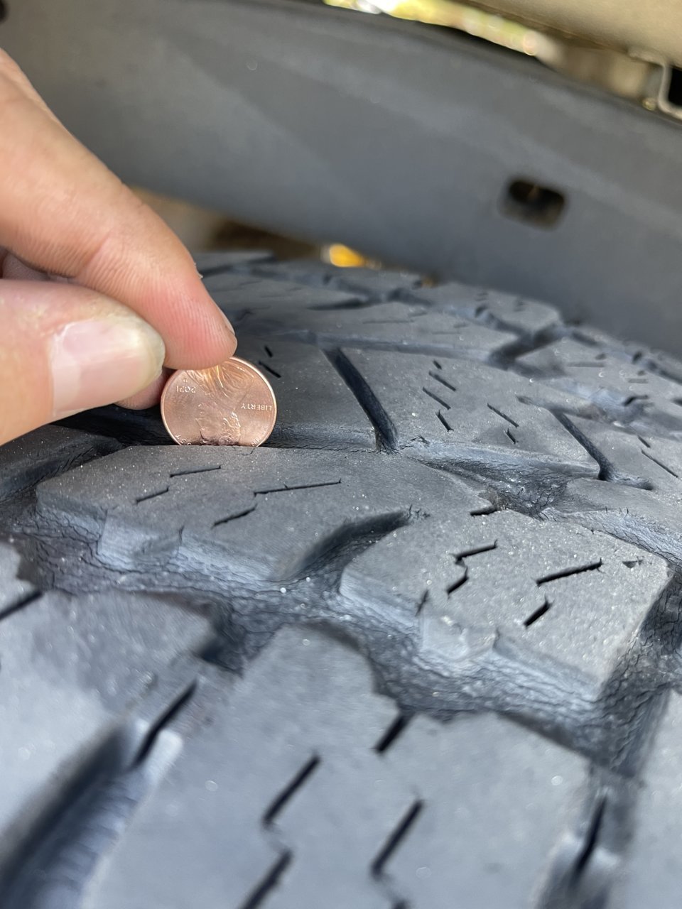

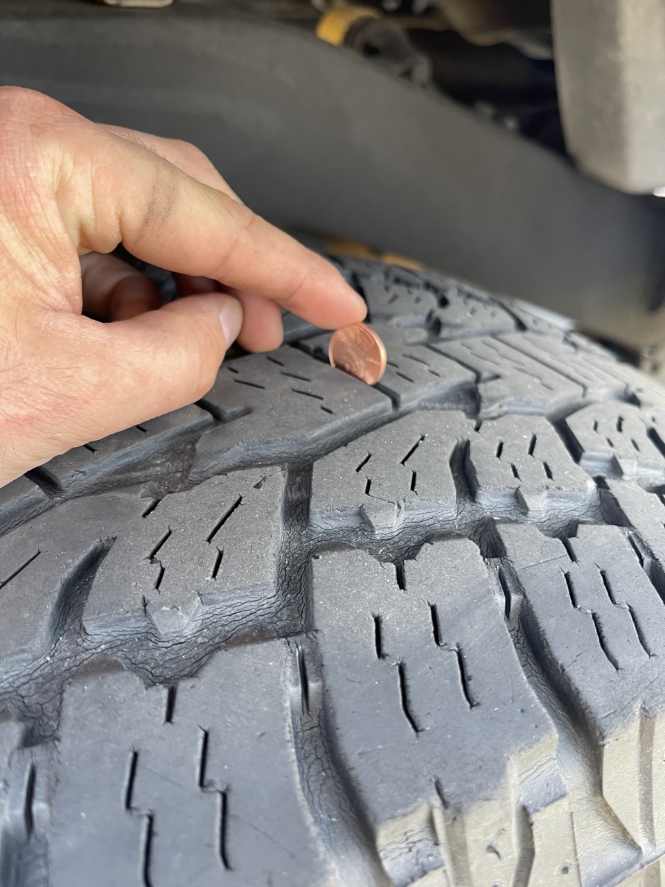

  10. Mar 7, 2022 at 1:02 PM
    Logans2001
    Logans2001 What’s crackin’
    Jan 23, 2016
    #175792
    1,981
    San Diego, CA
    2001 v6 4WD auto
    Are we do for new rubber? o_O
    I don’t see a point in waiting till they’re bald like some people do.
  11. Mar 7, 2022 at 1:44 PM
    Dan8906
    Dan8906 Well-Known Member
    Jul 26, 2016
    #192977
    5,151
    Daniel
    Concord, California
    2004 Tacoma ext cab TRD 4x4
    CBI sliders, ADS extend travel with compression adjuster coil overs, 9” Bilstein 5125 rear shocks, Icon Tubular UCA, Alcan custom leafs, All Pro Apex bumper and skids, NWTI rear diy bumper, 295/70/17 Cooper St Maxxs and nitro 4.88s.
    Yes definitely ready for new tires! I swear ko2s won’t wear past that point, the rubber just gets super hard and cracked from age. Yours seems to be doing that.

  12. Mar 7, 2022 at 2:08 PM
    ijm01PR
    ijm01PR Well-Known Member
    Aug 10, 2021
    #373703
    332
    Alex
    Indiana
    01 DC Prerunner (4x4 TBD)
    Ome 881s w/ 5100s and jba ucas 2” pro comp AAL with 5100s in the rear
    Yup. How many miles did you get out of them? They nittos?
    Logans2001[QUOTED] likes this.
  13. Mar 7, 2022 at 2:21 PM
    Logans2001
    Jan 23, 2016
    #175792
    1,981
    San Diego, CA
    2001 v6 4WD auto
    For some reason the receipt I got from les schwab didn’t have the miles from when installed so I’m not entirely sure. They’ve been for 4 years tho. Toyo AT2s
  14. Mar 7, 2022 at 2:48 PM
    JKO1998
    JKO1998 Well-Known Member
    Jun 2, 2015
    #156578
    53,131
    Utah
    I wonder what it’s like to have a set a tires last 4 years
    unstpible, DashMaple and Lil Puke like this.
  15. Mar 7, 2022 at 3:19 PM
    ijm01PR
    Aug 10, 2021
    #373703
    332
    Alex
    Indiana
    4 years. Wow. At the rate I’m driving I’ll be about at 4 years
  16. Mar 7, 2022 at 3:23 PM
    Logans2001
    Jan 23, 2016
    #175792
    1,981
    San Diego, CA
    2001 v6 4WD auto
    Ya and this is my daily. Probably held up this long cus I’ve rotated them religiously every 5k with oil changes.
