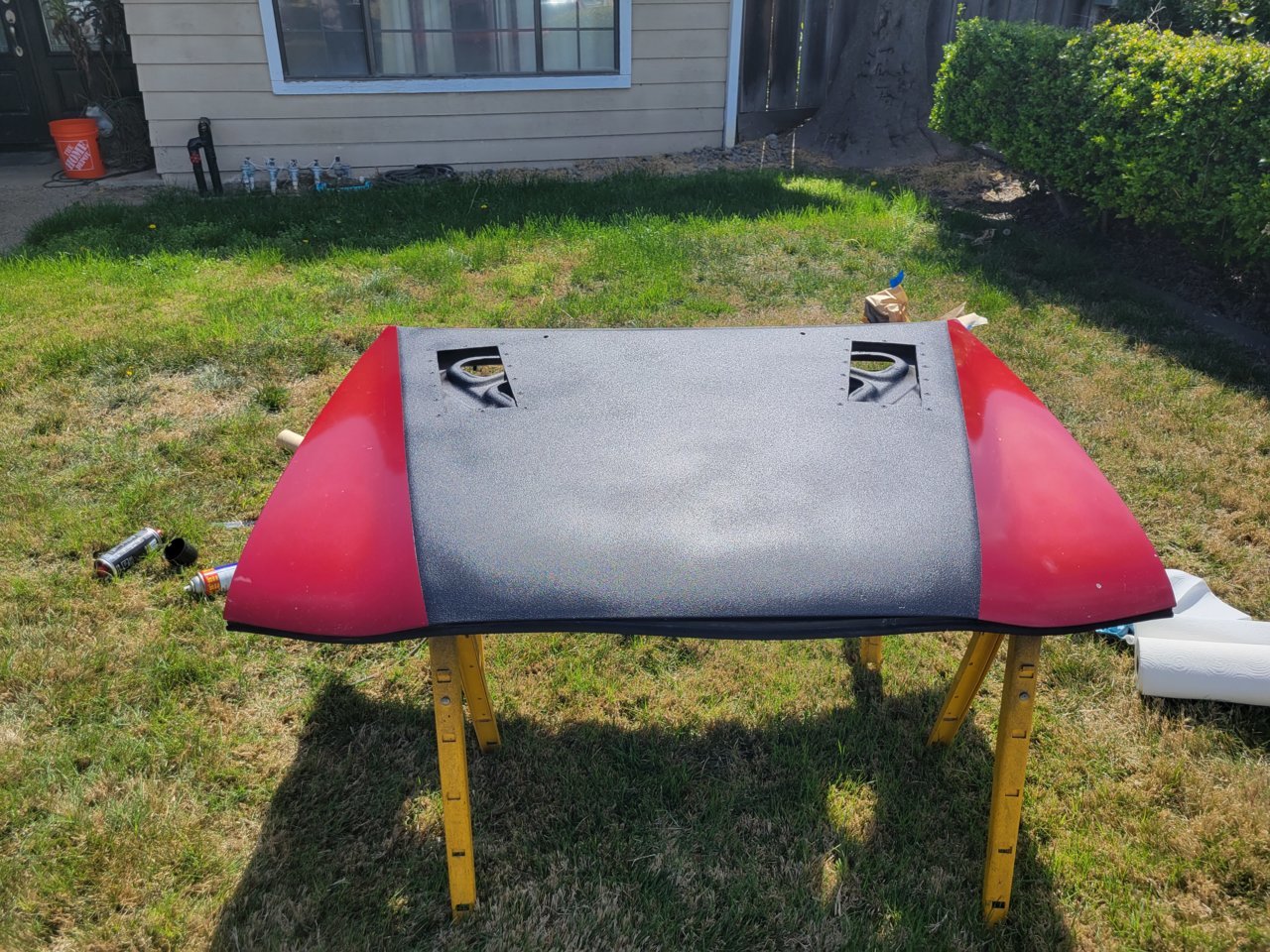

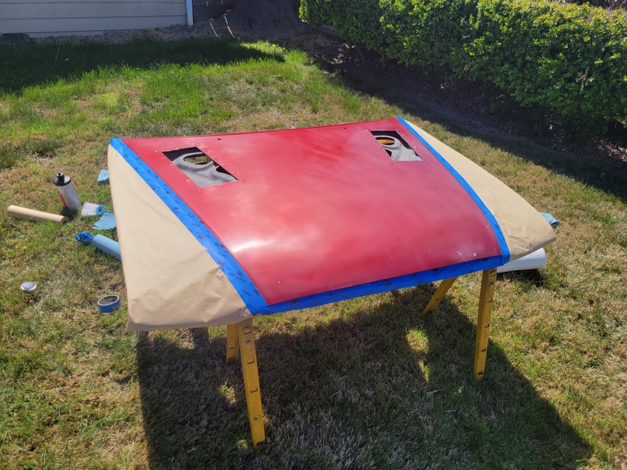

    If you don't have heat shield under your hood, this is what happens to vinyl after a year and a half, or so.
    Wasn't cheap vinyl either. It was top shelf 3M vinyl.
    So... to fix this... I yanked my hood back off, peeled the vinyl off and hit it with an entire can of Raptor Liner.
    It wont be shrinking again lol.

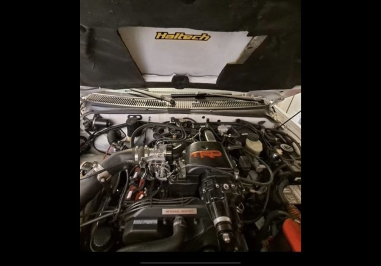

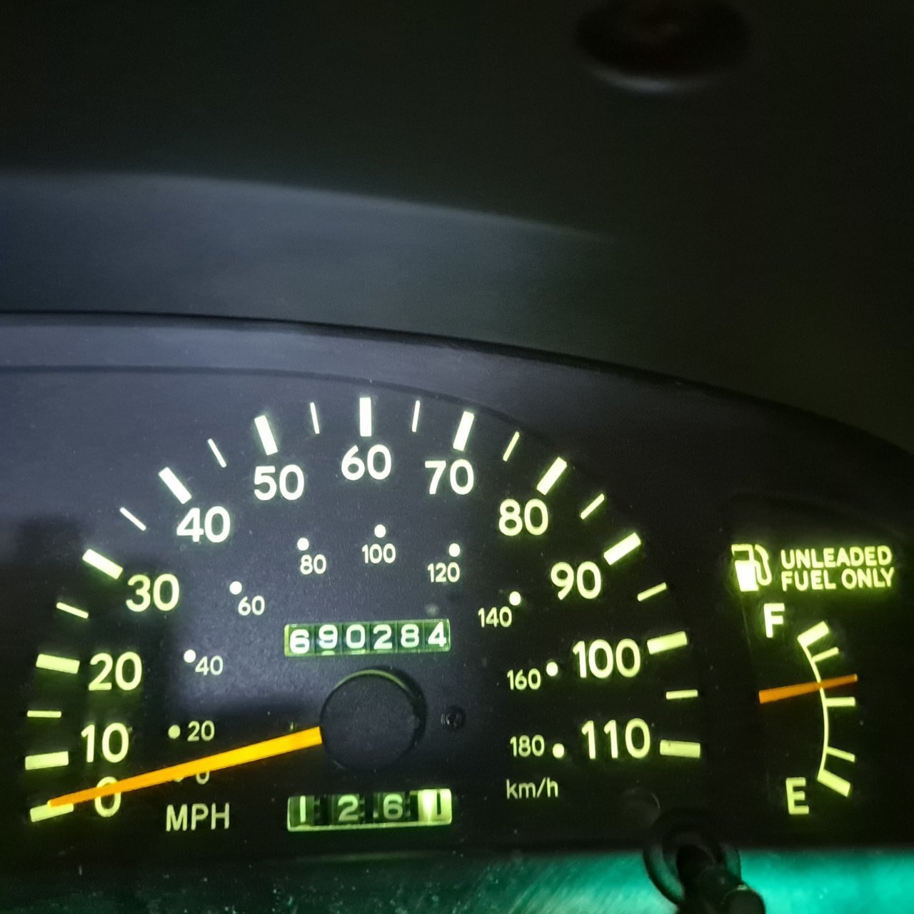

    Original owner,
    700,000 miles coming soon this summer and it's running better than ever!

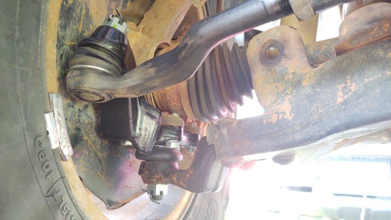

    Well, went to replace my LBJ's yesterday. Got the driver's side up, wheel off, popped off the tie-rod end with the nifty HF two-jaw puller I bought (the O'Reilly's rental puller didn't fit around the lower control arm). It was a bitch to get those jaw tips beneath the dust boot but I managed. However, when I started to torque the center bolt the entire tool began to tilt off-axis and insisted on doing so no matter how much I tried to adjust it. Thank God I kept the receipt because these sorry excuses for tools are going back to the store. Lesson learned, HF is a crap-shoot and you get what you pay for. Going to shop this coming week for a set of quality pullers.
    :frusty:

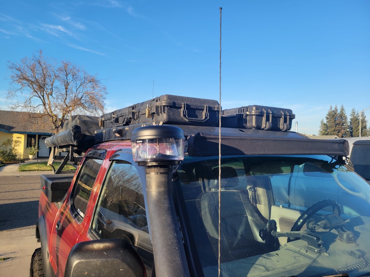

    Impulse red pearl is the best color :thumbsup:
    I've got a bit more accent black going on though.
    Everything below the body line, on the side, and the fender flares, is Raptor lined, the entire roof, and now the majority of the hood.
    I figure, about 30% of the truck is now Raptor lined lol.

    You want a pitman puller. Not a bearing puller.
    Go back to o reilyes, they have one you can rent. But for $15 I'd just buy it. Handy tool for tie rods too.

    The only one they had to rent was too small to fit around the lower control arm.
    I'm just going to order the same OTC kit that Timmy suggested.
