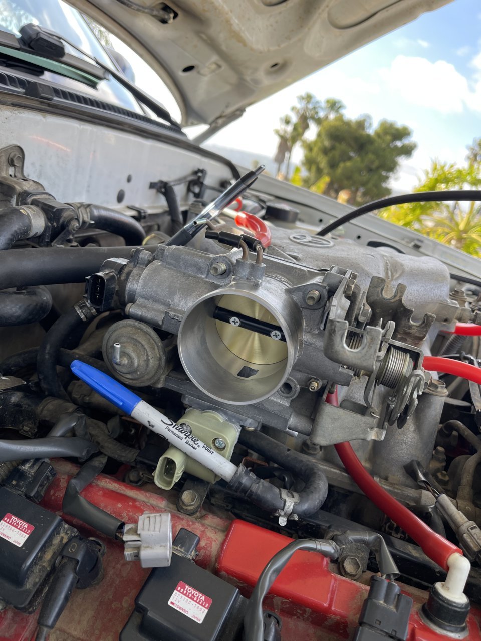

    Maxbore rebuilt TB finally gets re-installed. I’ve been chasing a high idle for awhile hoping this could help and so far…. it has! Drove back home from where I installed it (maybe a half mile) parked it and the idle came down to about 900ish! Would typically hover around 1100. Things are looking good so far. Hopefully it’ll come down a smidge more but I honestly wouldn’t mind if it stayed around 900.
    Yes I used a pen and a sharpie to plug the hoses lol.

    you should really be in the range of 750-850 while in park if you have an auto. Double check your TPS, IAC, and throttle cable tension if you haven’t already.
    edit: that IAC looks like you replaced it recently. Could be your throttle position sensor. If the idle doesn’t settle down some more, I believe you can OHMs check the TPS with a multimeter.

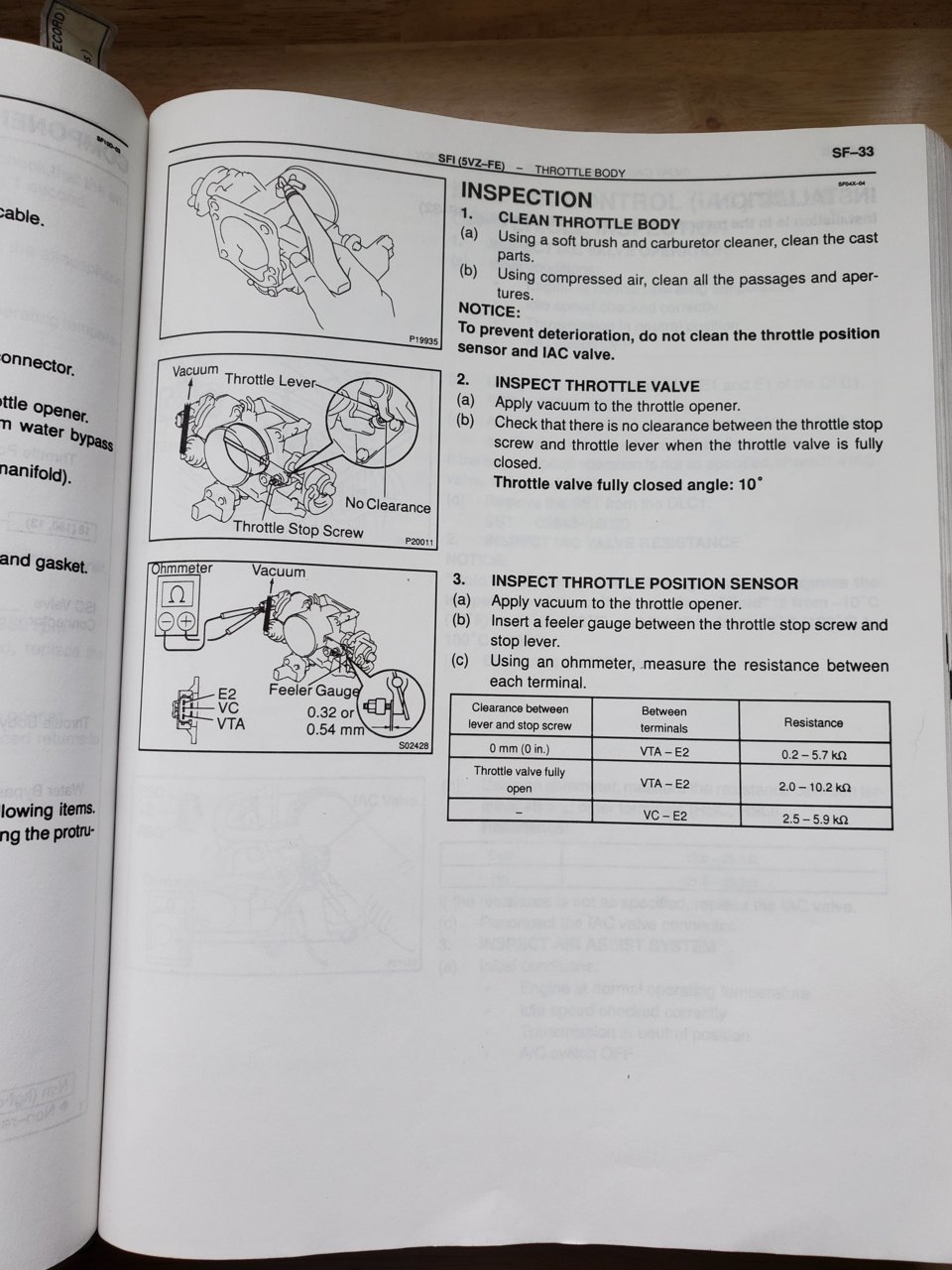

    Ya I am aware that it should be in the 750-850 range, and that is the end goal. Still, 900 is a better than 1100. Also yes, I mentioned somewhere previously in the thread that I’ve replaced the IAC twice recently with no change. So that’s ruled out. TPS was my next suspect followed by the coolant temp sensor.
    I’ve never used a multimeter before. How would I check that? What am I looking for?

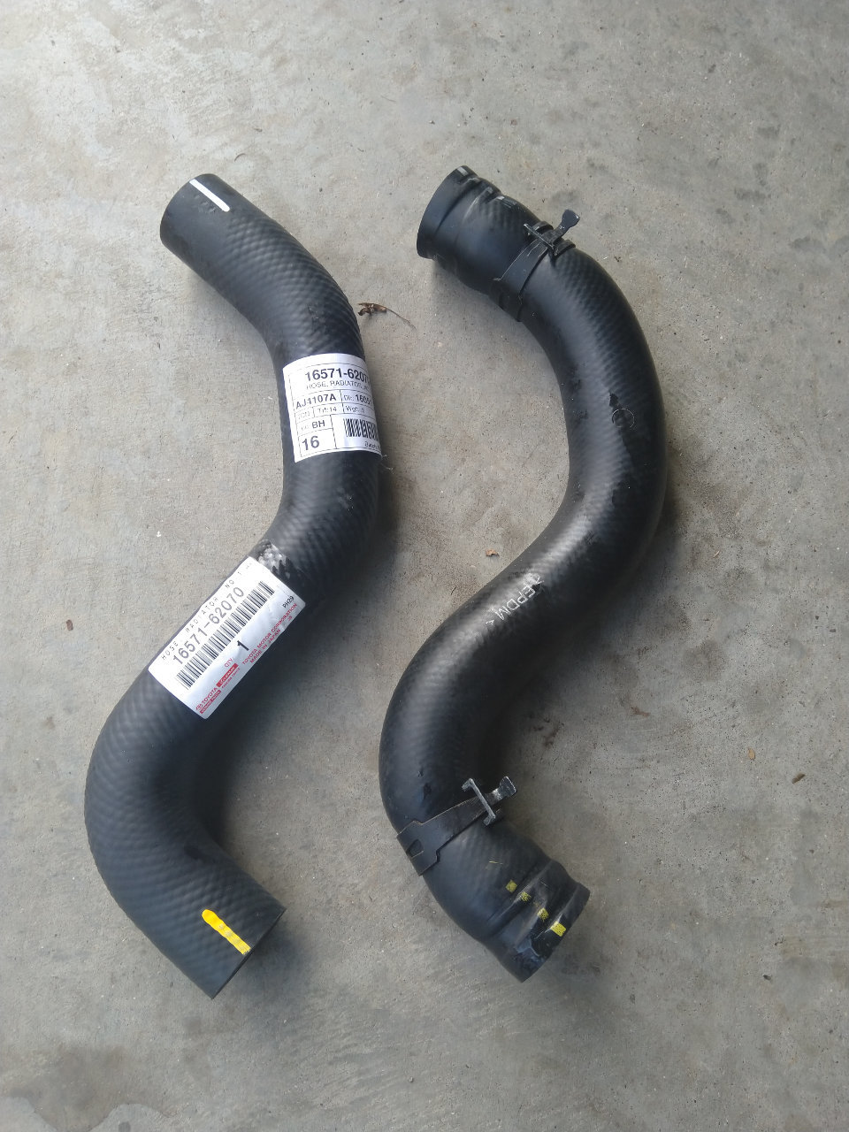

    5VZFE M/T upper radiator hose. The part number I have is 16571-07030 which looks to be discontinued? Seems like a part they wouldn't discontinue though...
    And, how long should I expect my original radiator to last? I'm doing my ~200K timing belt maintenance, so if I shouldn't expect another 100K from the radiator, now is the time to do it. OEM or aftermarket on the radiator?

    I would replace it since you're in there. Coolant isn't cheap either, nor easily disposed of. At least around here.
    This is the part# I used, MT vs auto doesn't matter for the upper. 16571-62070

    Radiator if it's original I would replace since they are cheap 100.00 with a good name brand company and a flush to remove any sen.
    Look at the gates hoses, gates typically are much better quality

    In addition to the video, here is the procedure to check the TPS...

    I'll check the factory service manual when i get home today and grab a pic of the page that spells out how test it.
    Edit: see about post, thanks @Gen1FTMFW

    Thanks. I was gonna say I don’t think Timmy shows how to check the TPS in that video. Just the IAC
