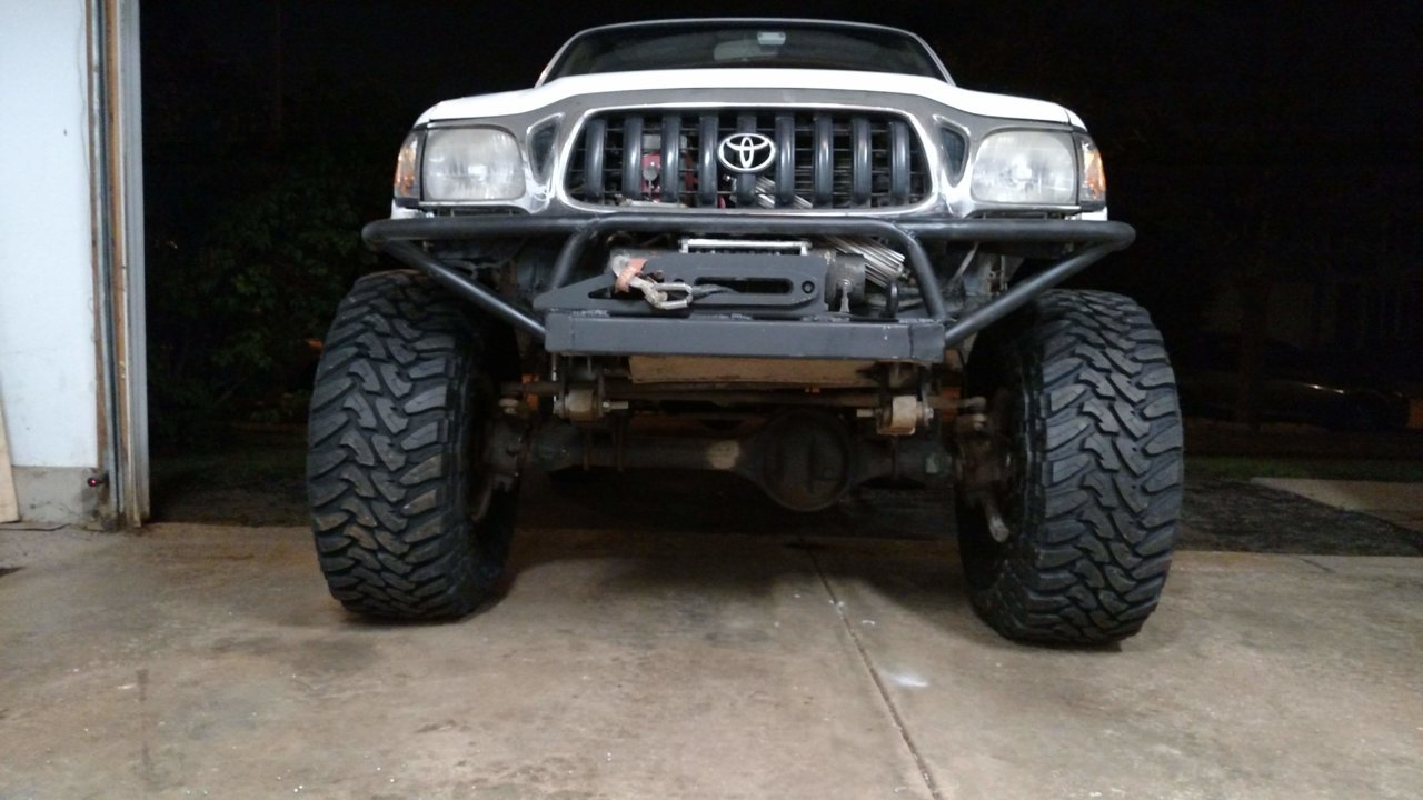

    02 Tacoma, fixed with curse words.
    I have the 18" single core Denso radiator on my v6 MT Tacoma, and it stays nice and cool even when slow speed crawling with the AC blasting. I also have the stock fan and clutch setup for reference. Even with all this crap Infront of my radiator, including a big ass steering cooler, winch control box and the winch itself it runs nice and cool.
