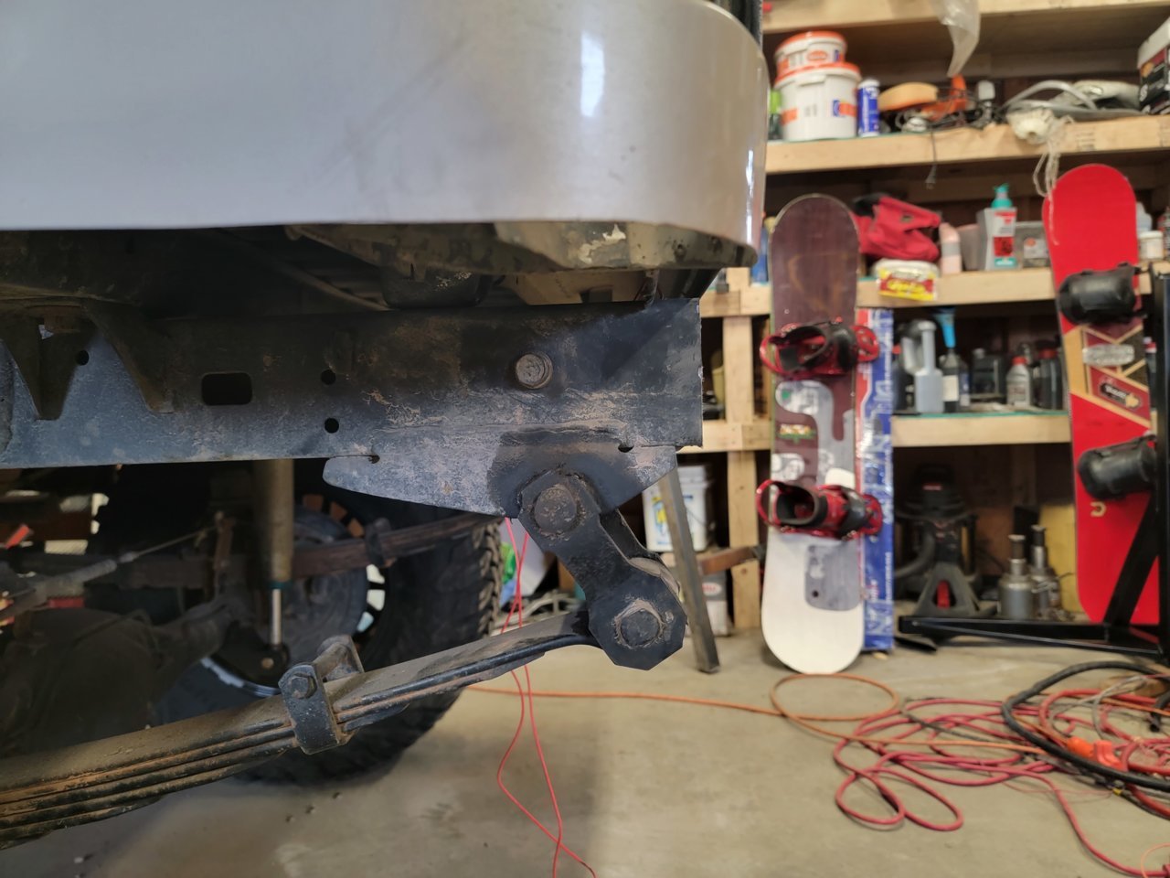

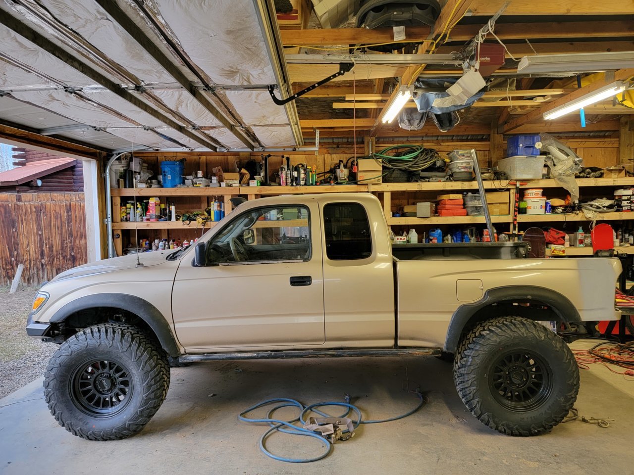

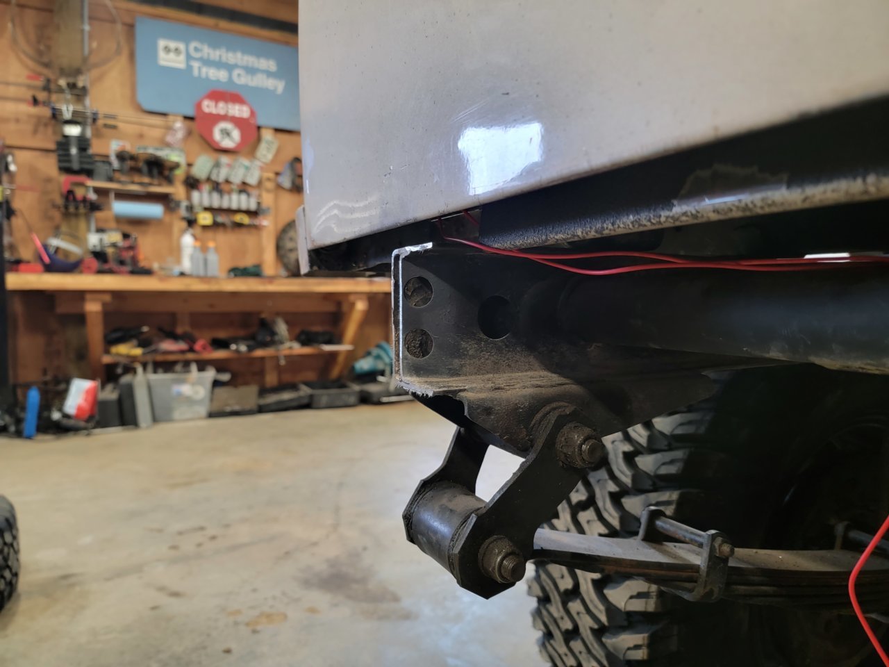

    I do like that bobbed bed. Makes me want to consider it again. Might even allow me to park in the garage without disassembling the swingouts on the rear!
    Remind me again why you cut out the amount you did, and not what it would take to get to a 5ft bed length?
  17. Apr 3, 2022 at 7:49 AM
    Squeaky Penguin
    Squeaky Penguin Nothing Ventured, Nothing Gained
    Apr 5, 2012
    #76340
    10,097
    Brett
    Steamboat Springs, Colorado
    '01 4WD, SR5, TRD & '13 TRDOR AC
    Lots of dust and custom dents, Check Build
    I cut 10" out, 13" would have got me to short bed length.
    Mainly because I think it looks better. :D But I also think there's diminishing return due to the frame. I cut 5" out of the frame and it's even with the back on my bed. Wouldn't really want to go too much more and get into the shackle support.

    Do you clear lock to lock? I know you checked the bump. Them tires are thick!!
  19. Apr 3, 2022 at 11:07 AM
    Squeaky Penguin
    Apr 5, 2012
    #76340
    10,097
    Brett
    Yes. Full bump and full turn. Limited a bit by the tires getting into the frame.
