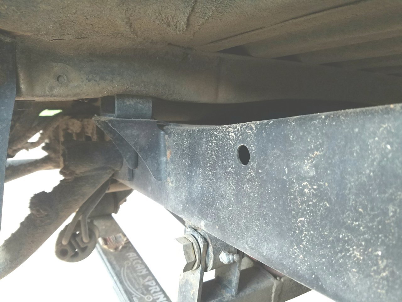

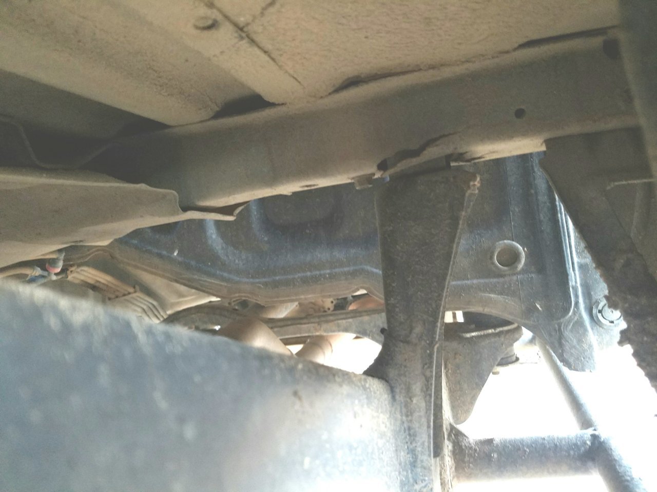

    That extra inch has been nice for a shock relocate and stuffing an intercooler under the hood. Only thing I regret is using the shitty bed mounts and not making my own before they destroyed the bed xmember.

    I'm not understanding the part about the bed mounts, woukd you have reinforced them? Or, fabricated completely new ones?
    You're talking about the mounting points on the bed correct?

    They were little 1" square spacers. Not enough surface area to distribute the load on the xmember. This can also happen with the factory mounts but the daystar bed spacers exacerbate it. 20180627_124035.jpg 20180627_124058.jpg

    Ok, I get it now. So you would have fabricated something else that distributed the weight better.

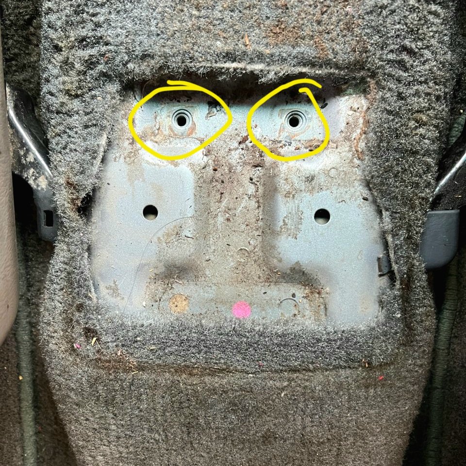

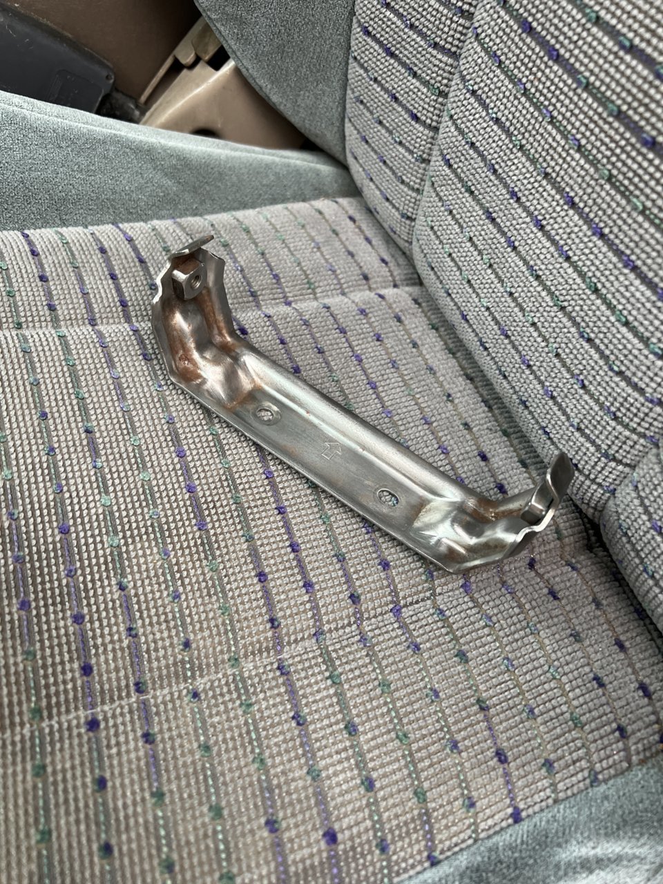

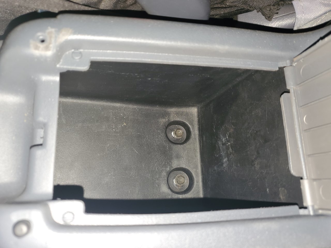

    I did it the lazy way and didn't even use the bracket. 2 holes, 2 bolts and done...

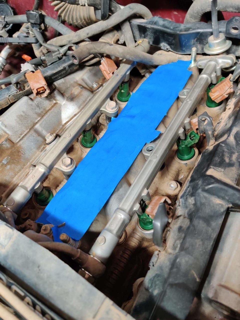

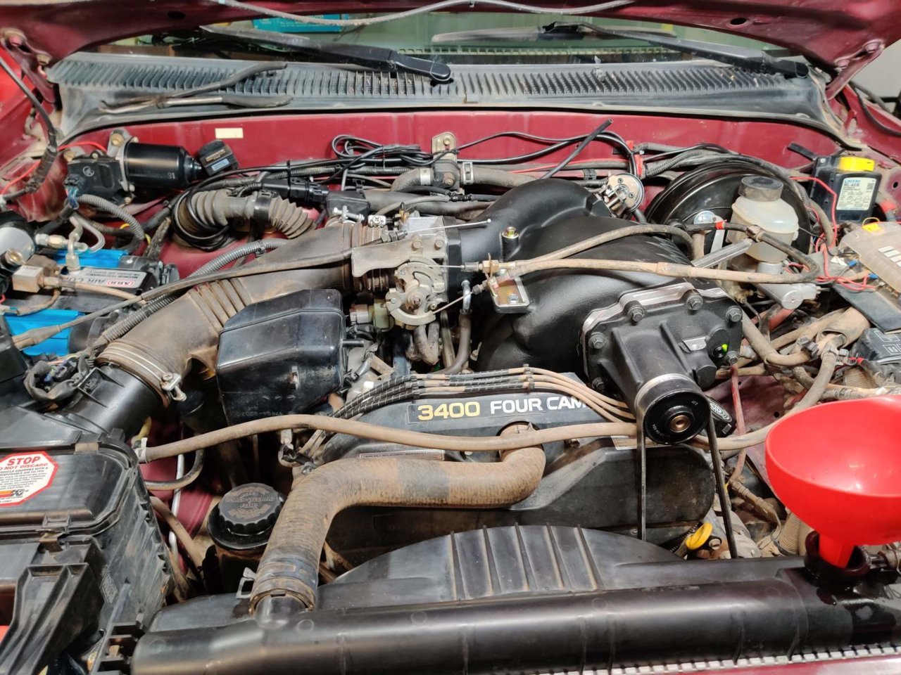

    With a lot of help from Zane, Installed a few new parts and pieces over the weekend. @Speedytech7 :hattip:

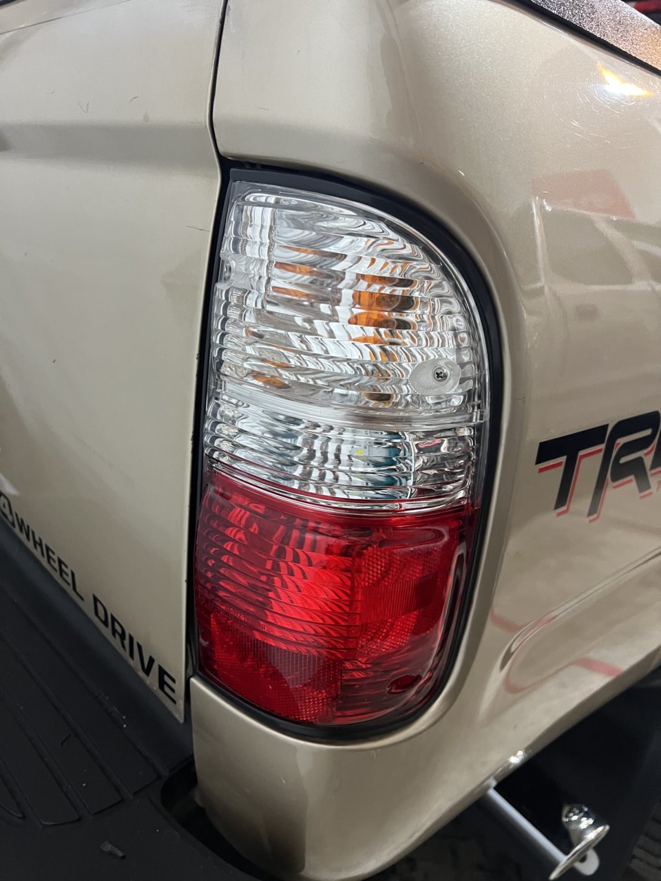

    Stock: Light bar!
    New taillights!

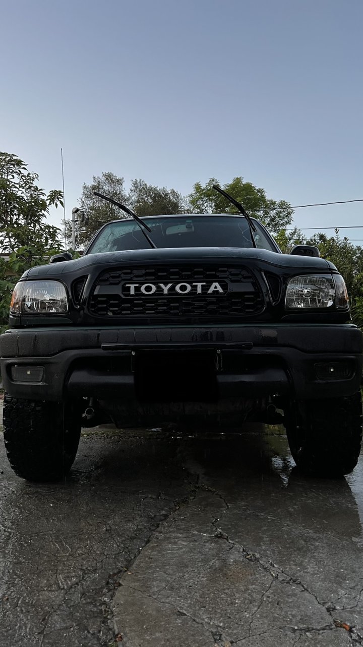

    Tacked on the new grille and rhino lined the front bumper
    Next up, rhino line the fender flares!

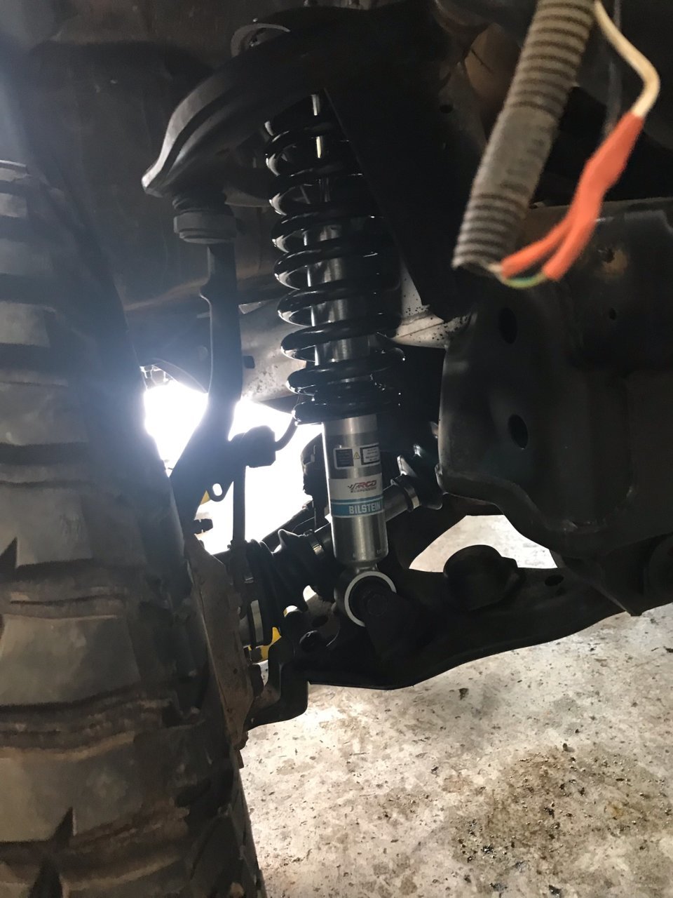

    Finally got my shit-kicker into the shop for alignment after the suspension work. Rode like crap after.
    Discovered I made another mistake in having wheelers put the Bilstein 5100s at the top notch instead of the bottom with their T1 coils. Now gotta wait till the shop has a bit to drop them down to where they're supposed to be.
    Lesson learned, just wish these lessons weren't so costly, lol.
    3 steps forward, one step back. Hoping nothing else comes up on it (knock on wood).

    I got my 5100's from wheelers. Ome 881 springs set on the lowest setting, let the springs do the lift, 2". Rides great.

    which injectors are those?

    Those are 650 cc Densos

    ah. supra stuff eh?

    Is that where they were used? I don't know really. They were recommended by SNP where I got the Haltech standalone from.
    They should provide plenty of headroom though.
