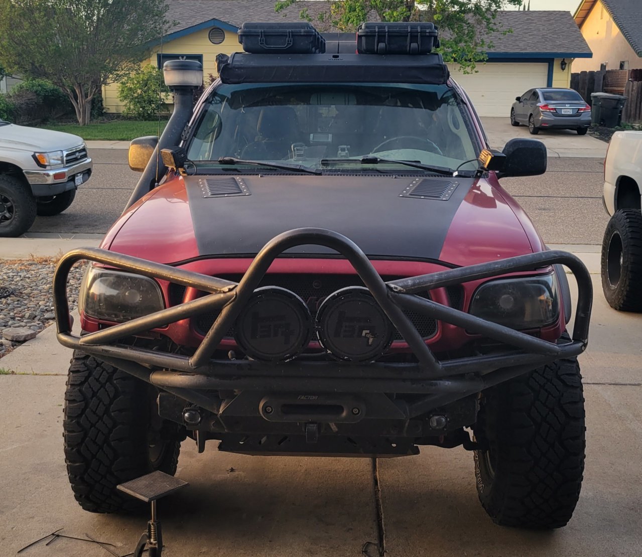

    Digging the build.
    Did you fab this from the ground up, or work off of a base and run from there?

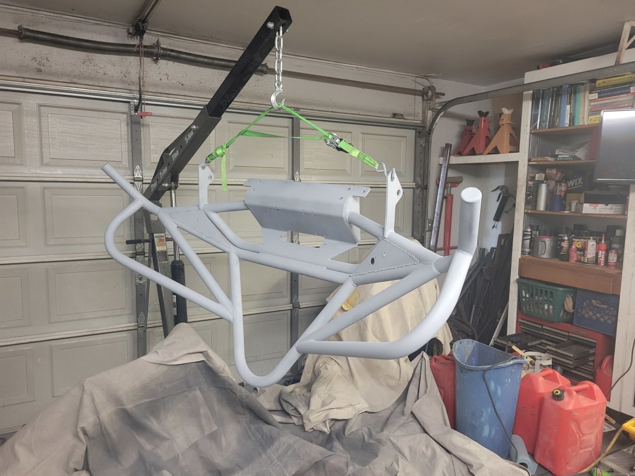

    It's a Trail Gear Rock Assault bumper with stinger. I'm just adding the headlight hoops.

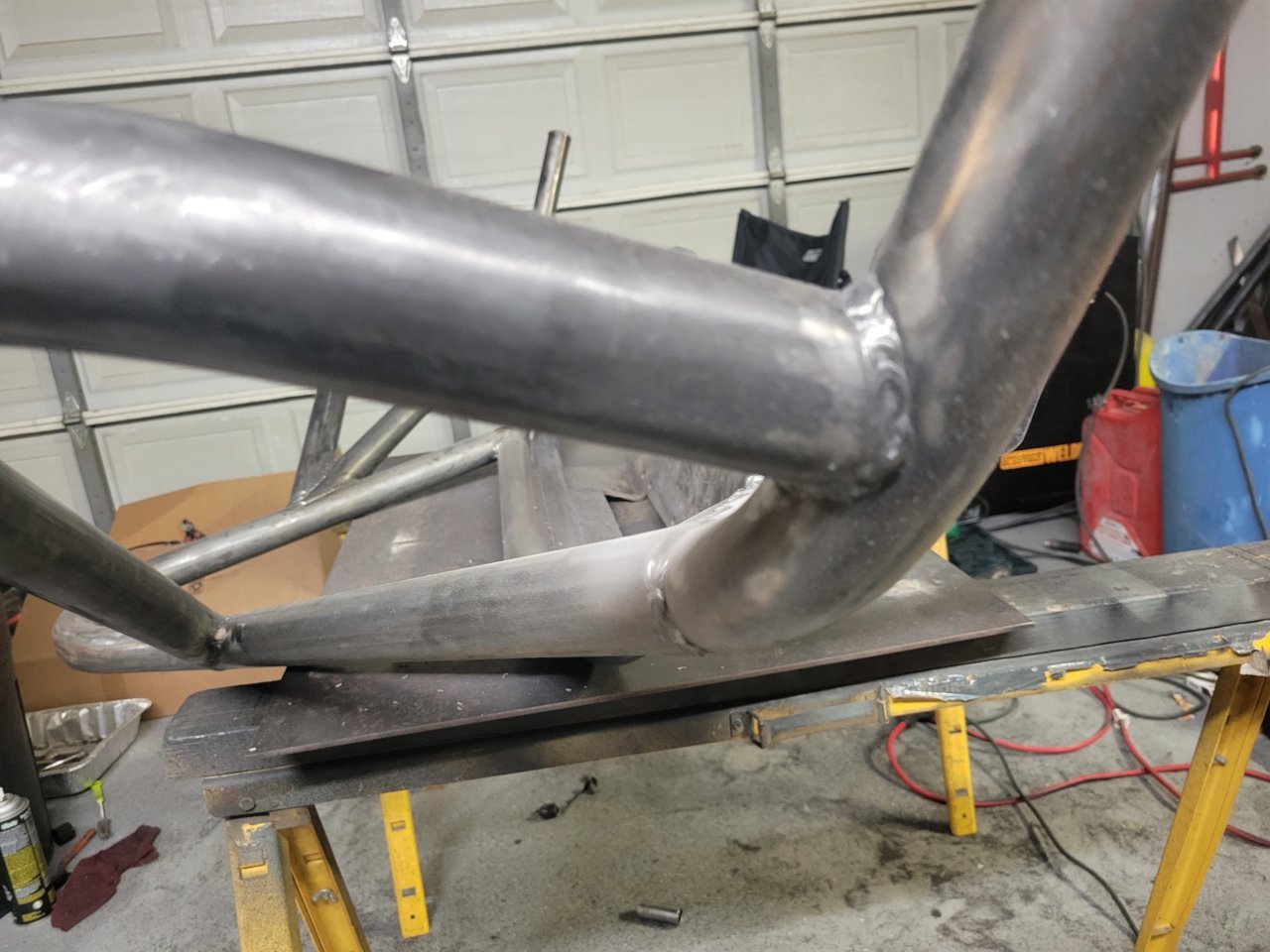

    Tacked the hoops in place, then pulled the bumper. Welded the hoops fully in place and stripped the entire bumper to bare metal.

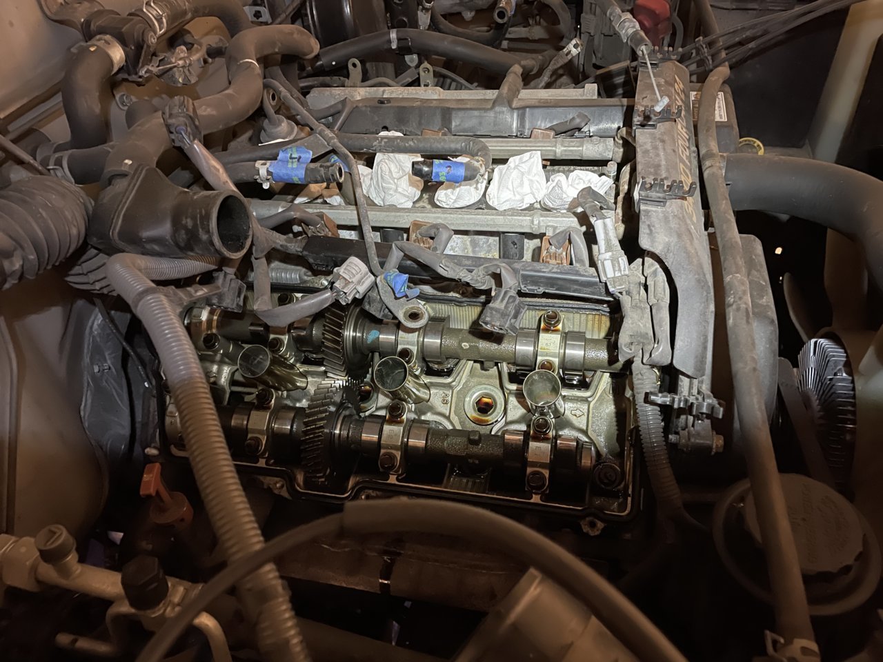

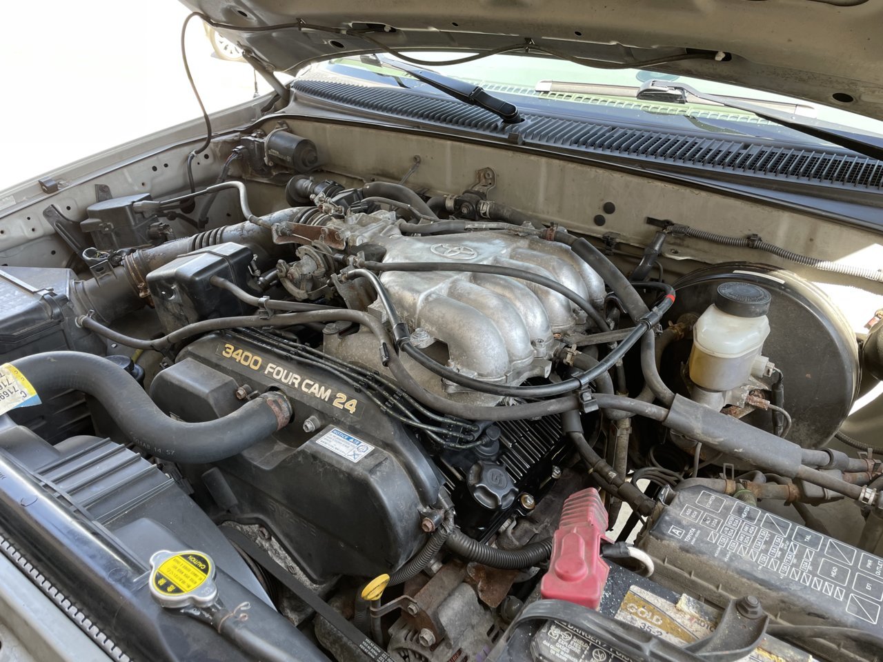

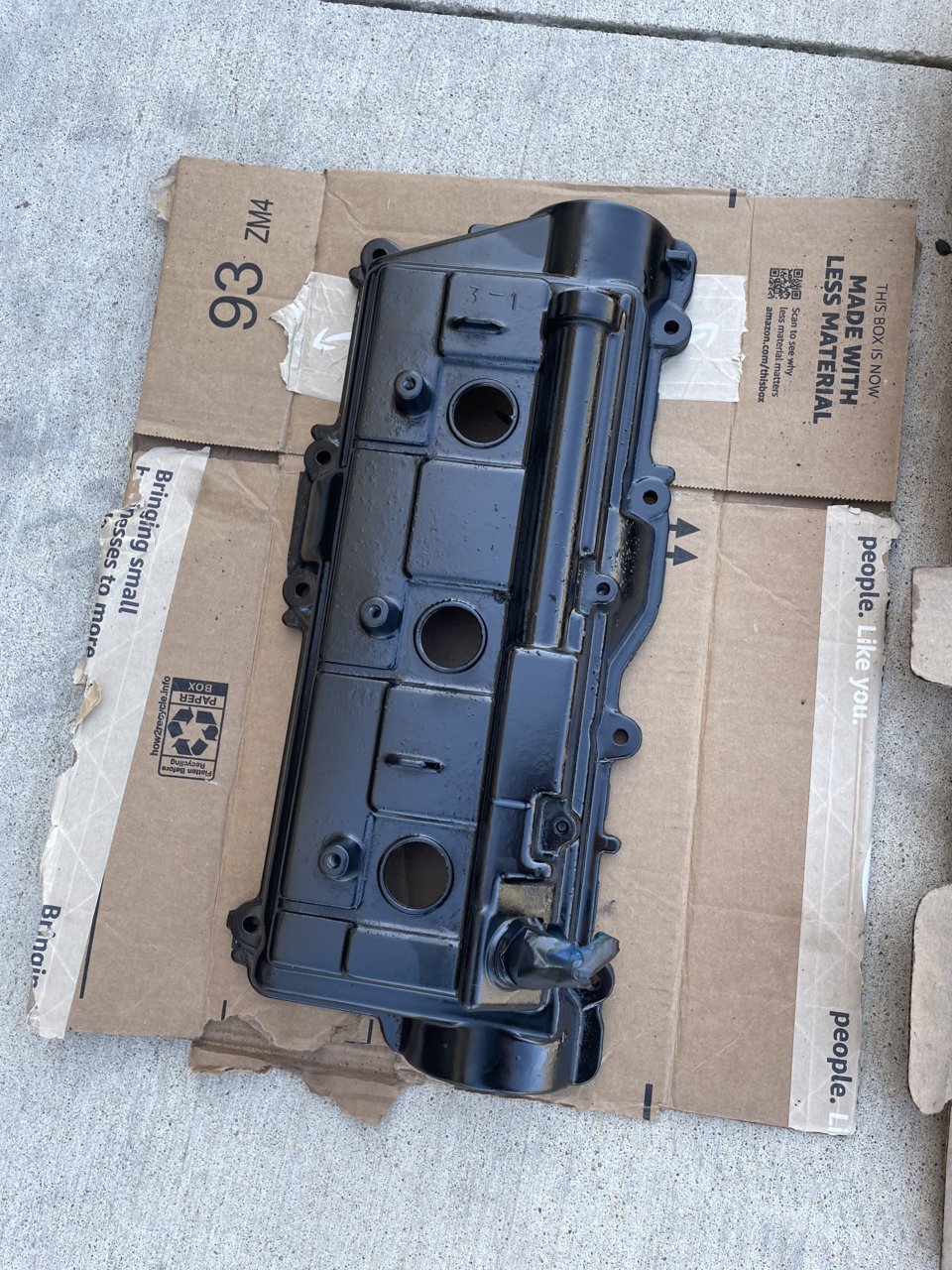

    I’ve got everything done and she started right up but was idling around 3000 RPM.. I messed with throttle body cables. Will readjust them in the morning. Was a busy a day. Upload more pictures tomorrow as well

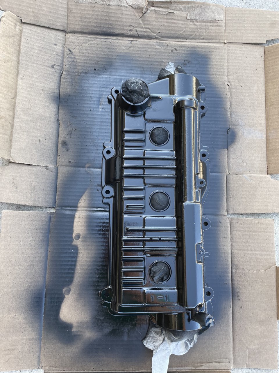

    Was able to get the the throttle body cables situated and tightened to correct play. After I did that, she was still idling extremely rough and low and of course, for got to connect one last tube. Once I got that on, she purred. I replaced all the hardware on the the valve cover with stainless. Will say she does run more quietly than previously. Glad it’s done.

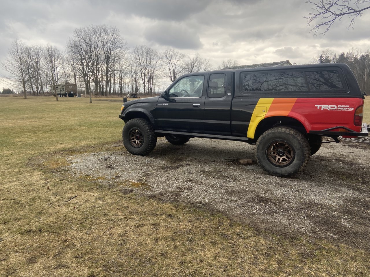

    Beater is back on the road, feeling out the Chevy leafs and the spherical bearing shackle hangers still. Need to get some sliders on it but I'm happy right now.
