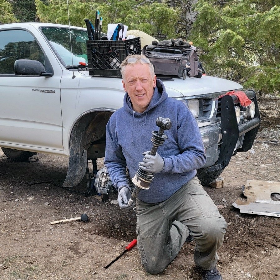

    The adventure begins when everything goes wrong. What do you do when an axle breaks in the remote Nevada backcountry at 7800' and there is zero chance of any services rescuing you? You fix it yourself! In this case, it involved a 7 hour round trip in my friend's Jeep to fetch parts, an 18F degree overnight stay on the mountain and a lot of grease. But with my friend's optimism and help, I made it out.278364401_10159334575404331_3231475860482835270_n.jpg

    CV axle, passenger side.

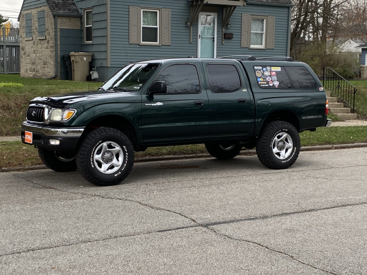

    Just had to take a moment between lunch and work to snap a pic and appreciate how great these first gens are.

    What part of the CV? Shaft looks intact, inner joint looks OK too.
    I blew up an outer joint on an OEM CV yesterday. I guess 35s and a front locker will do that...

    In separated in two pieces. I'm not super familiar with these CV axles, but it seems like that knuckle popped out of it's socket perhaps. I think the culprit may have been a missing bolt on the passenger side of the diff support arm, which allowed the diff to move and pull on the axle in extreme circumstances (like turning too tightly off camber in 4WD).

    Sounds like you could've just pushed it back together and been on your way. That inner joint can just slip in and out.

    Maybe, but the joint had been gashed pretty good. When it slipped out, it got badly jammed between the skid plate etc. Good to know for next time though. I was definitely an amateur trying to find my way out of an unknown difficult situation.

    Like Brett said it looks like you could have put the tulip joint back in its home if it wasn't damaged. Would have at least got you home.
    If you do ever break one on the outer joint you can cut the boots and separate it and keep going in 2wd if you don't have the parts.

    Yes. I painted the caps to test the color and really like it just haven’t had time to do the rims themselves. I’m in between getting black steels or painting these. Currently debating that.

    not my truck, internet photo, but I dig the rim color, dupli color graphite I believe

    Yup that’s the exact photo I got the idea from. The gunmetal with the green looks sick.
    Actually went today searching for some steelies at the lkq but couldn’t find any that weren’t bent or rusted to shit. I’m going to try out one more junk yard and if no luck then to the paint I go.
