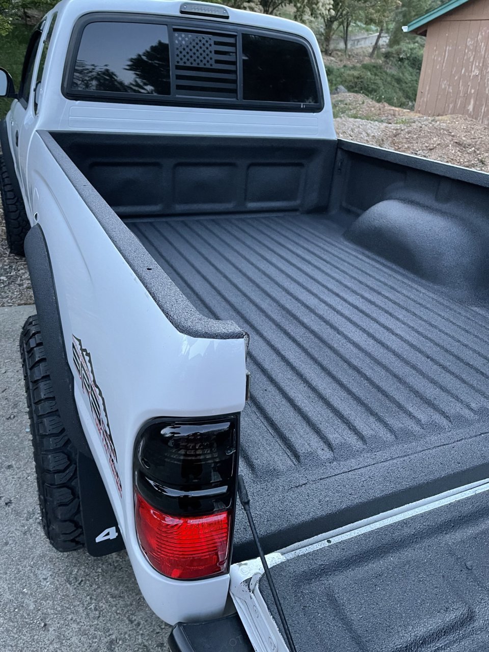

    Finally finished the raptor line. Wasn’t able to do the amount of prep work I wanted to but I’m pressed for time since I’m driving back to San Diego tomorrow (8 hour drive). I still think it came out relatively well. Happy the lines came out straight and didn’t take any paint with it like last time.

    Looks nice. did you use only 1 kit? One or two coats?

    1 kit. So 4 bottles, 1 per coat.

    thanks. Did you roll it or spray?

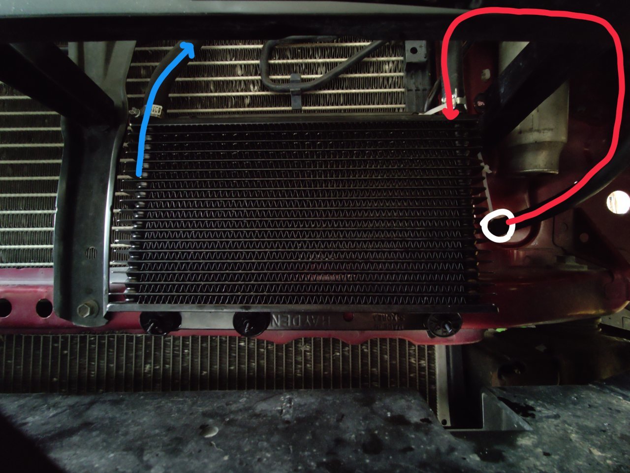

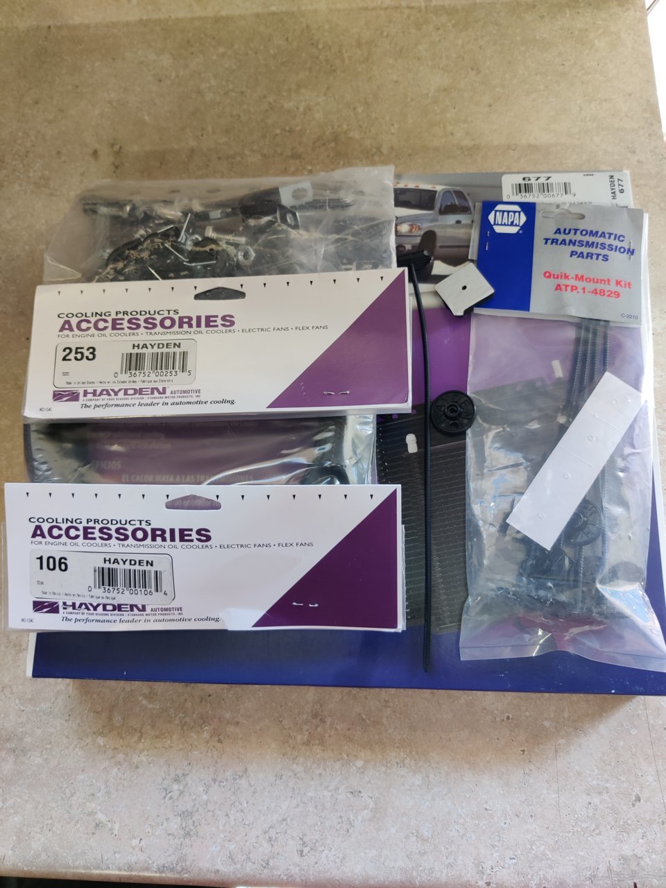

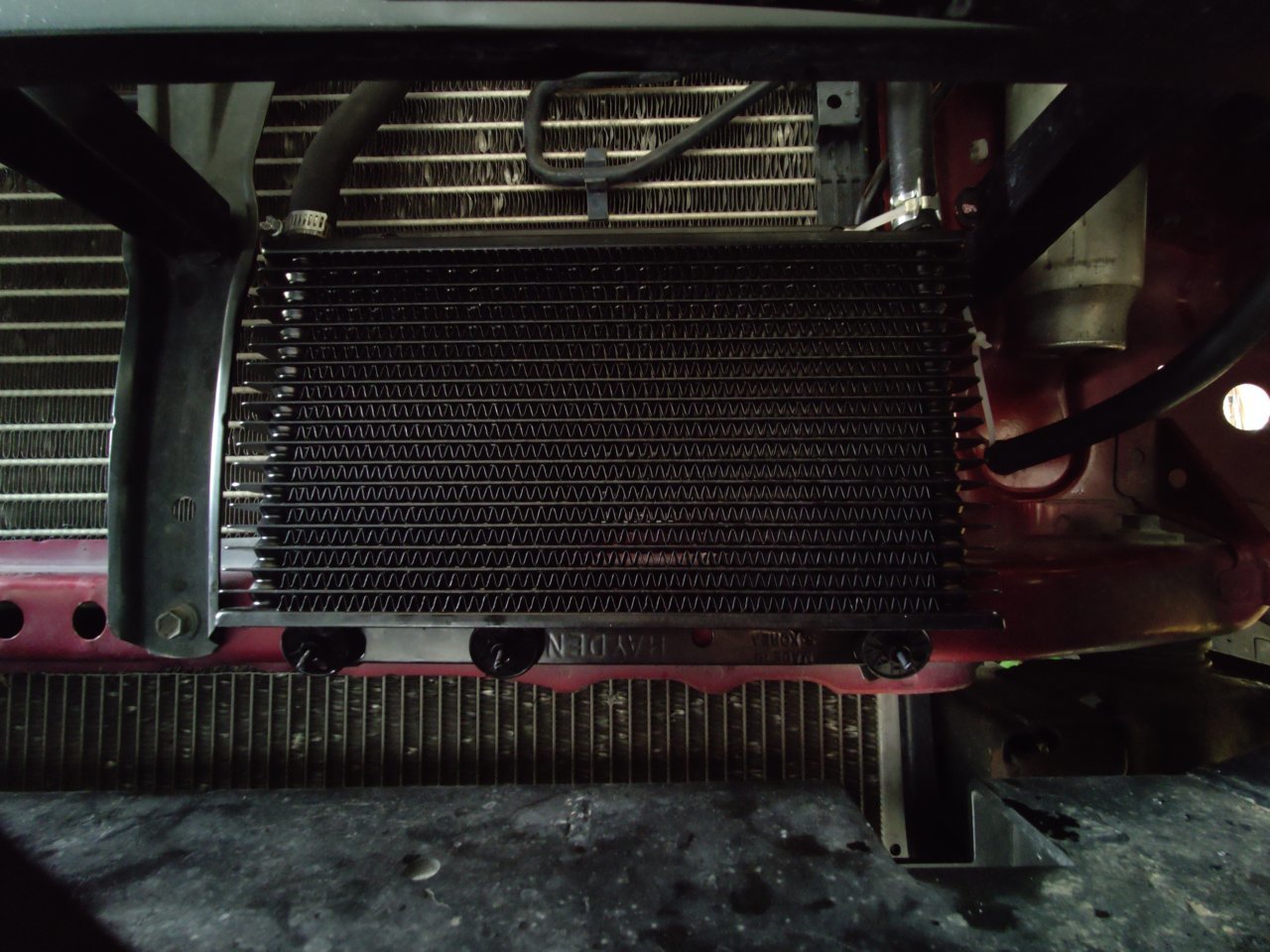

    CX Racing Turbo kit. TransGo shift kit. All Pro Apex bumper and skids. Smittybilt XRC 9.5 winch. All Pro Upper control arm's. Bilstein 6112's with 600lb coils. Eimkeith's lower control arm reinforcement plates. Perry Parts bump stops. All Pro spindle gussets and alignment cam tabs. All Pro standard 3" leaf springs. Bilstein 5125's rear. Extended rear brake lines. Rear diff breather relocation. MagnaFlow catback with resonator. Bluetooth stereo. Memphis 6x9 door speakers. Diode Dynamics SS3 Pro Amber fog lights. Single piece headlights. aftermarket grille. Anzo taillights. LED 3rd brake light. 4runner sunglass holder and dome lights. Master Tailgaters rear view mirror with 3 directional cameras, G shock sensors, and anti theft system. Honda windshield washer nozzles. Stubby antenna. Scan Guage II. 2nd Gen Snowflake wheels powder coated black. Cooper Discoverer ST Maxx 235-75/16 Denso 210-0461 105 amp alternator. Speedytech7's big wire harness upgrade. Aeromotive 340 fuel pump. Haltech Elite 2500. Tacomaworld sticker. Tundra brakes with Adventure Taco's hardline kit
    I use the 677 model and bought the recommended extra hose and mounting kit.
    I really meant to take pictures of the install but my hands get going and I forget about everything else.
    I haven't used the mounting bracket kit to properly secured it down yet but it's working great with the little zip ties it comes with
    I did drill one hole with a stepped bit
    Picture probably isn't much help but the line with red is what comes from the bottom of the radiator cooler, It goes through a hole I drilled then into the Hayden cooler. the blue line goes up and across and passes back through the hole on the passenger side were the power steering lines come through

  12. Apr 13, 2022 at 1:33 PM
    Dan8906
    Dan8906 Well-Known Member
    Jul 26, 2016
    #192977
    5,151
    Daniel
    Concord, California
    2004 Tacoma ext cab TRD 4x4
    CBI sliders, ADS extend travel with compression adjuster coil overs, 9” Bilstein 5125 rear shocks, Icon Tubular UCA, Alcan custom leafs, All Pro Apex bumper and skids, NWTI rear diy bumper, 295/70/17 Cooper St Maxxs and nitro 4.88s.
    Gotcha, so you have it trans out-radiator-Hayden-trans In.
    I just ask because I’ve seen a lot of people say similiar things…once 220 now never above 180. I added a cooler and it still hits 220 sometimes. So I think I need to loose the tru cool and go to a Hayden and see if it makes a difference.
    unstpible[QUOTED] likes this.

    Louisiana
    01 V6 4wd PreRunner DCSB OME lift
    whats your routing? I have a tru cool and havent see above 175

    I like the idea of running the Hayden cooler before the radiator just to help keep the radiator that much cooler.
    Trans-radiator-cooler-trans. But maybe it’s just the terrain, I have Sierra Nevada grades I drive up
    DashMaple[QUOTED] likes this.
    That’s how I originally ran it, seen a 10 degree decrease by running it after. The radiator was heating it back up.
