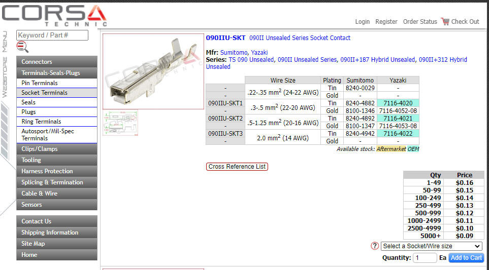

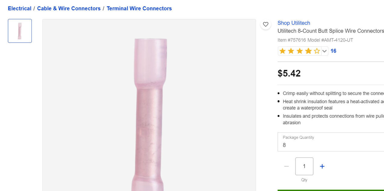

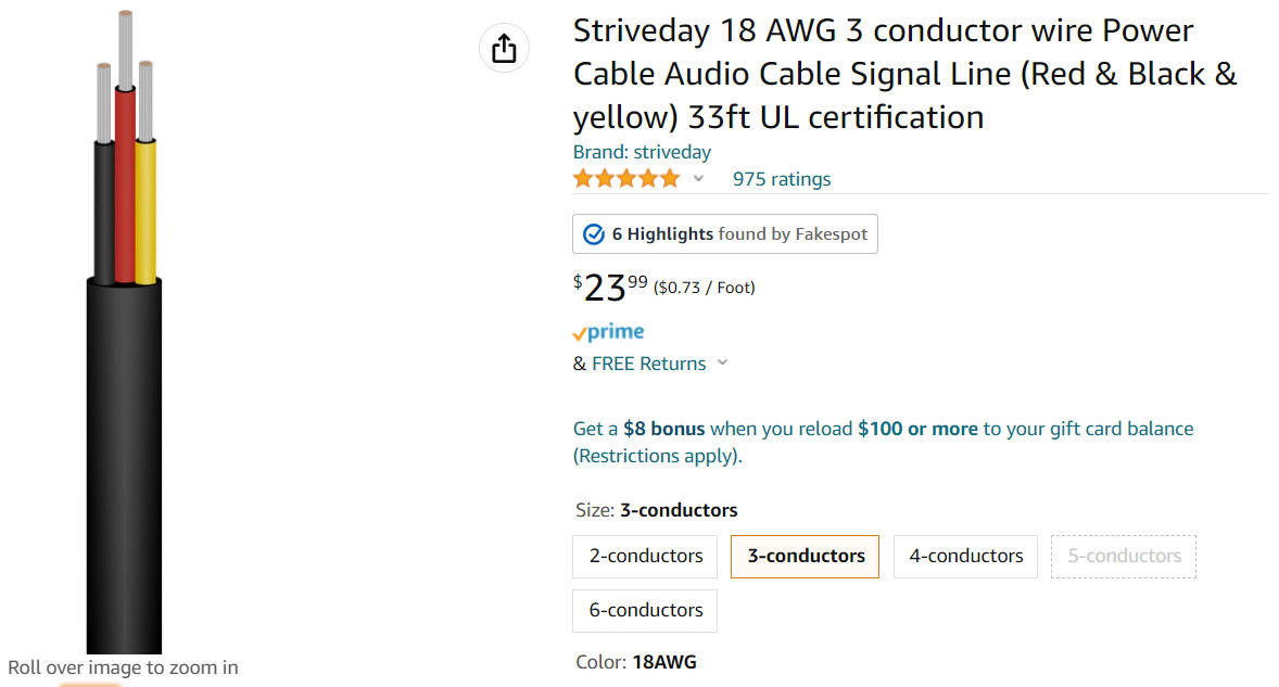

    I used the following materials for the job:
    * 3 conductor tinned/stranded 18 Ga. wire (Amazon)
    * Single stranded 18 Ga. wire (Lowes)
    * Heat shrink butt splice connectors for 16-22 Ga. wire (Lowes)
    * 3M Super 77 Elec. Tape (Lowes)
    * 090 SKT1 connectors (Corsa Technic)

    - LG wire to mirror: Solder splice/tape (along with black wire for pass side) the black wire on the 3 conductor cable, then butt splice at LG wire at mirror plug.
    - P wire to mirror: Butt splice the Red wire on the 3 conductor cable, then butt splice at P wire at mirror plug.
    - P-G wire to mirror: Butt splice the Yellow wire on the 3 conductor cable, then butt splice at P-G wire at mirror plug.
    - This 3 conductor cable is run along with the power window/lock harness and then up to the drivers mirror plug.
    III. Wiring from the mirror control panel to Pass side IH1 connector at driver side lower kick panel:
    - LG wire to IH1: Solder splice/tape (along with black wire for driver side) the black wire on the 3 conductor cable, then to connector IH1 and using soldered 090IIU-SKT1 connector plugged into position #5.
    - G-B wire to IH1: Butt splice the Yellow wire on the 3 conductor cable, then to connector IH1 and using soldered 090IIU-SKT1 connector plugged into position #7.
    - G-R wire to IH1: Butt splice the Red wire on the 3 conductor cable, then to connector IH1 and using soldered 090IIU-SKT1 connector plugged into position #3.
    - This 3 conductor cable is run along with the power window/lock harness and then through the rubber door sleeve and to IH1 connector plug.

    - IL1 pos. #5 to mirror: From pos. #5 on IL1, solder 090IIU-SKT1 connector to Black wire on 3 conductor cable then butt splice that G wire at mirror plug.
    - IL1 pos. #7 to mirror: From pos. #7 on IL1, solder 090IIU-SKT1 connector to Yellow wire on 3 conductor cable then butt splice that G-B wire at mirror plug.
    - IL1 pos. #3 to mirror: From pos. #3 on IL1, solder 090IIU-SKT1 connector to Red wire on 3 conductor cable then butt splice that G-R wire at mirror plug.
    Of course, I used a heat gun to shrink all butt splice connections and I used cable ties on the wiring inside both doors and tried to follow the OEM wiring routes and much as possible. I taped-up the groups of butt splice connectors to keep things more organized.

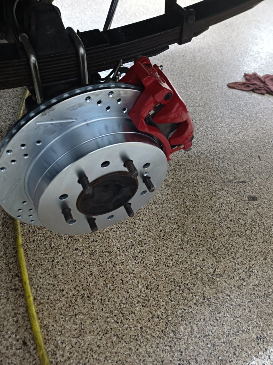

    Specs man, specs! I assume no parking brake?
  8. Apr 19, 2022 at 1:48 AM
    mechanicjon
    mechanicjon They call me "Jonny Stubs"
    Dec 2, 2016
    #203828
    10,149
    Jon
    Scottsdale Arizona
    04 Taco SC 4dr SR5 TRD Prerunner
    Supercharged, AEM FIC/6, Meth Inj, ION Alloy's, Radio & Phone steering Wheel controls,Fabtech AAL, Billie's wrapped with 880's , Tundra big brake conversion, bully bars and Pioneer DDin Stereo/dvd with exterrnal usb ports. 290K and going strong.
    Yes parking brake. In the process of getting cables that came with kit shortened. SOS Tundra brakes.

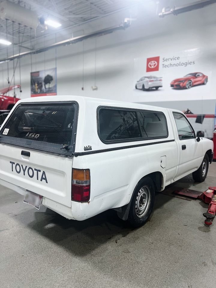

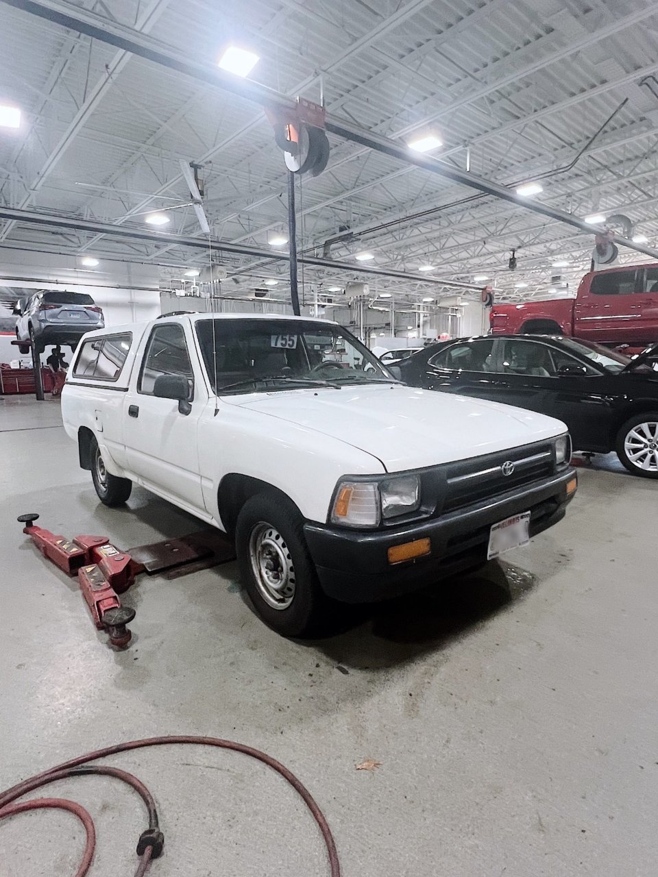

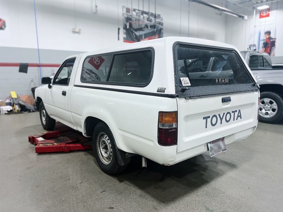

    Marion, IL. Toyota. :) Always love to see old trucks like this one come through the shop! A 1992 with over 300,000 miles! YES it is the original frame!
    278840349_5913353175347371_7574868129304310626_n.jpg 278873042_5913353215347367_6782045609836324660_n.jpg 278975017_5913353178680704_5655405713572040687_n.jpg
