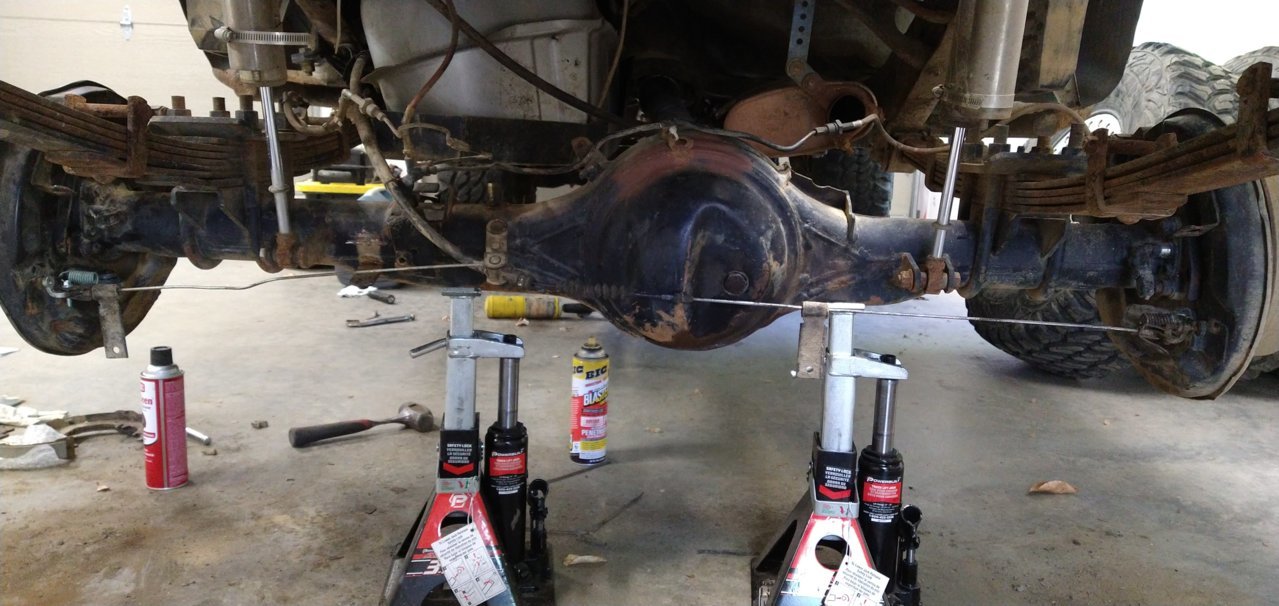

    That is pretty fabulous. Thank god I don’t have vehicle inspections, I tore all the parking brake stuff off my 80 axle. Didn’t have any of the cables anyway.
    What do you do for a brake, if anything? I have a line lock, would like to mount a driveline brake at the transfer case.
