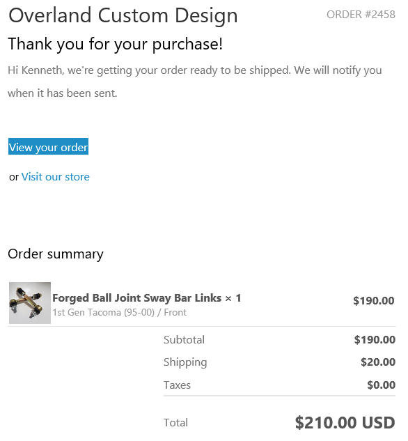

    Sorry, forgot yours was a '99. I bought these OCD forged end links when I added 2" lift with Kings, but when I tried to install they were too long no matter how I adjusted. I just install new OEM type with poly bushings and they work fine. I haven't heard any "clunking" noise - at least not yet. If anyone needs this set of forged sway bar links, I'd be happy to sell at a big discount (I'll take a pic and post later on the BST).
