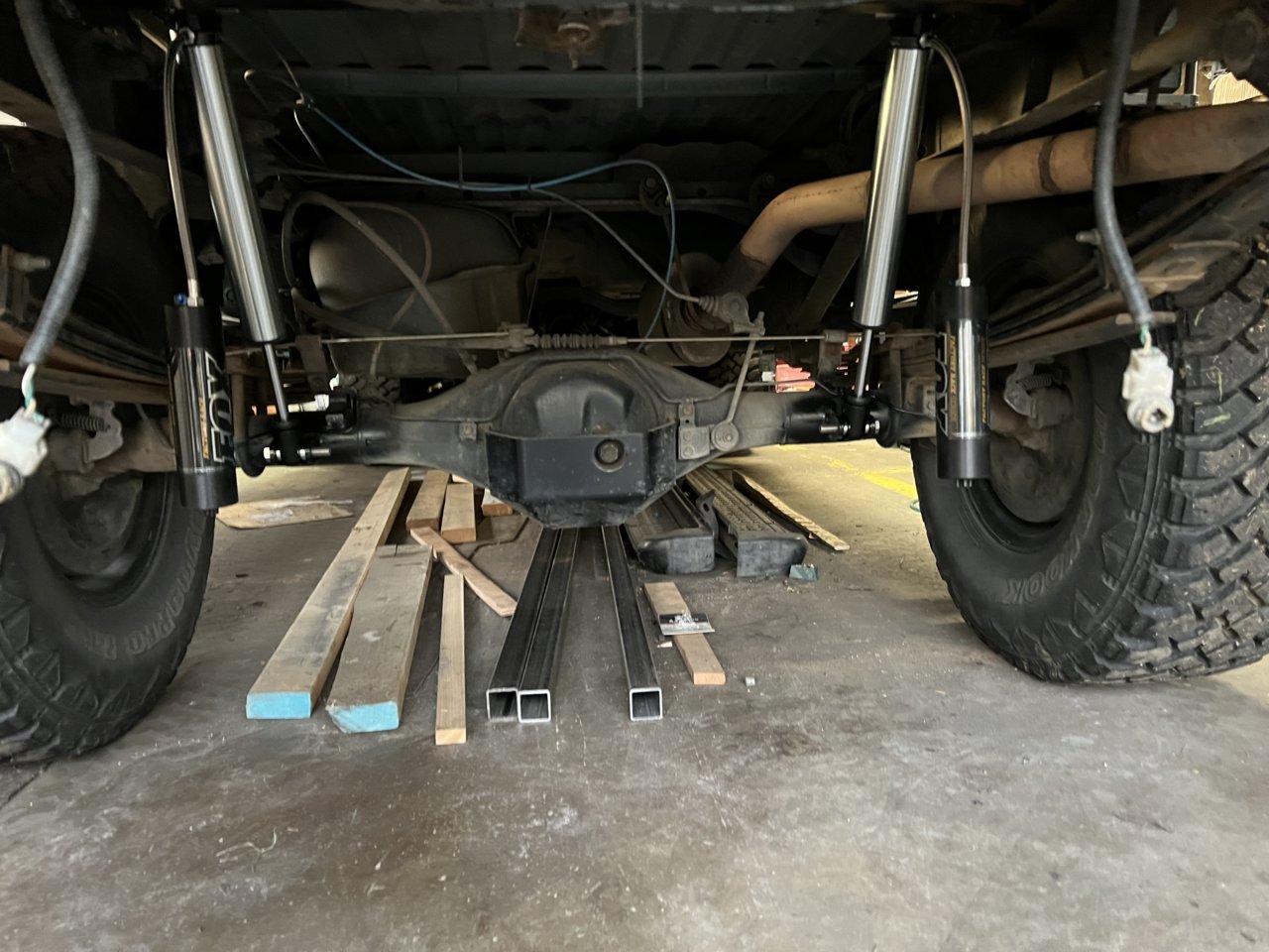

    Didn't know you had a diamond Axle housing back there.
    Those are some beefy perches. Who makes them?
    Also why are you going to a factory housing from the diamond?

    Something is not right with the Diamond. I'm not sure if it is bent but it eats everything on the passenger side. I picked it up secondhand and I should have known when I opened it up and the pass wheel bearings fell out in pieces.
    I've put several axle seals and wheel bearings in it, it broke a shaft on that side and took out the spindle, wheel bearings, hub, and drive flange. Everything has been swapped except the housing itself. Last time I took it out in July it spit out a drive flange too so it seems like it's under side tension when it should not be.
    Now, it could be salvageable. My buddy has an alignment bar and has straighten a few factory Toyota housings. I'm not inclined to, though. Shafts are $500+ ea and that's tons territory.
    I'll probably keep an eye out for a Econoline Dana 60 to start building next

    Interesting. Yeah, something seems off with the housing for sure. Too bad diamond customer support sucks.
    I was researching into doing a full flow conversion for the rear of the diamond I have coming, but decided against it as it's pretty pricey when it's all said and done
    Nice. I'll check them out for when I build mine up. Much more affordable than the ruffstuff u bolt eliminators I was looking at previously.

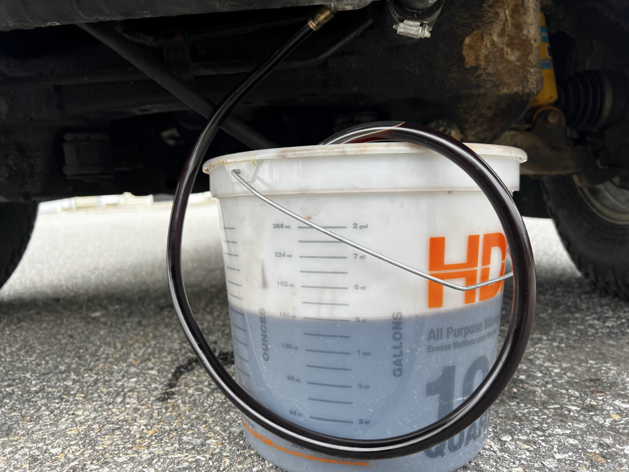

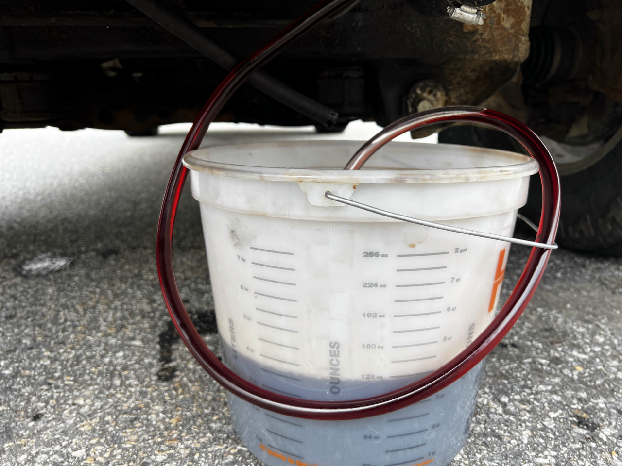

    Did a Timmy-style complete transmission flush at 250k. I'll try to remember to update with an actual write-up after a get a couple thousand miles on with the new fluid.
    I'll tease with a little before/after:
    E0B2A252-72D3-418B-84C2-CE8CB32264CC.jpg 32AE16CB-EFD2-41F8-B19A-A64F8983193D.jpg
    Maple syrup to ruby red

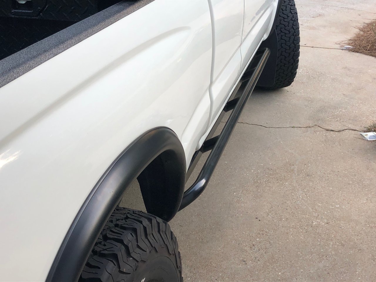

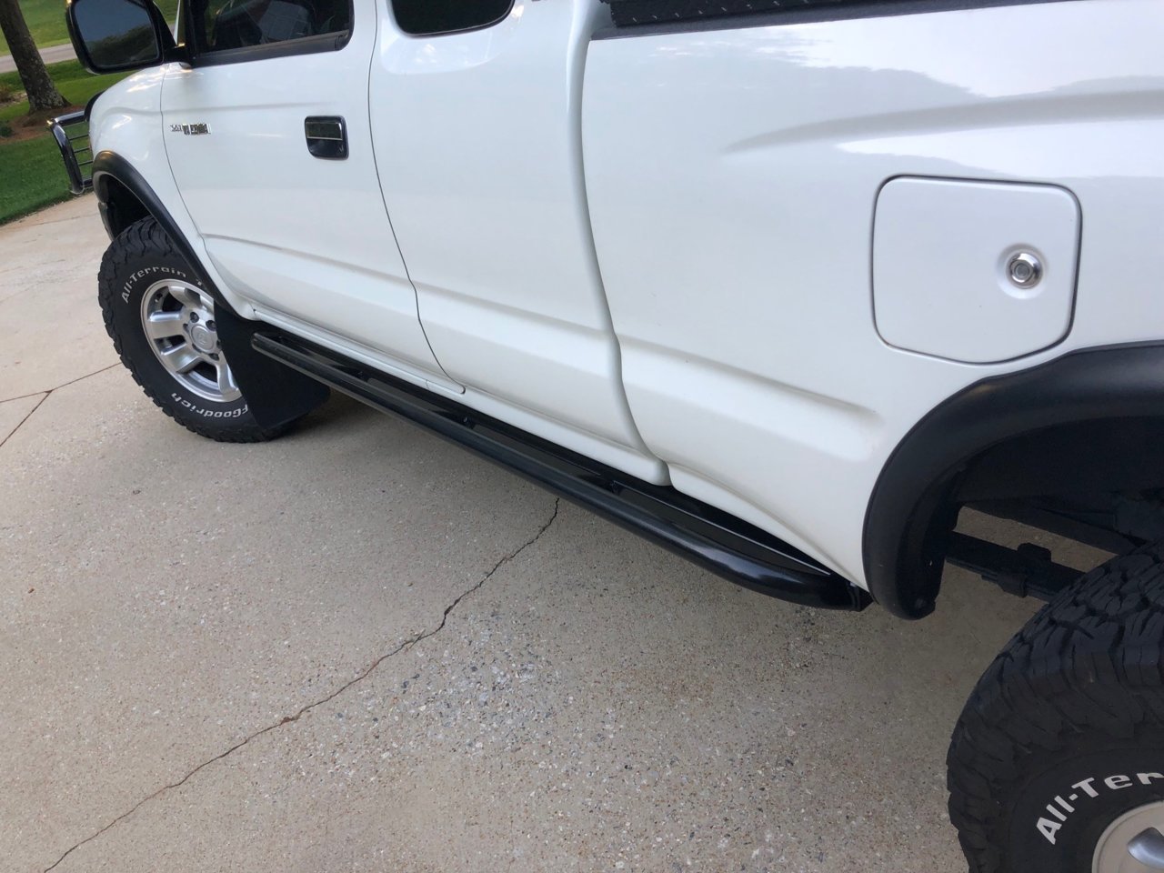

    Finally got my Shrockworks rock sliders on. Some of the stick nuts were a real PITA to fish through the frame, but all is OK in the end.
    Shrockworks 1st Gen Rock Sliders 2.jpg Shrockworks 1st Gen Rock Sliders 3.jpg

    Too bad they don't make them for a regular cab.

    It probably wouldn't be too hard to modify a set, but too much investment to be fitting yourself.

    Just the 8.4 semi float housing they make non ABS.
    Replacement for my bent current 8.4 housing. Shouldn't have issues with bending this one hopefully.
    Same stock config with E-brake and drum housings and whatnot.

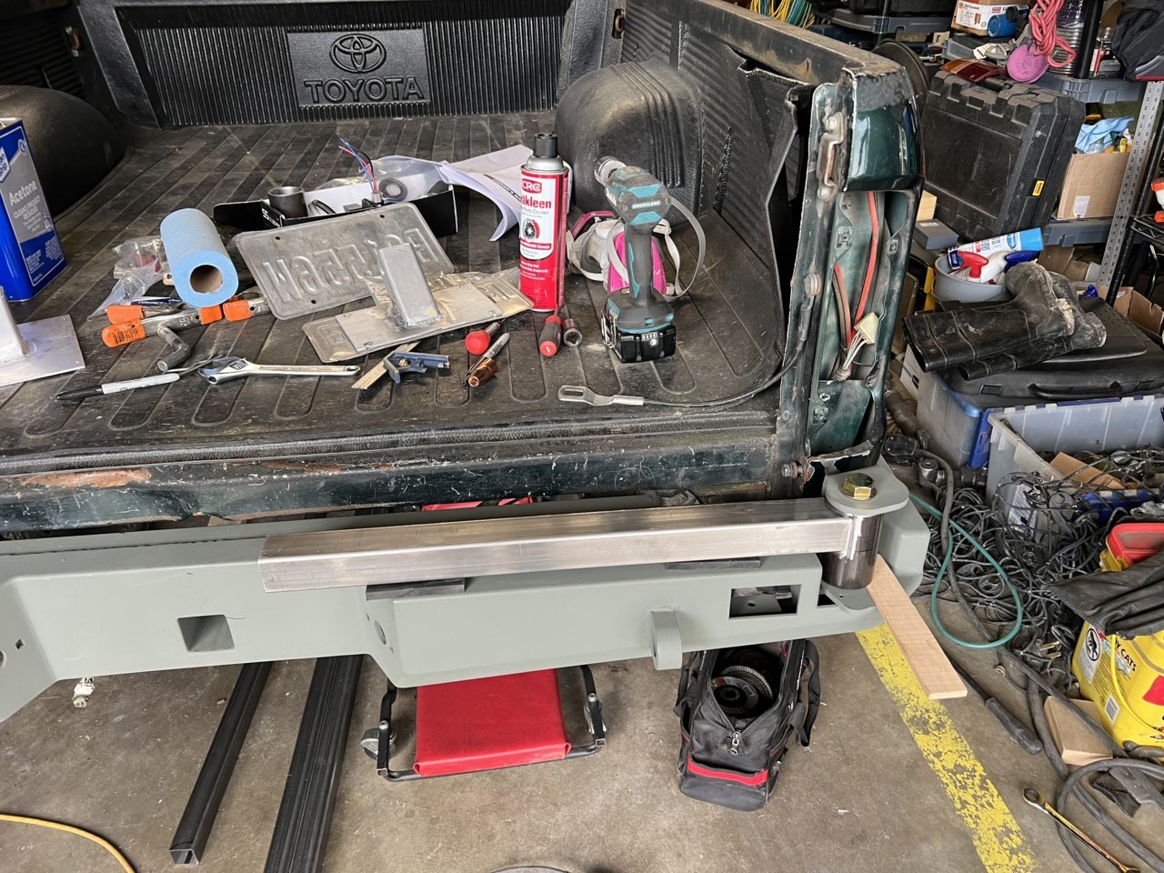

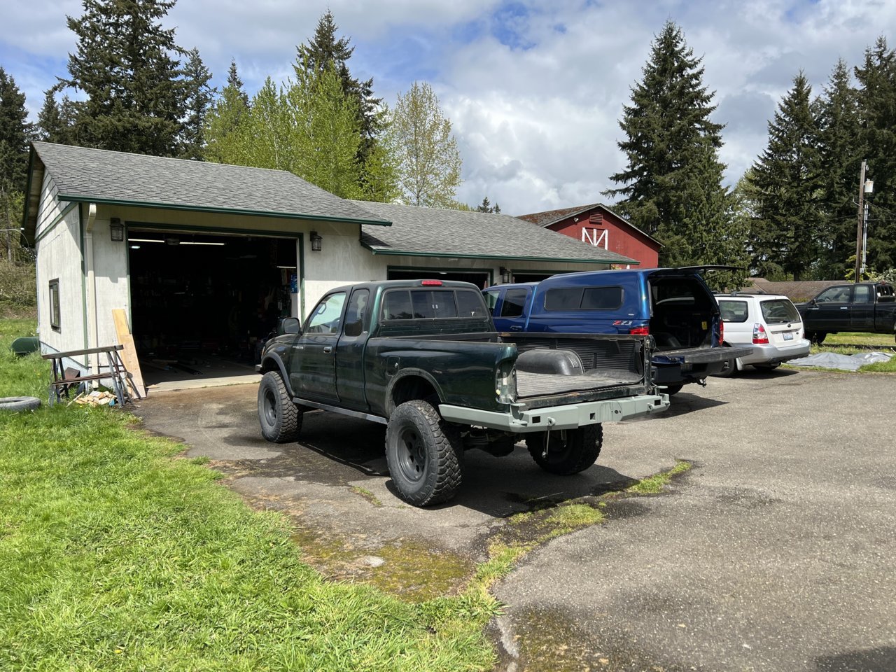

    Everything is just tacked but what's the popular opinion on sliders. I have the 4xinnovation with the kickout, my question is do you keep the outside rail flush with the wheels or closer to the cab.

    Flush with the wheels is best/preferable. Gives a smooth transition if you are against a bank/log/rock from tire to slider to tire again. Too close to the cab means whatever you are rubbing against will go inwards and then need to be pushed out again. The kick out can only help so much with that.

    Outside rail flush with the flares or there about offers good protection and a step, even though may look odd without big tires/small offset wheels.

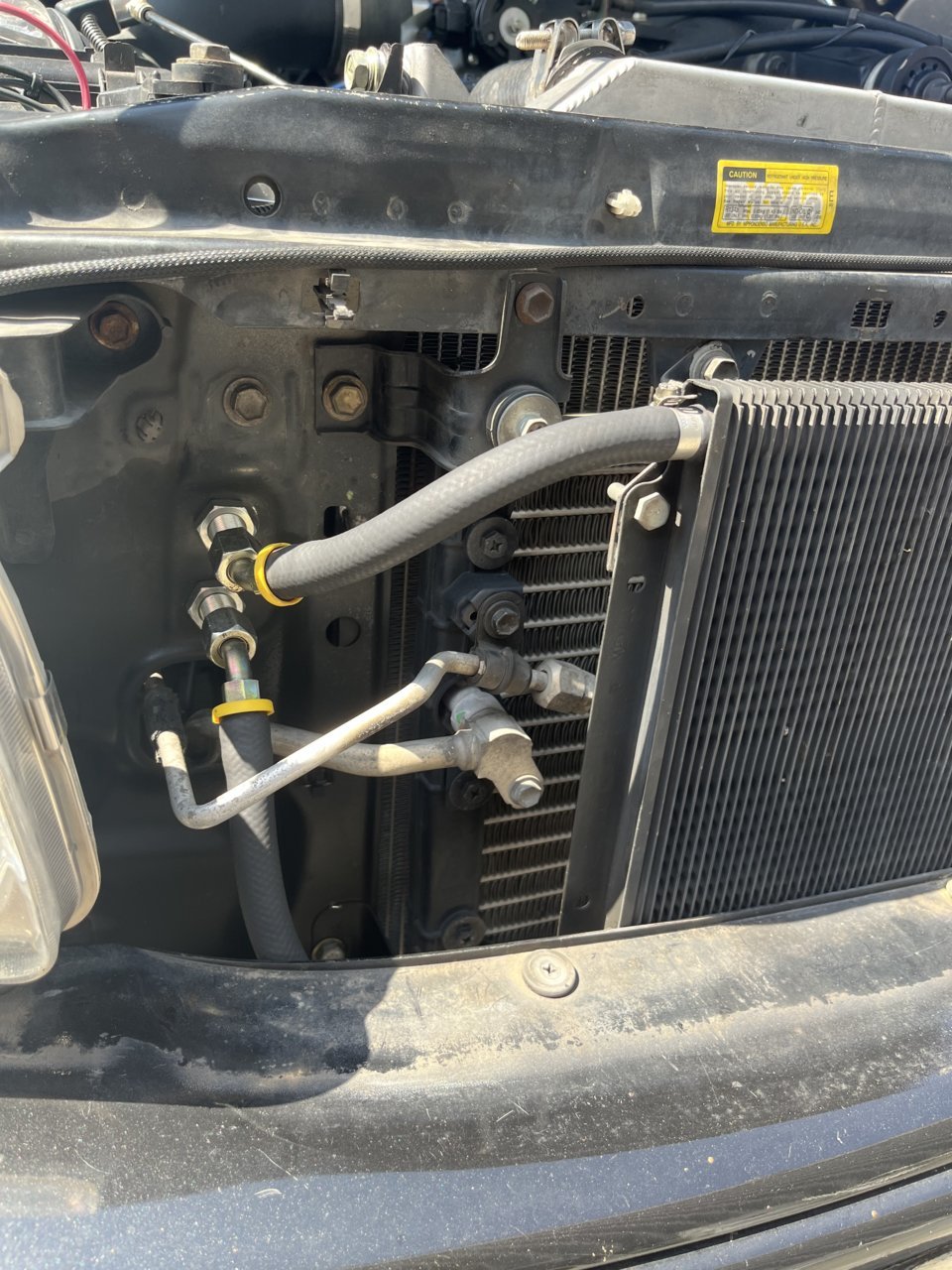

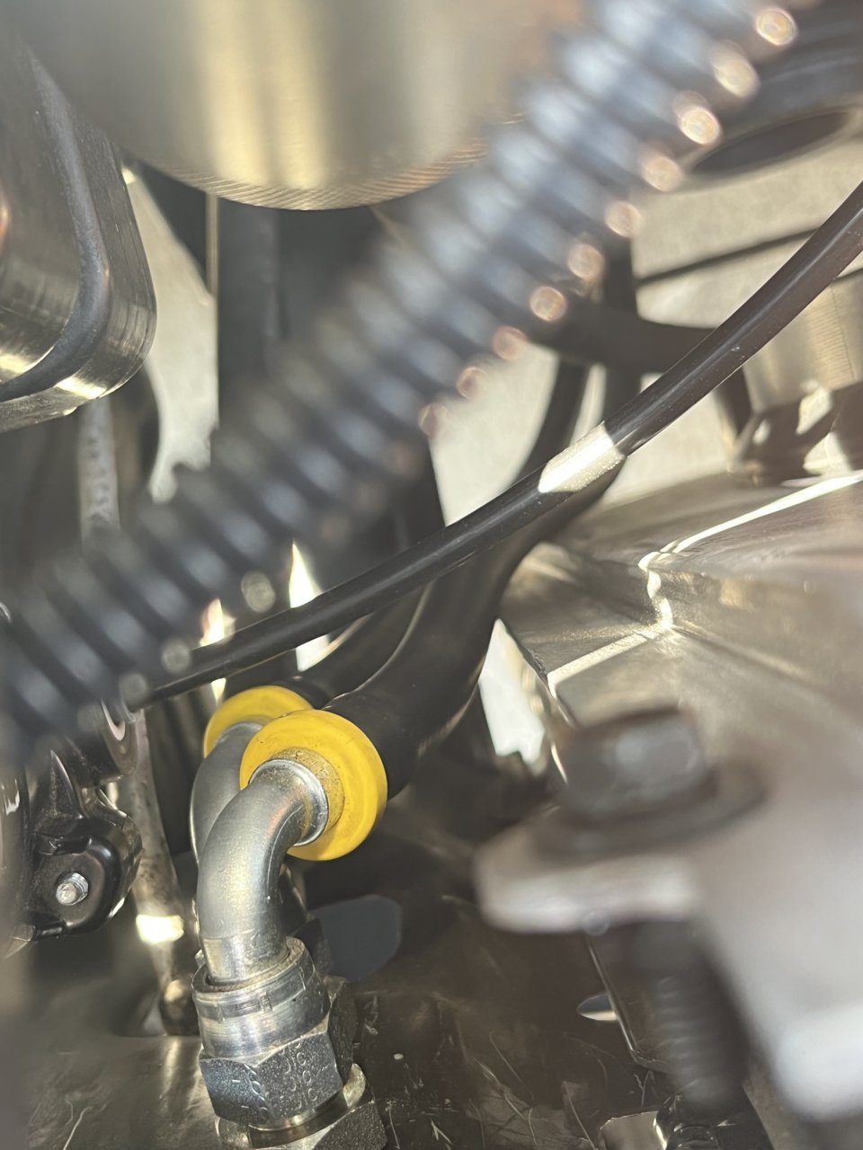

    Damn I need one of those elbows

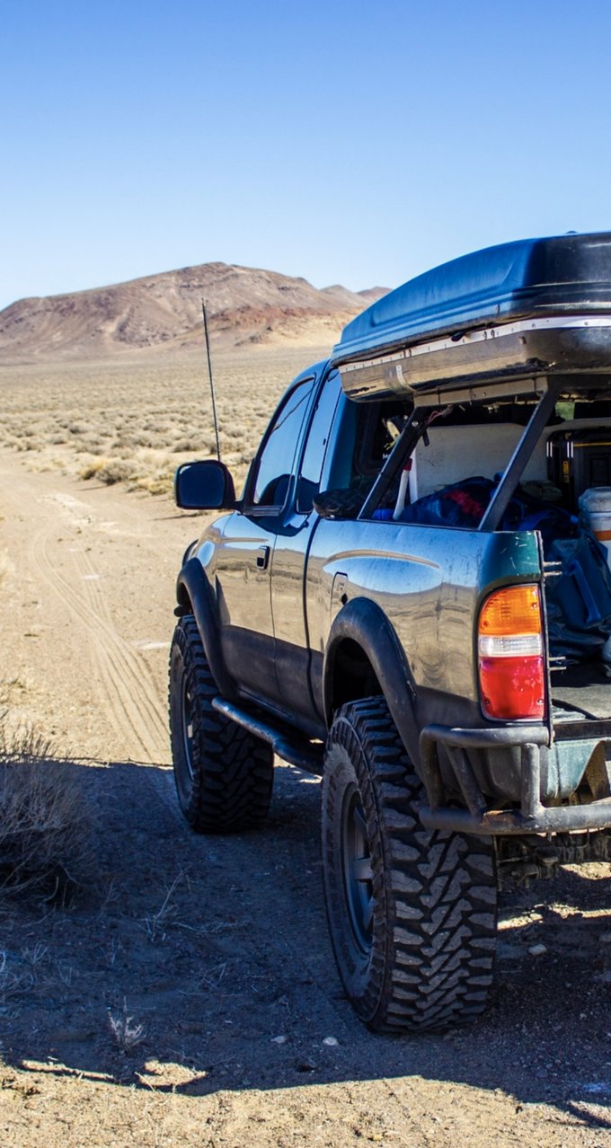

    I've waffled back and forth on rock sliders for long enough. Maybe I'll get some feedback. Originally I planned to just go with some 1/8in square tubing welded to the frame like I had in my 01 tacoma years ago
    I think the square or rectangular tubing looks better with the angels of the plate bumpers. it works great for a step and protects the cab a little from rock chips. It's also the budget friendly option.
    I could double down on the All-Pro Apex sliders and keep all my current trail armor the same brand.
    And with the fill plates it should still help protect the cab from rock chips and work well as a step. (price includes powder coating)
    And then of course there's 4xinnovation as we've just seen recently above but I still think I would do the fill plates
