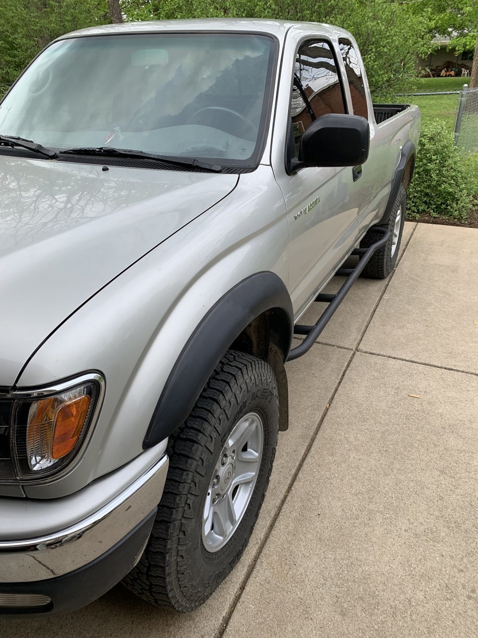

    My cbi sliders with the kick out sit pretty far out and I actually like it a lot, it’s saved my body panels quite a bit. But closer to 15 degrees. The tucked look does look slick tho.

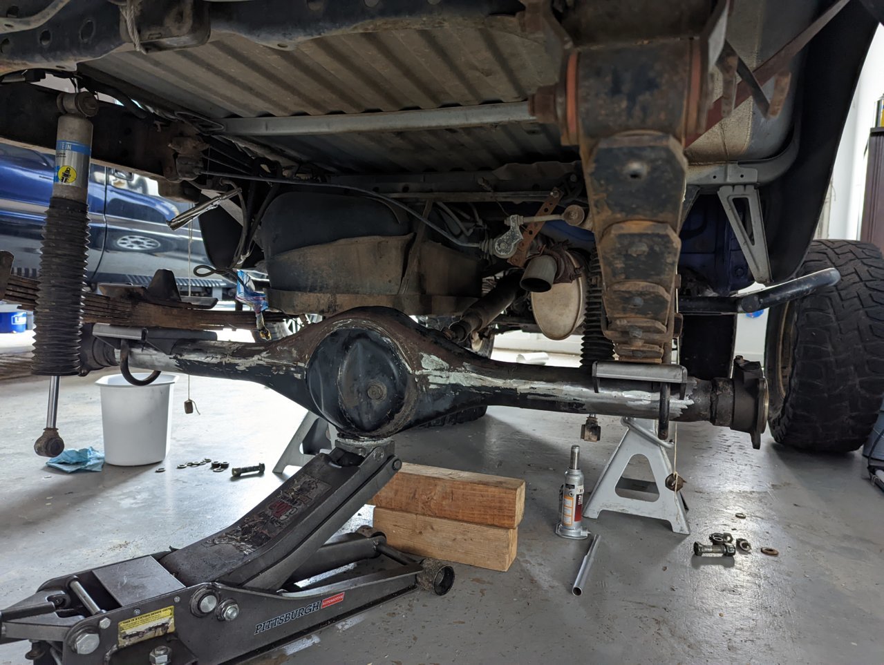

    Those bolt threads are gonna chew up that eyelet bushing real good. Unless there's a metal sleeve that's not shown.

    Yeah it's already beating up the bushing after a few years. I don't think there was a 3/4 bolt with a longer shoulder available without ordering a box of 20 when I needed it

    Yeah thats not gonna be great for your lower bushings...which also I hope you are replacing. thing looks pretty chewed. But any new bushings on the bolt and it'll die a fast death.
    Or you can run a sleeve which will help. The threads will eventually wear down likely and not work great.

    yeah, I'll dig around at Ace and see what I come up with. Maybe I still have the original spring plates and can cut the shock mount off of those.
    if not I'm not too worried. When i wheel this truck it gets trailered. It think I've put like 1000 mi on it in 3 years. it'll hold me over til I get the energy to commit to a new rear axle LOL
