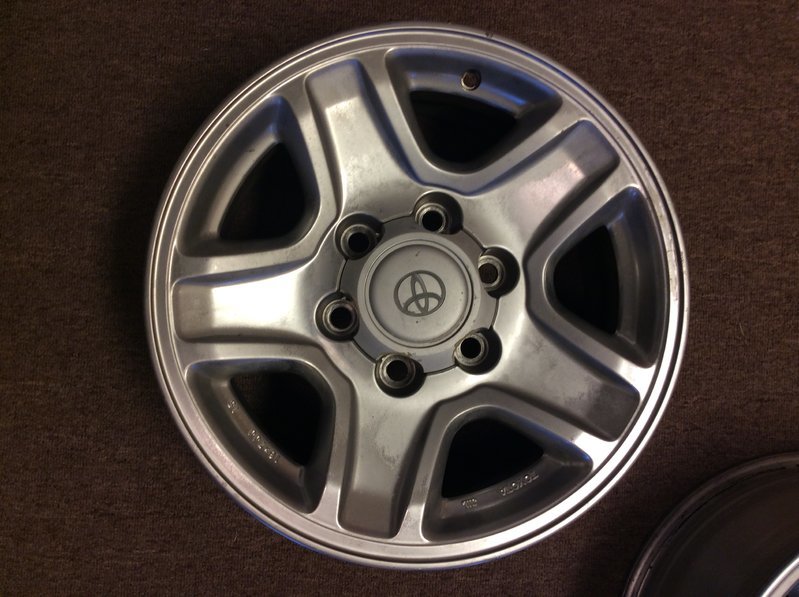

    Yeah lol the one above is my old truck though, the TEs lugs are in center circle, im not even sure if they line up with the spokes... I had a car with three spoke wheels and 5 lugs too, weirdly it doesn't affect strength.
    Huh look at that they do, never looked before. Not bad for $100 wheels haha
    But I was never anal enough to look and see if my D window steelies on my other tacoma had lug holes that corresponded with D window holes or to see if my land cruiser OEM 5 spokes had any lug hole alignment. You'll give yourself brain cancer doing shit like that.

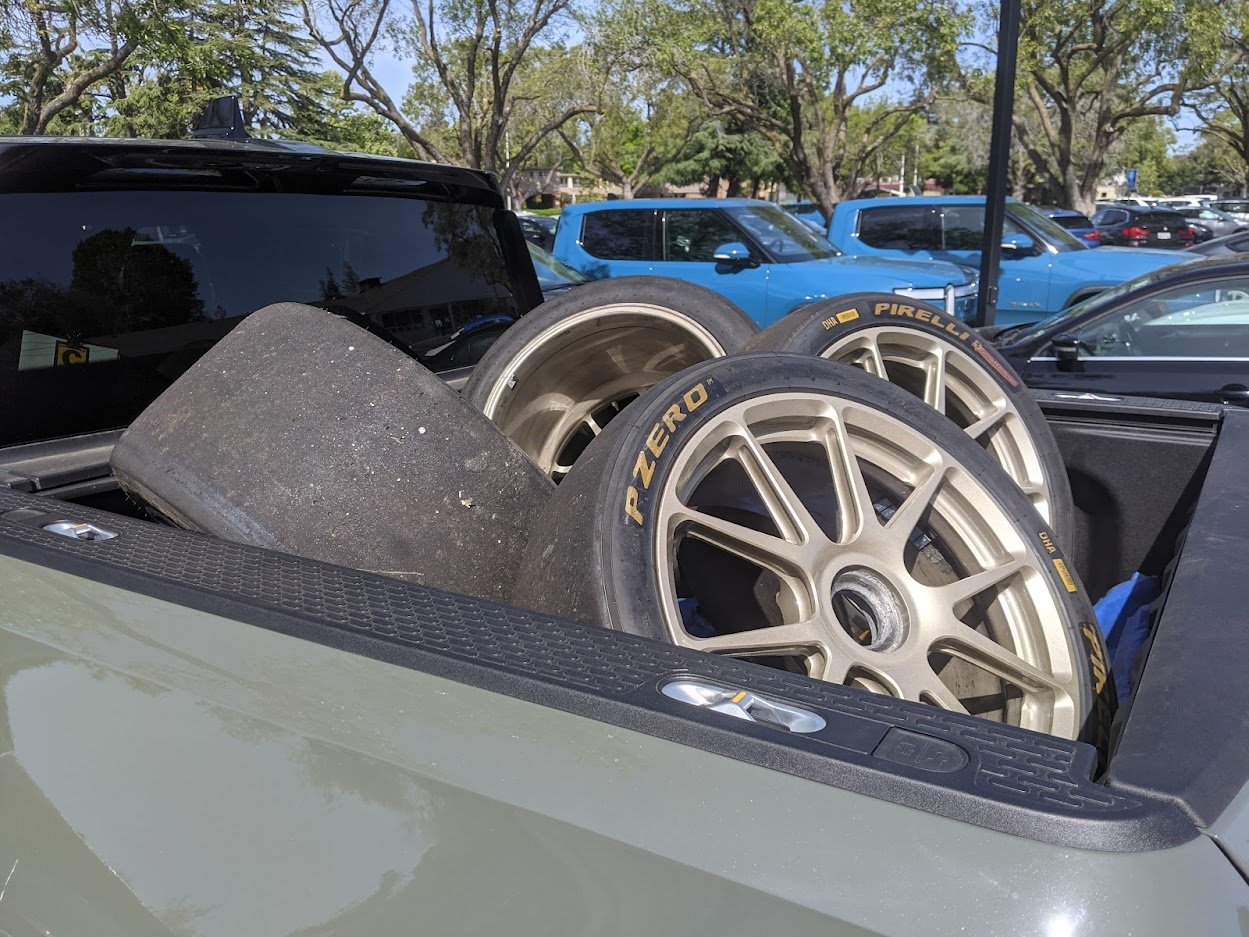

    Easy solution: all cars should have centerlocks

    I kinda like that option actually, would make wheels way easier to fit up on different platforms. Reminds me of Daytons haha

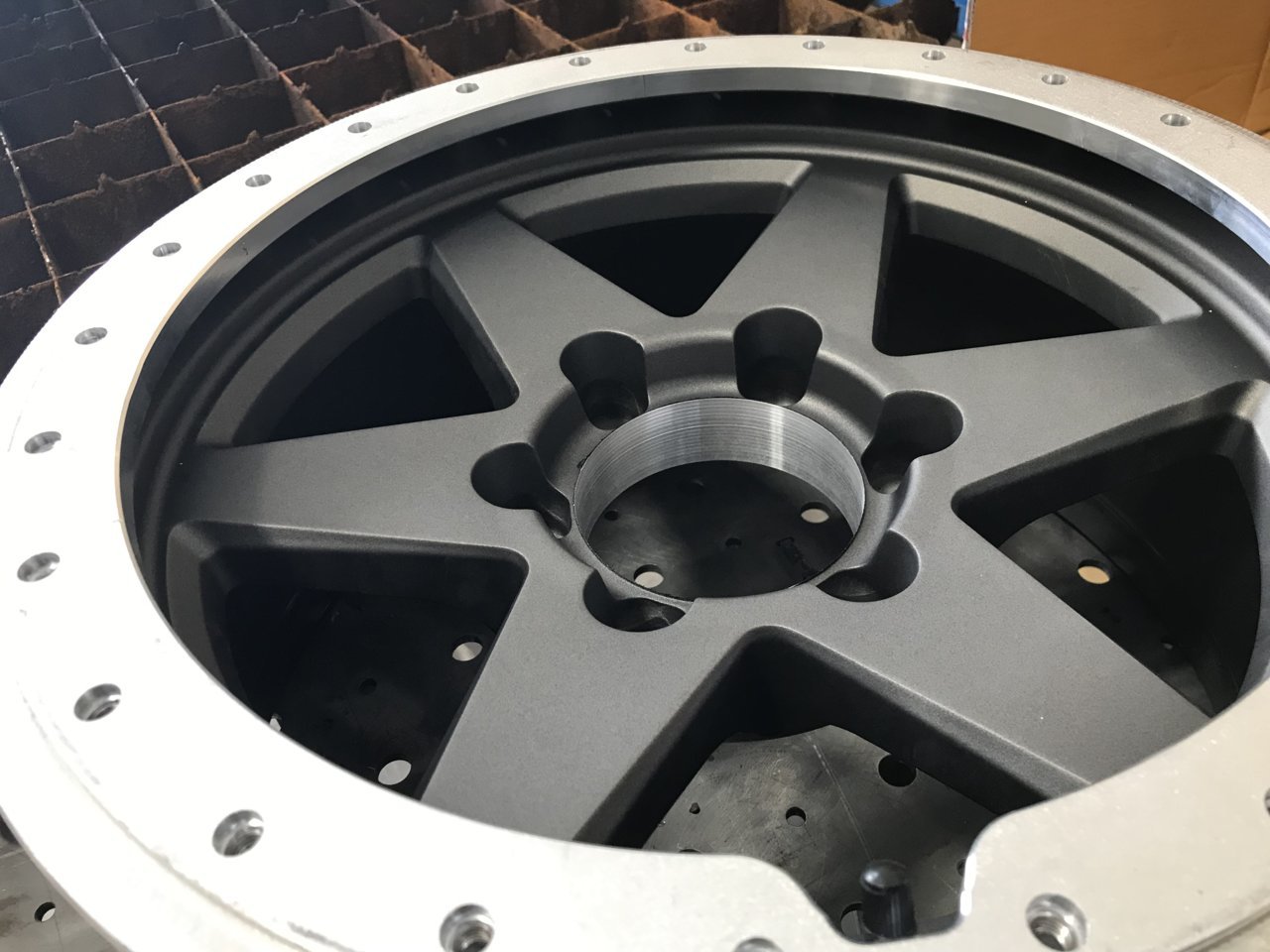

    I was all about the F5’s until the BR6’s came out. The F5’s still look great, don’t get me wrong. But the BR6 has that perfect symmetry, and the more angular lines match my truck better imo.
    Matte gunmetal with flat black OMF beadlocks and custom center bore.

    6 spokes for 6 lugs is prime. Looks great!
