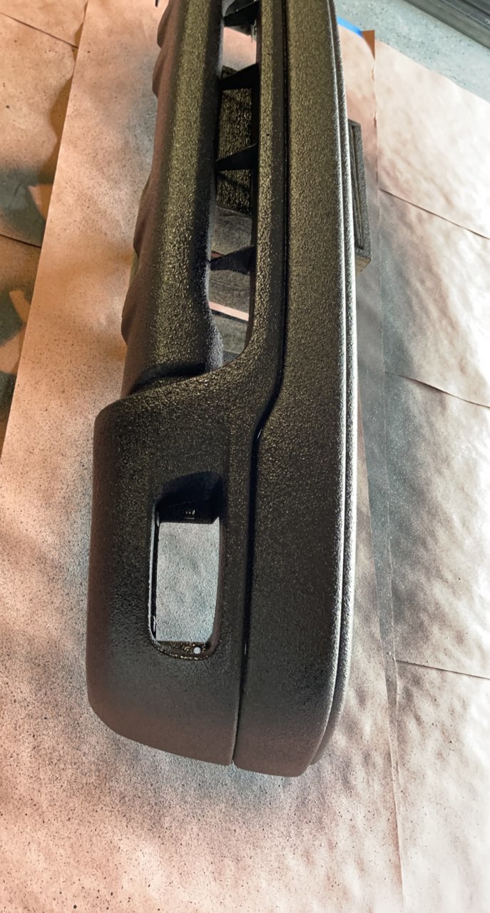

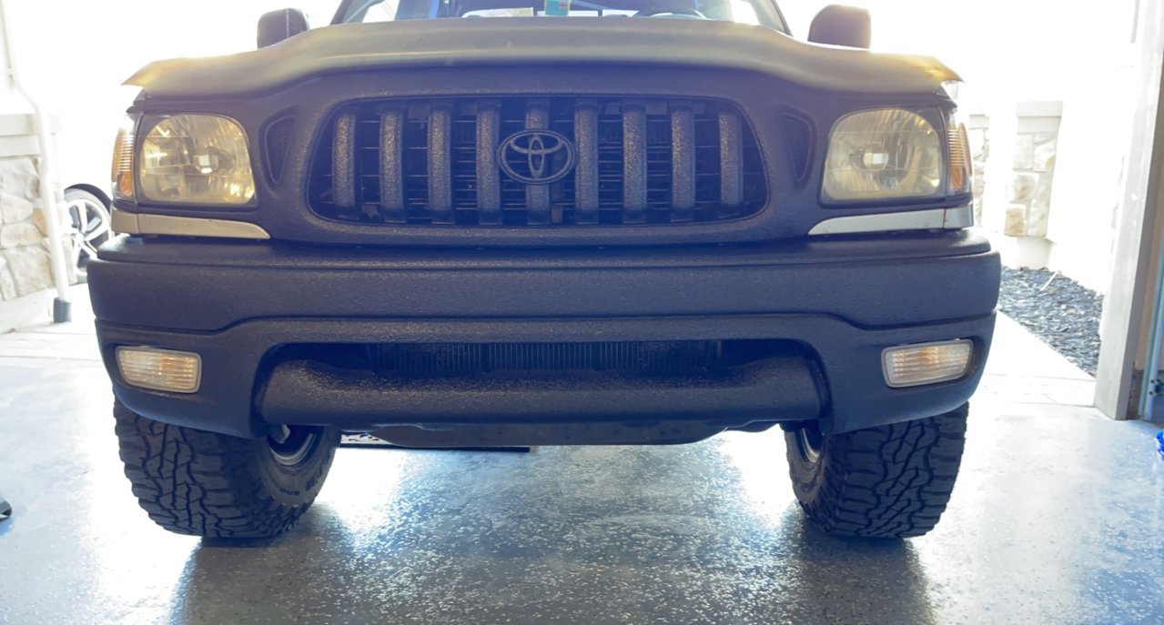

    B2A84896-9576-4903-8E2F-AC6ED439F0FB.jpg Raptor Lined front/rear bumpers, grille, and fender flares..here’s just the front bumper..

    post a Pic after it’s reinstalled, what was the prep work?

    AFCFF4C7-49AA-4B21-AA26-1B3EF880EF2F.jpg 1. Wash/Degrease
    2. Sand it down 120 grit all the way
    3. Wash again
    4. Acetone to make sure I got everything
    5. Raptor Liner Bed Liner Kit..compressor shooting around 50 PSI, hour between coats (2 coats)

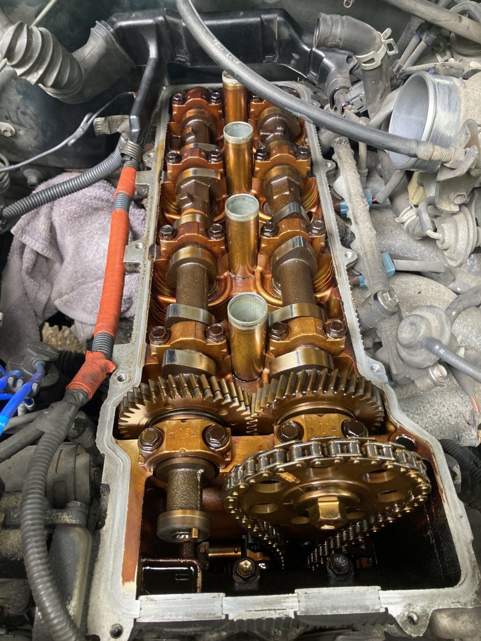

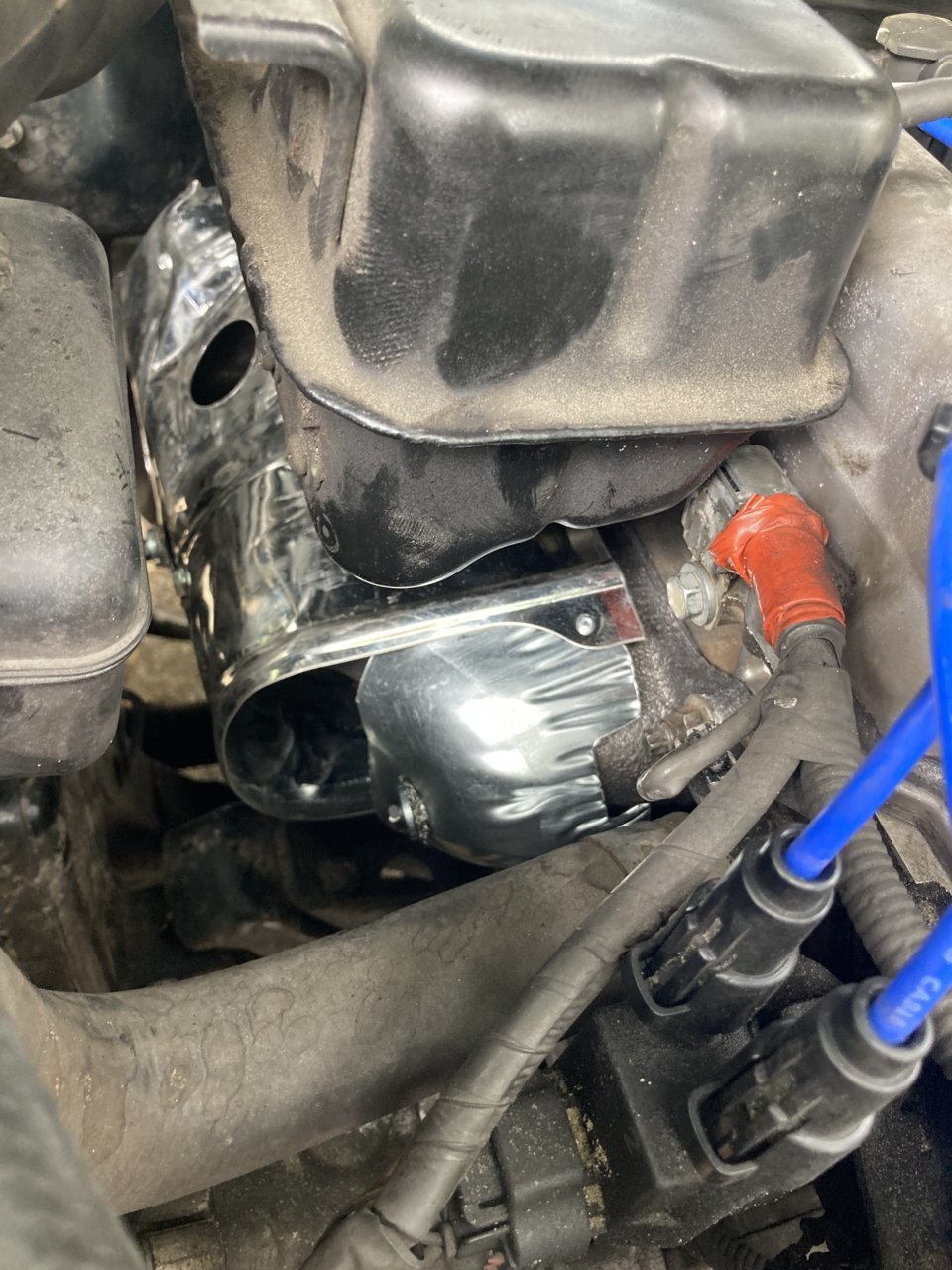

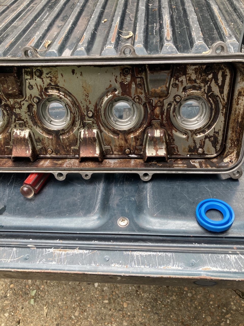

    Replaced valve cover gasket, spark plug tube seals, and exhaust manifold.E3B5EEB0-461B-4851-8511-E1B75543E650.jpg1B7622B9-E374-4FE5-8DB6-D40E77D7B1DC.jpg8B61944F-93D3-490F-90E3-986CB61832B4.jpg

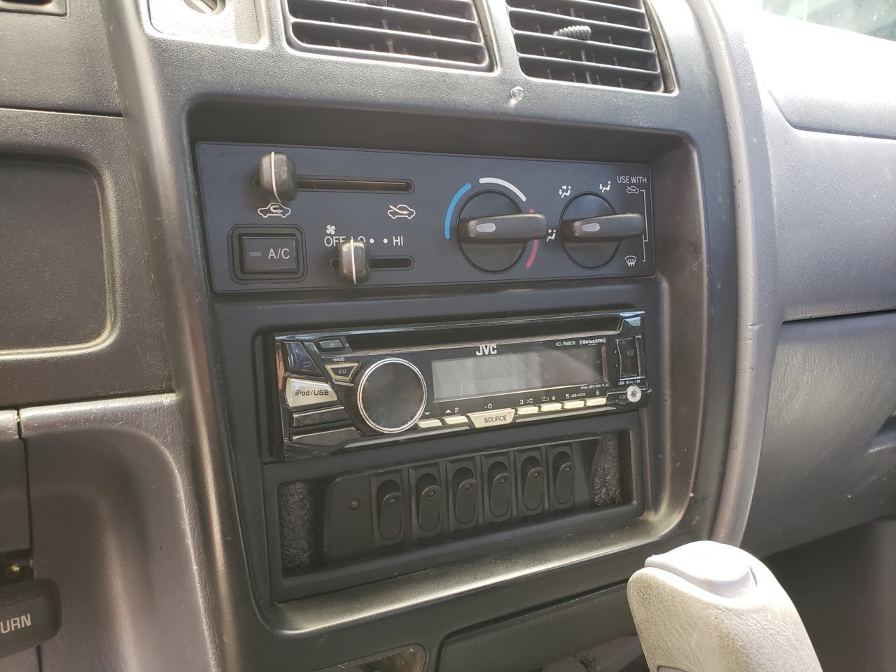

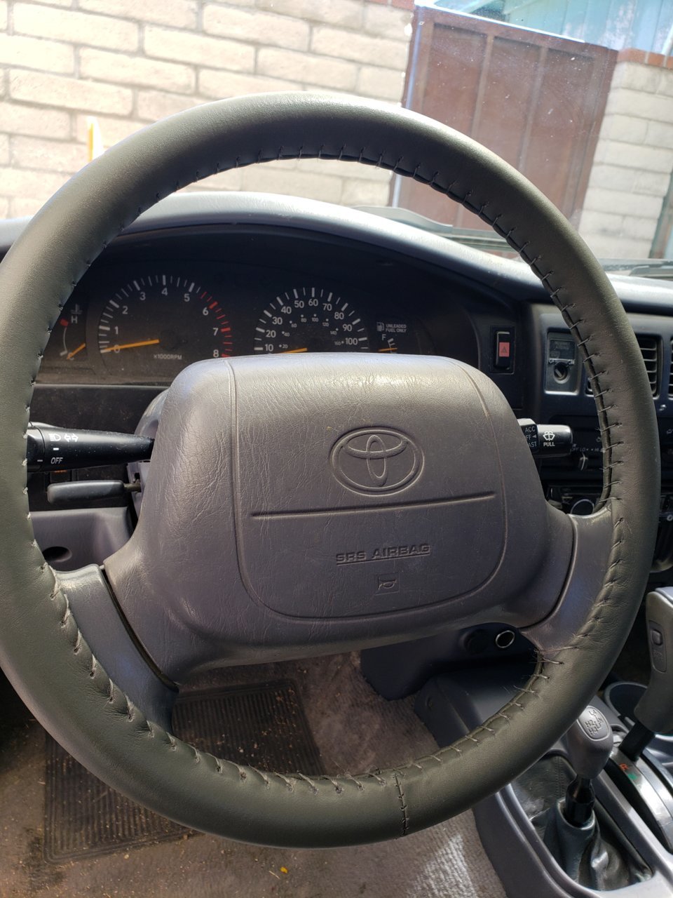

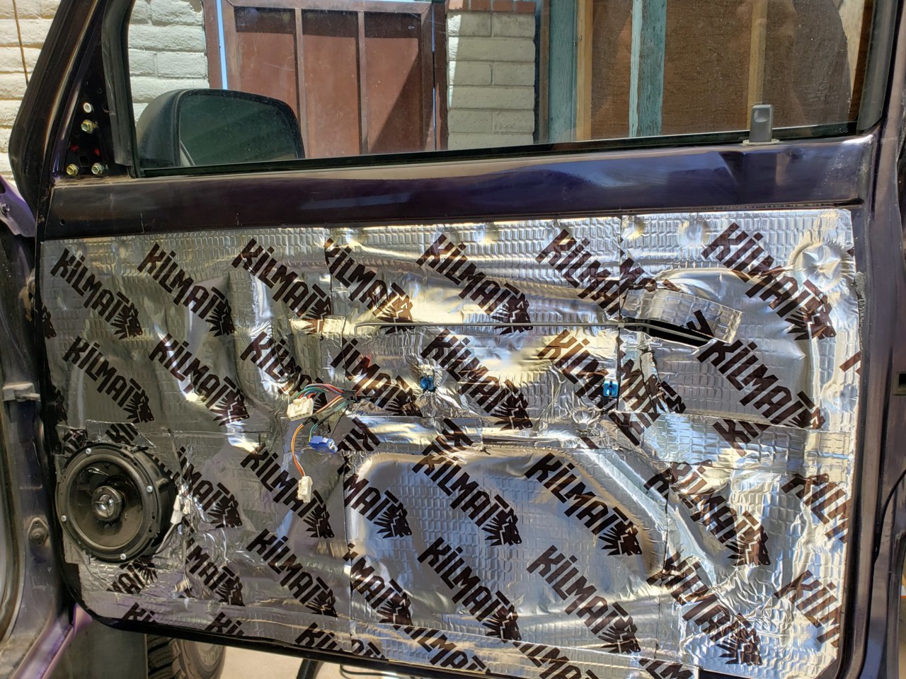

    Finally got around to putting sound deadener on the passenger door. Put in new door lock while I was at it, on both driver's and passenger doors. Steering wheel cover done, the Wheelskins take a while but they certainly don't slide around, and summer is coming in Tucson. Also, switch panel is in.20220507_124155.jpg 20220507_105322.jpg 20220507_105332.jpg
