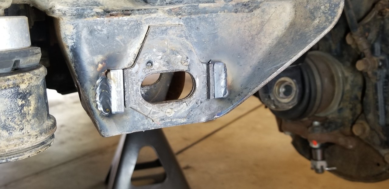

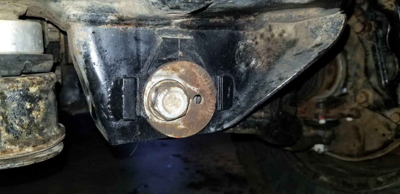

    The part that stands out to me with that project was trying to get the control arms back in. My mounts are bent and things were tight. If I had an air chisel I don't think it would have been a bad job at all to remove the old tabs.

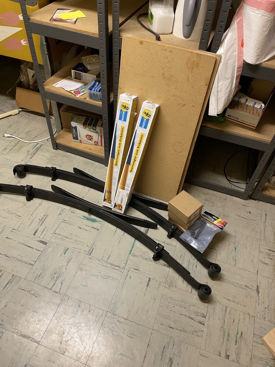

    Many Thanks! This information will be helpful when I head down this road. I bought an OEM e-lock rear axle off a junked Taco a couple months ago. I already have newer Bilsteins, but plan to do the leafs and other stuff when I swap out the axles...if I can ever find the time to do it!
