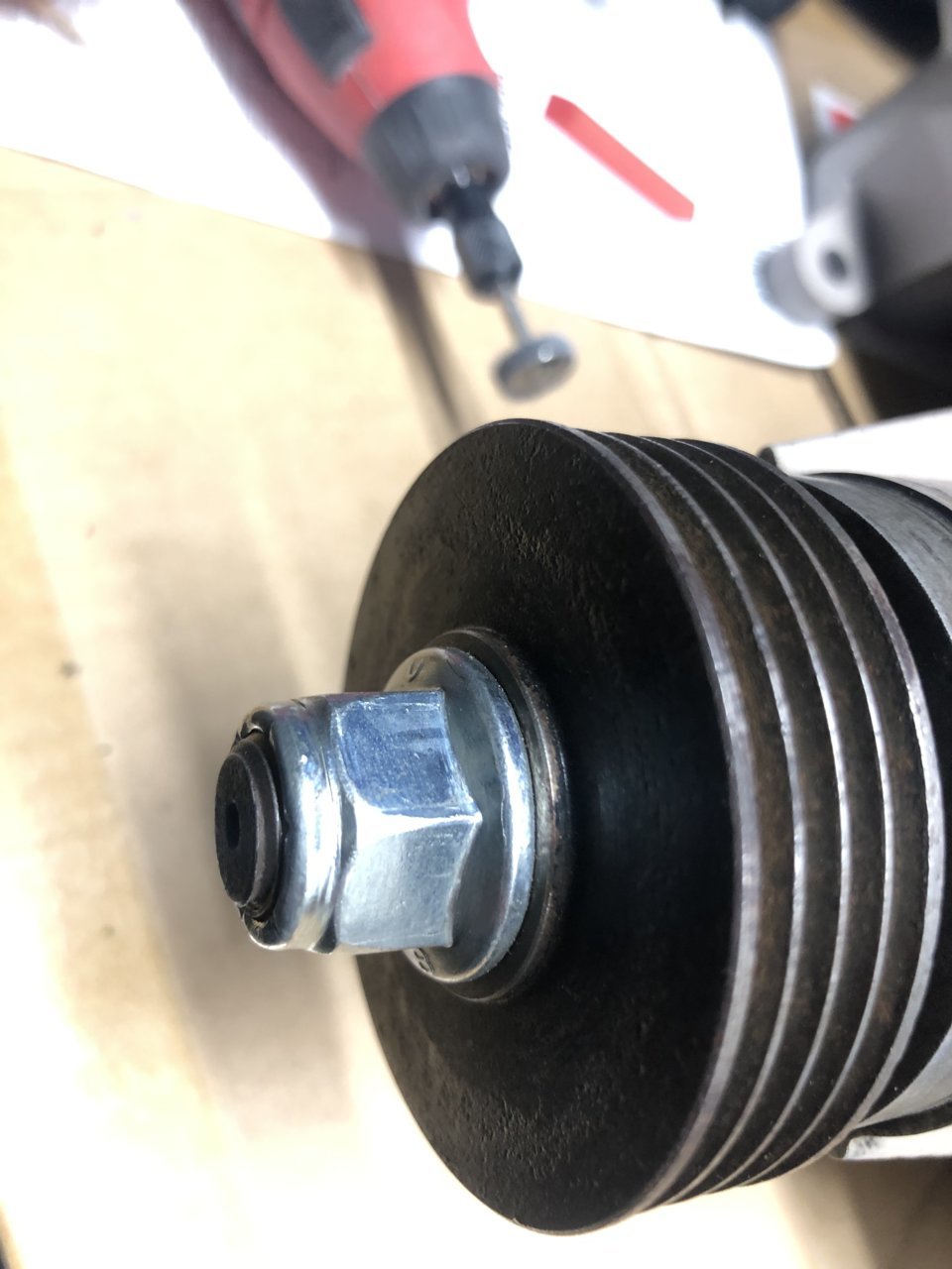

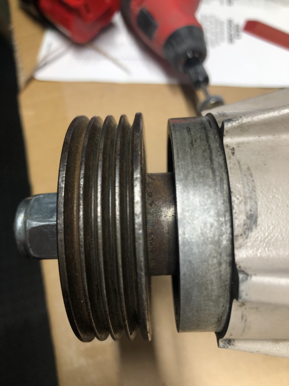

    lol.geez. Fucking feel like a donkey. Threw that on right before rush packing. @Locot@co once the sc is on, zip off nut with the impact and flip it and put nut back on. Torque when the belt is on.

    the flat part is supposed to be on the inside. When you take off you will see. It has a rim that is supposed to be on outside.

    Rim looks to be outside

    Nvm got it. Thought you were referring to the rim a tad larger than the nut.. in other words the pulley is supposed to sit flush to the body of the SC

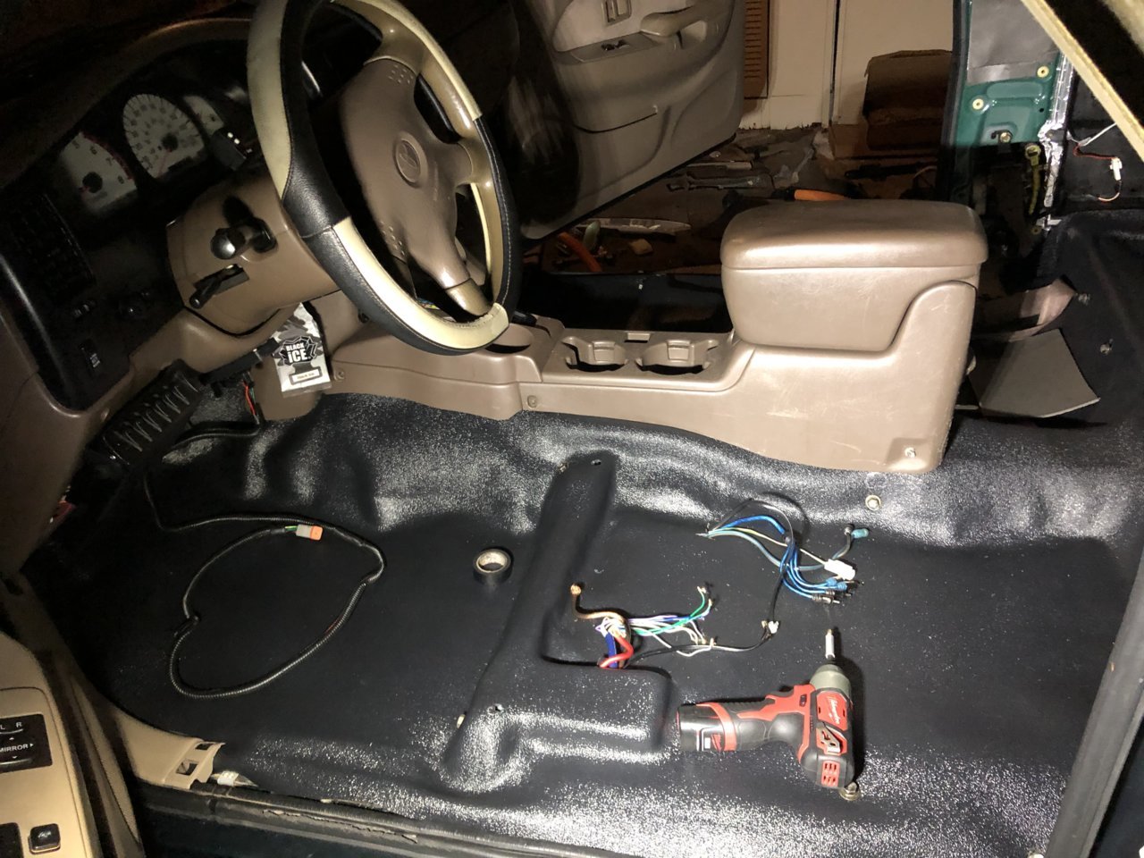

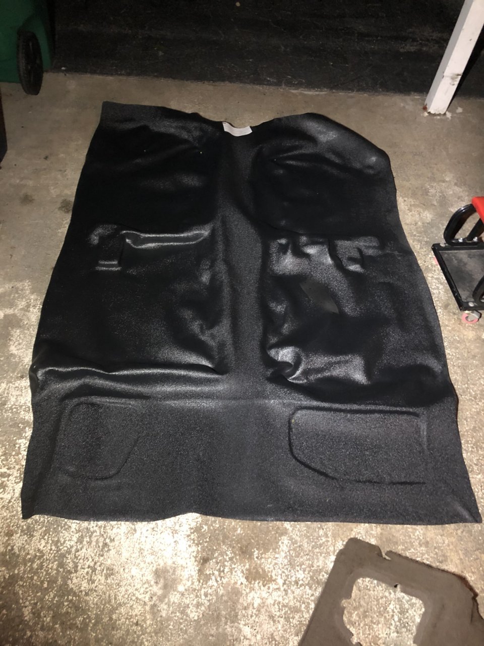

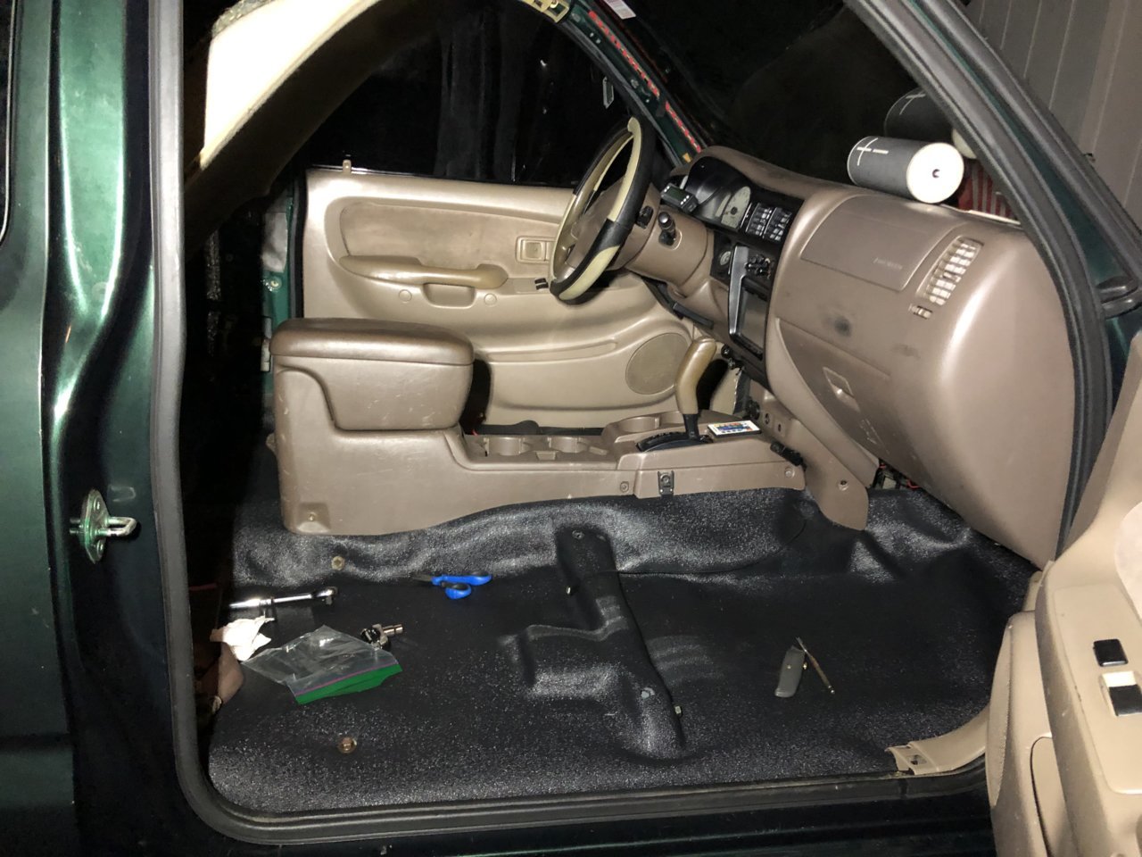

    Got the same kit from rock auto a little over a year ago.. Major PITA job… could’ve done a better job but was tired of it by this point…
    This is how it looked right after putting the center console in place. Will update after some time and use

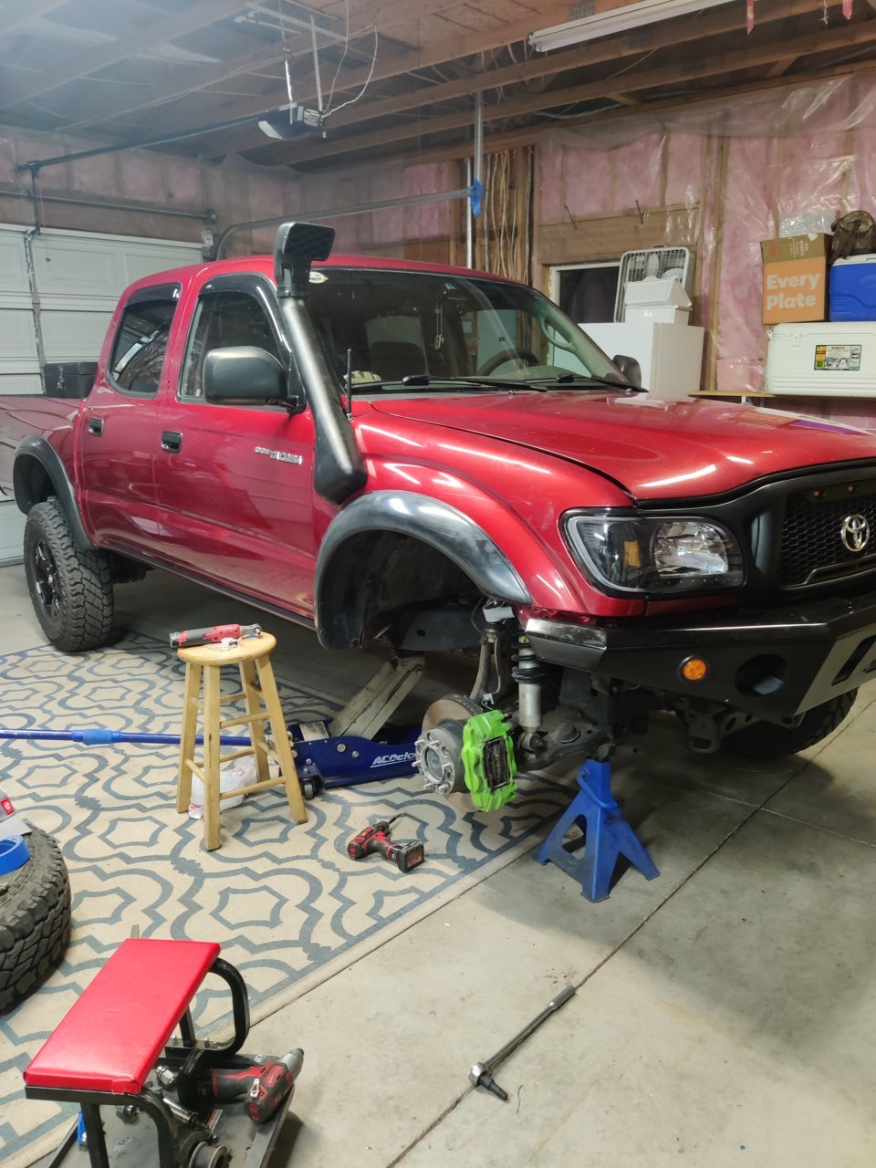

    Lucky this was my 2nd rodeo and the hole saw for the 2nd Gens snorkel is even bigger so there was a little less anxiety IMG_20220513_193445.jpg all the holes
    I wasn't expecting the Rivits to be a pain in the ass but my rivit gun busted and one of the studs for the rivets just disappeared into the A pillar to never be seen again. I haven't used rivits in forever and couldn't find any in the shop and had to go buy a box. Me trying to be a smart person I bought a new rivit gun and it snapped the 1st rivit in the wrong spot
    I got this Stanley MR99 second hand from my former father in law back in 2009 and it chose today to fail. Looks like the spring inside could use replacement and maybe that will fix it
