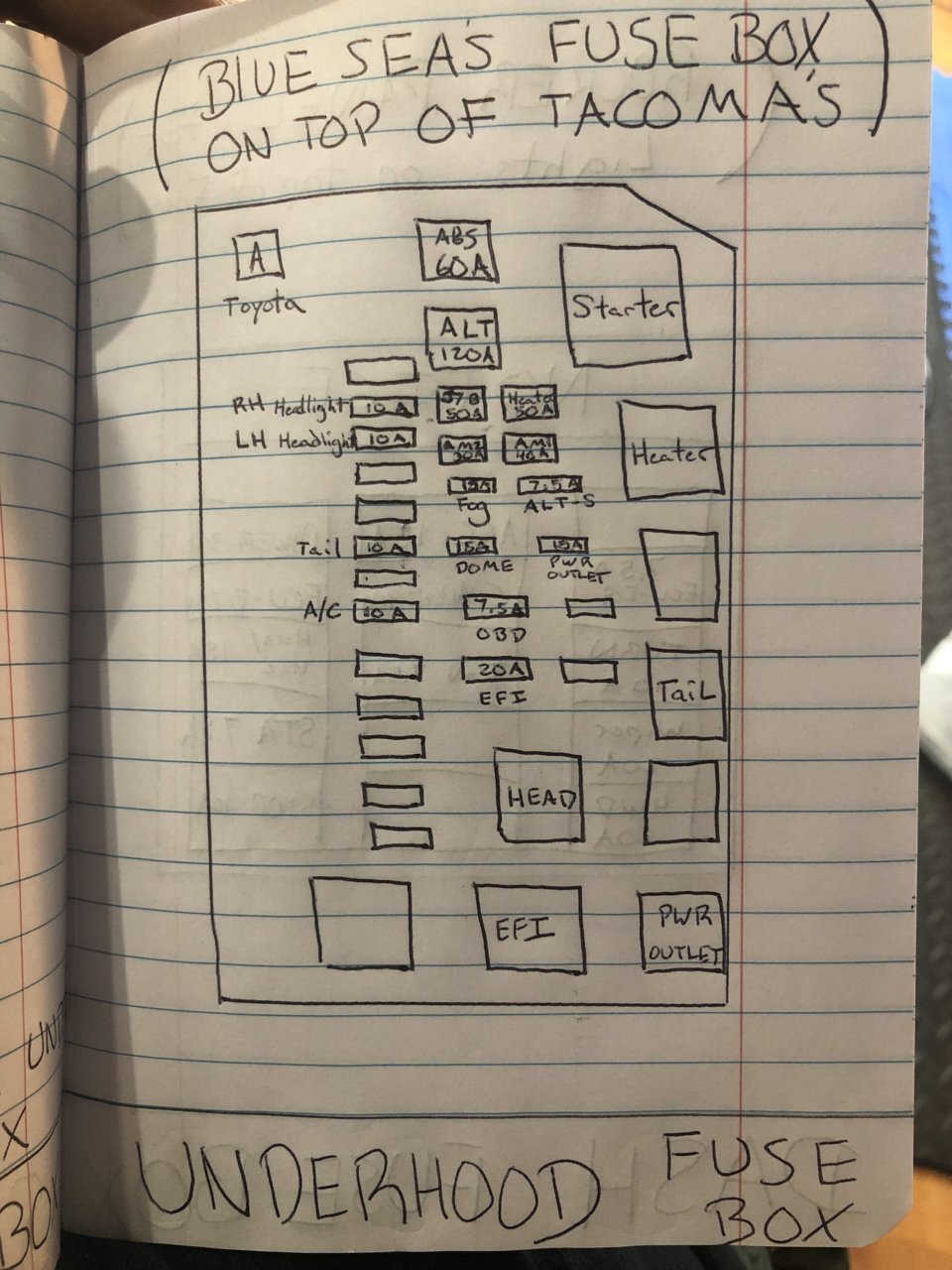

    I took a picture of that fusebox cover and keep it on every electronic device I own

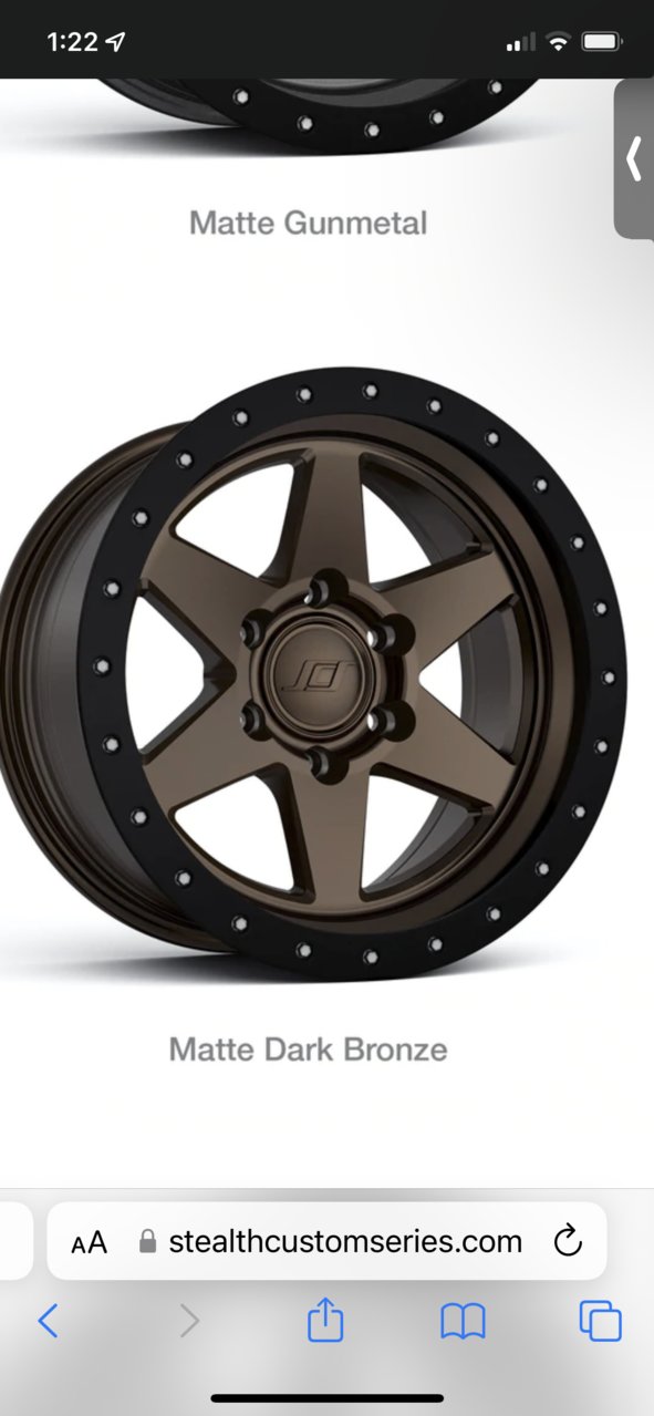

    Ordered new wheel! Hopefully the matte bronze on the lunar mist will look as good as I hope!4B66EC82-2093-44E3-911B-A305C29AEDC2.jpg

    Yea I have one in the trucks photo album on my phone also, but decided to get a journal to leave in the truck for reference 100% of the time

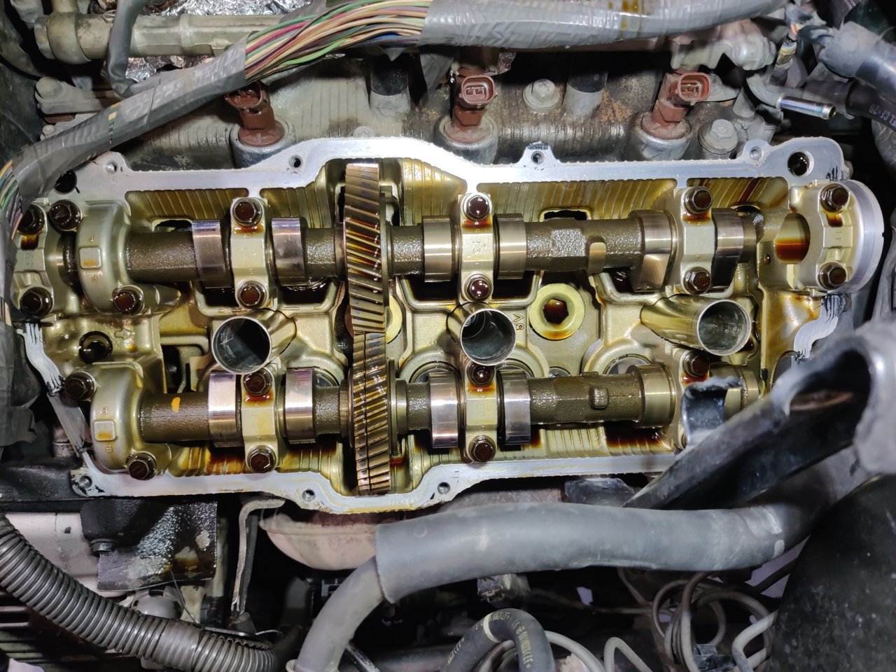

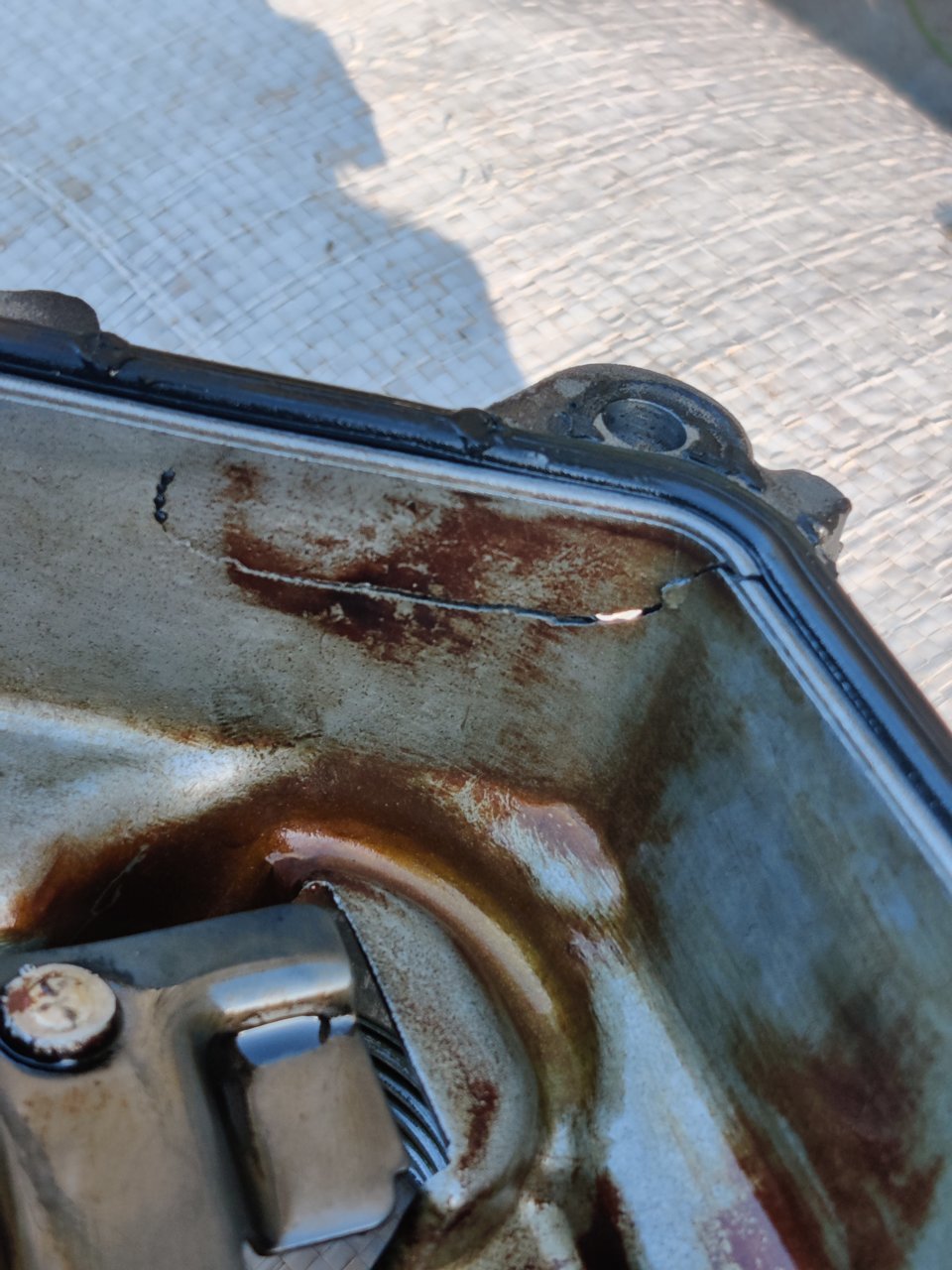

    The crack in my valve cover finally started leaking so I got busy this afternoon.
    I'm shocked it lasted almost 10months before causing trouble
    Not bad for 326k miles.

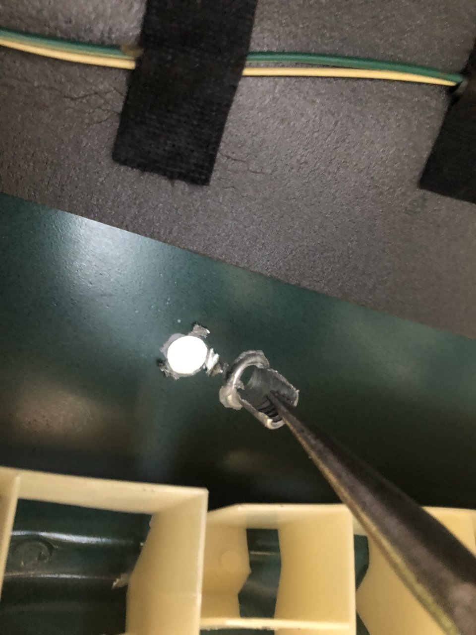

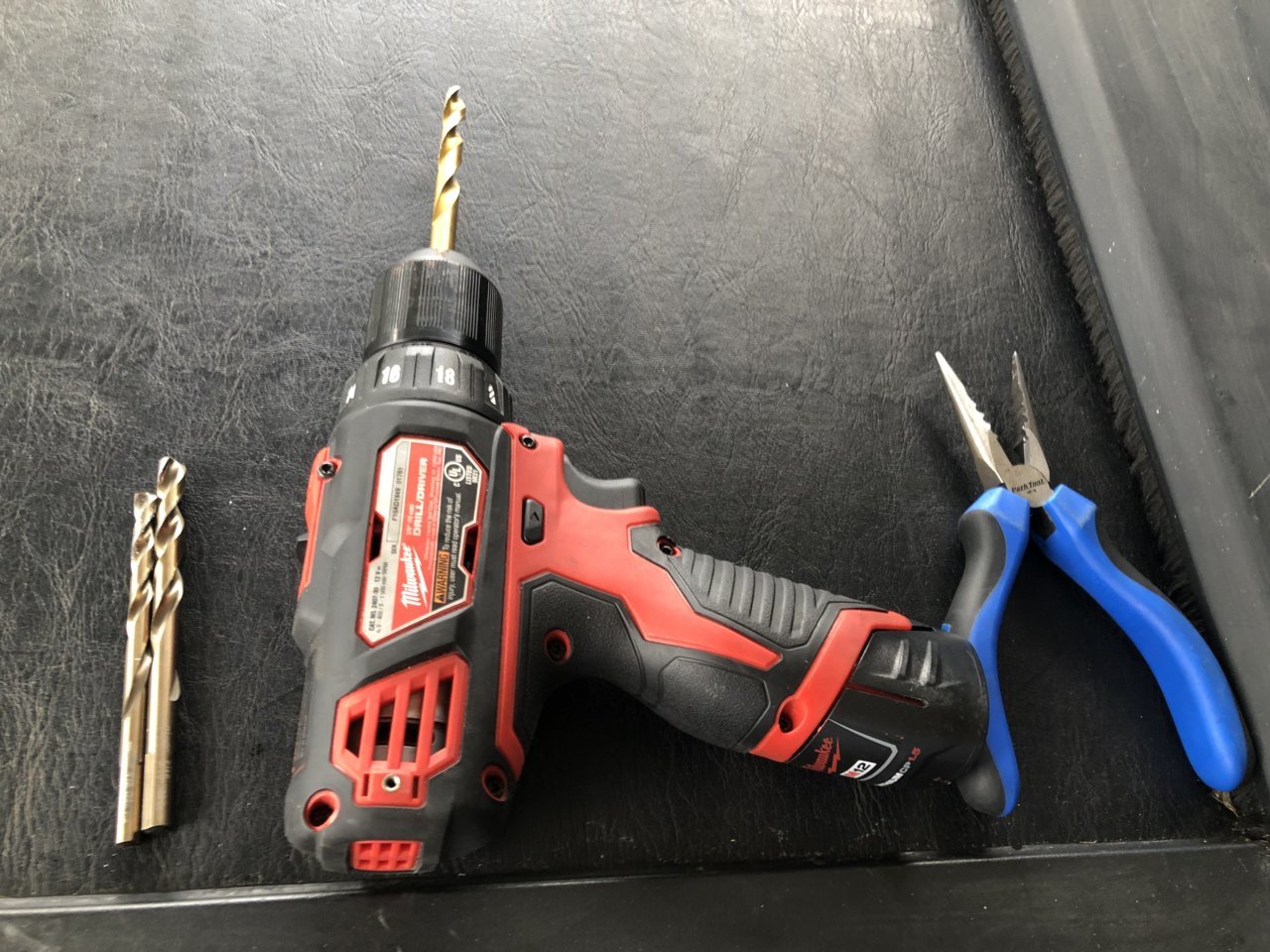

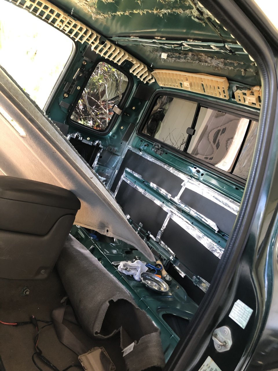

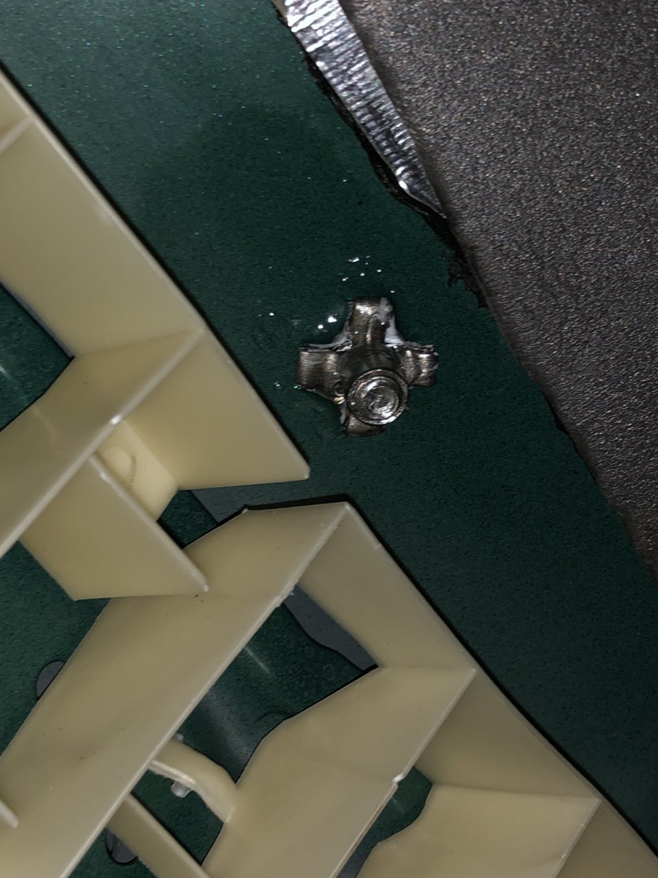

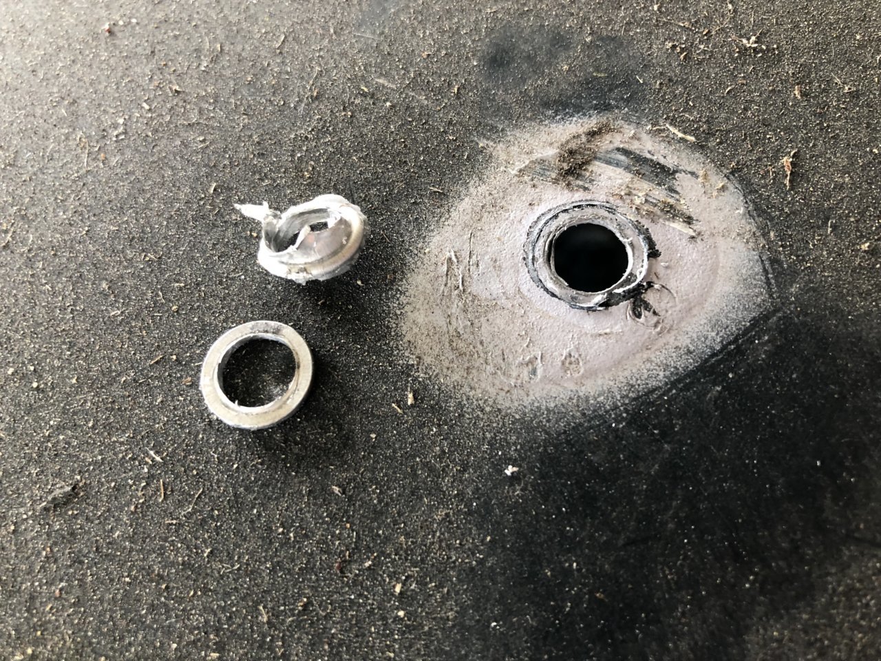

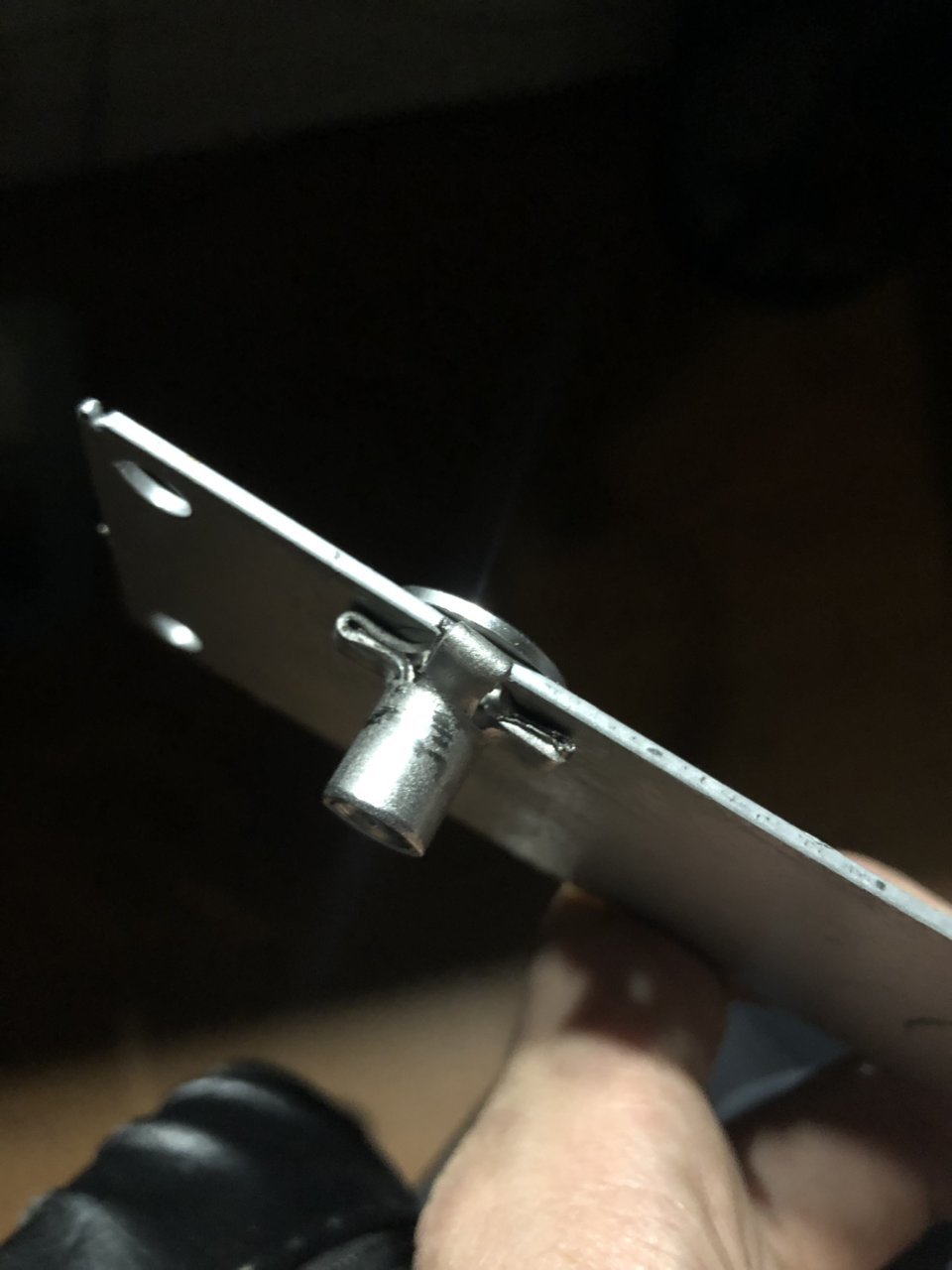

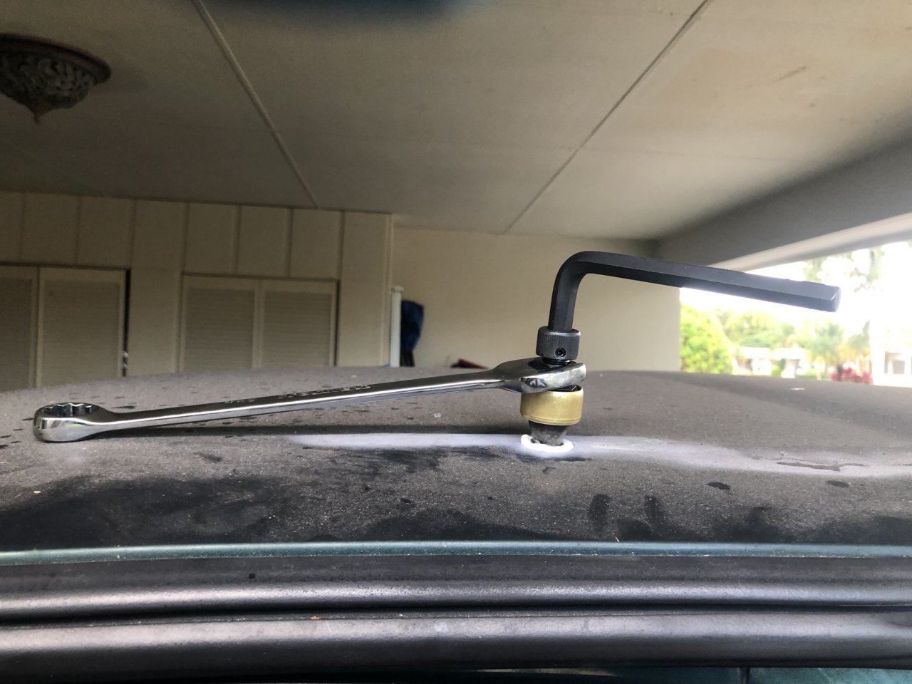

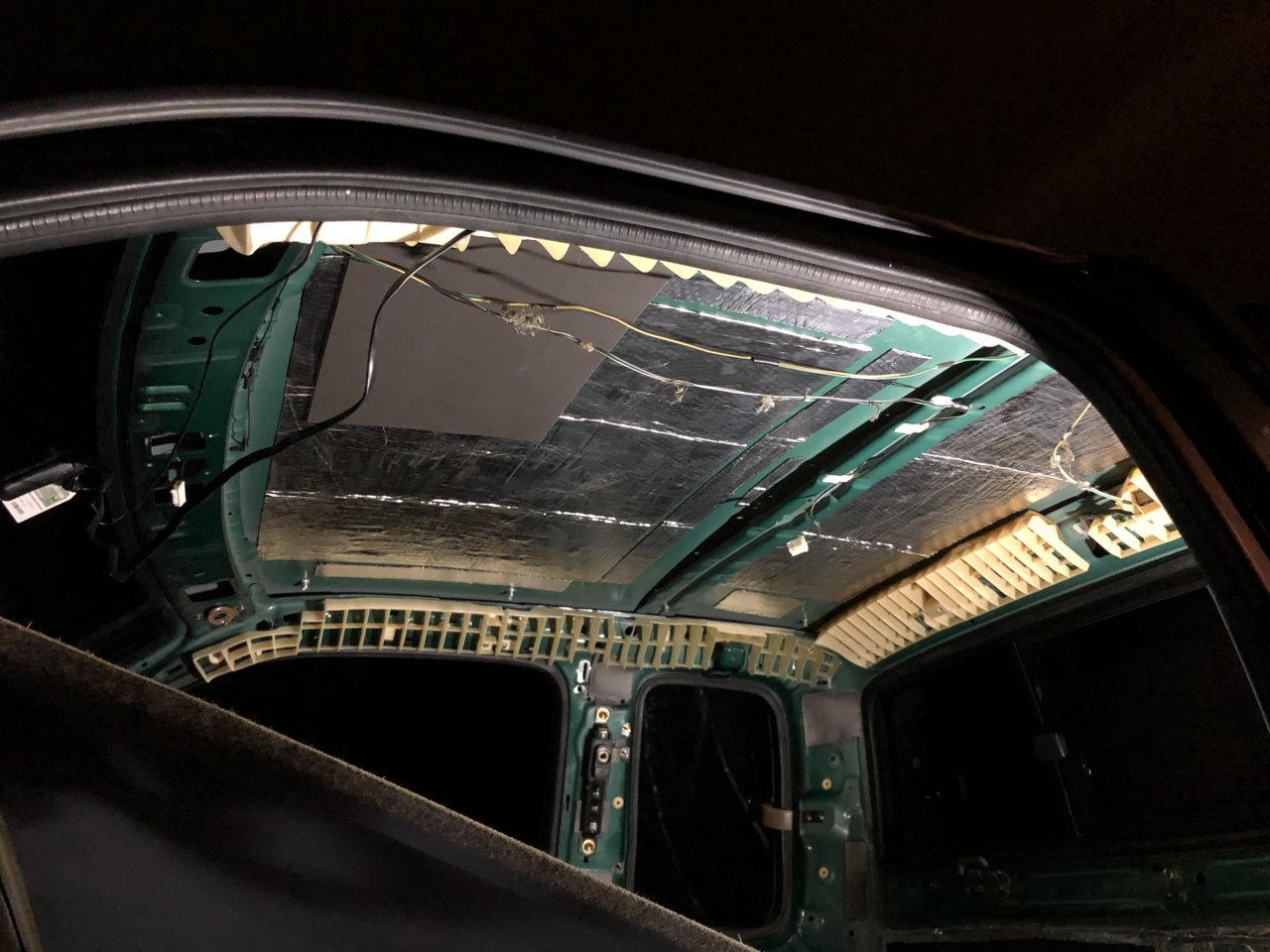

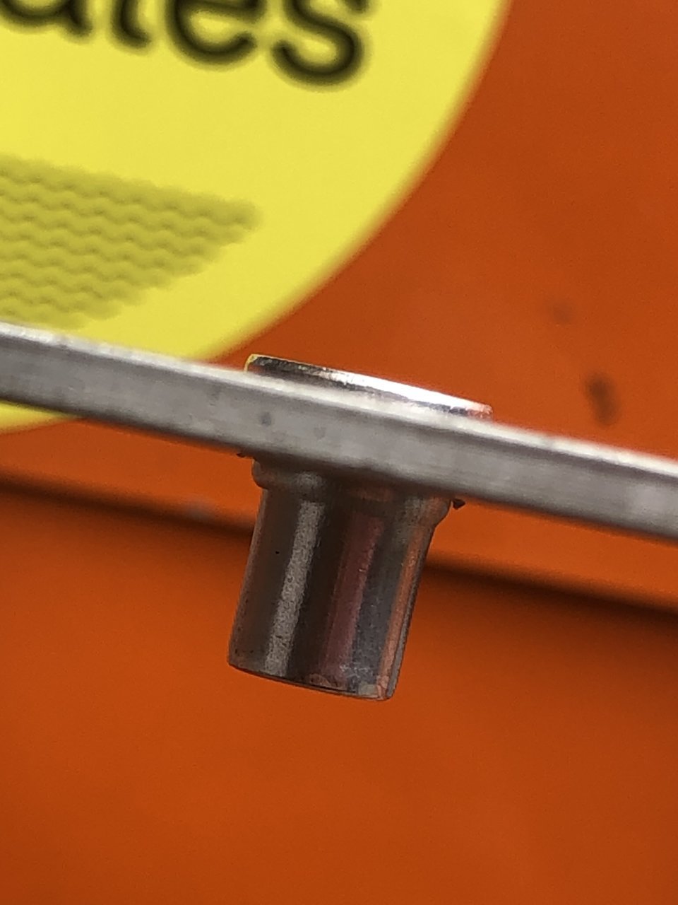

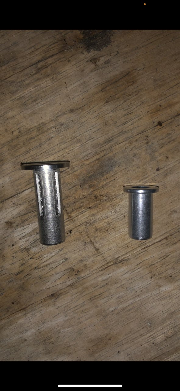

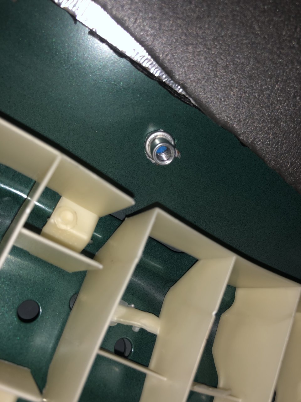

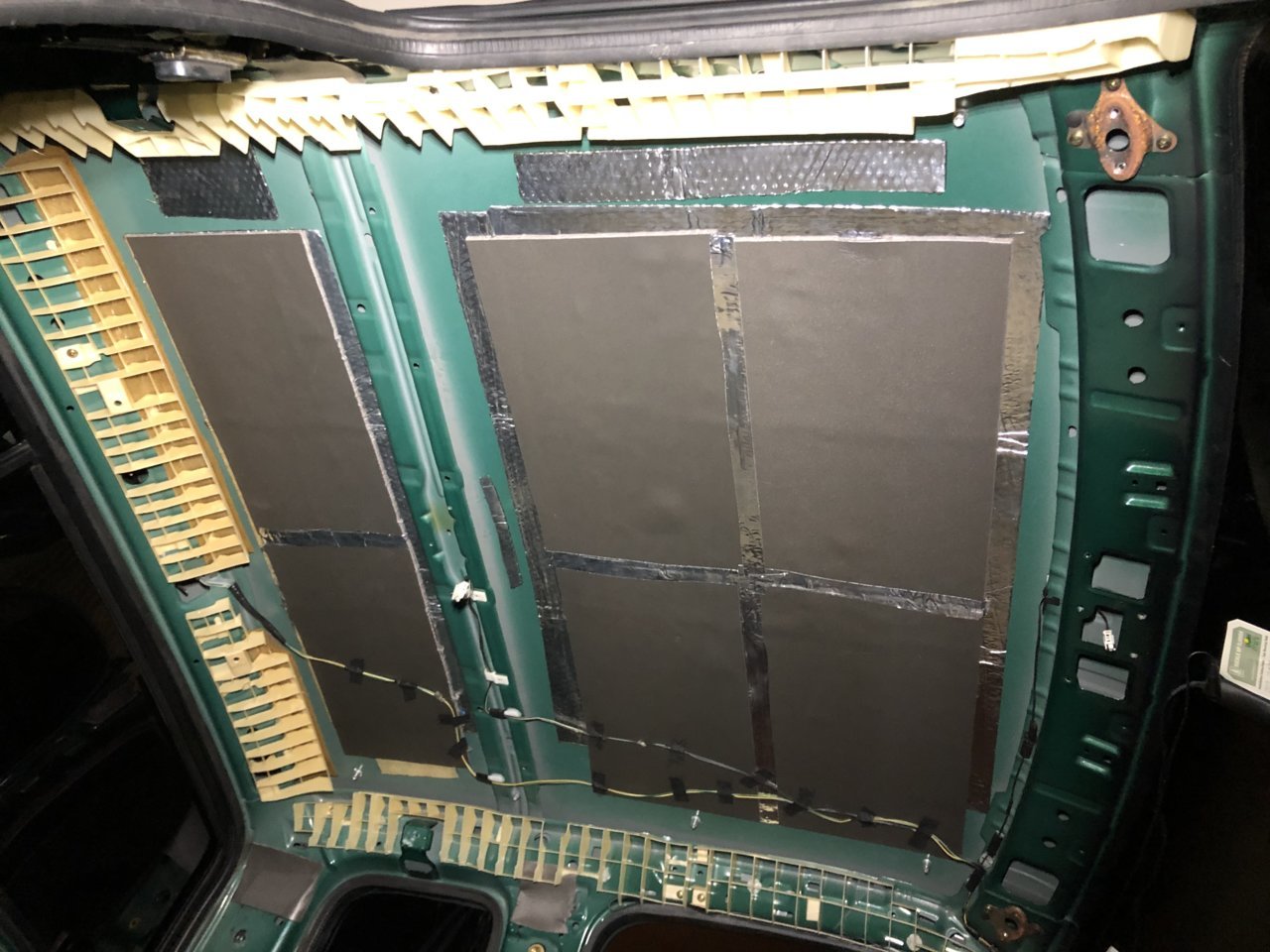

    Drilled out & replaced the weaker rivnuts with stronger plus-nuts for the 4runner roof rack while sound proofing the headliner. Love the simple & functional upgrades.
