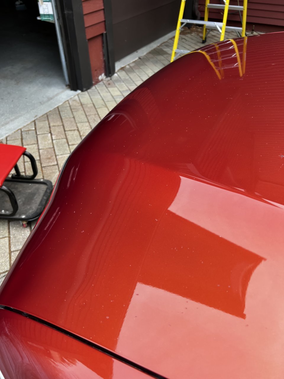

    After 21 years, she finally got a polish and wax.
    All the sun fading has led to a really pretty sunburst effect that came out after the wax. Kinda reminds me of that classic Les Paul finish.

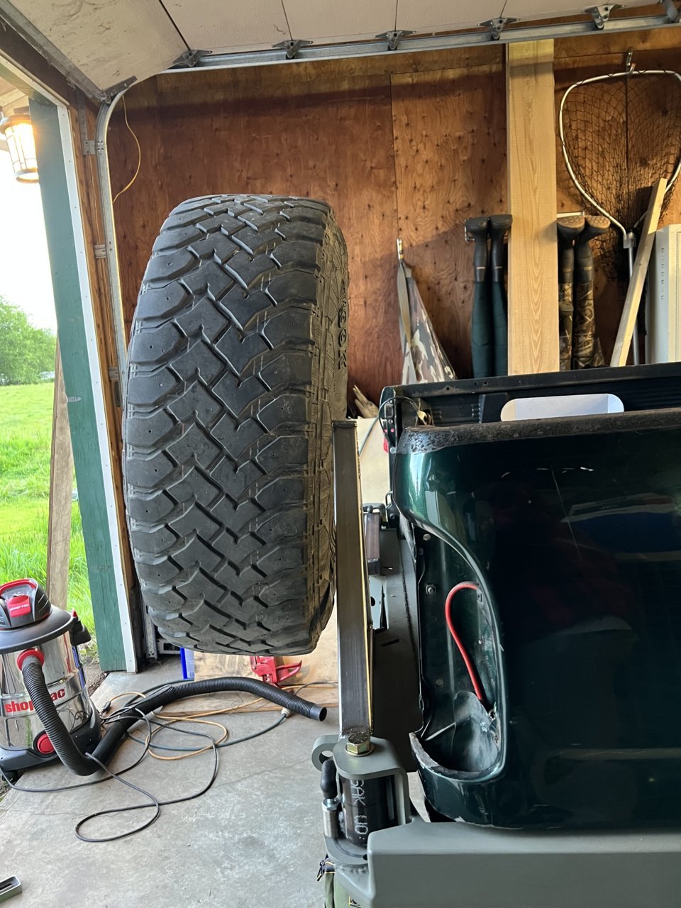

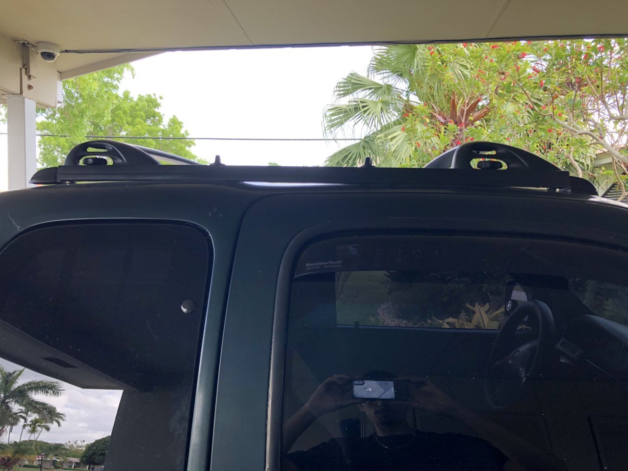

    The plan is to make a fiberglass mold to kill the gaps and allow the rack to sit flat & flush.. The roof rack flexes way too much as it gets tightened down (as it sits with the gaps) so I don’t have many pics..
    The most weight it’s carried in the past with the weaker rivets & gaps were 8 gallons of liquid & some aluminum poles..
    Once the gaps are solved I’m confident this thing will hold what I throw up there…

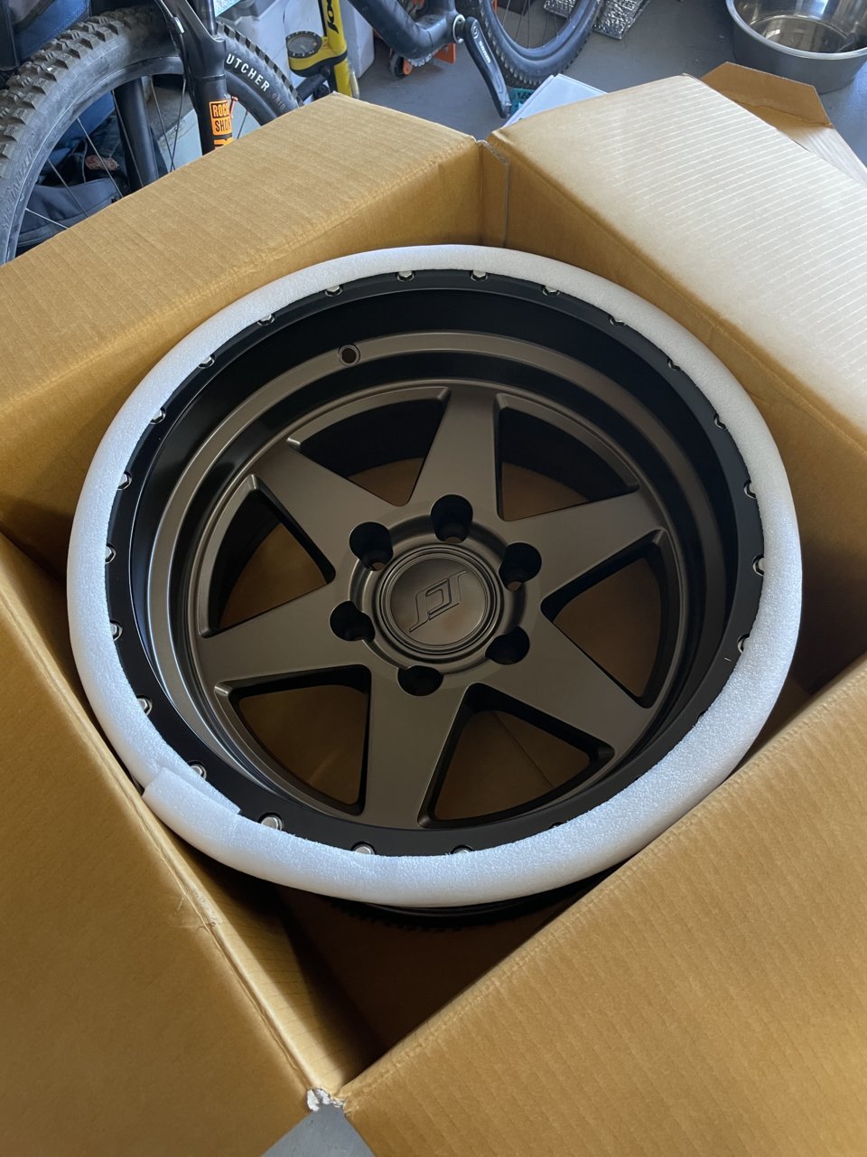

    What are the specs on these...they do look nice.

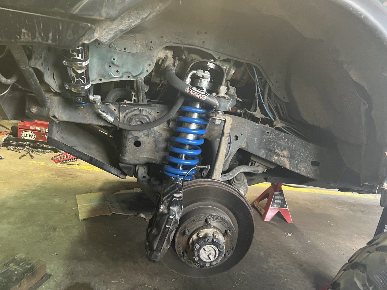

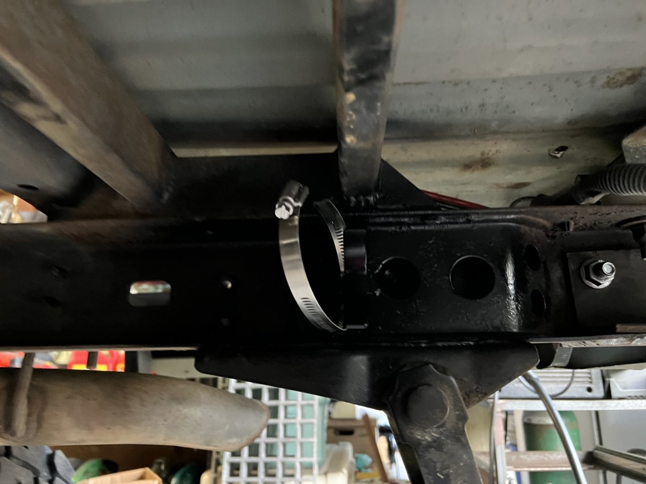

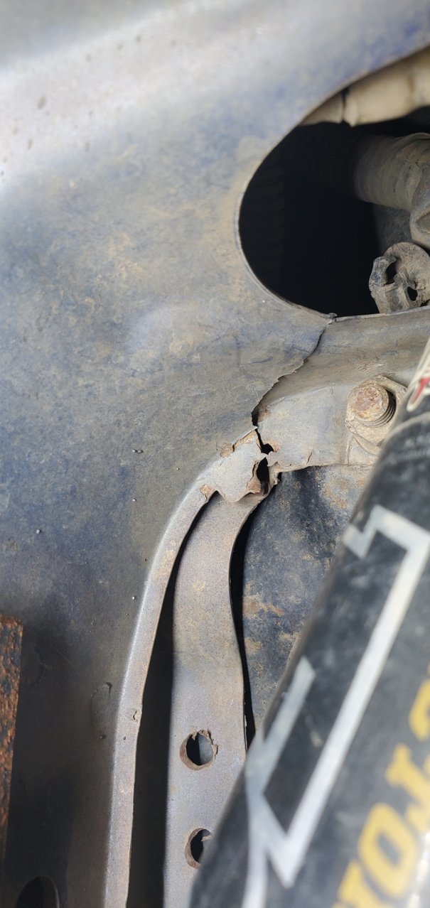

    7C341E24-90C6-4751-A733-65E5637D34DA.jpg Got my new co’s mounted and swapped my 700# coils I had on a pair of Donahoes0D6751DB-6E05-4DAA-83D5-446D50142C31.jpg Have some concerns about body fatigue, so not sure about the resi mounting, but I tried just about every configuration and ended up following what Betterbuckleup did, not many other options. May need to reinforce that areaC4AB95CD-D4B6-4DA6-9342-A57E5F02F903.jpg rear resi mounts I used a ruffstuff bracket and tucked it in the frame railFDD9140A-F43E-456C-9D6E-0EA761CAF594.jpg 66164EEA-20A2-45D8-B859-DDEE01B340D4.jpg swingout finalized after a first effort leading to the latch hitting the tire.139437ED-ED45-47D0-B192-5E92F23FE705.jpg
  10. May 18, 2022 at 10:23 PM
    betterbuckleup
    betterbuckleup Well-Known Member
    Jun 26, 2017
    #222483
    4,791
    Ian
    Concord, CA
    2000 Tacoma SC 2.7 4x4 5spd
    Looking good.
    Yeah, I can confirm that I had some tearing of the sheet metal on the part where the fender apron meets the core support. The resi def adds a bunch of extra weight in that spot.
    Although, my core support is a mix of bolted on and welded on since it was replaced so that maybe a factor as far as where mine started to crack.

    17x9 -38mm BS

    I replaced my core support as well about 10 years ago, truck has seen a lot of abuse

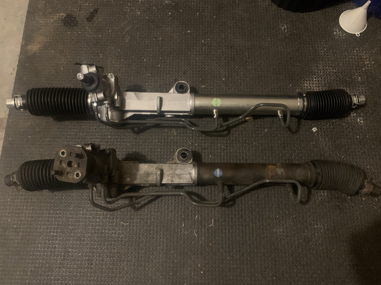

    Got the leaking steering rack removed last night in about 3 hours. Any advice for how to remove the lower part of the rag joint from the old rack? I removed the 12mm nut, but it's stuck on there good. Have already doused it in PB blaster, and may give it the torch treatment tonight. Wasn't sure if there was a good technique for removing it.
  14. May 19, 2022 at 9:15 AM
    Speedytech7
    Feb 20, 2014
    #123587
    58,100
    FCQM+VG Cheney, Washington
    It's less Tacoma and more mod
    We bolted a slide hammer to it, that thing puts up a fight
  15. May 19, 2022 at 9:15 AM
    Squeaky Penguin
    Squeaky Penguin Nothing Ventured, Nothing Gained
    Apr 5, 2012
    #76340
    10,075
    Brett
    Steamboat Springs, Colorado
    '01 4WD, SR5, TRD & '13 TRDOR AC
    Lots of dust and custom dents, Check Build
    An air hammer should zip it right off.
  16. May 19, 2022 at 9:18 AM
    cynicalrider
    cynicalrider #NFG
    Jul 25, 2012
    #83399
    17,154
    Jersey
    01 SR5 TRD 4x4, '23 Bronco Wildtrak, 2017 HSQV FE350
    Drop bracket lift and booger welds
    +1 to air hammer, it's how I have always needed to do it.
    CrustyTaco and Wulf like this.
  17. May 19, 2022 at 9:23 AM
    CrustyTaco
    CrustyTaco Well-Known Member
    Jan 20, 2019
    #279940
    1,044
    Todd
    Louisville, KY
    04 Ext Cab V6 5MT 4X4 185k
    881/5100/Dakars 4R wheels / TBU / New frame
    Thanks fellas, looks like I'm going to be paying a visit to Harbor Freight tonight to pick up an air hammer.

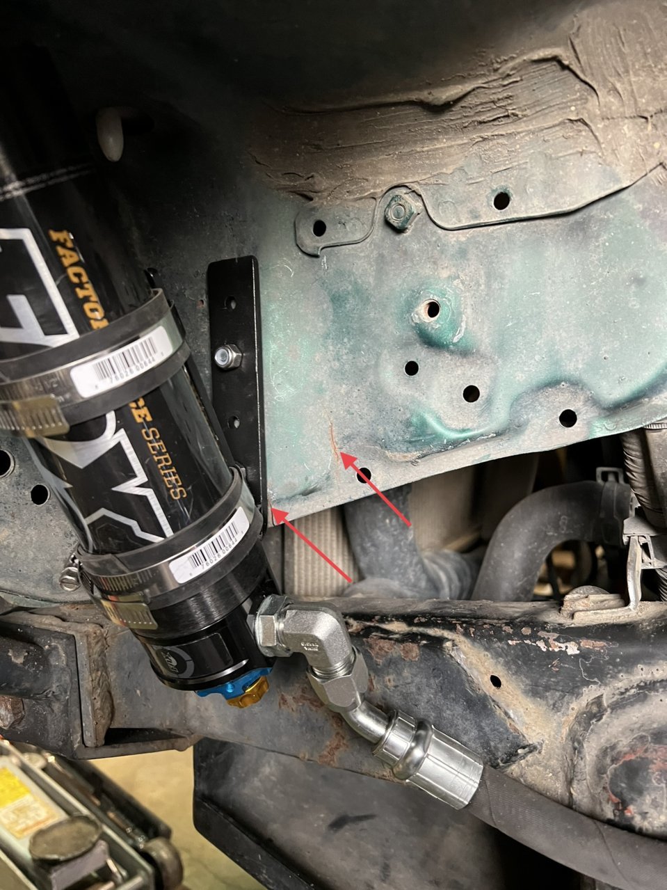

    That's a lot of leverage acting on that sheet metal when bouncing around. I mounted mine to the front crossmember behind the skid. Not the best for air flow but keeps it out of the way and it's solid.

    Fox 2.5 DSC resi CO's w/ 700lb King Coils, Camburg uca's, T-100 rear leafs, 13WL Tundra brakes, 1" 4crawler body lift, 295/75/16 Hankook MT, Ruff Stuff u bolt flip, 10" Fox LSC resi shocks turned back on custom mounts, home built rear high clearance bumper with dual swing outs, Diode Dynamics SSC2 Pro rear floods, Skid Row front and transfer case skid, home built transmission skid, Mercerfab sliders, home built front bumper, Badlands Apex 12k winch with synth line, 4.56's, ARB rear locker, home built rack with CVT Mt. Shasta, eBay snorkel, Sierra LEDs 20" dual amber/white light bar, Diode Dynamics SS3 Max amber fogs, Mini D2S projector retrofit, Blue Sea ML-ACR, dual Odyssey PC1200's, 100 watt solar panel, 20 plate heat exchanger/home built shower kit
    Agreed, I don’t trust it at all, passenger side even worseA8DF6A54-E064-493D-98CC-699D48978C53.jpgI think my solution may be getting some heavy stock aluminum bar I can bend to the angle I need and bolt it to the frame below the body. My frame is reinforced in the front after fixing a bent frame rail, so could probably just tap a hole.
    Any pictures you can share of your setup?
    I looked in that area, figured I’d have to fab a mount for it to get it away from the power steering lines.
    The biggest concern is keeping the hose as tight as possible to the IFS framing, I tested with the steering maxed out at full stuff and full droop, not a lot of room
    0594CB6C-8F6B-4A82-BA6E-675C0E868757.jpgFull stuff3D71E012-FF28-47EF-A794-3AE838F80BBD.jpgFull droop is not as big a concern

    ARB front locker, Custom high clearance rear bumper, Custom plate front bumper, mile marker winch PE8, safari snorkel, Deck Plate Mod Fox 2.5 rr DSC, Camburg UCA, squeaky Dakar leafs, 5125 10" and custom 7.5" shackles, thee finest PNW pinstripes, MT-R, Nissan crew cab roof rack??? wtf is that about??? Allpro skids, Rigid duallys President McKinley CB with PA Recaro SRD with Wedge Engineering Morimoto retrofits Champion Rad - Failed Tundra brakes
    I "tried" putting the resi above the UCA and was strongly suggested to move it ( @Digiratus and @drr ).
    @drr actually came over and we strong armed the resi into a better place-ish.
    Edit: Lake City Way in the house!
