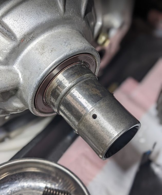

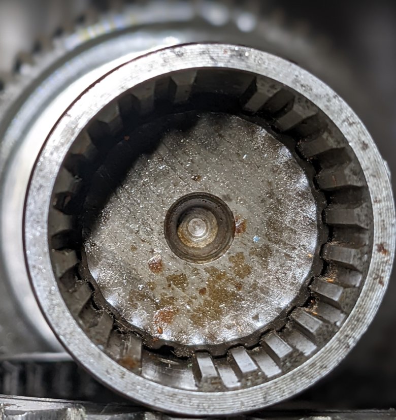

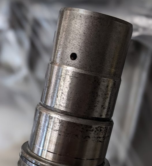

    I just had my case off today and it was not stepped like that one is. It's behind the w59.
    Area51Runner[QUOTED] likes this.
  4. May 30, 2022 at 9:08 PM
    Area51Runner
    Area51Runner Well-Known Member
    Jun 26, 2014
    #132748
    11,980
    Northern California, Bay Area
    02 3.4 DC TRD PreRunner 4WD SWAP
    What I figured. This must be from the 6cyl. Thing that messed with the old' grey matter was the number of splines I counted on the inside. thanks for confirming your 4cyl was different.
