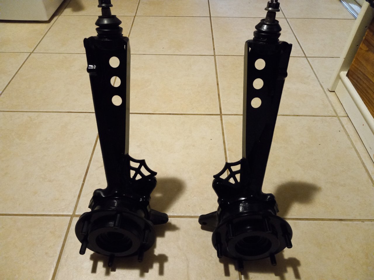

    Love a little spiderwebs! Where’d you get those? True

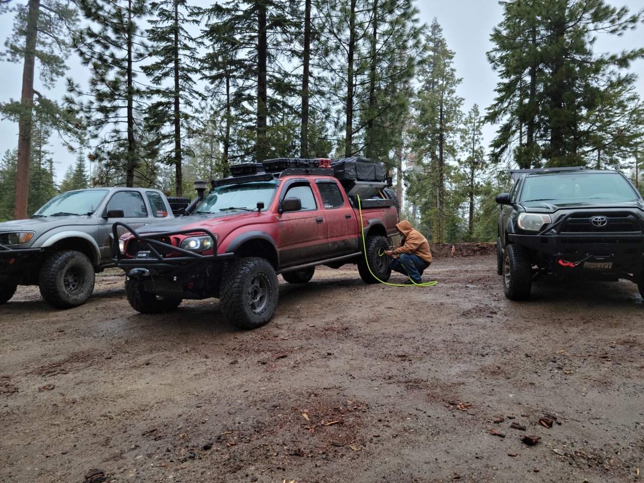

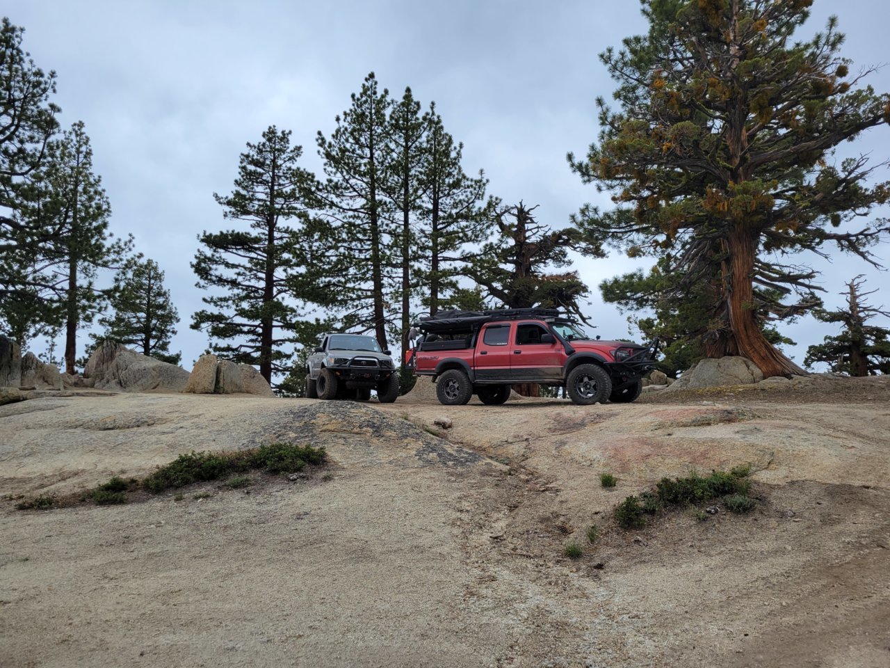

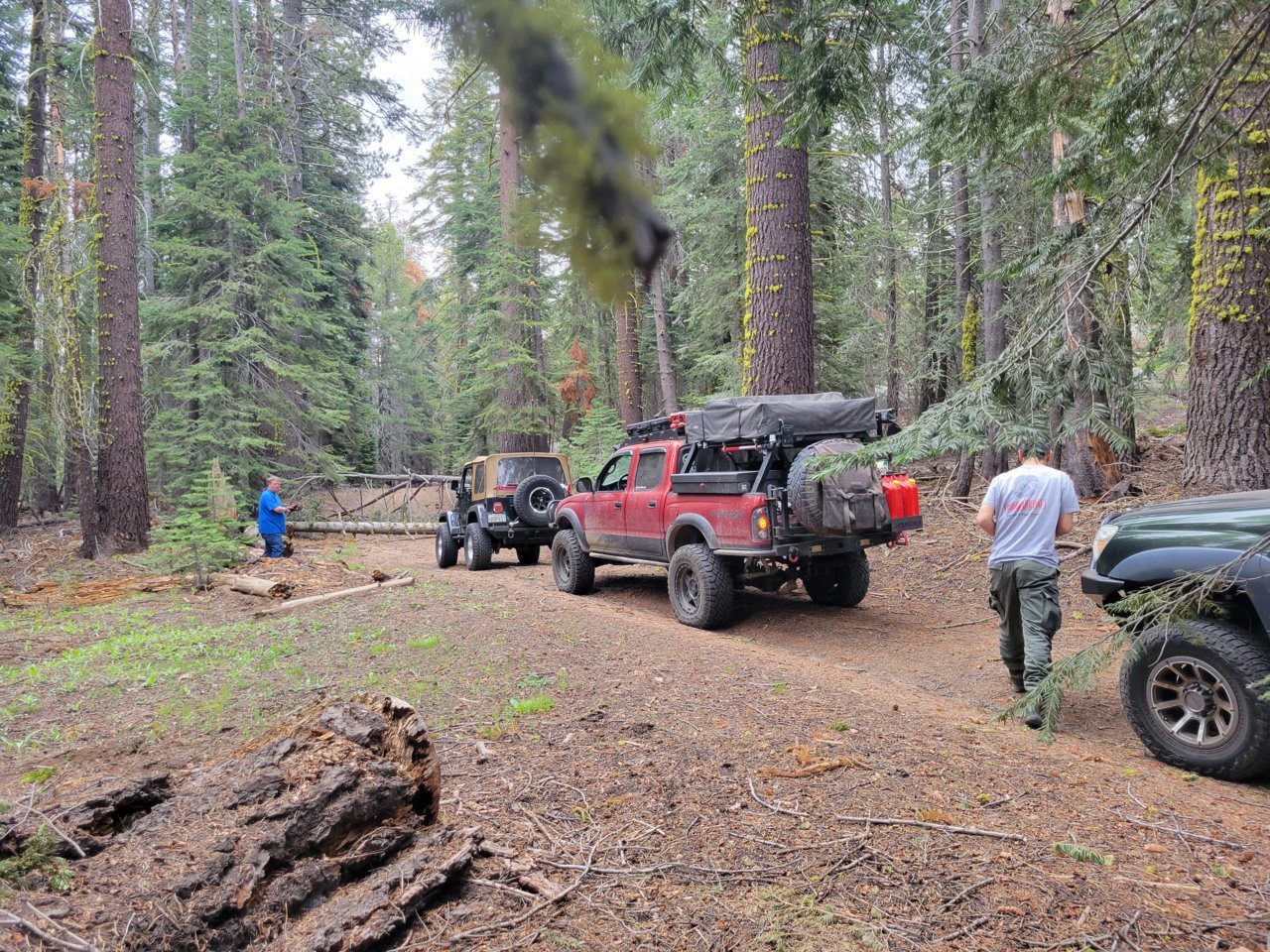

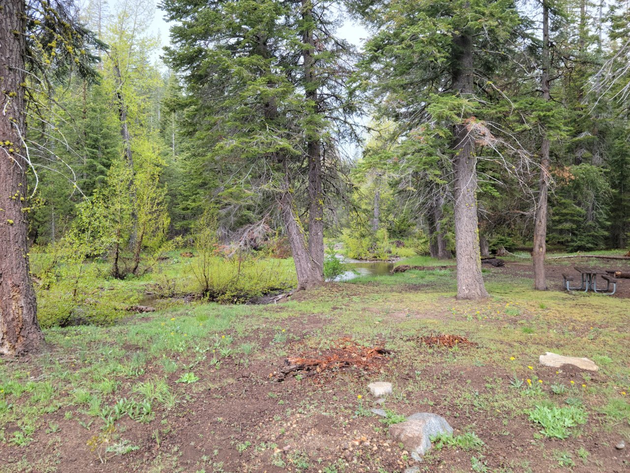

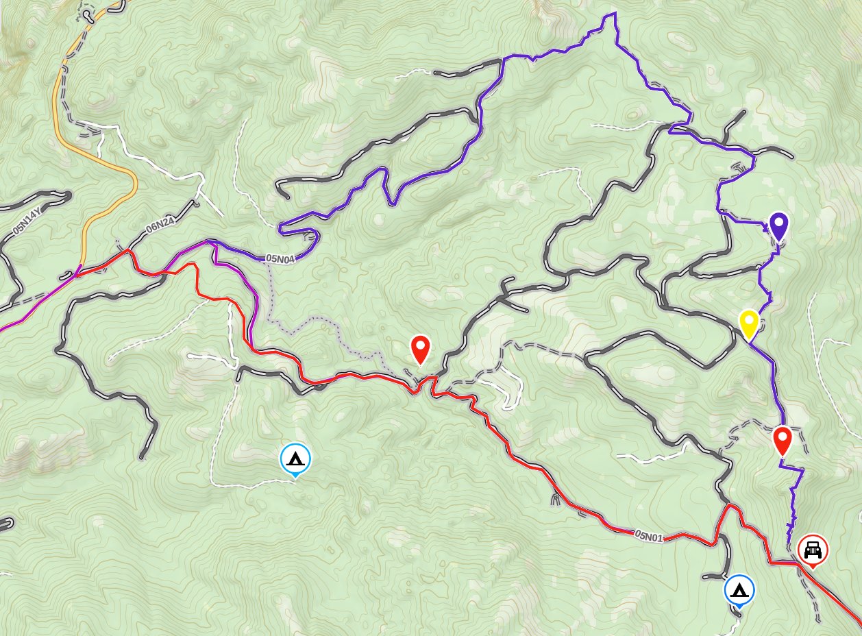

    Niagara Rim Trail clearing was a success. We worked with 4x4 In Motion and the Forest Service yesterday to clear and season open Niagara Rim Trail (purple line) as well as 5N01 (red line) and all of the trails inside the NRT triangle.
    @ssd_dan, my wife, niece and 2 of my sons camped at Niagara Creek Camp and then cleared all of the trails south of 5N01 (up to NRT trailhead = Jeep Icon) today.

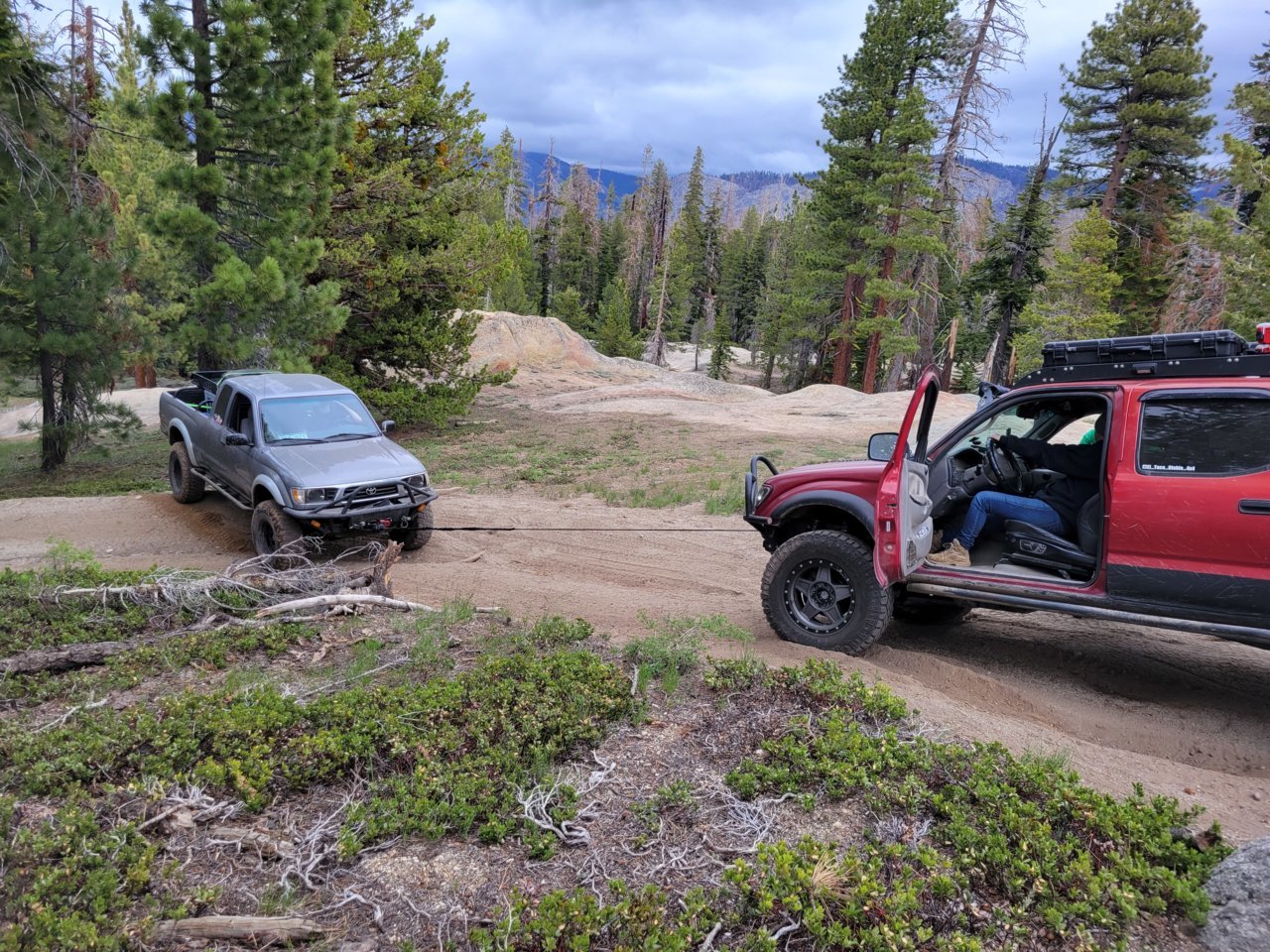

    Brennen needed a little help getting up to Lion's Butt from the back side.
    Lion's Butt
    Gotta hate airing up in the rain.
    The aftermath of camping in the rain:rofl:

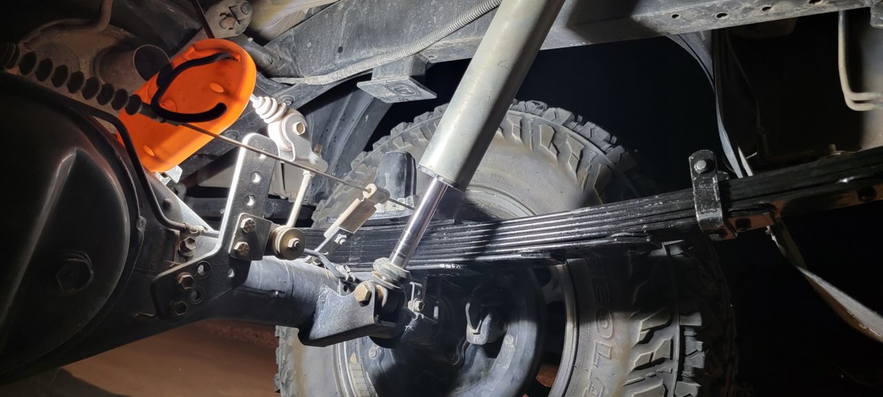

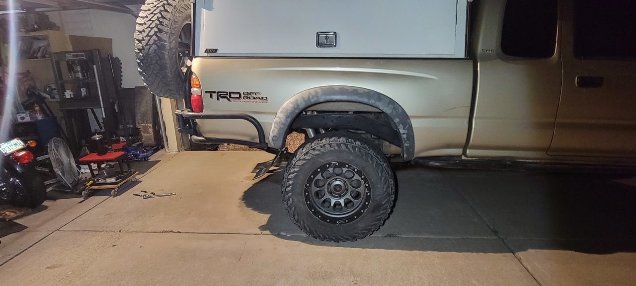

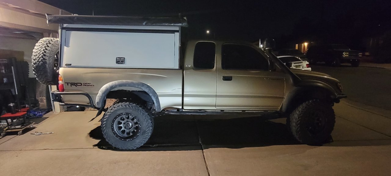

    Finally got a chance to mostly install my alcan's. I ran into a couple of issues, I'm gonna need to raise up the ebrake cable,. I need new upper shackle bushings the u-bolts I ordered were way to big"9/16 × 3 1/4" the old OME u-bolts were 3 1/8 ish lol . I need to paint my drums as there starting to rust. And lastly I think I'm going to need a axle relocation bracket. The wheels look like there pretty far back in the wheelwell. On a high note it looks like my shocks are finally sitting correctly , well tell the springs settle anyways. 20220605_212411.jpg 20220605_212607.jpg 20220605_212258.jpg

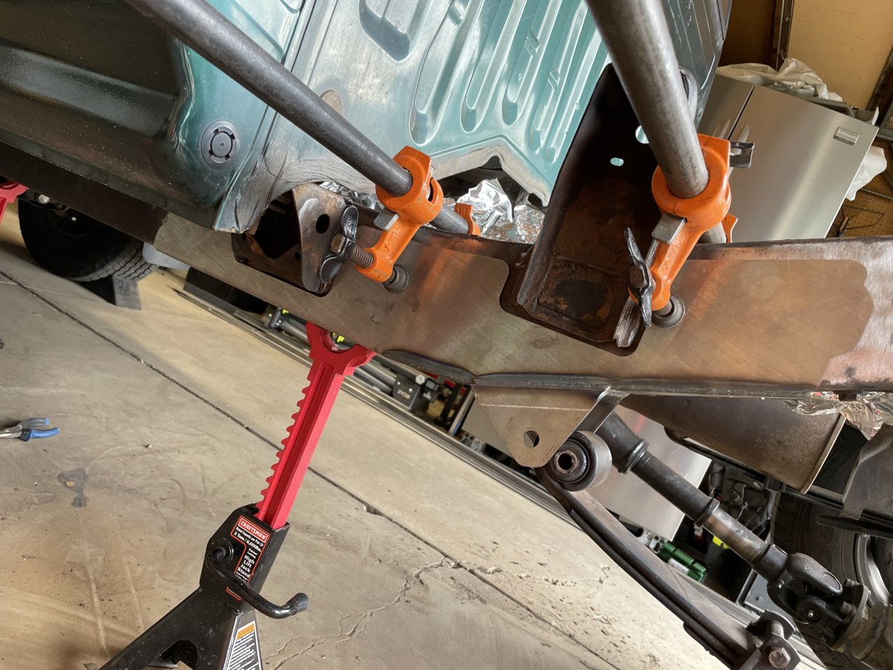

    This BS. Was terrible and a long long day. But I’m glad it’s done

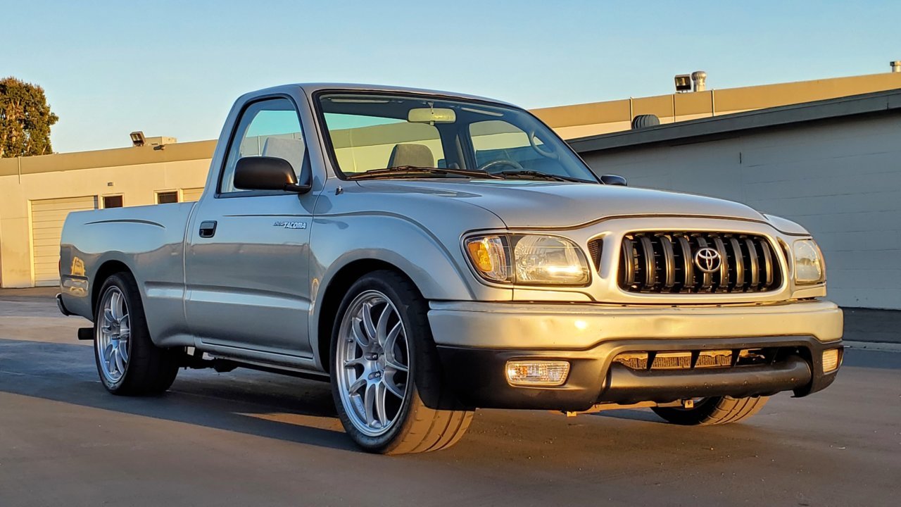

    Installed some measly 3mm wheel spacers, for that extra 3mm!

    Prepare your butt, it was an ass-kicker. Just did one side (driver-side) which is much harder due to dropping the gas tank and all the brake lines and electrical running across it. Took a solid 12hrs with a buddy - I'd prepare to have the Tacoma out of commish for a bit, you could do it over a weekend if you were deliberate with your time
    edit: if you’re still running OEM leafs, try and remove the leaf spring main eye bolt first (don’t completely remove until on stands, just check if you can remove)
    I redid my springs a month ago and when I did them I had to cut the bolt out due to cold/rust welding and time. If you’re in a similar boat you’ll have to have a plan to address the leaf springs before moving on
