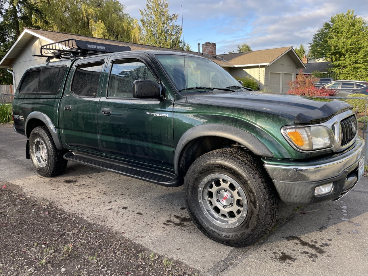

    2003 Toyota Tacoma TRD 4x4 Double Cab
    TRD Beadlock Style Wheels

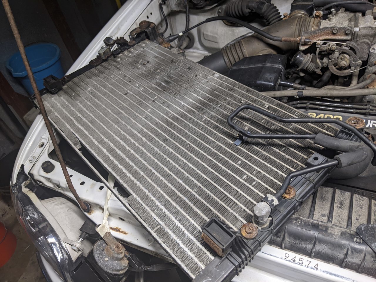

    Also working on repairing my AC. Replacing the condenser, drier and now the line between those two because I stripped the nut connecting them :(

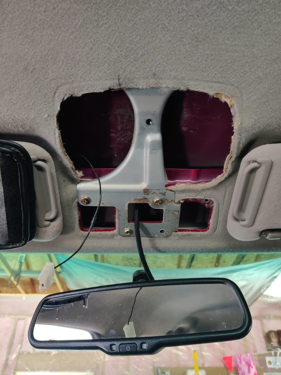

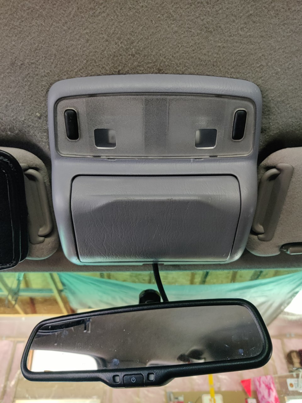

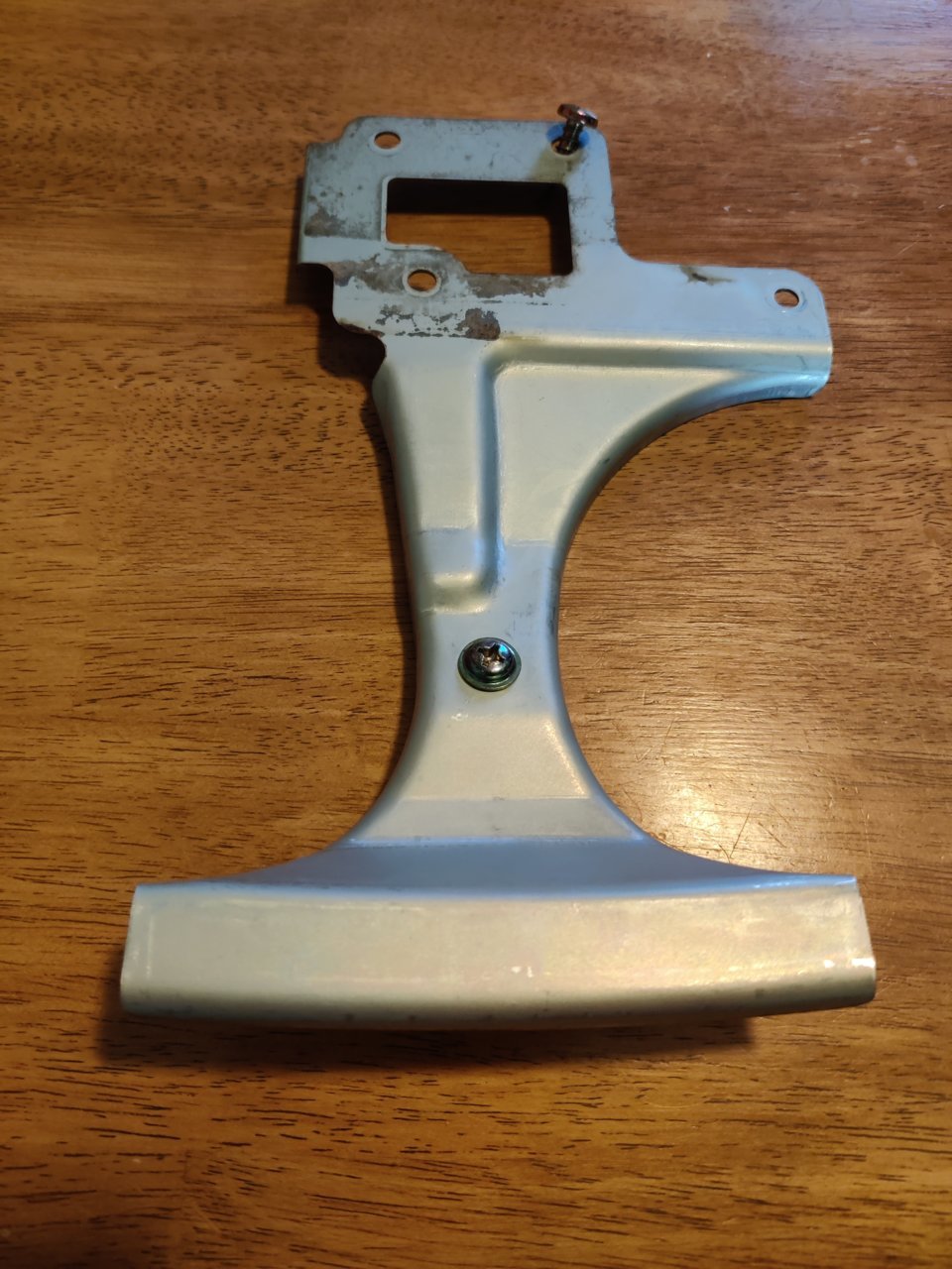

    Installed the correct bracket for the 4runner sunglass holder thanks to @ijm01PR.
    Alex you are the man

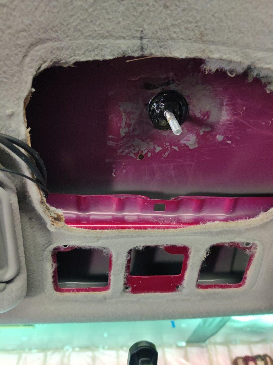

    This little brain spike epoxied to the roof was doing the job but it failed me two times too many.

    No problem man. Glad it worked out for ya. :cheers:

    Where did you find that piece? I've searched a couple times on eBay looking for them and it seems like they all have sunroof controls.

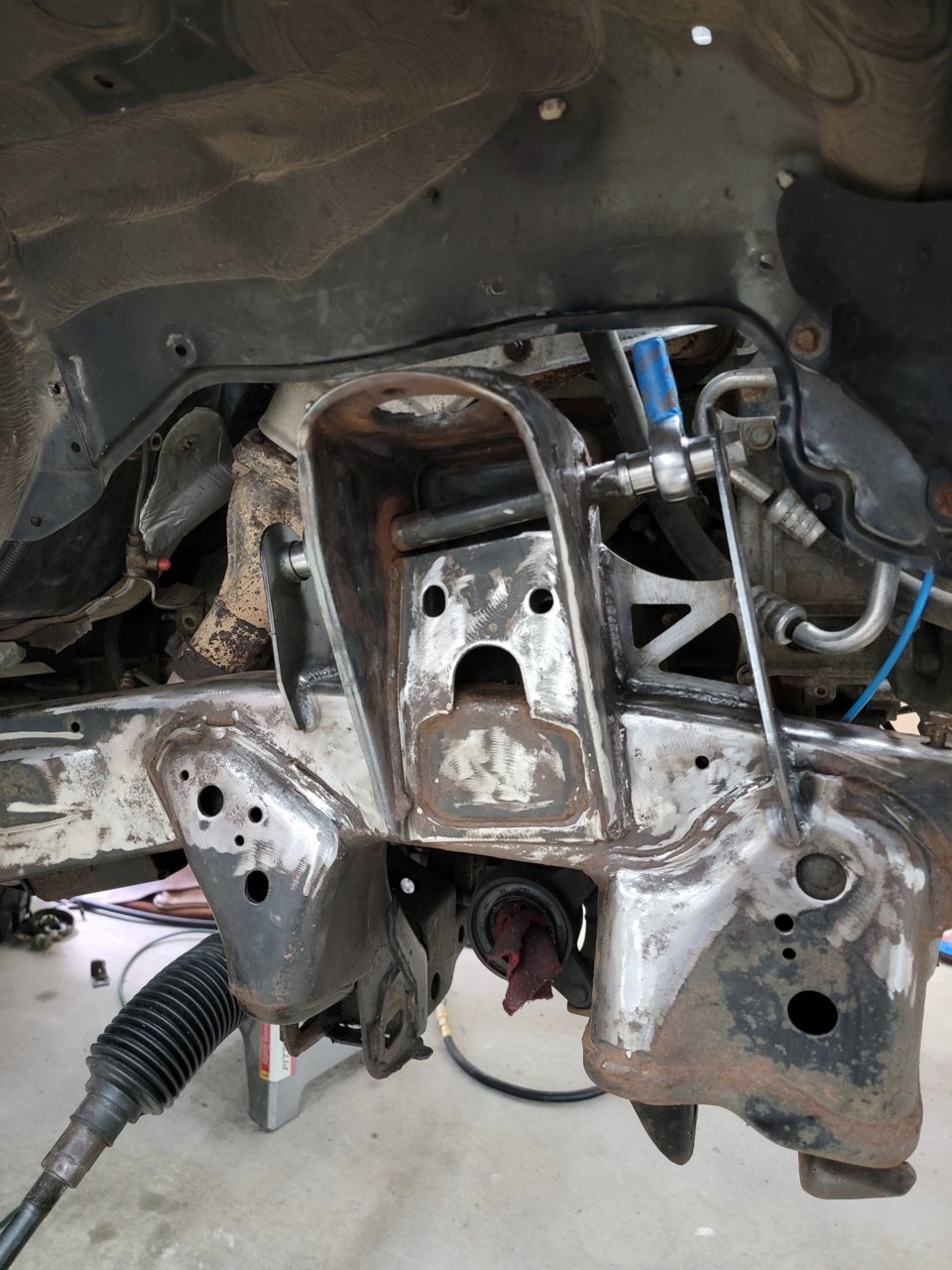

    Anyone have any experience with installing UCA double shear on a 4cyl?
    The TC ones apparently don't fit the 4cyl due to a different hump in the frame but could maybe be ground down to fit?
    Not sure about the Solo motorsports ones as they don't mention anything about the 4cyl.

    I never even looked for it Alex hooked me up. I believe he found it at a junk yard

    i couldn’t find it either but I used 3m panel bond (the stuff car manufacturers uses to bond metal panels together instead of welding) trust me guys I would have to cut the roof to get it off!

    The bolt ended up breaking out of the plastic housing when I tried to remove it so that's just going to stay up there forever. No sense in possibly denting the roof trying to get it off.
    When I first stuck it up there the surface was too smooth and that's why the 5 min Epoxy didn't work. Once I took the time to scuff the mating surfaces it stayed in place

    I've got Solo's installed on my 4cyl. they fit pretty well with just a little grinding.

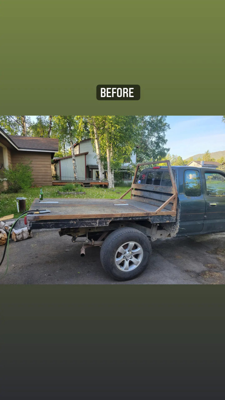

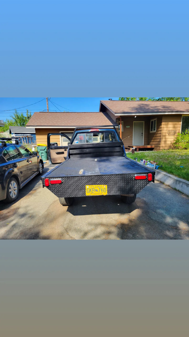

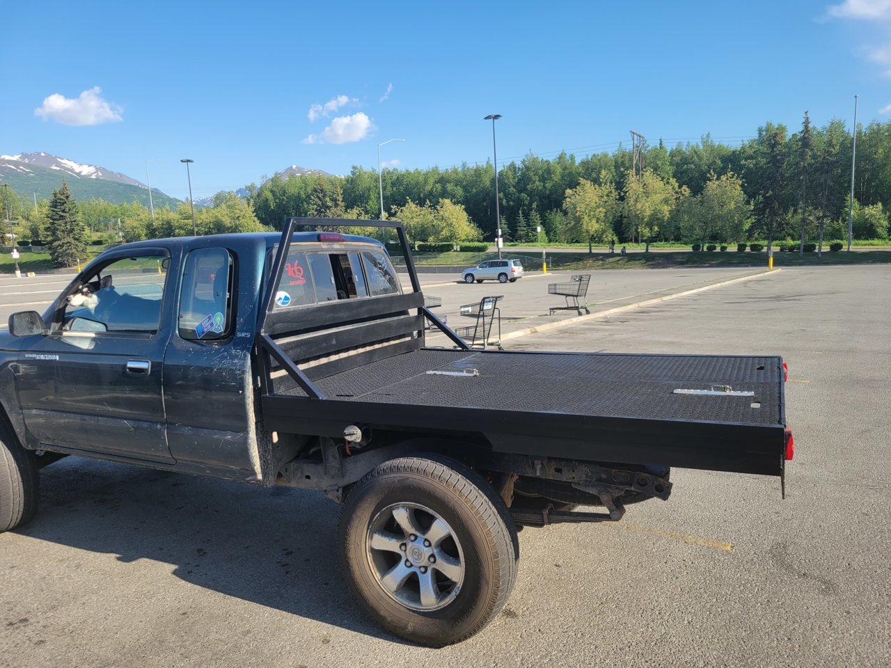

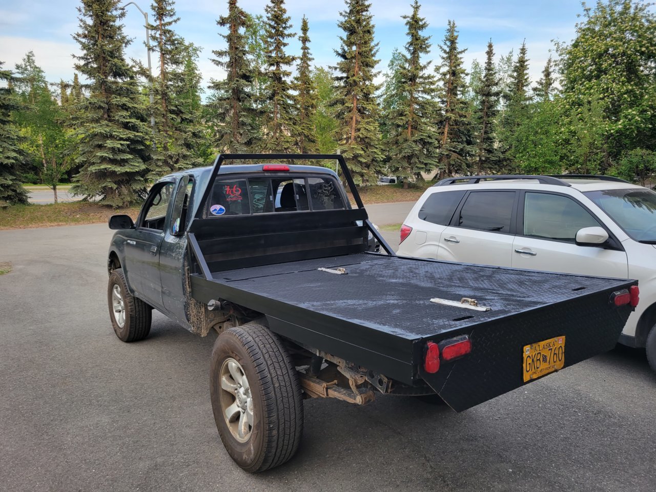

    Bedlined my flatbed! Built the flatbed myself after rolling my truck and cab swapping it. It took an entire year of nonstop work but im finally proud of it again. I mean, i was always proud but this makes it a lot easier to be proud.

    Glad to hear. That's what I ended up ordering as they seemed they should fit better than TC considering they're not pre-bent pieces

    Details on this one, please - DM is fine
    Looks like 2 pieces?

    I've got a few more details on the 1st page of my build thread "Little Red Creeper"
    The sunglass holder /map light comes from a 99-02 4runner
    When I first did the install I didn't even know there was a mounting bracket available so I just glued a stud to the roof and made it work
    I've heard these brackets are hard to find but I don't think that should stop anyone from installing it.
    The lights are so much better than the stock tacoma
