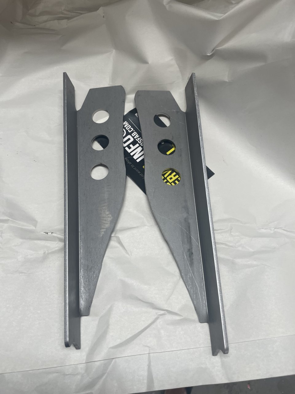

    20220612_155732.jpg Doin some fine tuning.

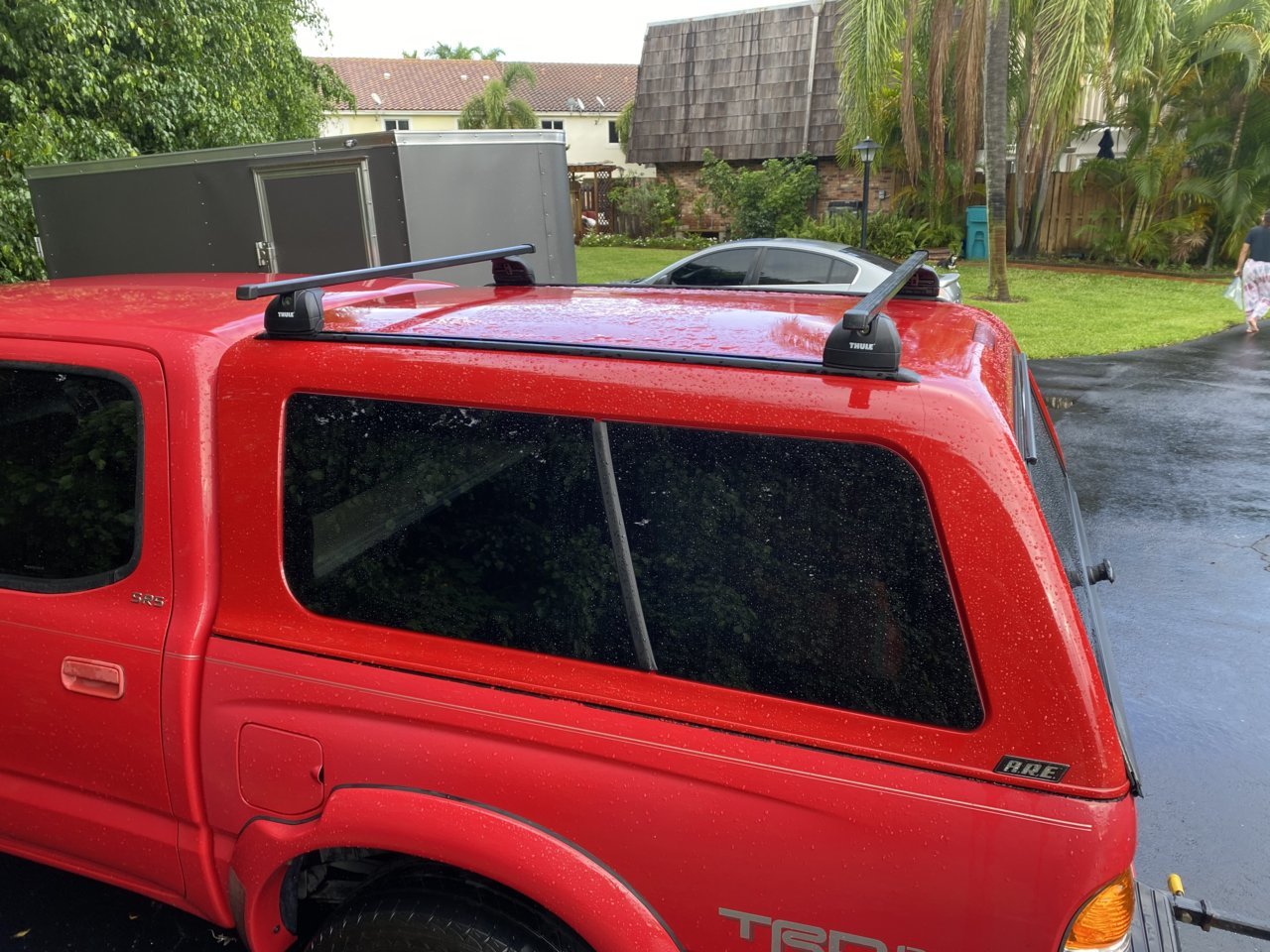

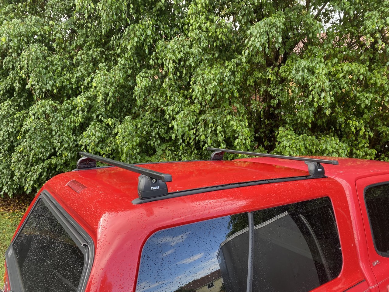

    Added a Thule roof rack today
    F6EA904D-778C-4770-8F91-E753AAF3E291.jpg 2C94B0B1-C4EE-4ACD-89D5-8ACA94A1702A.jpg
