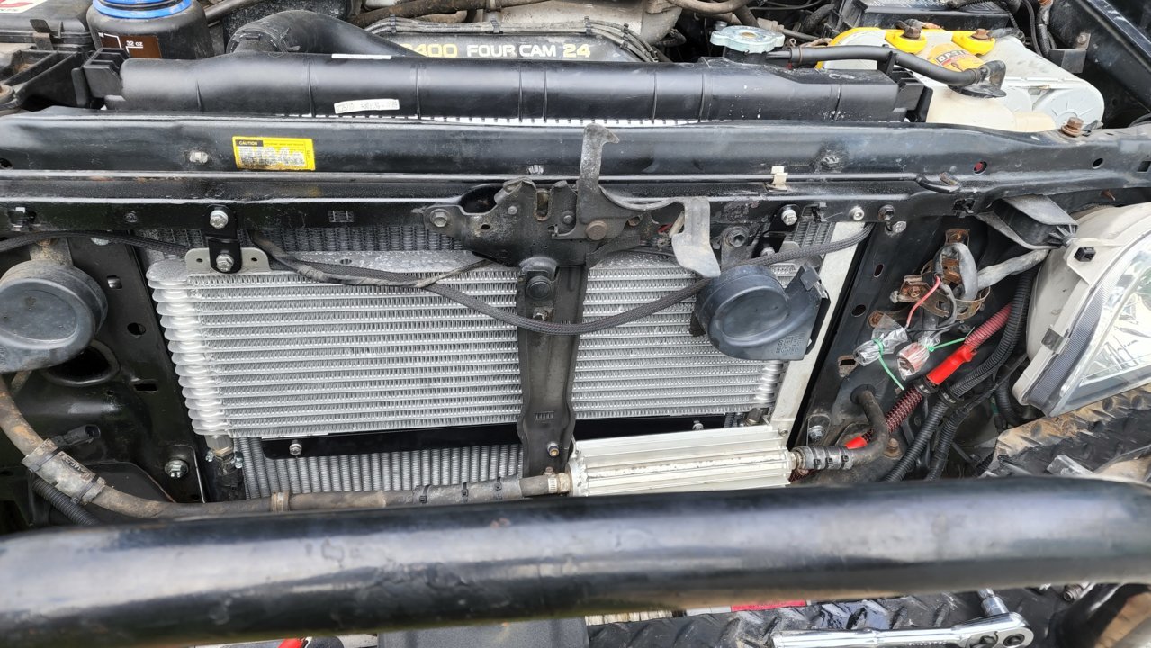

    I recently installed a larger tranny cooler and changed the location to be closer to the fan to get more pull through it, wondering if any one else has had issues with this location. I think it’s creating a hot spot in the radiator and not letting the tranny fluid cool.
    It had seemed to be working fine, but on the first really hot day/long drive (150 miles and 100 degrees) I took it on it was running hot almost immediately. Motor was between 200-210 it’s usually 190-195 and tranny jumped to 200 and fluctuated between 200-230. Hotter than it ever really has.
    So I’m guess it has to be with the cooler location, just seems odd to make that big of a difference.

    that's where mine is.
    Are you certain your thermostat is installed correctly? jiggle valve pointed down at 6 oclock?
    When's the last time you flushed the coolant?
    Mine runs around 185-190 and tranny fluid is like 150 on the highway.
    Whats the routing of the tranny fluid? I have mine going to the external cooler bottom port, then top port to the radiator, then to tranny.
    I have ahd it in a tough situation on Morrison Jeep trail and it was at 230 most the switchbacks. Took a LONG time to cool down once it's that hot. of course we couldn't go much faster than 15-20mph even off the switch backs and air movement is needed to really cool that stuff.

    Are you running your AC since installing this Trans cooler vs before? Could be the condenser heat soaking your Trans cooler.
    As stated above check thermostat position.
    Also, how's your fan clutch looking, and fan clutch support bearing.
    Or maybe air pocket in the cooler?
    Condition of coolant hoses, collapsing?
    Couple possibilities...
    Same place I have mine, granted "slightly" bigger size, but no AC condenser.

    coolant and radiator was replaced 6 months or so ago.
    I am not 100 certain the thermostats is facing down. But did my timing belt about a year ago and put a new one in. I actually cut that jiggly thing off, recommend by my mechanic buddy. Although after changing it my temp went from 190 to 193. Are there oem thermos that open at higher and lower temps? Maybe I should run a lower one?
    fan clutch was replaced and functioning with the heavier duty one that came with the towing packages.
    I did have the AC on full blast, so soak through from the condenser could be a thing.
    current configuration is tranny - radiator - top port of cooler - bottom port of cool to the radiator
    all the cooler hoses are newish and no issue with radiator hoses.
    this was happening on flattish highways which was my major concern. Made me start thinking it was possibly my torque converter taking a shit.
