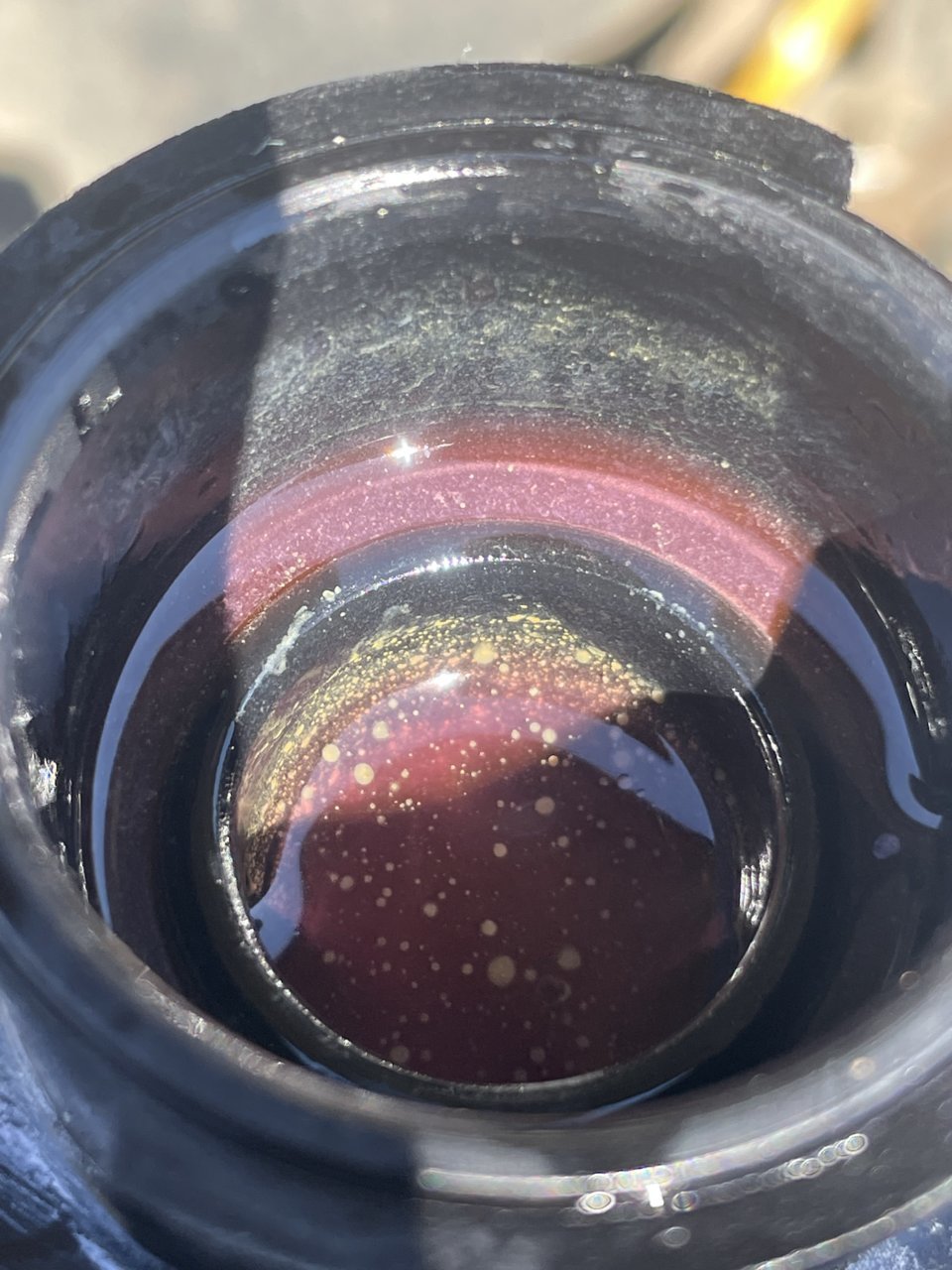

    How does your oil look?

    Looks fine

    Your radiator contamination looks kinda sus

    That sucks. Is it oil or exhaust? Harborfreight has a tool to test to see it your getting exhaust into your fluid.

    Agreed, don’t like seeing it. I’ve never done a full coolant flush on this truck so I’m wondering after I swapped the radiator couple months ago, it kicked some shit up?
    Fingers crossed. Otherwise, might try to get a compression test done on it, hoping it’s not a head gasket issue or worse a cracked in the block.

    High trans temps will degrade the fluid. Keeping the fluid fresh should help.
    I've started doing drain and fills at once a year intervals depending on miles traveled and severity/frequency of situations where the temps got to 230° and above. A drain and fill won't get it all (~4-5 qts) but will freshen it up quite a bit.
