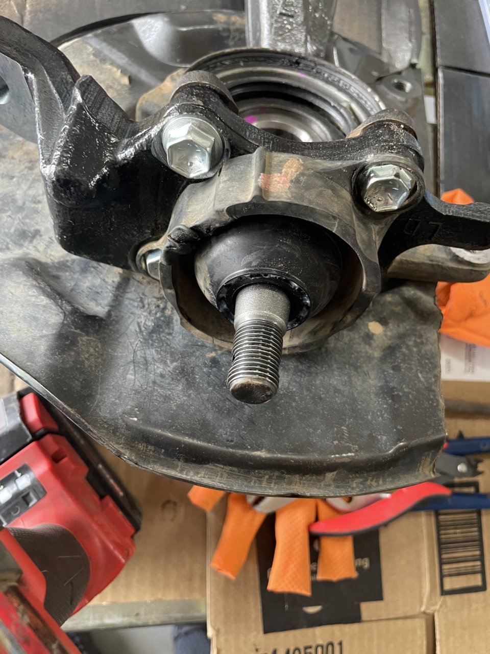

    Anyone got the part number for the little LBJ boot thing. E542DA42-AC5F-4418-A25F-795DD9B2F648.jpg

    I don't think you really need it. plenty of trucks that run without them

    I ran without one for a long time and didn't have any issues, the earlier 1st gens didn't have them up until 2000 or 2001 I think. But last time I did the LBJs I picked up an extra just to toss on there.

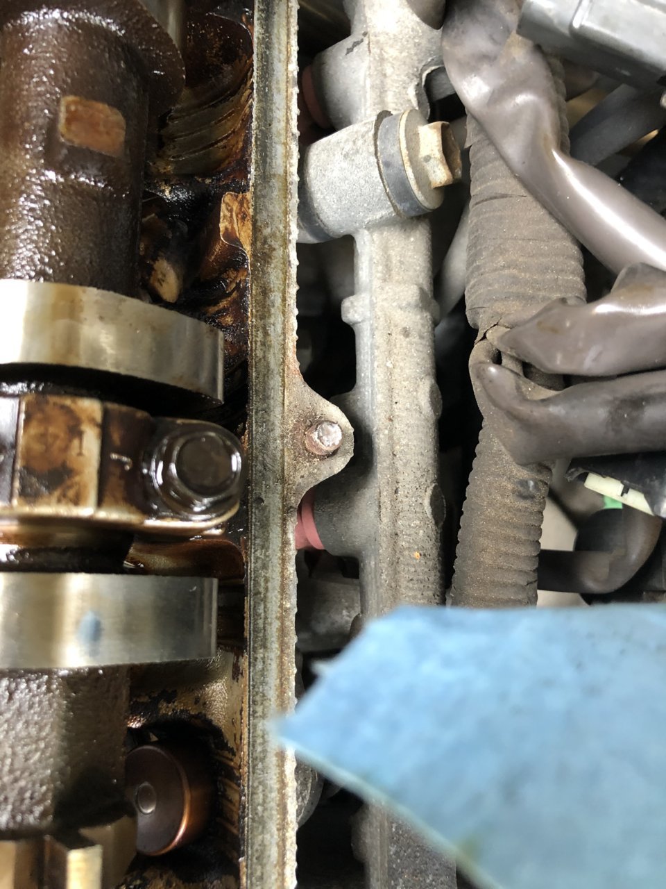

    The threads on the head portion are stripped? I don't see why you couldn't just drill out and re-tap to the next size up, be sure to keep track of every single metal shaving while doing so.
    Honestly, the more I think about it, that might actually be a decent spot for a helicoil since it's not under a ton of torque/stress and you shouldn't need to worry about stripping it again. I'm sure others will chime in though, just my .02.

    I've never even seen one before

    stripped out threads or snapped the head off?

    If you have a welder, weld a nut on the end and spin it off. Make sure you cover up the valve cover and the few hoses there.
    If no welder, take a cut off/hacksaw and cut a flat head into the bolt, then impact driver with said flat head bit. Again valve cover covered as well.
    Not even a few ftlbs tight so should come out pretty easily, penetrating oil helps too.

    Agree with what was said above.
    First off though, I'd hit it with some channel locks or pliers...

    Thank you guys for the tips. I snapped the head off is what happened. I have no idea why it was so tight.
