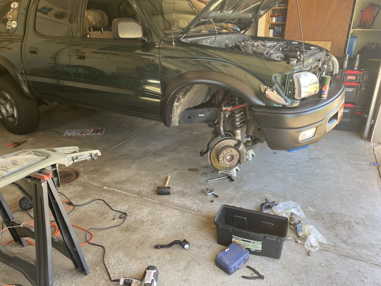

  3. Jun 22, 2022 at 9:01 PM
    unstpible
    unstpible Well-Known Member
    Aug 16, 2012
    #84909
    3,883
    Derek
    Cedar City, Utah
    03 4x4 boosted V6 Auto 341k miles
    CX Racing Turbo kit. TransGo shift kit. All Pro Apex bumper and skids. Smittybilt XRC 9.5 winch. All Pro Upper control arm's. Bilstein 6112's with 600lb coils. Eimkeith's lower control arm reinforcement plates. Perry Parts bump stops. All Pro spindle gussets and alignment cam tabs. All Pro standard 3" leaf springs. Bilstein 5125's rear. Extended rear brake lines. Rear diff breather relocation. MagnaFlow catback with resonator. Bluetooth stereo. Memphis 6x9 door speakers. Diode Dynamics SS3 Pro Amber fog lights. Single piece headlights. aftermarket grille. Anzo taillights. LED 3rd brake light. 4runner sunglass holder and dome lights. Master Tailgaters rear view mirror with 3 directional cameras, G shock sensors, and anti theft system. Honda windshield washer nozzles. Stubby antenna. Scan Guage II. 2nd Gen Snowflake wheels powder coated black. Cooper Discoverer ST Maxx 235-75/16 Denso 210-0461 105 amp alternator. Speedytech7's big wire harness upgrade. Aeromotive 340 fuel pump. Haltech Elite 2500. Tacomaworld sticker. Tundra brakes with Adventure Taco's hardline kit
    Might not even need to scuff it
    My fast fading bumper is starting to match my long since faded fender flares perfectly :bananadead:
    "It's custom faded"

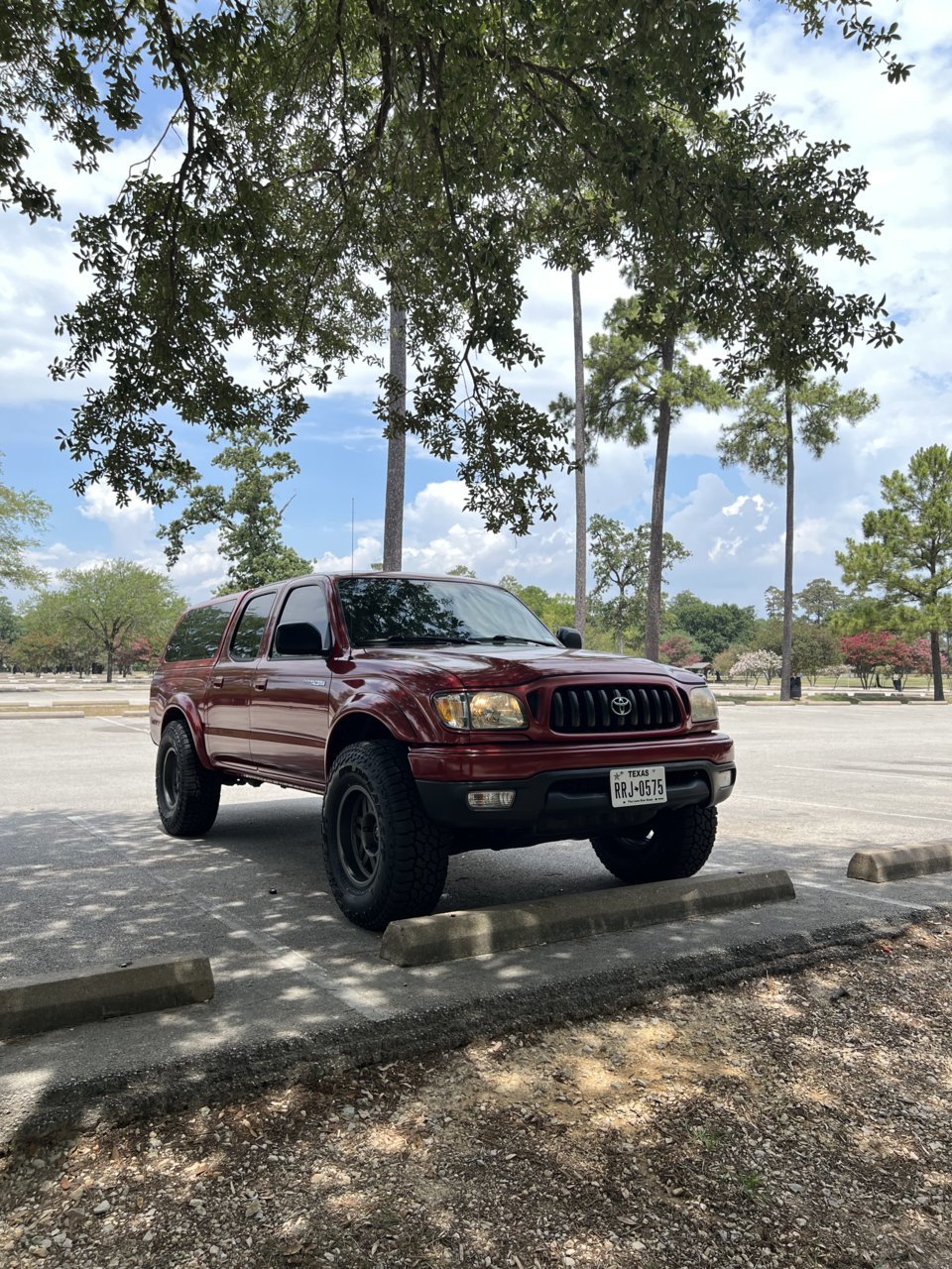

  4. Jun 22, 2022 at 10:26 PM
    TACO_GUY03
    TACO_GUY03 Well-Known Member
    Feb 4, 2020
    #318229
    103
    Houston, TX
    03 Tacoma Xtra-cab 4x4 v6

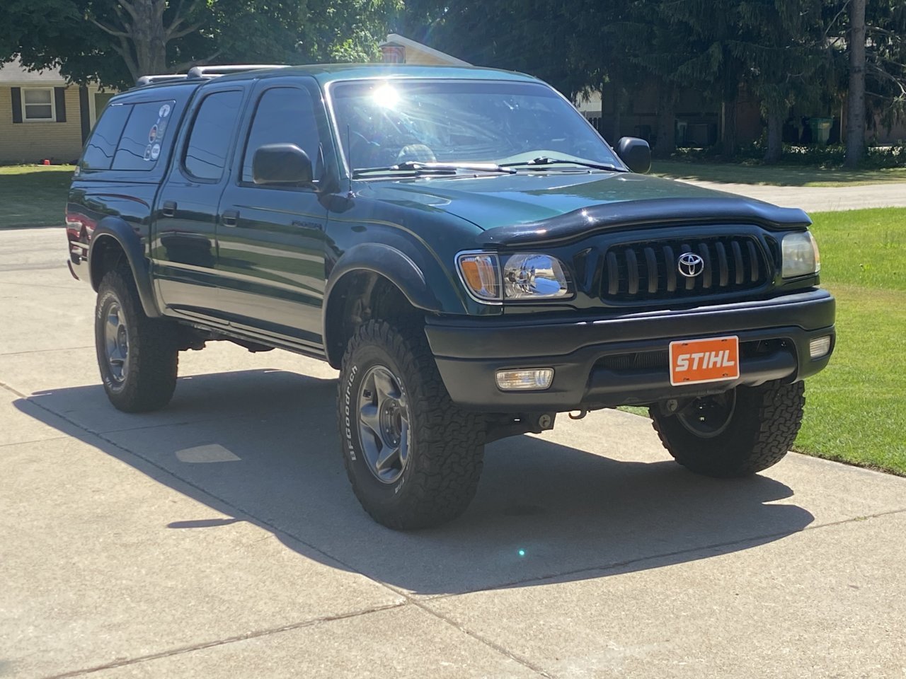

    Installed my 33’s and new wheels.. forgot to update

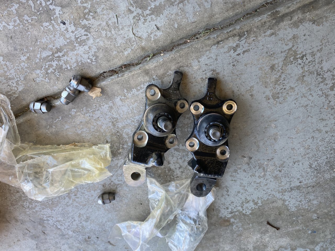

    Finished the grill and lbjs. damn that driver side headlight is bothering me

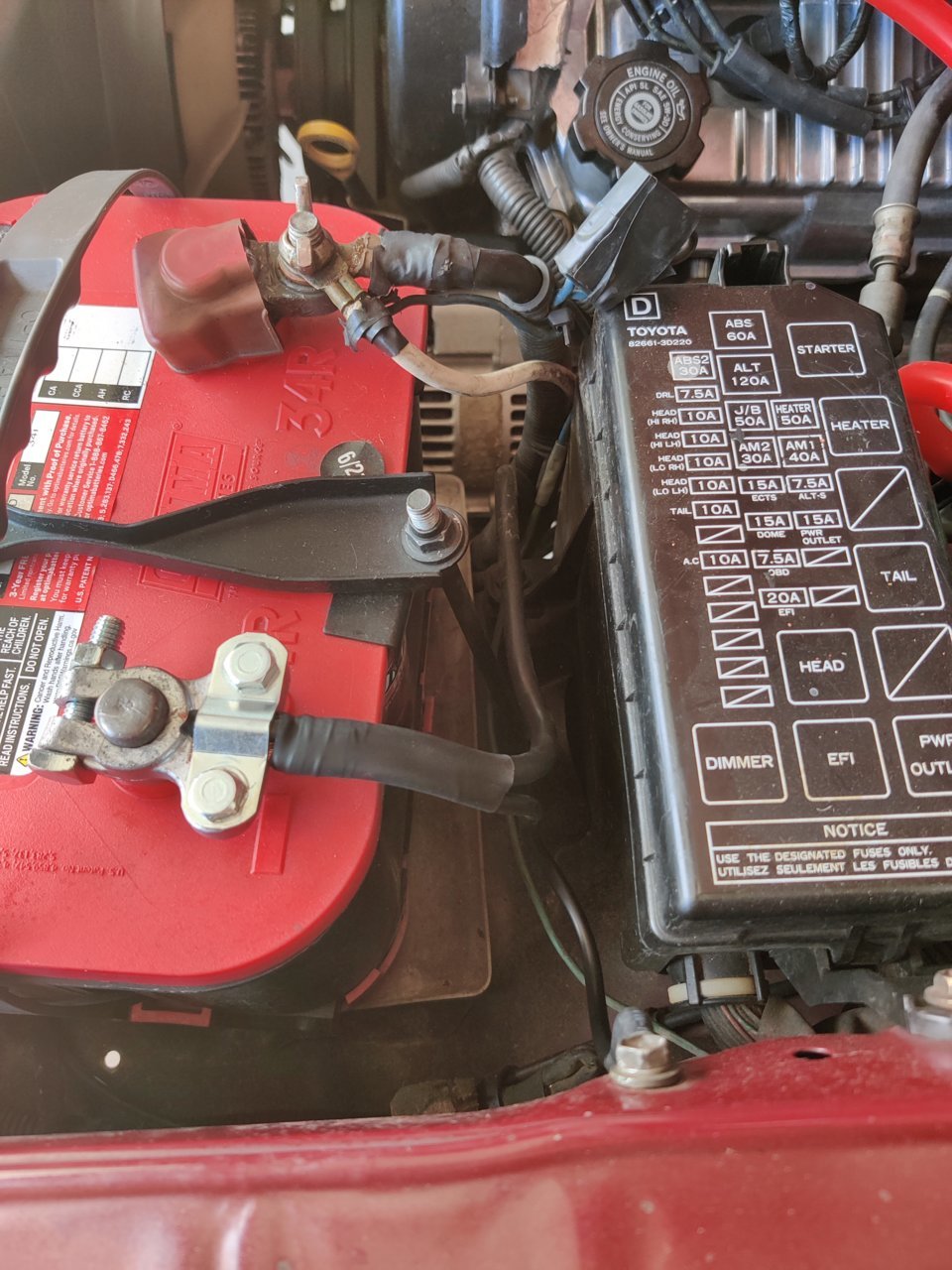

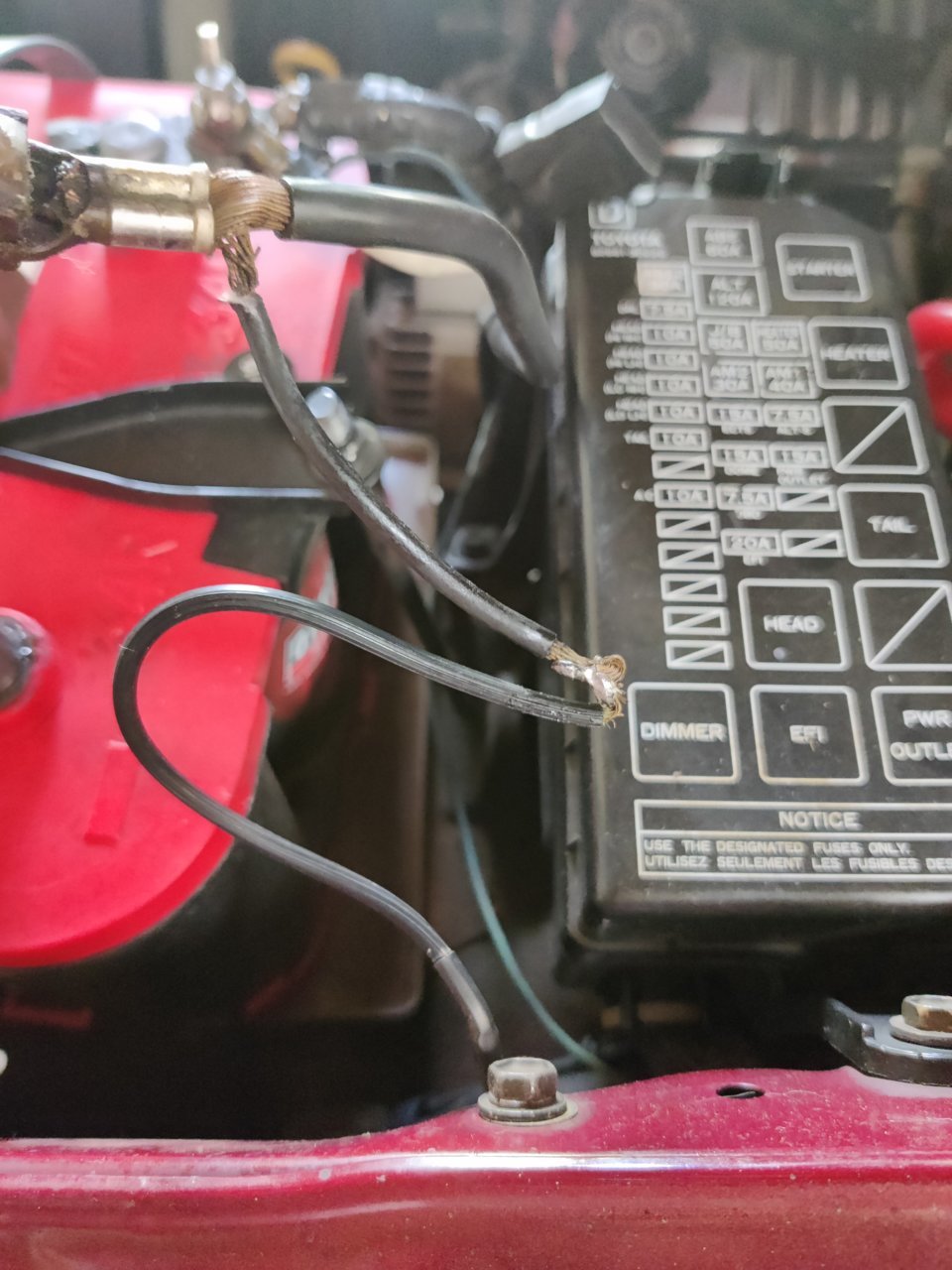

    :anonymous: check out this body ground coming off my battery
    I want to know who soldier in the thinnest black wire they could find:facepalm:
    Might not be perfect but it definitely can't be worse

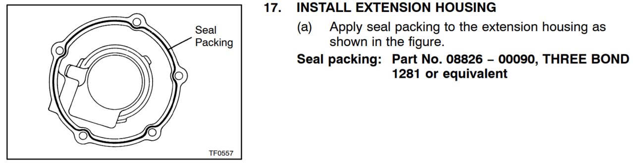

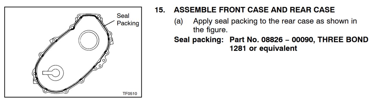

    Damn OCD is going to bite me in the ass on this... still going to ask for opinions anyway.
    FIPG with the transfer case... FSM says to apply around the inner side of the bolt holes.
    I went along the outside edge of the bolt holes. Seems OK but of course I'm not going to put this fcker on the vehicle mated up to the trans only to find I fuxored myself and its leaking in multiple places.
    Do I need to break it open now before that crap dries and let it dry then remove and re-do?
  11. Jun 23, 2022 at 5:44 PM
    theesotericone
    theesotericone Well-Known Member
    Jul 27, 2018
    #260800
    12,372
    Bishop CA
    Pull it apart. It will leak out the bolt holes eventually.

  12. Jun 23, 2022 at 5:45 PM
    Area51Runner
    Area51Runner Well-Known Member
    Jun 26, 2014
    #132748
    11,980
    Northern California, Bay Area
    02 3.4 DC TRD PreRunner 4WD SWAP
    What I figured. :facepalm:
    Thx.
  13. Jun 23, 2022 at 5:47 PM
    theesotericone
    Jul 27, 2018
    #260800
    12,372
    Bishop CA
    Anytime. The silver lining is you caught the mistake before you slammed it back in. Easy fix right now. Not so much later.
