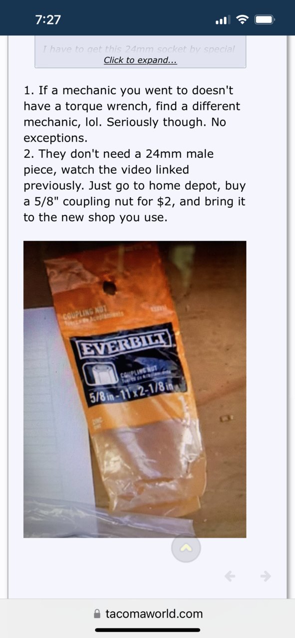

    Does anyone know the actual size for the hex on the steering rack guide cap, I cannot find it.

    I don't know it off the top of my head. But there is a Youtube vid of a Russian (i think) dude that rebuilds a rack. I think he said it in the video.
    I know, it's not real specific, but it's all I got lol
    EDIT @timmah has his video where he replaces a rack guide. I'll bet he says the size.

    Yeah I was just trying to find something better, I had a 3/4” coupler that I had laying around that I grinded down. It works bu definitely isn’t the best. I did see some one say a 5/8” nut fits well, so may just grab 2 and weld them together. I Also seen One picture of a 24mm hex bit. But I can’t seem to find that in a cheap option or in 1/2”

    I use a coupling nut from home depot.
    Think this was it
    https://www.homedepot.com/p/Everbilt-5-8-in-11-tpi-Zinc-Rod-Coupling-Nuts-822311/204337405

    24mm. I bought one awhile back to tighten mine up.
    https://www.amazon.com/gp/product/B00RBGMVOY?ie=UTF8
    that coupler idea is definitely a cheaper solution
    Be wary of over tightening it though, too much and the steering gets super tight. I can't remember the torque spec off the top of my head but it's pretty low. I overdid it the first time and the wheel wouldn't return on it's own after turning a corner.

    Oh yeah I over tightened it and it was sketch haha, the adjustments are interesting. Torque specs is 18 ft lbs and then back it off 19 degrees, so I went to 18 ft lbs and then tried it and was way to tight. Backed it off like 10 degrees, it’s tight but much better. Going to rock with that for now since I ordered a new guide and spring.

    I lift the front of the truck off the ground and adjust it until I start feeling a little bit of tension in the steering wheel.
