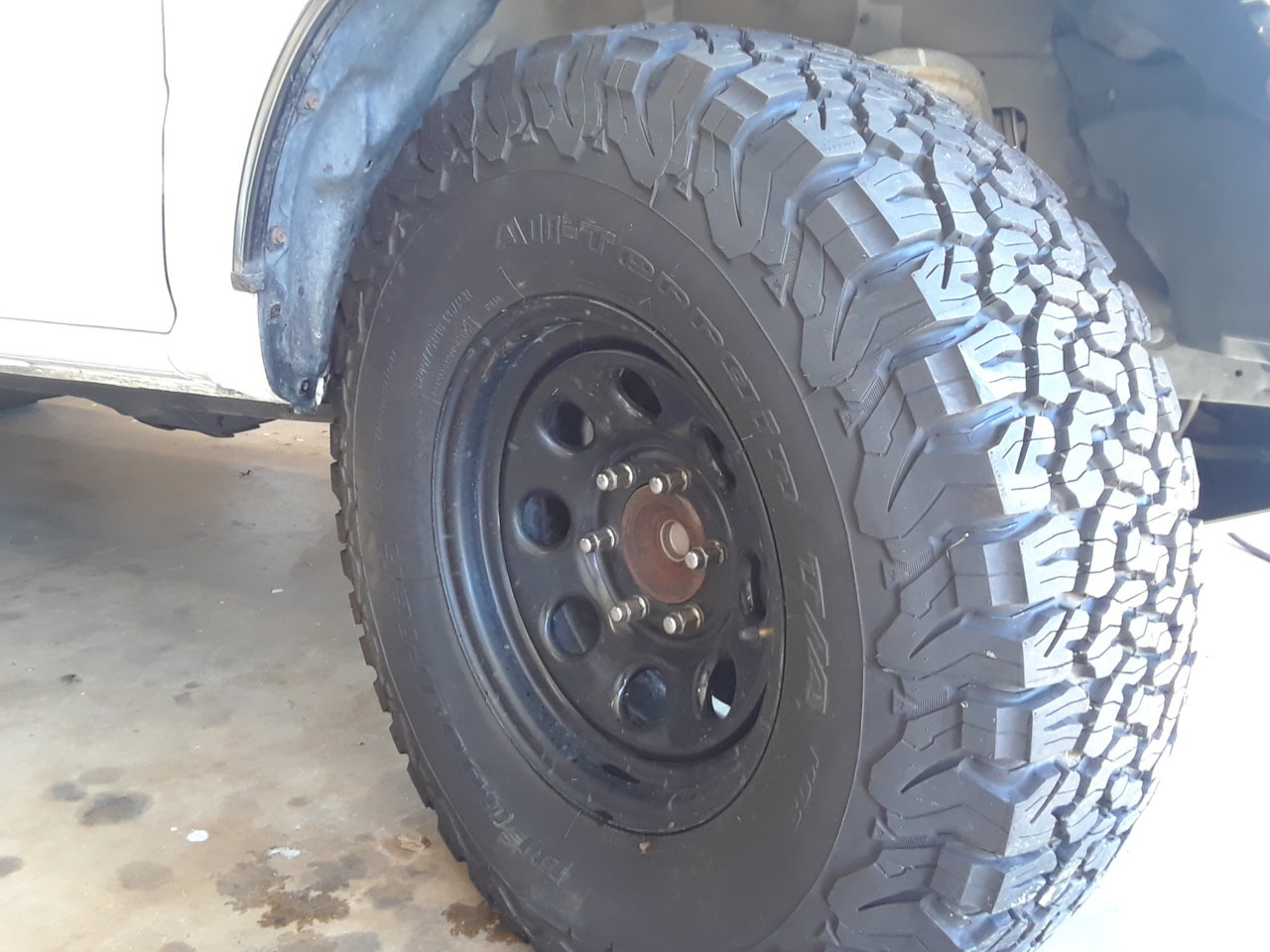

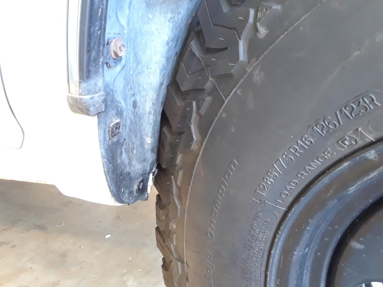

    Was bored and attempted to put 33s without lift:p. Rubs everywhere 20220703_164304.jpg 20220703_164317.jpg

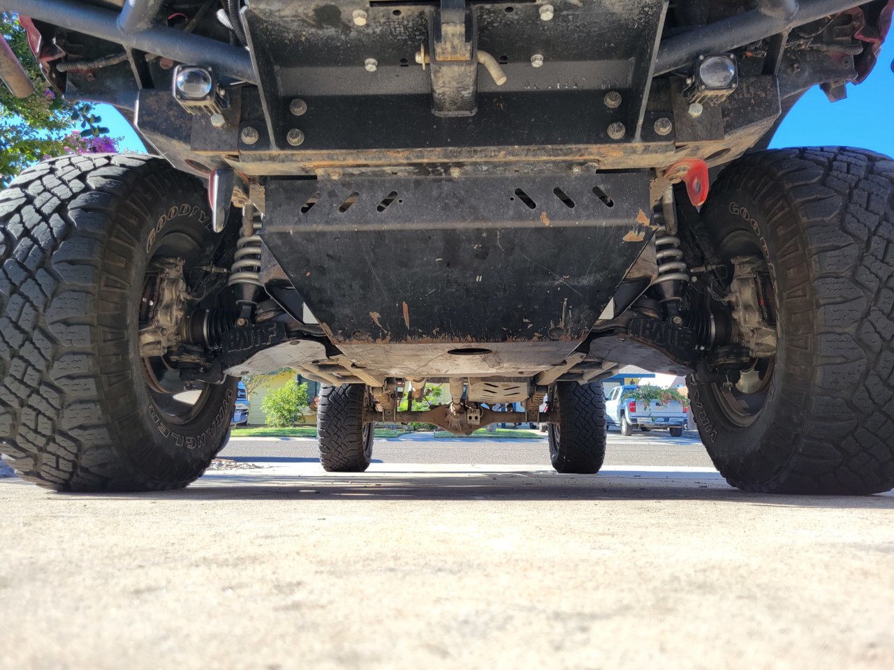

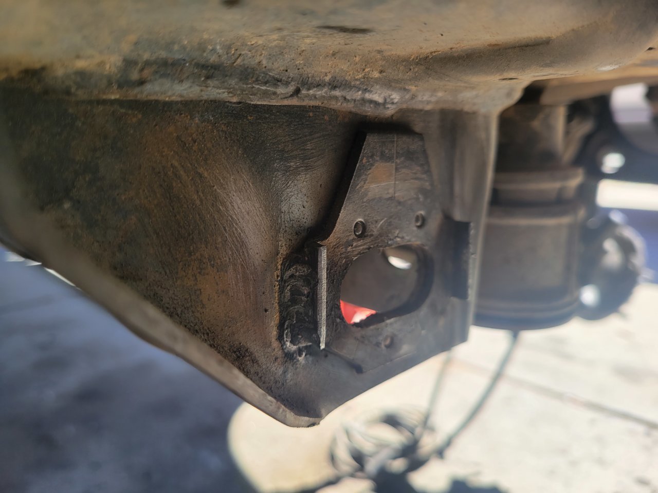

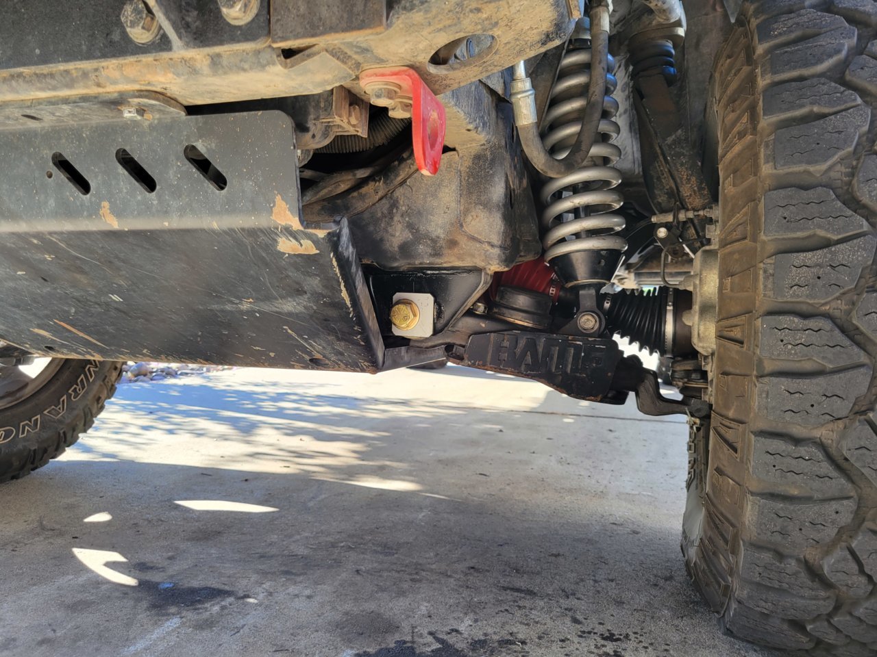

    Major thumbs up to the 333 Fab alignment cam eliminators!
    Finally got all the other work, I've been doing this weekend, done. Got wheels back on the ground. This is probably aligned better than it ever has been.
    Steering wheel dead centered. Drives perfectly straight. Steering returns exactly the way I want it. And the back side of my tire is over 3 inches away from the back fender.
    I could tell the kit moved the wheels forward a bunch, because both the wheels were toed way out before I adjusted them. I'm certain the tie rods are not adjusted too far out. I checked the witness marks the old set of tie rods I keep as spares, and they ran with over twice as many threads showing as what I currently have on the truck.
    https://333fabrications.com/products/cam-eliminator-kit
    Did the alignment here. The toe is within 1/16th of an inch from front of tires to back of tires. The camber is as good as you can get it without a rack. And with the placement of the wheel away from the fender, the caster is perfect.
    Thanks for the heads up on the kit @theesotericone. I ended up staying at D setting. I may need to change it when I go 35s, but for now it's 2 thumbs up :thumbsup::thumbsup:
