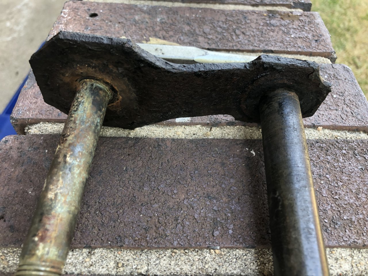

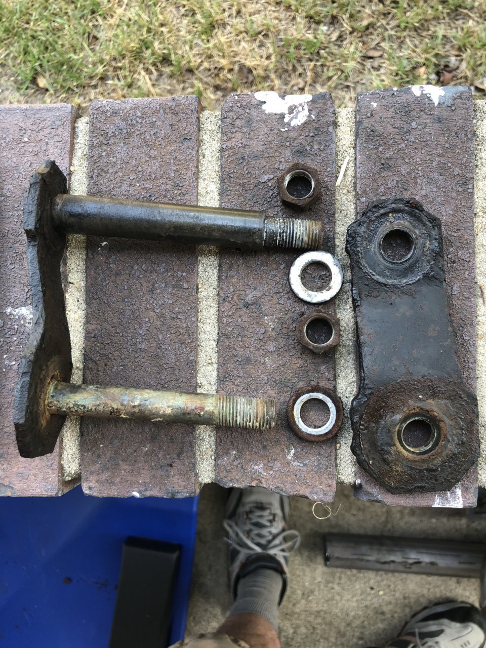

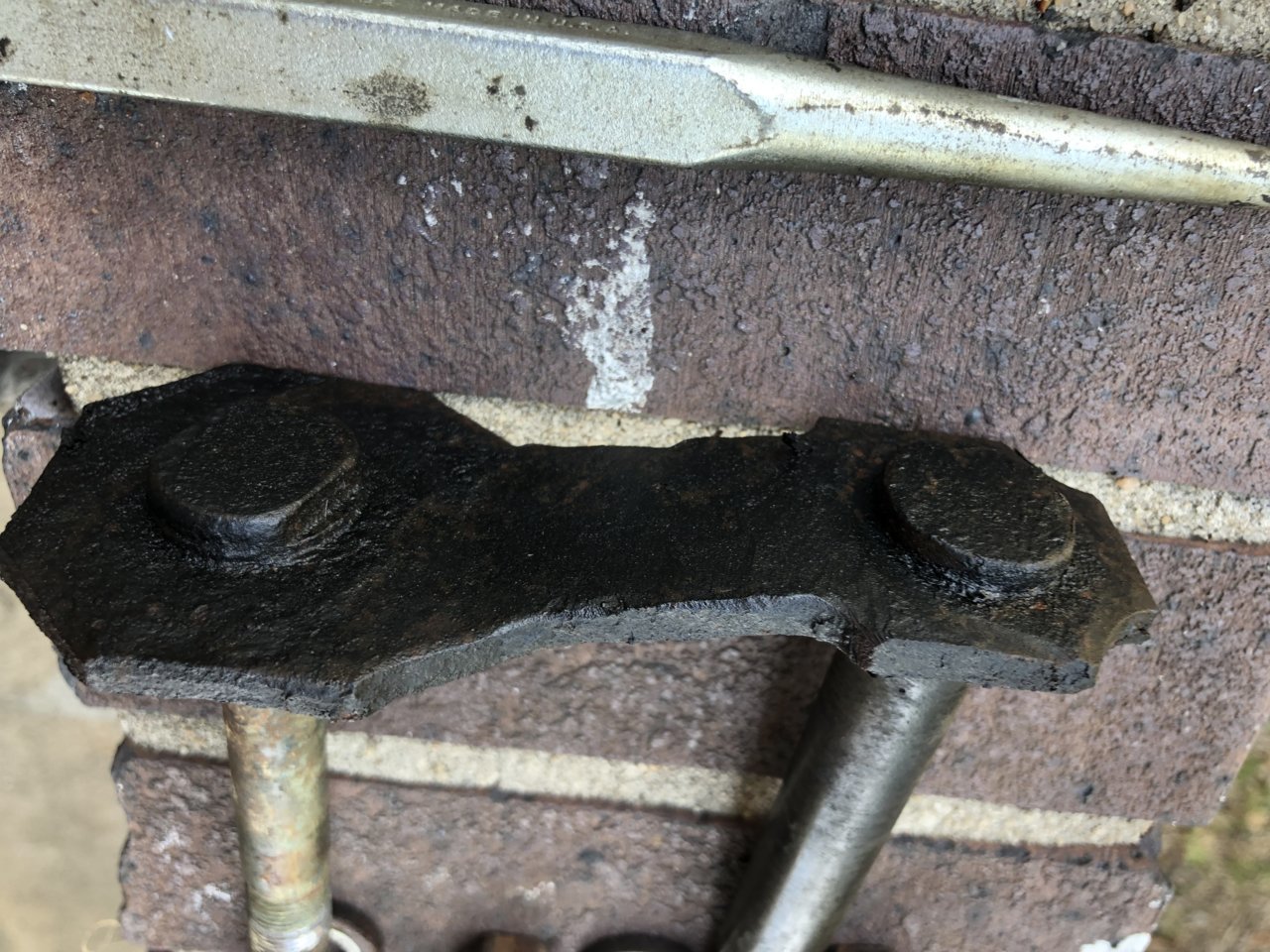

    Do y’all think these are still serviceable? Would you reuse them or ditch em like u bolts?

    Shackles are definitely not like U-bolts. U-bolts stretch when they are torqued, (they also can deform due to the stresses they are under) and generally should be replaced every time. Shackles are not like that. They aren't a disposable part per se.
    With that being said, I wouldn't run those shackles on my truck.

    All I see is dirt and surface rust, wire wheel and send it.

    You're going to spend about the same on new bushings anyway so just get a $50 kit with new shackles and move on with your life :notsure:

    It's a time vs money matter. either clean them up and reuse (what I did recently) or buy new and slap them on.

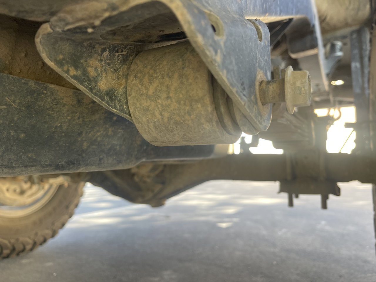

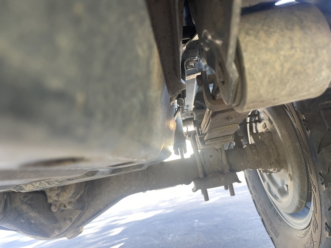

    on a related note, I just noticed this… Does anyone know the bolt and nut size I need to replace this? It’s for the leafspring Bolt closest to the front of the truck

    Yikes, lucky that didn't come all the way out. I had the main eye bolt come loose once on a trail and it made a racket.

    Wheelers sells a pair, not sure on the specs

    It's a M14x1.5x100mm.
    Part numbers if you want to buy OEM:
    Bolt - 90080-10135
    Washer - 90201-14005
    Nut - 90179-14039

    9/16 Fine thread nut and washer did it.
    thought I’d try to push the bolt through before pulling it out and the threads seemed OK

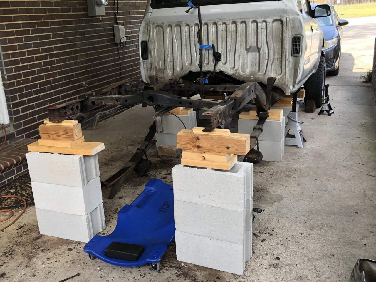

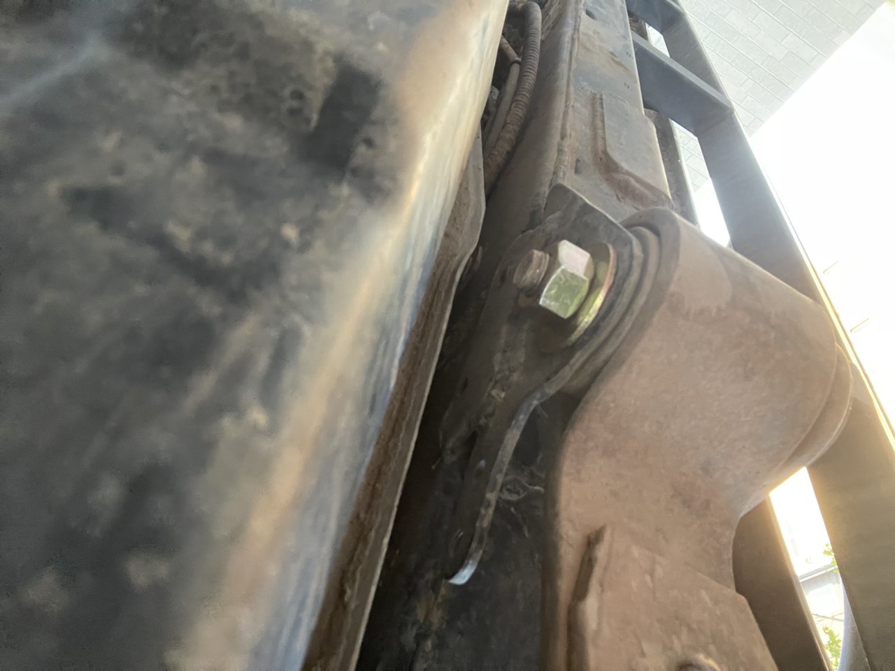

    Pulled my starter motor out today, which was a wild ride of cursing and sweating. I was made aware from other threads that getting the starter out of the 4x4 V6 auto is nearly impossible, but I managed to finagle it out from a gap between the transmission, frame, and steering rack. I think it helped that I don’t have the anti-sway bar on. Going to replace the contacts/plunger and get it back in this weekend, hopefully she starts right up!
