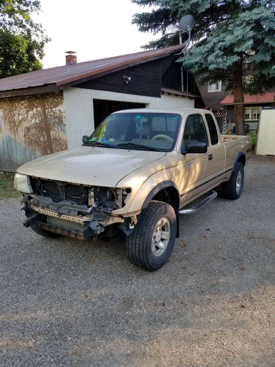

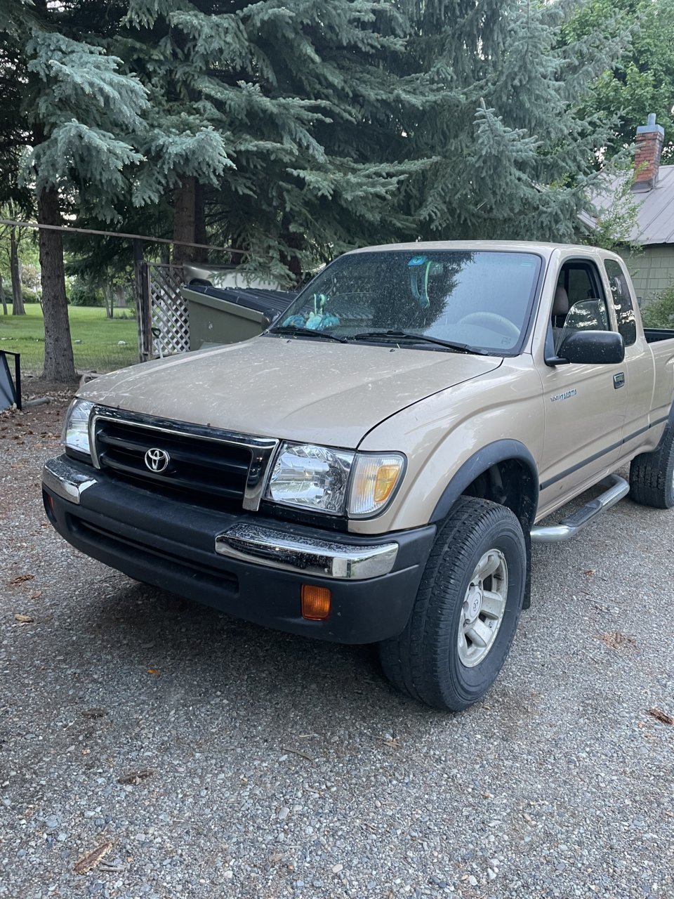

    New here trying to catch up with just over 240,000 on my Lil’ Champ. Just had the front bumper straightened and replaced after, oh…7 incidents (I can recall) since getting it in 2004. Also replaced the rear bumper.

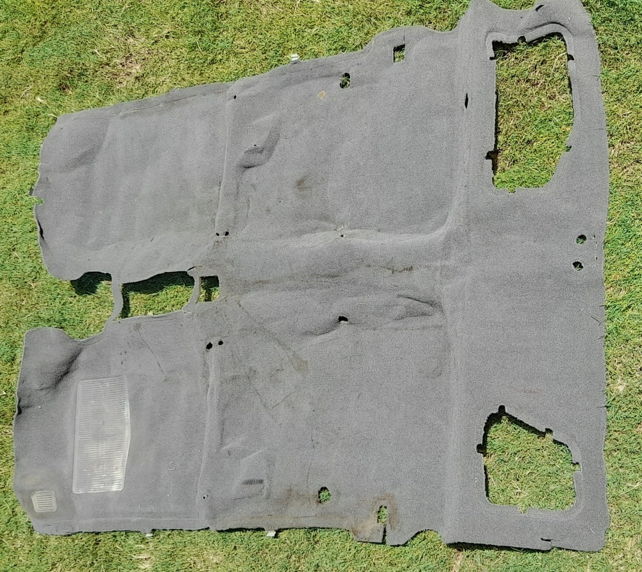

    Today going to throw on seat covers. Anyone have experience with replacing the whole seat and/or carpeting? Torn between selling and keeping. Being here makes when want to drive to Mars and back. E2CD7B04-7500-4D86-AF9C-7F7CF2C84467.jpg 045ABA74-2C07-4D11-A702-A1E37A301B9E.jpg CF15541A-6282-4306-B415-92155844A8CE.jpg D661C872-6484-4AF1-A2E1-EC61BE17993F.jpg E2CD7B04-7500-4D86-AF9C-7F7CF2C84467.jpg

    Tons of us have done seat swaps, replaced the carpet or gone to vinyl even. Rock auto has both carpet and vinyl. If you are seat swapping, most cut the feet off their seat rails and weld the new seats rails to their seat oem feet.

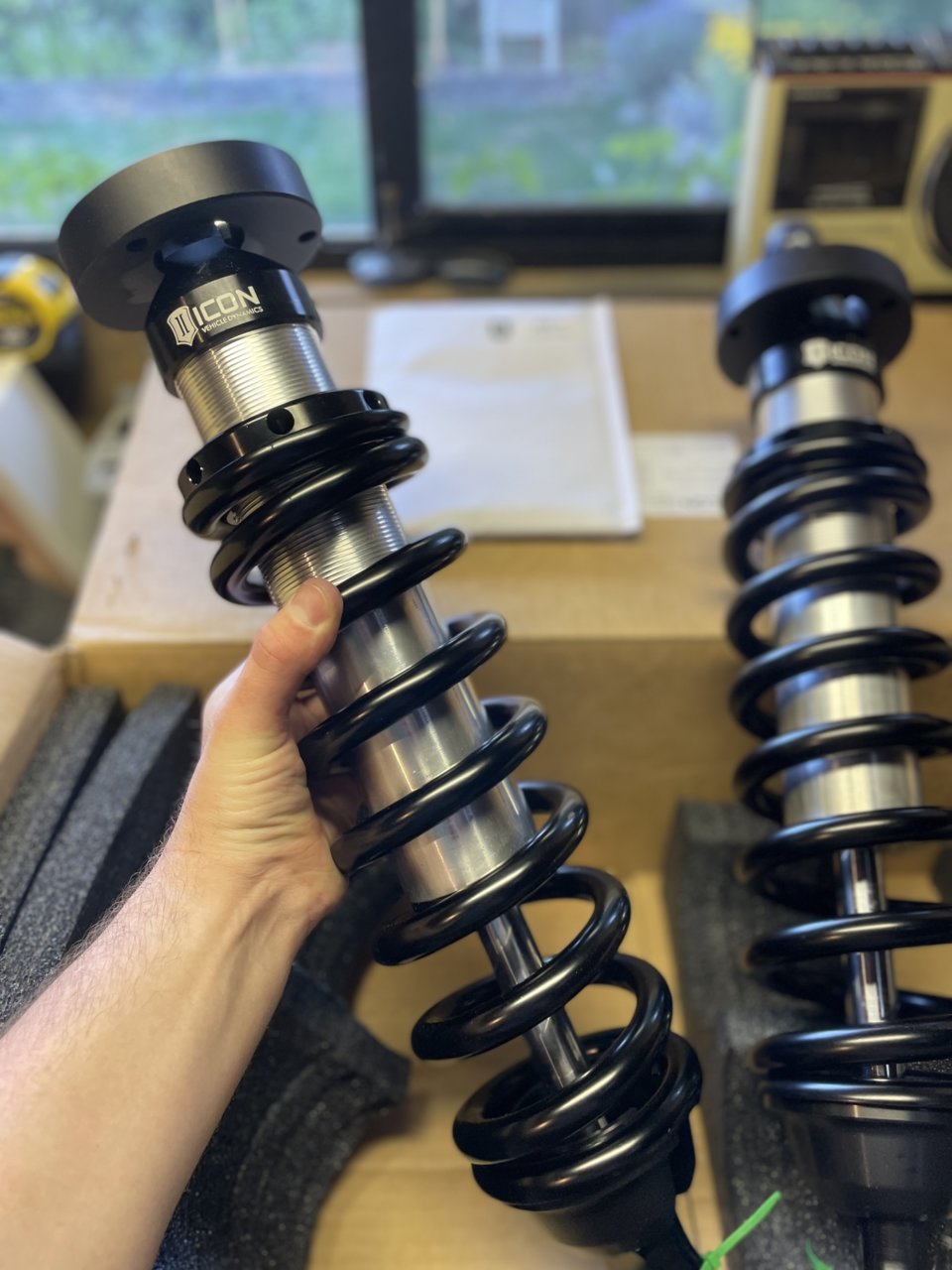

    I order these Icon 2.5’s last Wednesday from PolyPerformance and they arrived Monday.

    If you need carpet, Shoot me a PM, I'll cut you a decent deal.
