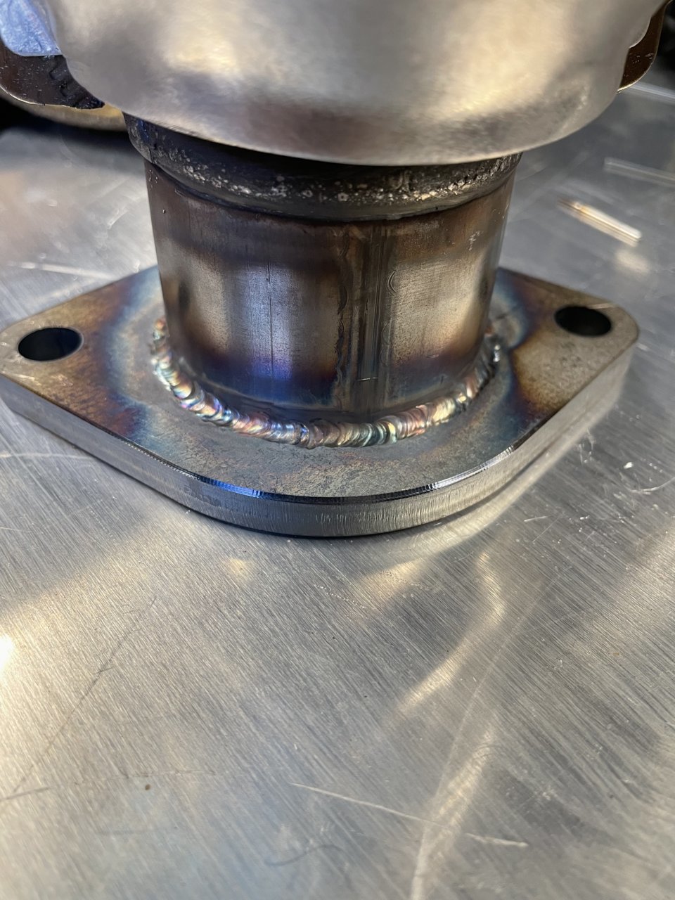

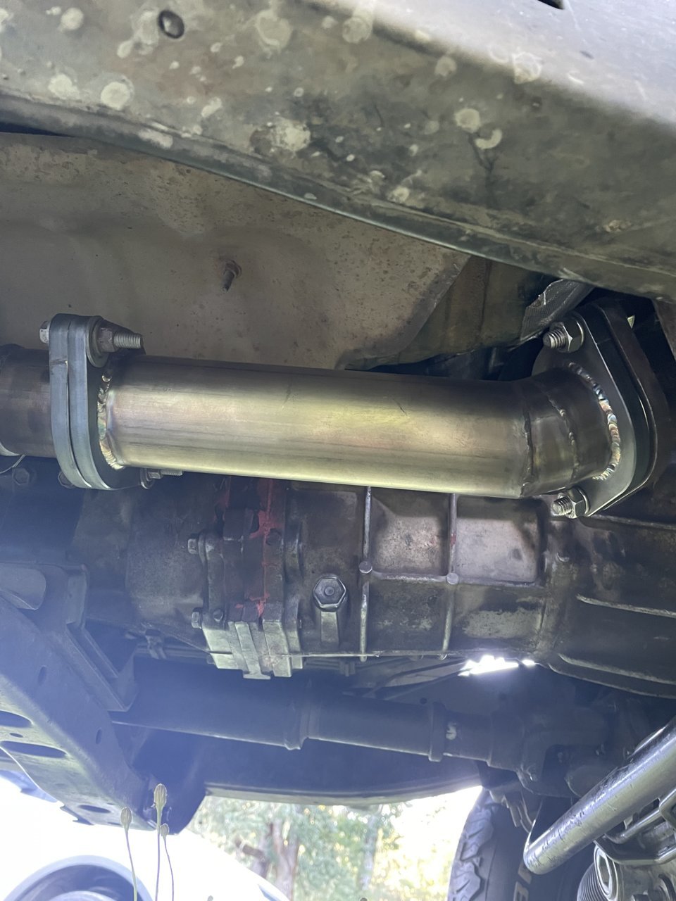

    Got my exhaust leaks addressed and taken care of. About a month ago I’d built a slap-dashed adapter to make my double cat headers line up with my single system, but the flanges I sourced from a local exhaust shop were pretty inferior. I ended up burning the gaskets out of them about 500 miles into a road trip to the Midwest. So yesterday I went ahead and welded some LCE flanges onto my new catalytic converter from magnaflow and then proceeded to make a better adapter pipe for the header -> cat connection using same LCE flanges. Truck is so much quieter now and the catalytic converter no longer rattles. Now we shall see how long the P0420 code stays away. Here are a few pics of process and end result.
    645B9DD1-94A8-49A7-BAD8-CBF6E18F9FBA.jpg F53713C3-3DFE-40D4-9EB9-5DD8CB5797F6.jpg 81A81BFB-DF96-4F19-92F8-A2A1F3D2F62F.jpg FB744779-F995-4F3F-A6E3-5ACBEC4619DA.jpg
    Now back to the driveshaft discussion.

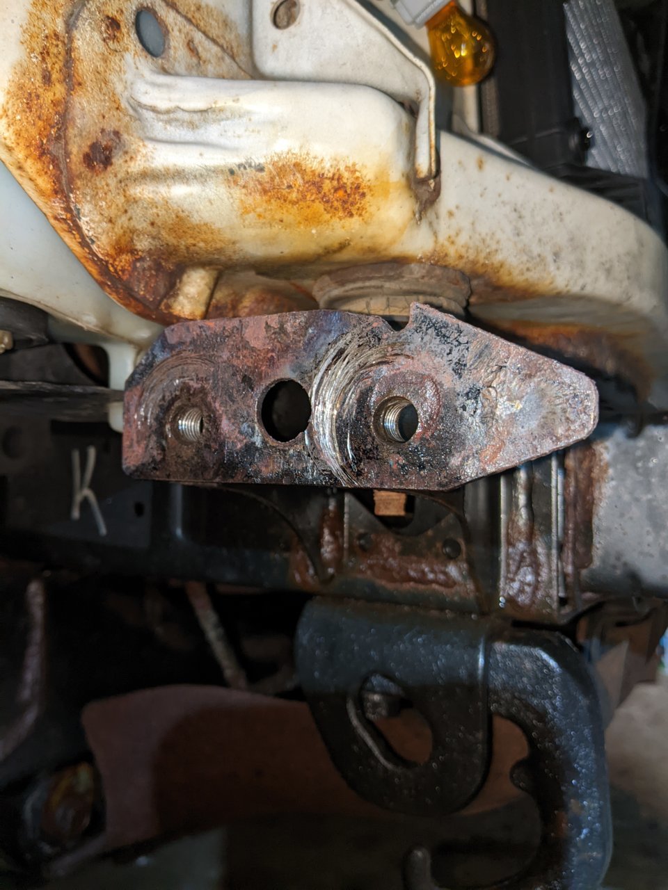

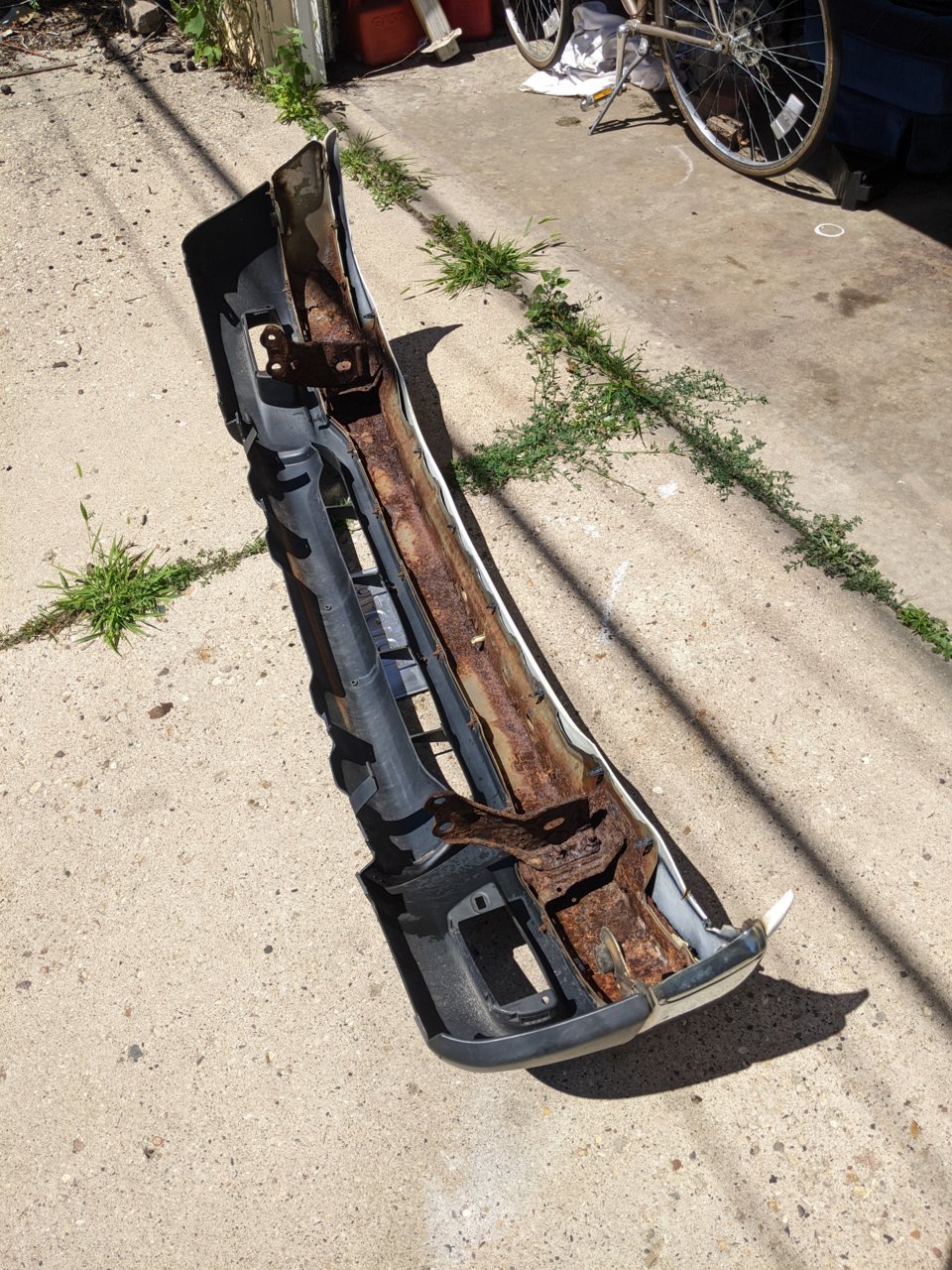

    Working on replacing my rusted chrome bumper, three of the four bolts holding it in broke when I put the impact wrench on it. Tried using a torch for the first time to free the bolts and that worked like a charm.

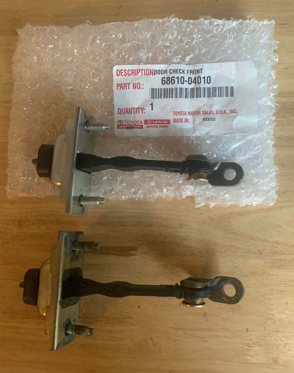

    Got tired of my doors flinging open when I'm parked on an incline at my land, so I bought some new door checks. Had originally planned to rebuild the originals but the Russian seller on eBay of those replacement pads is not around anymore... While I had the door panels off I took a closer listen to my tweeters, and they sounded like tinnitus so I unplugged them for now.
    Found some troubling rust on the bottom inside of the doors underneath the seam sealer, will have to do some wire wheeling and painting this weekend. I pulled the old seam sealant bead off of the door, anybody recommend a brand when I'm ready to run a new bead? 3M? Eastwood?

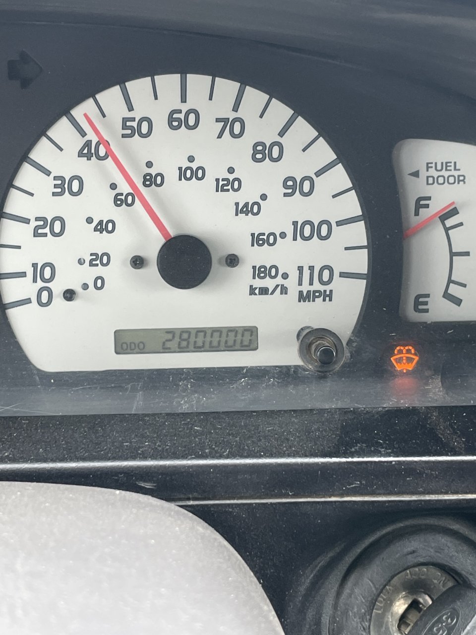

    280k today, mileage really slows down when I drive the work truck and my chicks drives me around town everyday
