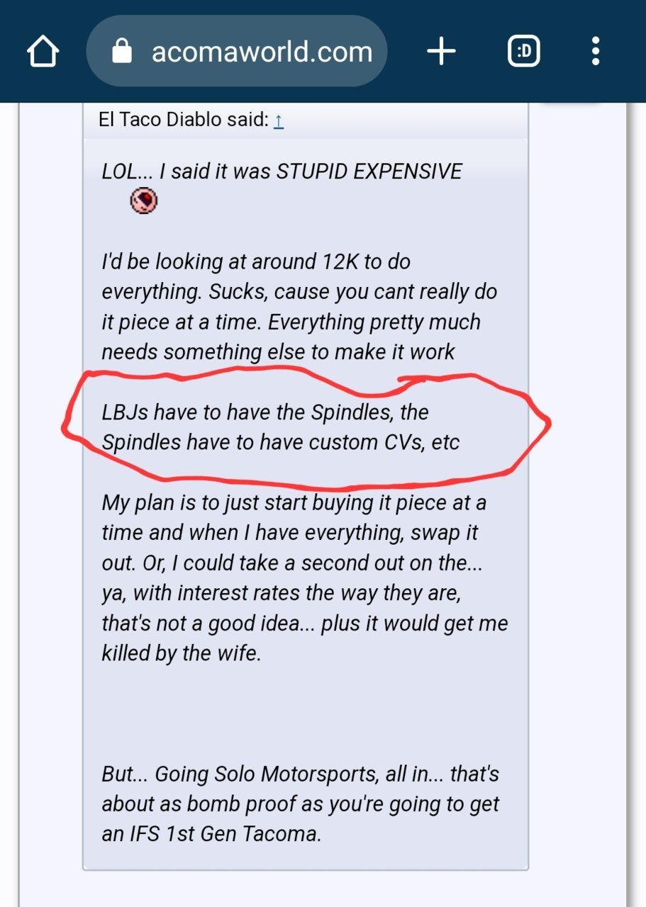

    I'd be looking at around 12K to do everything. Sucks, cause you cant really do it piece at a time. Everything pretty much needs something else to make it work
    LBJs have to have the Spindles, the Spindles have to have custom CVs, etc

    Thats not true.
    You can run the spindles with anything. They bolt in like stock ones and will work with any LT kit or OEM arms or mid travel kit.
    The LBJ's are the only part that needs the spindles.
    And you do not need custom CVs, the OEM ones work just fine or the tundra ones with LT.

    LMAO... You just actually said exactly what I said... but differnetly.Screenshot_20220720-153401_Chrome.jpg
    And YES you do need RCV axles for their spindles

    Just looked they must have changed that. Used to be when the Dana 44 hub design came out you could do either. But they must have stopped doing that. I'd bet they would still make them with toyota hubs though if you asked. You'd probably have to provide some spindles for a core.

    The entire point that I (personally) would want their spindle... aside from a better LBJ. Would be to get away from our dumb press fit bearing.
    I'd rather have the Dana 44 hub that's more easily servicable.
